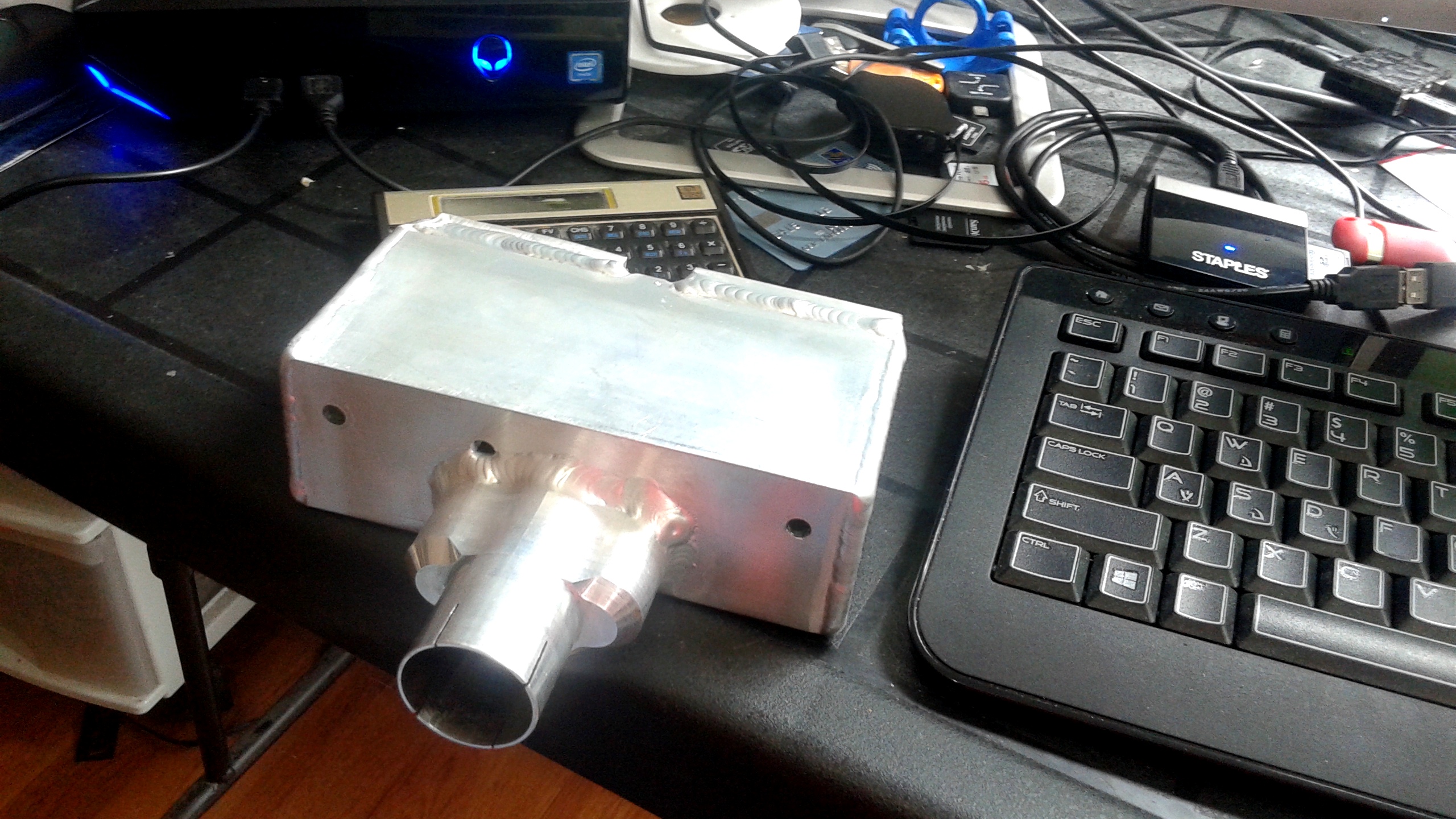

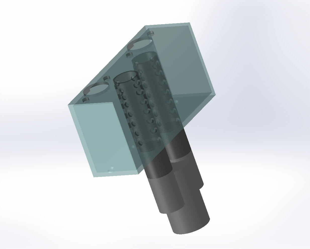

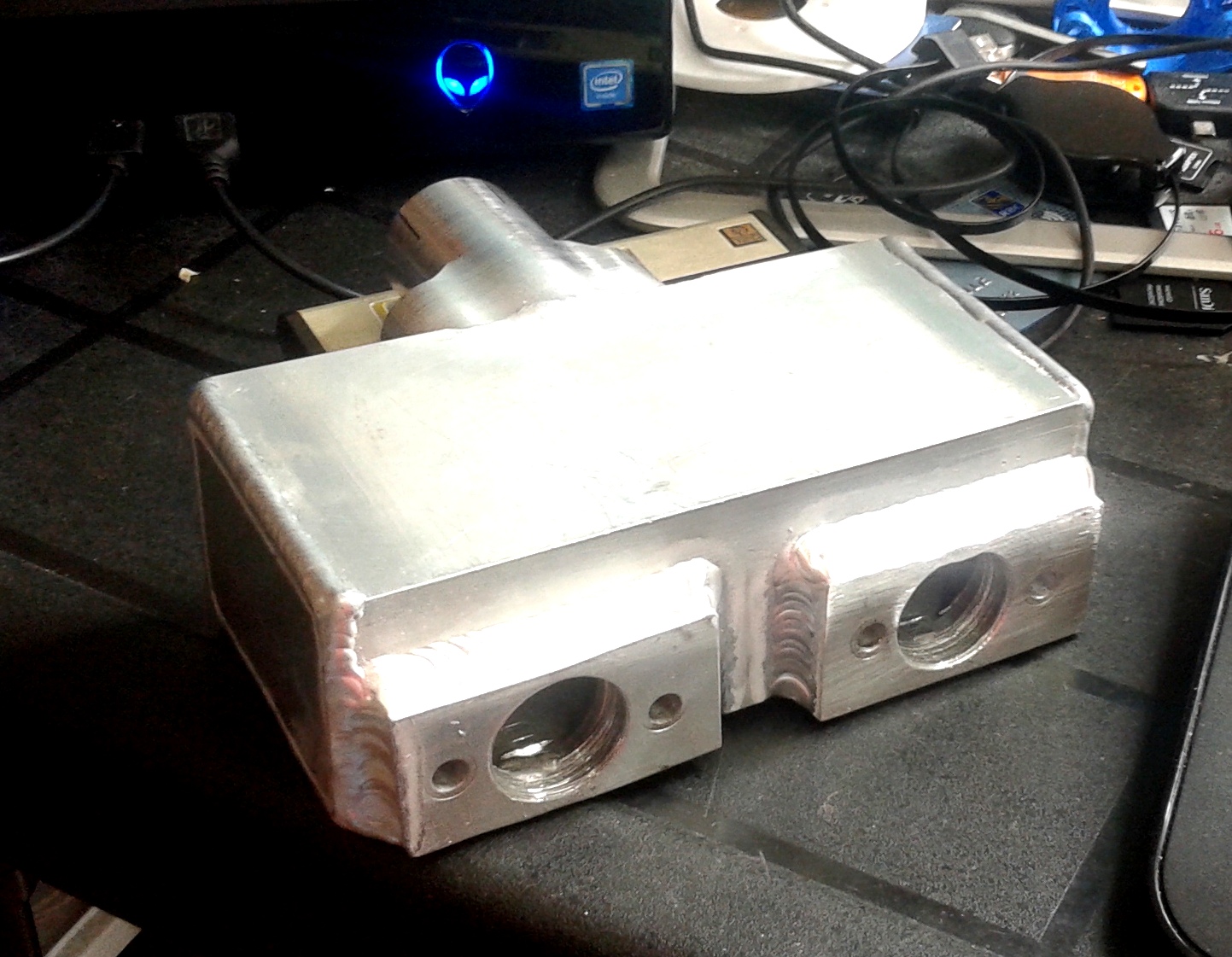

Mufflers all welded and ready to install, taxi test within the next few weeks, if all goes well next will be the test flight

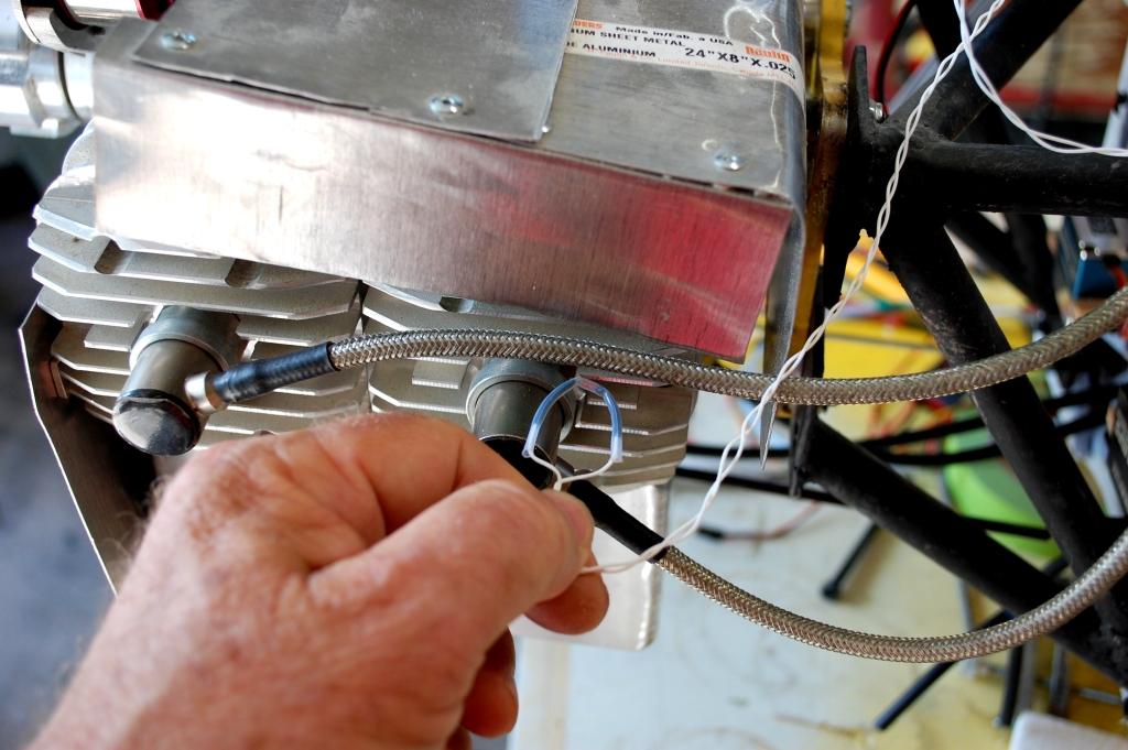

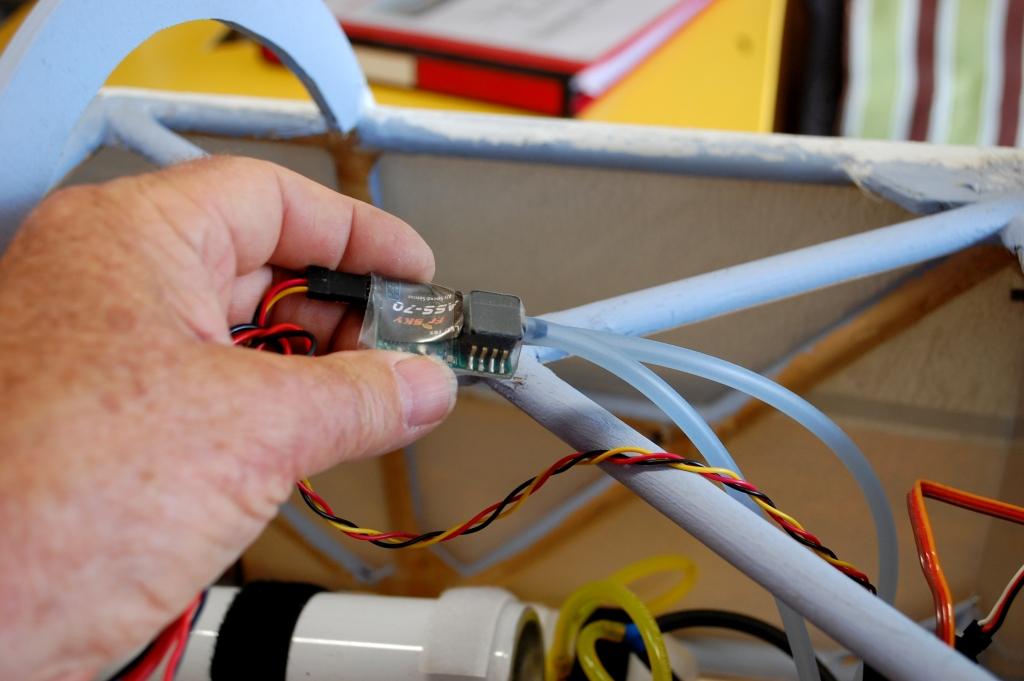

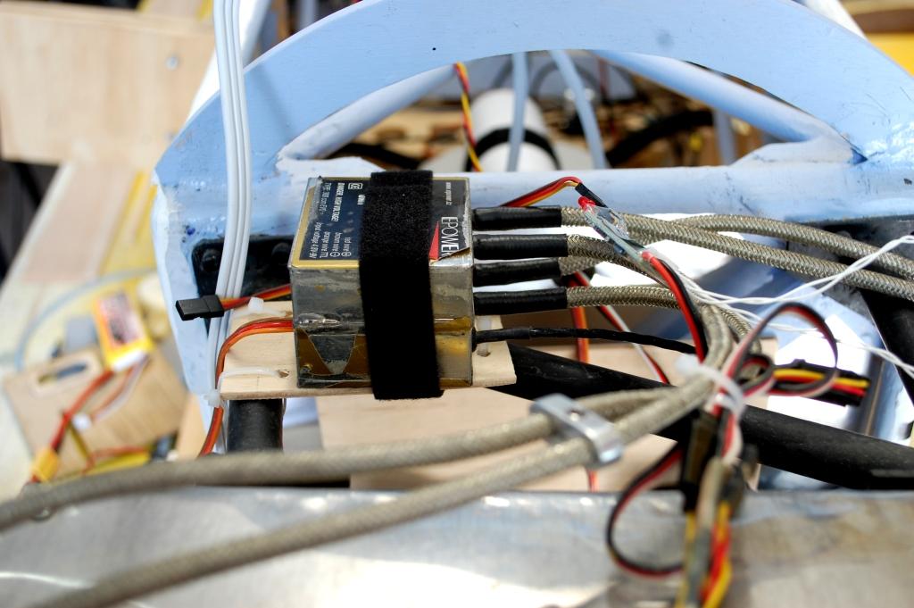

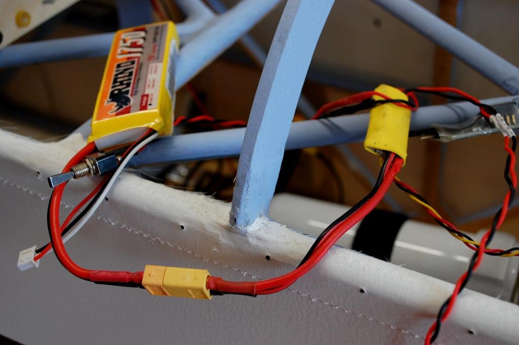

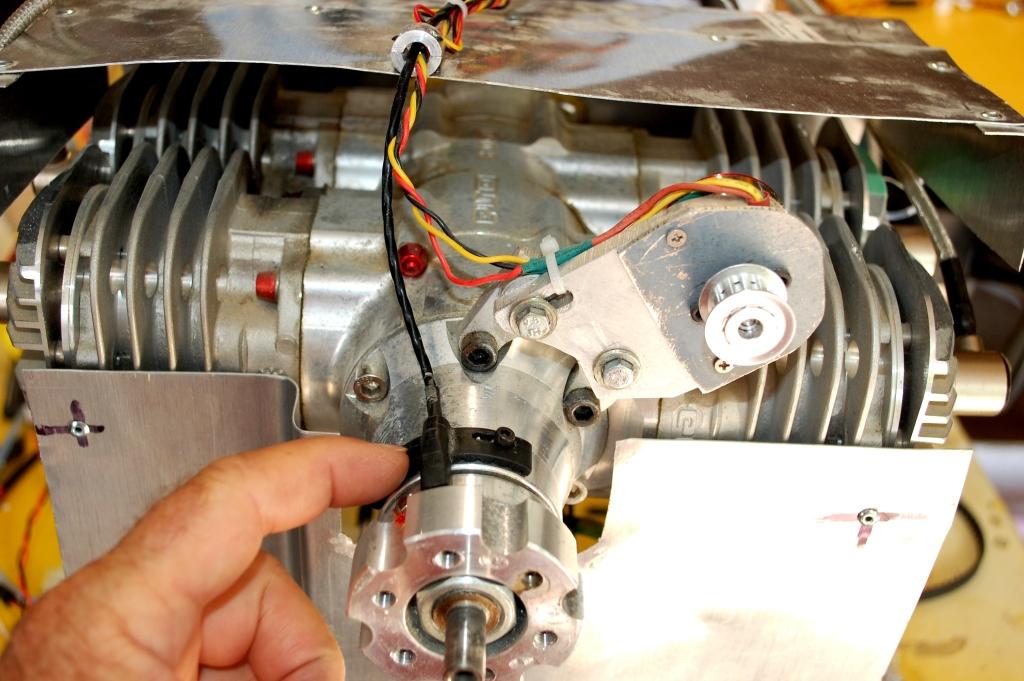

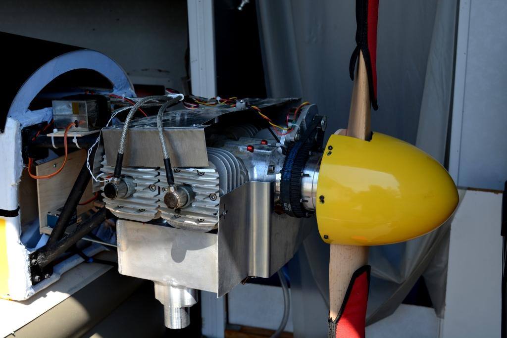

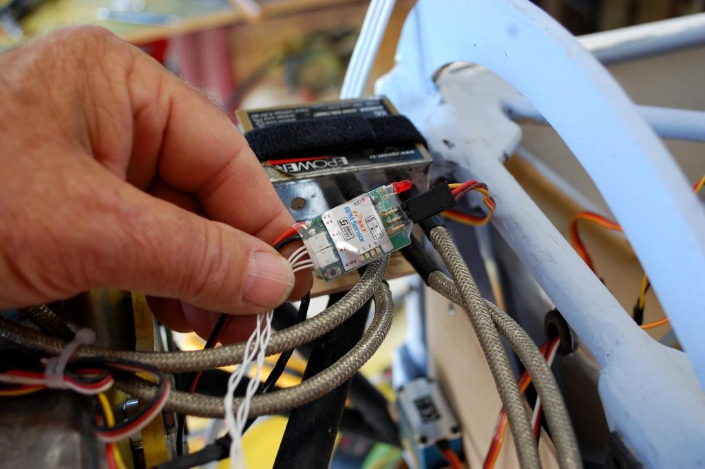

a few pictures, about the ignition module replaced, also ignition battery install with its own failsafe mosfet switch, also installed two temperature sensors on the rear cylinders, and you can also see the airspeed sensor

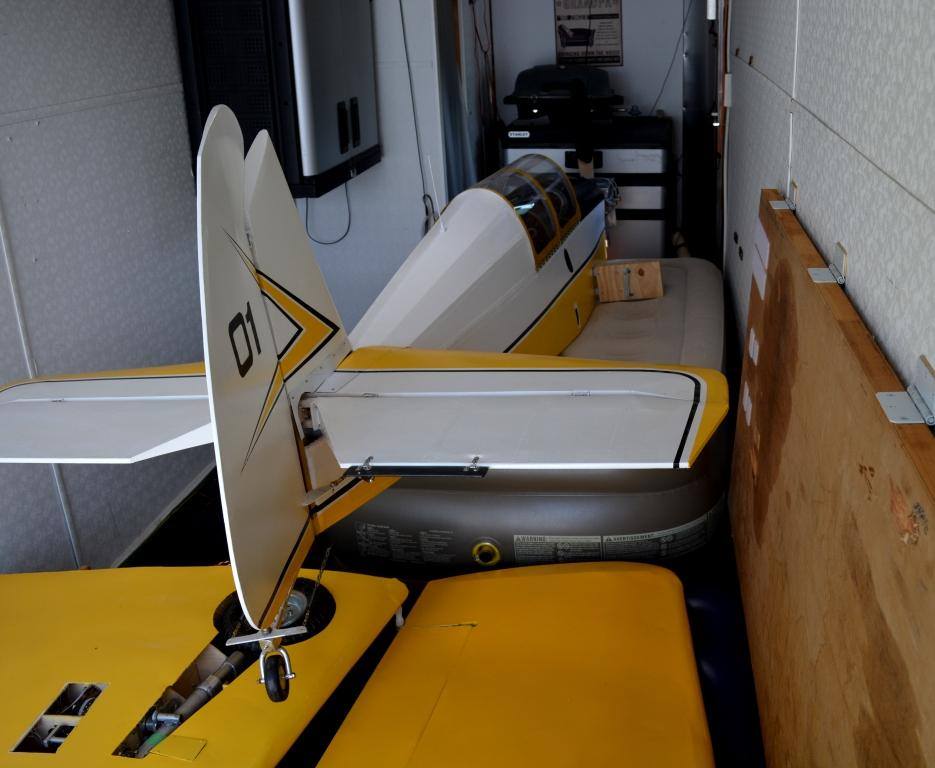

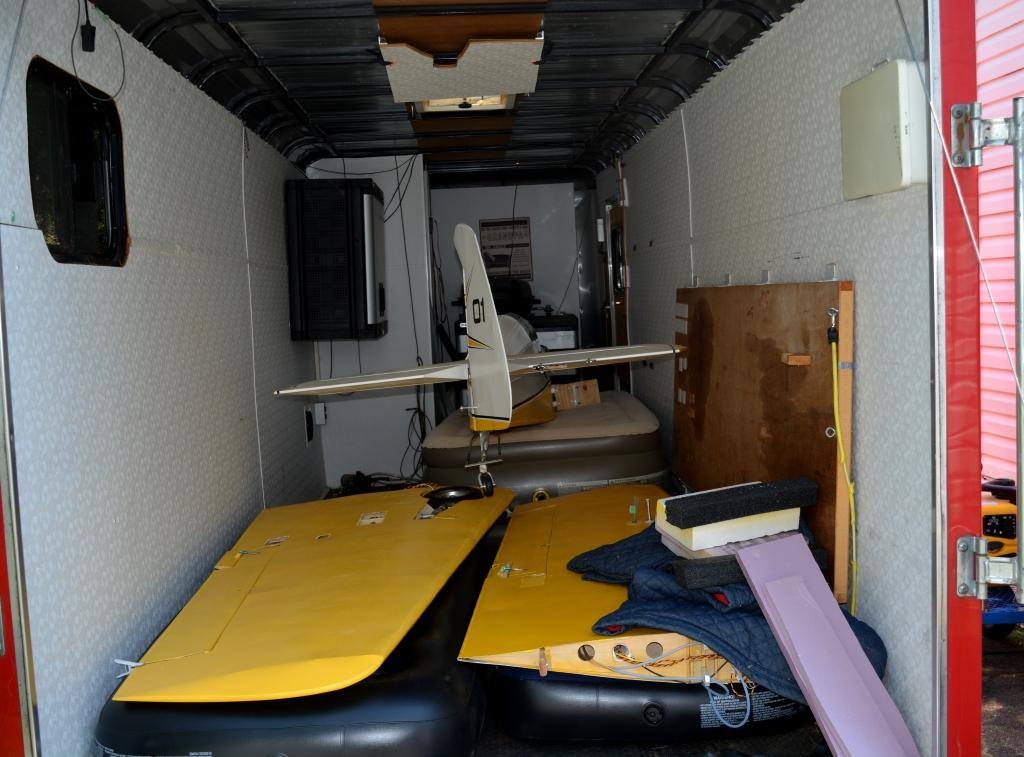

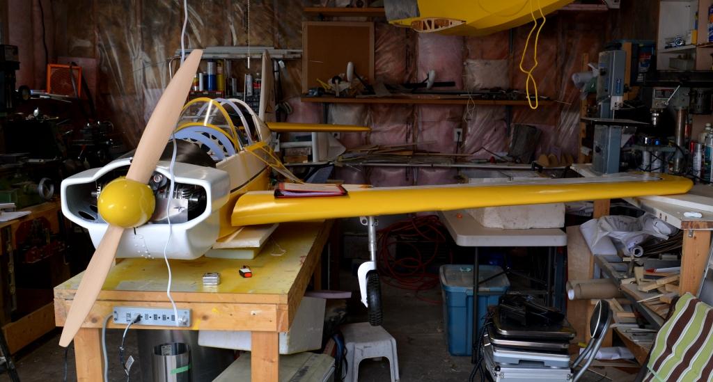

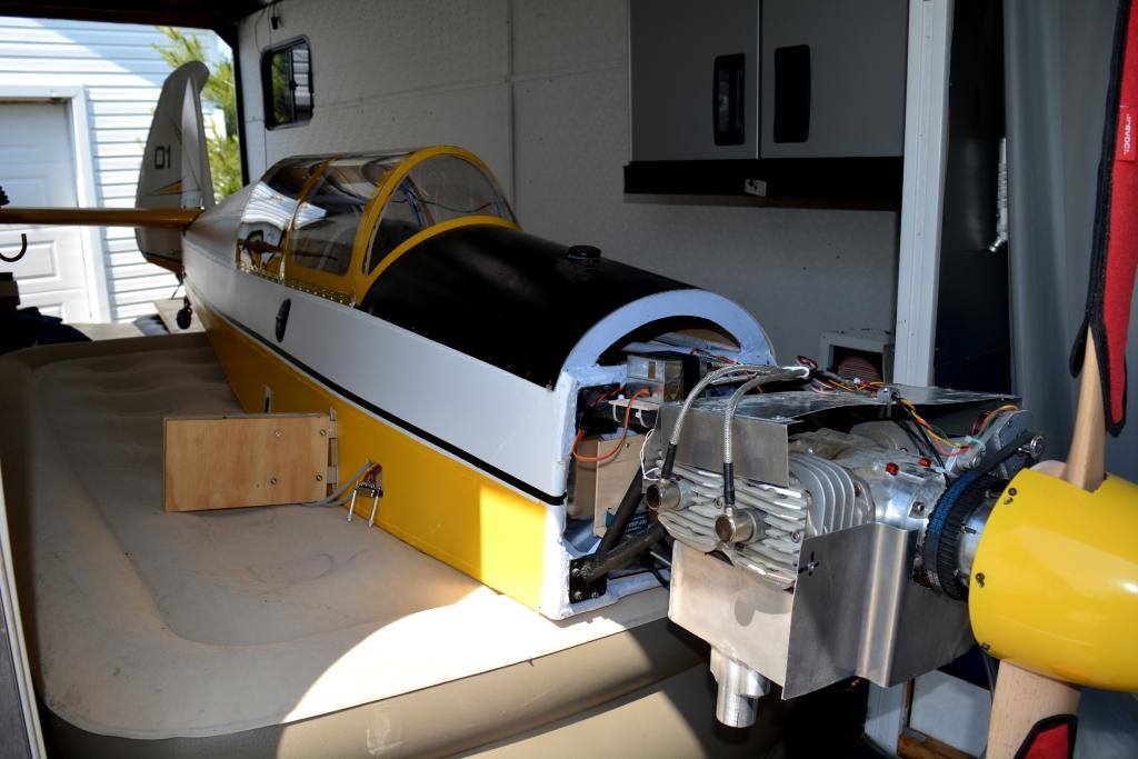

all loaded up and will assemble for the first time at our annual fun fly, it will be a good assembly rehearsal since this is not assembled as your usual model but exactly like the full size, will some taxi test later after our fun fly, then flight test will be in October, and the reason for October is I decided to enter team so found a local pilot which was rated as the 5th in the world in helicopters, now flying jets , so why October? a few weeks ago while racing his motorcycle, had a bad crash and broke both legs, damaged shoulder and more , so now he is on recovery.
I'm a decent pilot, but I want the best his name is Colin Bell of Nova Scotia
