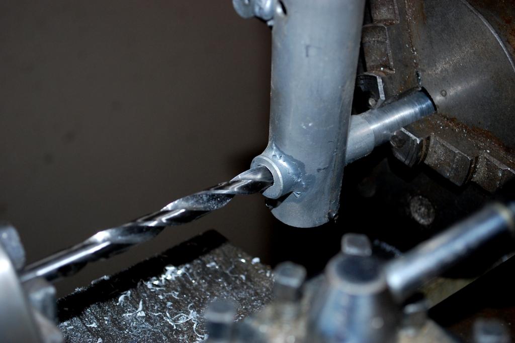

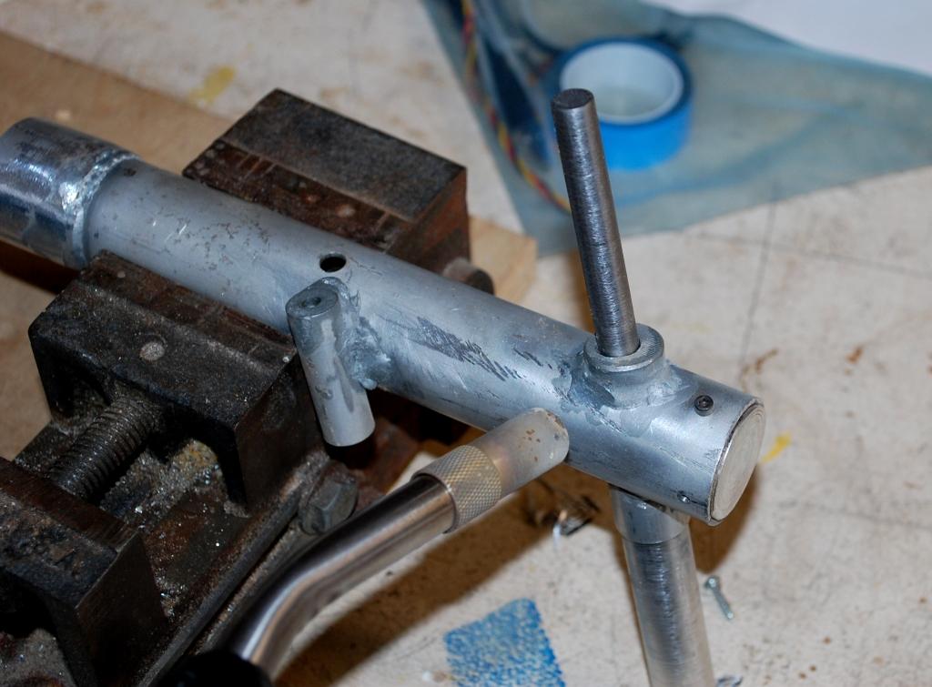

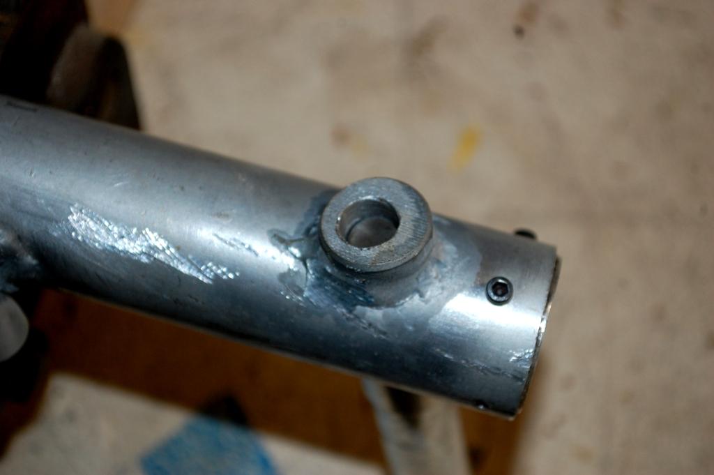

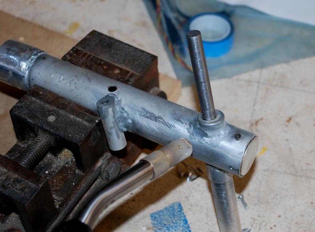

Very happy for you that everything is working out on this unfortunate setback. But I see it this way. Tis much better to have this issue arise due to a mishap that helped a weak link show it's faults, than to have a perhaps less than perfect landing and have the gear fold and drop that beautiful babe to her belly on the harsh runway.
Absolutely and it wasn't that bad a deal so far, well worth it
Done and working perfectly, in the axle hole there is a 10mm dia. drill rod to add rigidity
