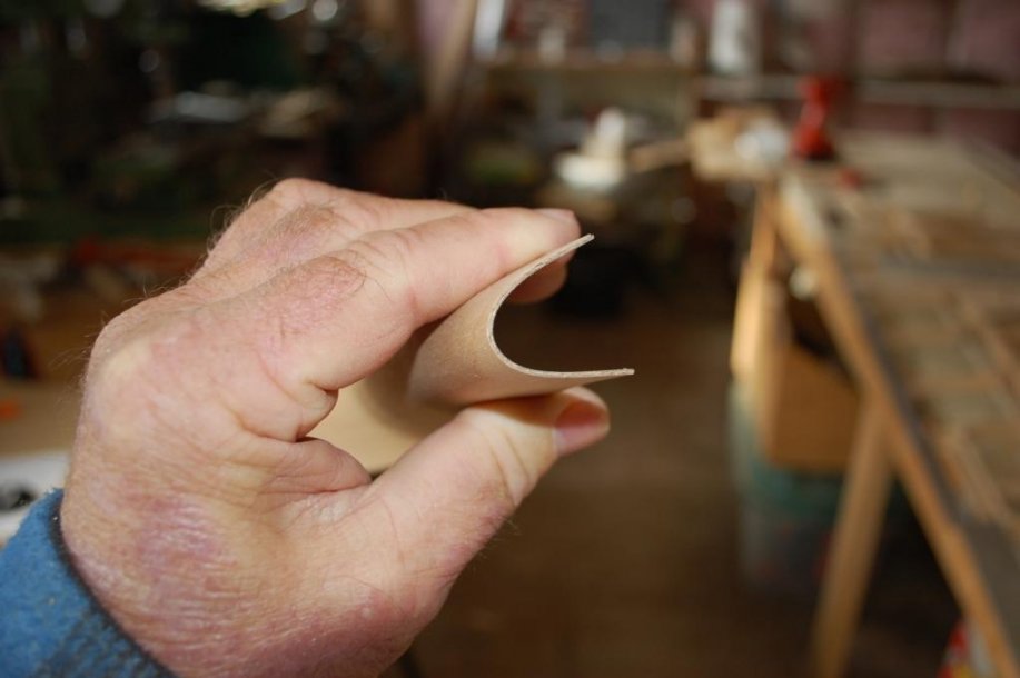

The 1/32" plywood just arrived , and now for the work to begin. I have tested with very good results the bending a piece of 1/32" plywood on a small diameter (1/2") piece of aluminum I have, by using Amonia to break down the wood fibers and it works really well but one must always be careful with the odors, they are dangerous. I'll post some pictures later today
Here you can see the extreme bendin around a radius of the 1/32" plywood which is what the wing will be sheeted with
