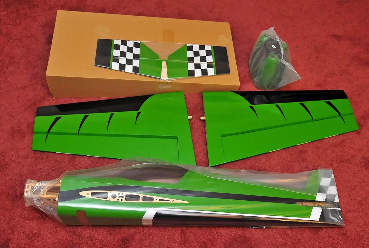

My Green MXS is here!!! I just got home and had to unbox it immediately! I am not going to be able to assemble it for a while because I am still working on gathering all of the components so I boxed it back up that is why I did not remove the protective plastic, yet. Anyways here is a shot of it on my floor.

Yea I had the same thoughts promised wife that if I bought plane I would not start on it till after christmas just bought 2 other new planes a month ago well I ordered servos yesterday plane is done just waiting on servos and motor esc

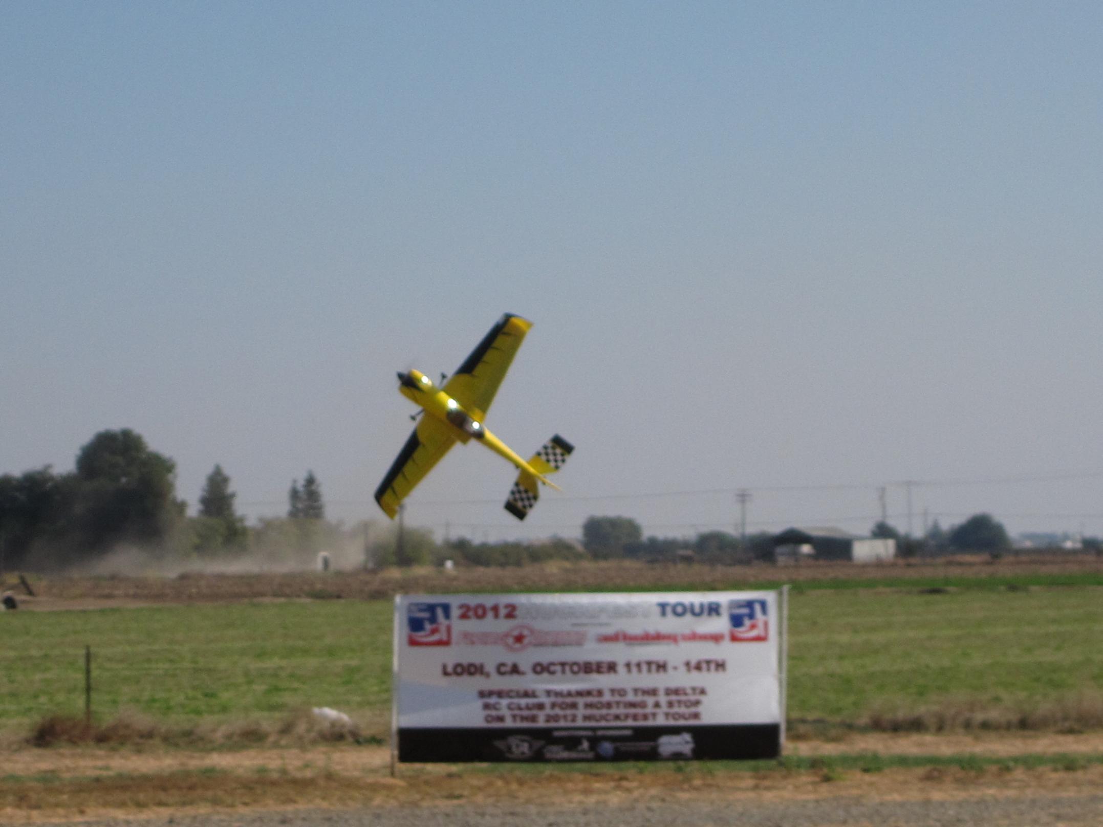

Man i can't wait to take this thing to Lodi Huckfest :flyer:
