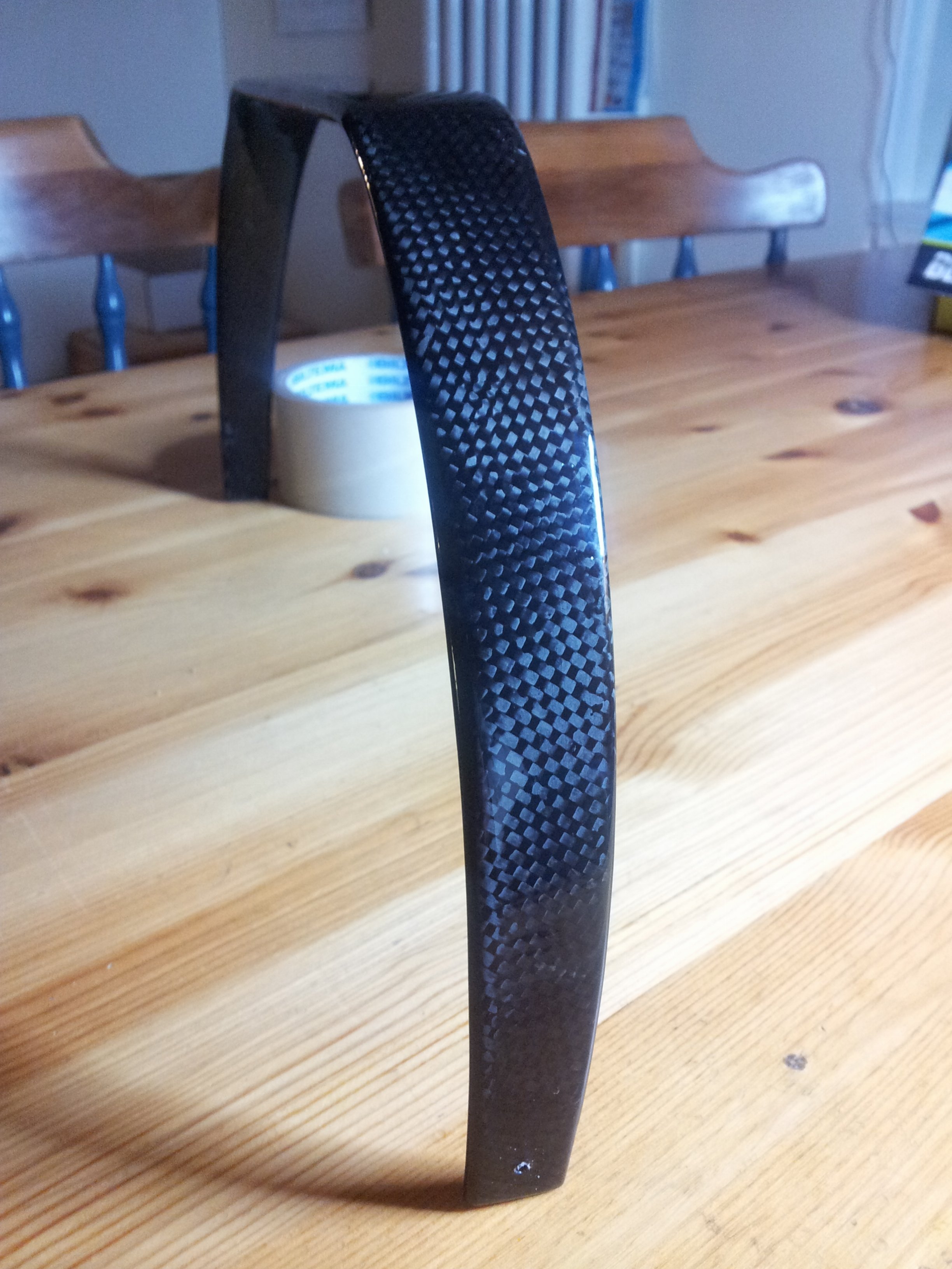

I made me a carbon fiber landingear, it came out pretty nice i think, 100 gr, and stiffer than the aluminum one:D, we´ll see how it holds up.
Yes i know, the Picture is the wrong way, but you get the idea.;)

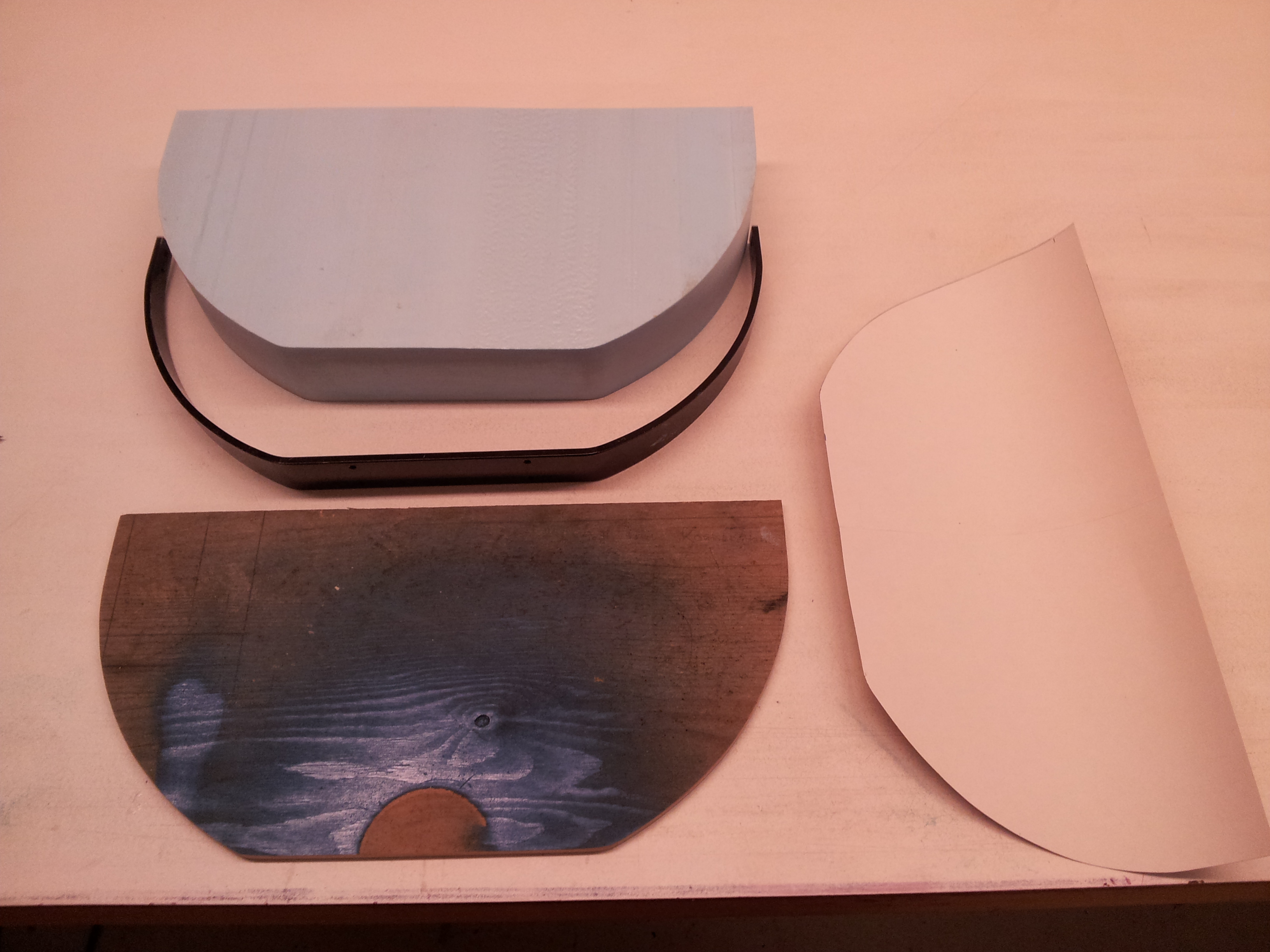

Of course i vill share, its not that hard.
I started with making a plywood template, shaped as the landingear.
Used that to cut a foam block, than you have to cut it so it vill be 30mm at the top (where i mounts to the fuselage) and like 15mm at bottom.
