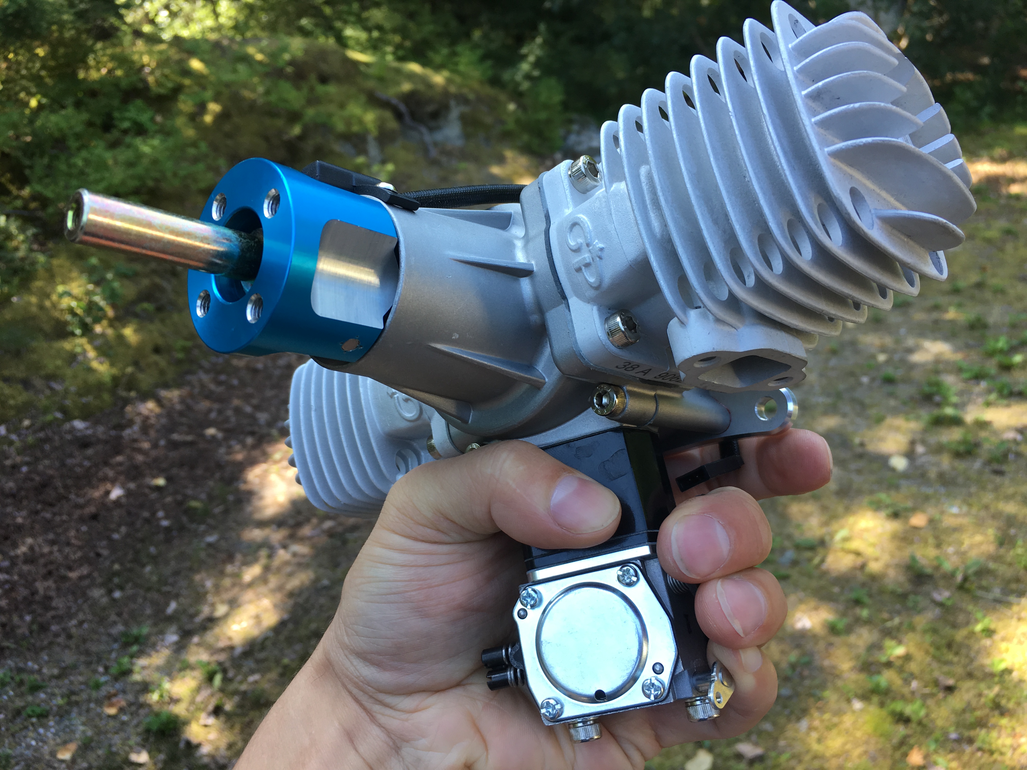

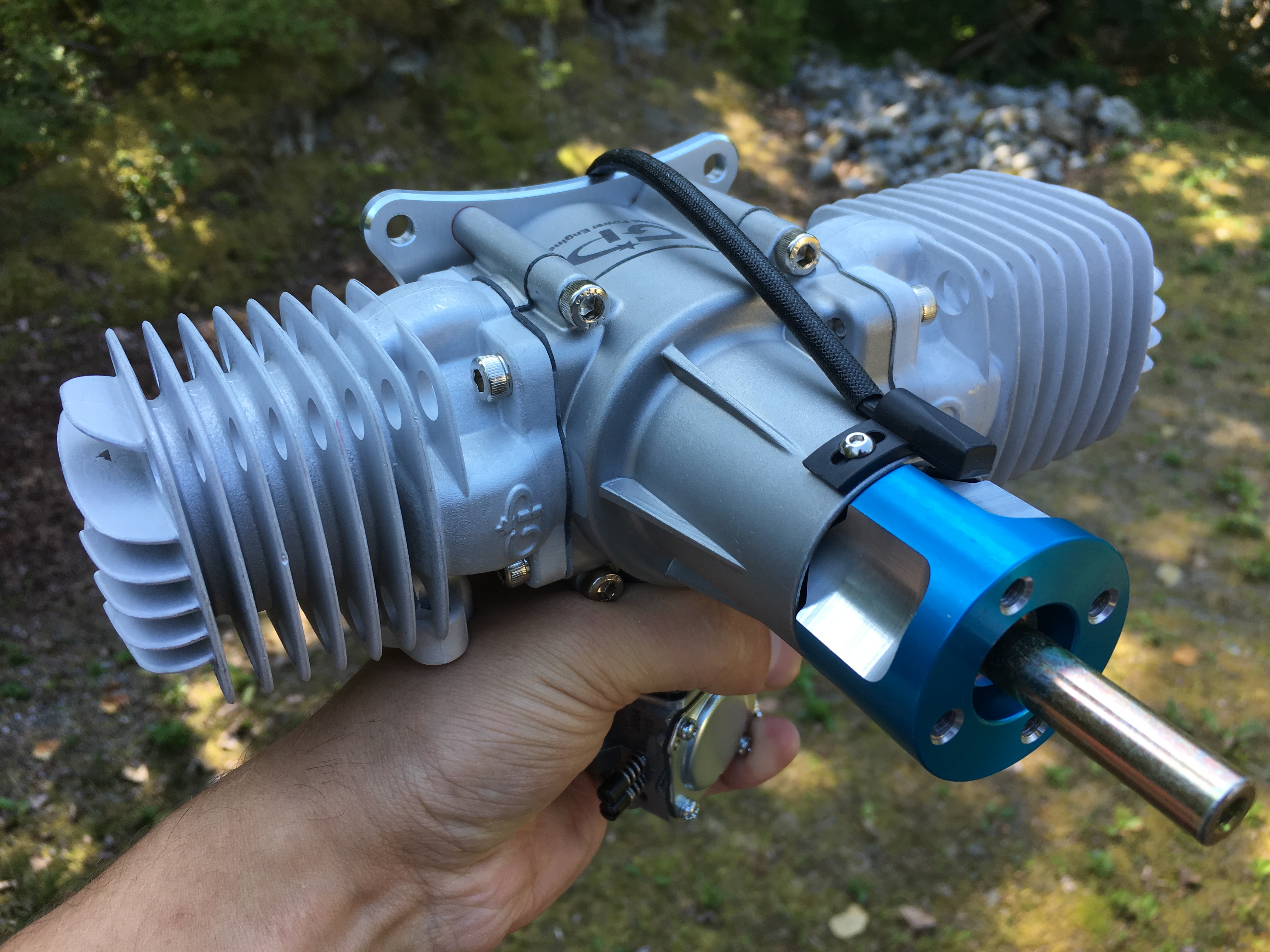

Time to talk about the powerplant! GP76 !!

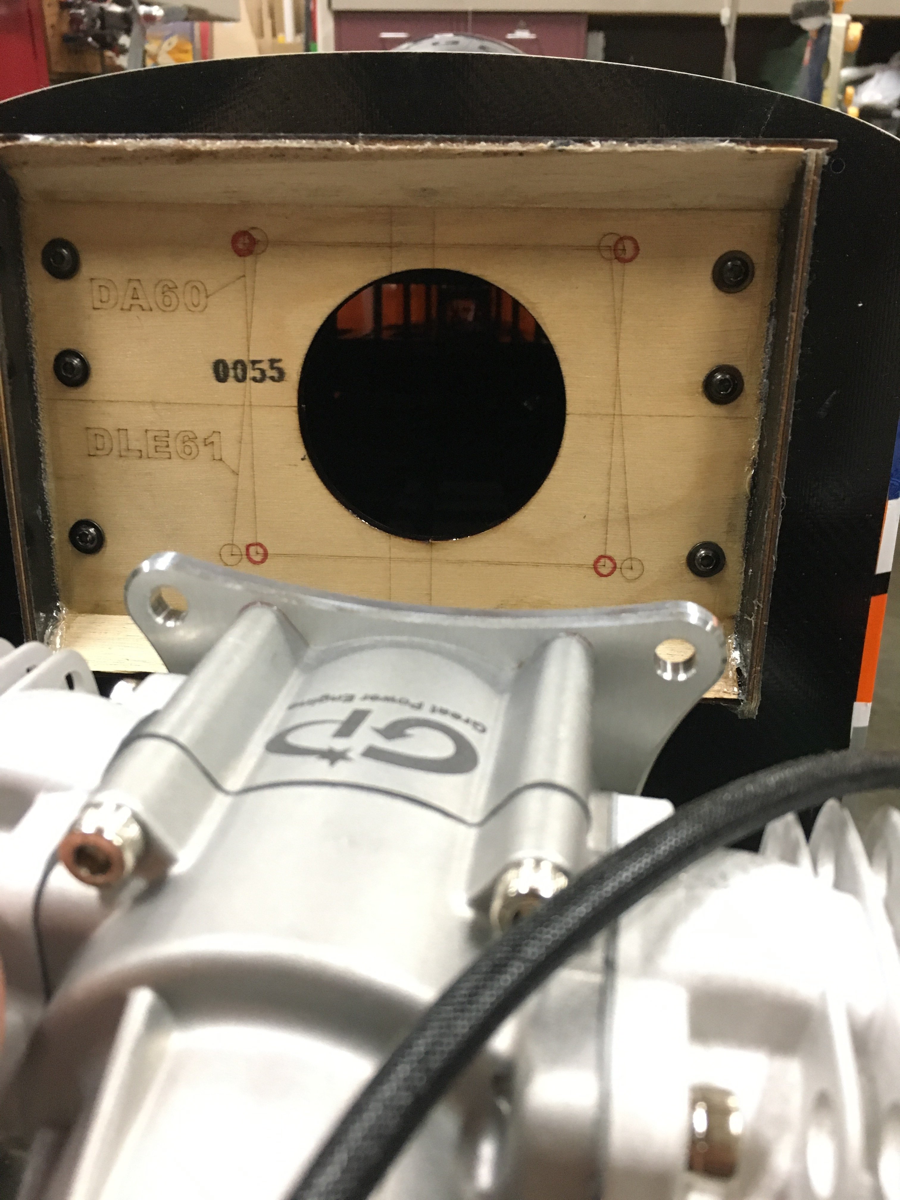

Same bolt pattern as the DA60 which is marked on the firewall for drilling which is a bonus. Very excited to try out this twin!
Marked the DA-60 holes. I’ll need to check my standoffs for prop clearance. Appears to be 7” firewall to spinner backplate.

Looks like nice engine is it your first from this manufacturer. Twins are always much nicer to work with smooth and they just sound better.

Sounds like the DA60 Blazing star mount will be the correct length for the GP standoff. I’ll have to be sure before I spend the cash on it. I think it’s only 1” and I need more than that I’m pretty sure.

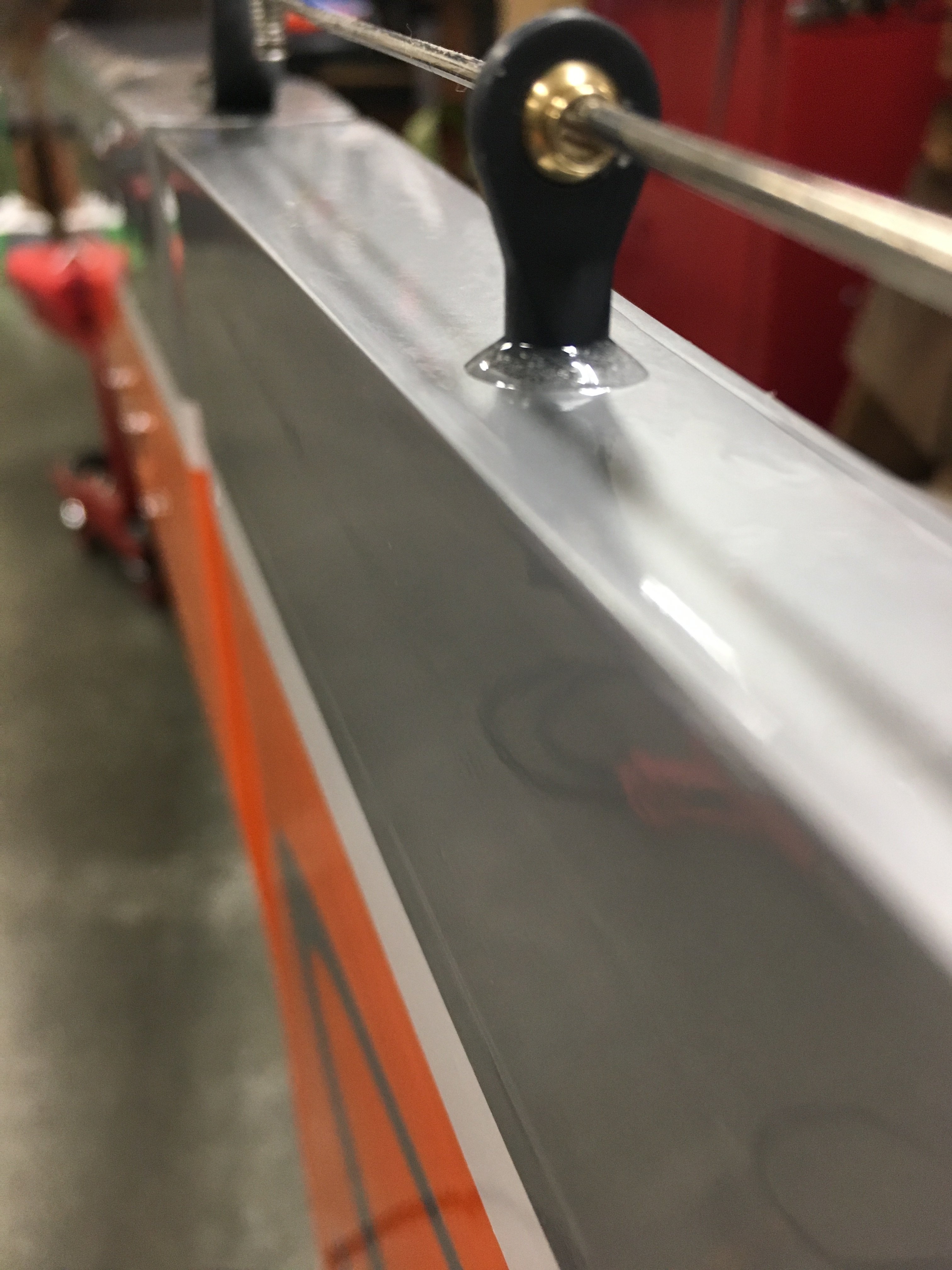

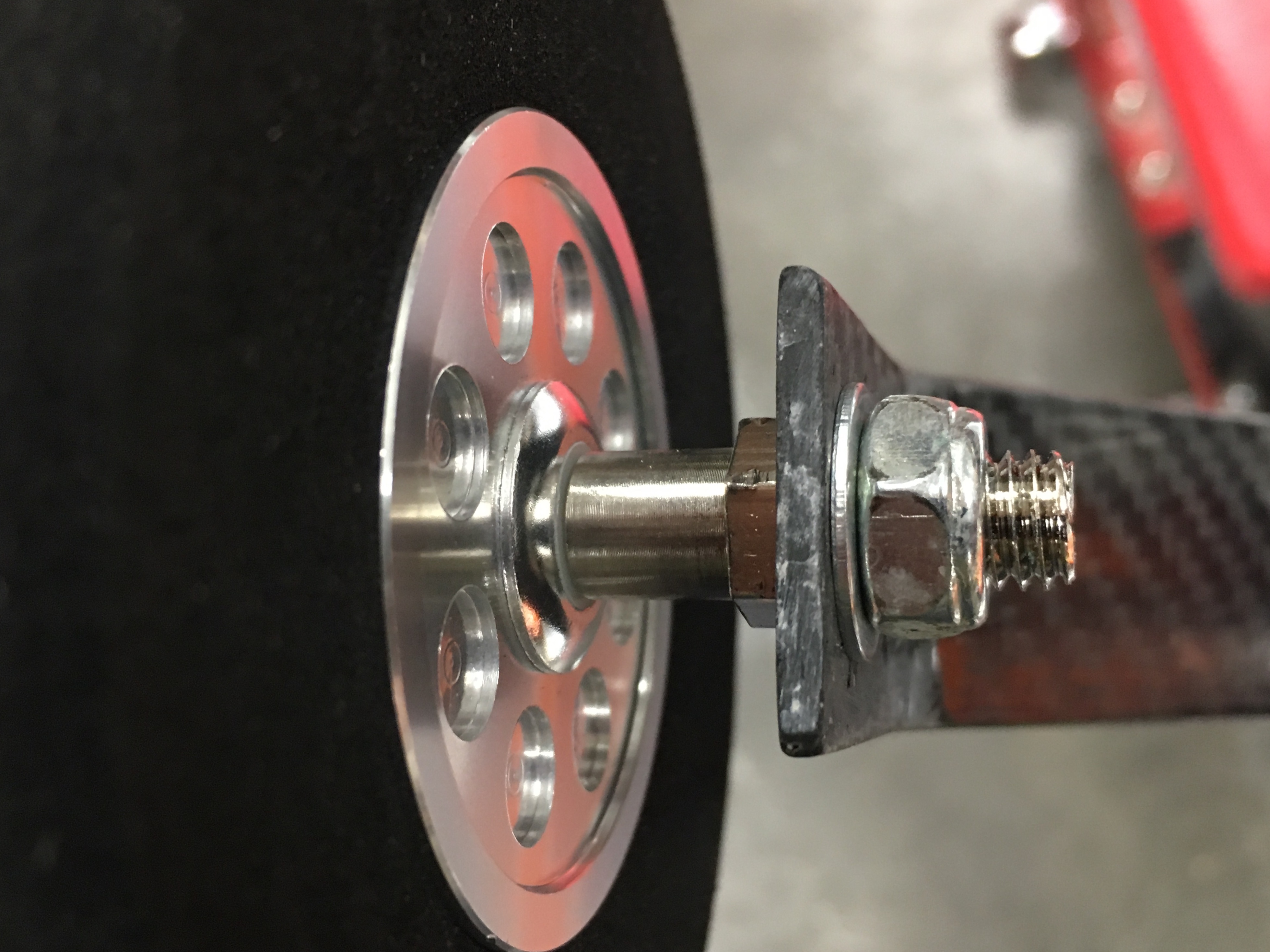

Finished up my tail wheel. I lied about the last of the epoxy ha ha. Just a dab O.K.!!!

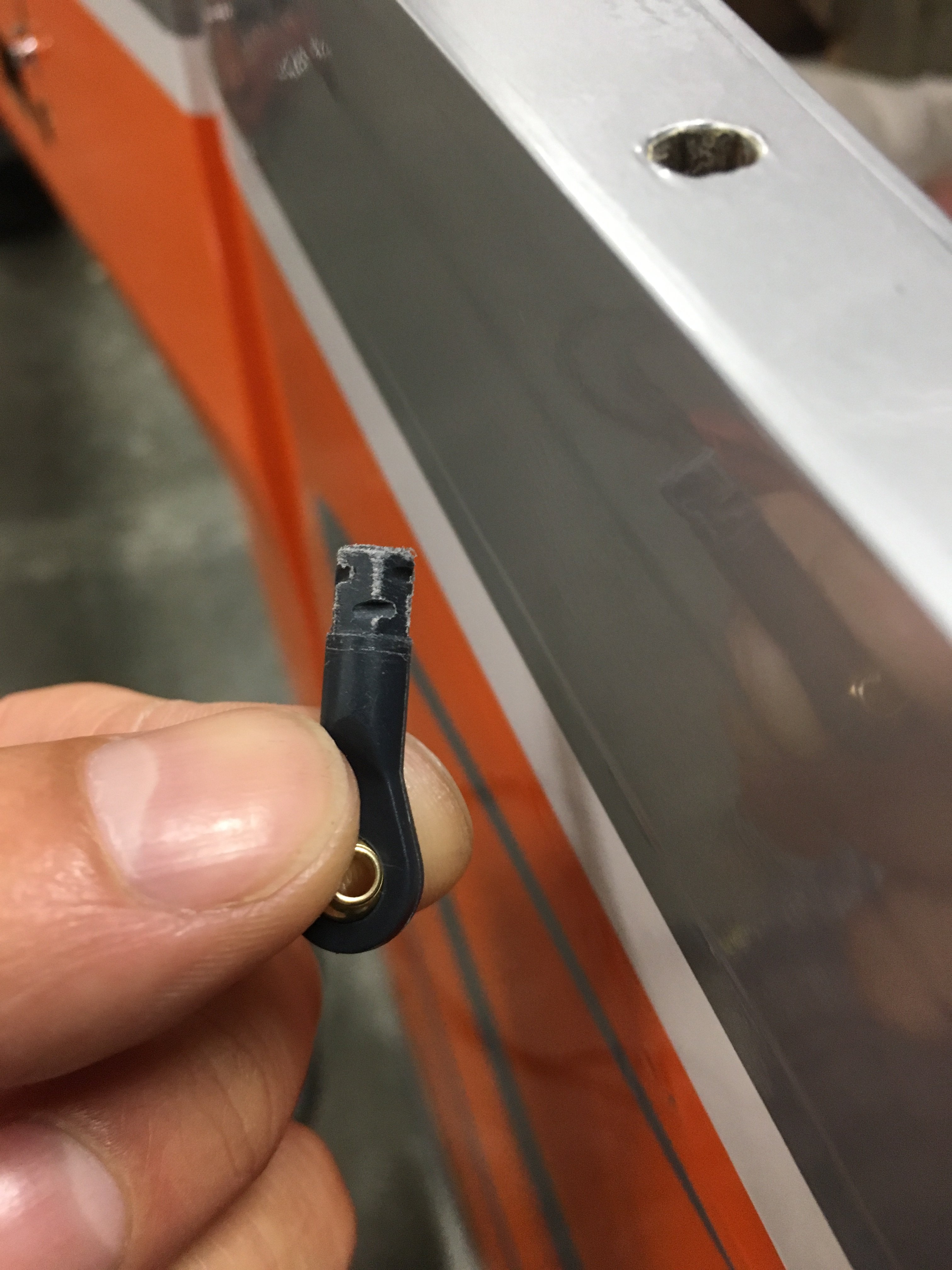

Scuffed up and made a few notches for the epoxy to bite into. The hole shape matches the flats on the ball link... clever. It is bottomless so excess epoxy will fall into the void FYI.

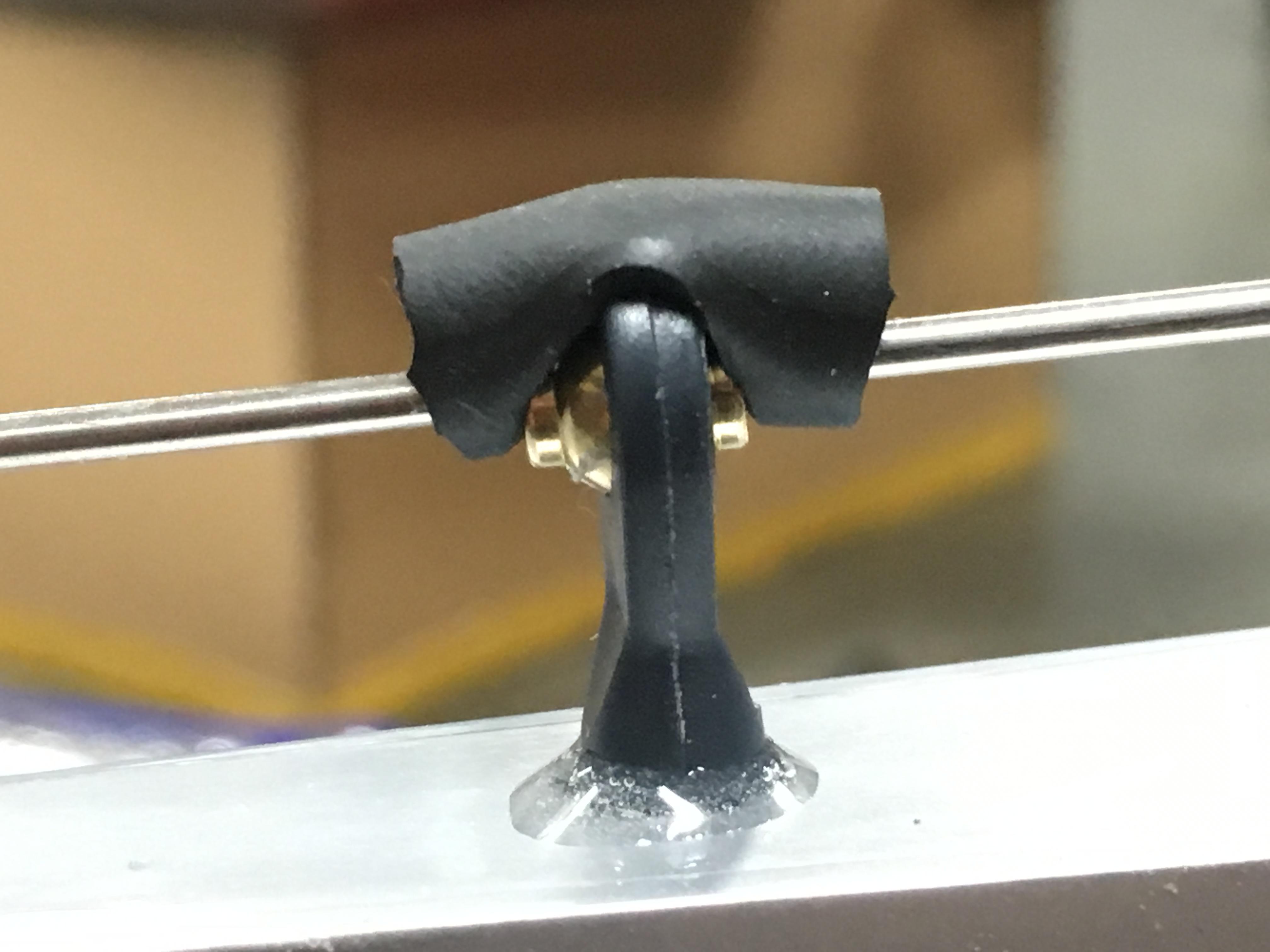

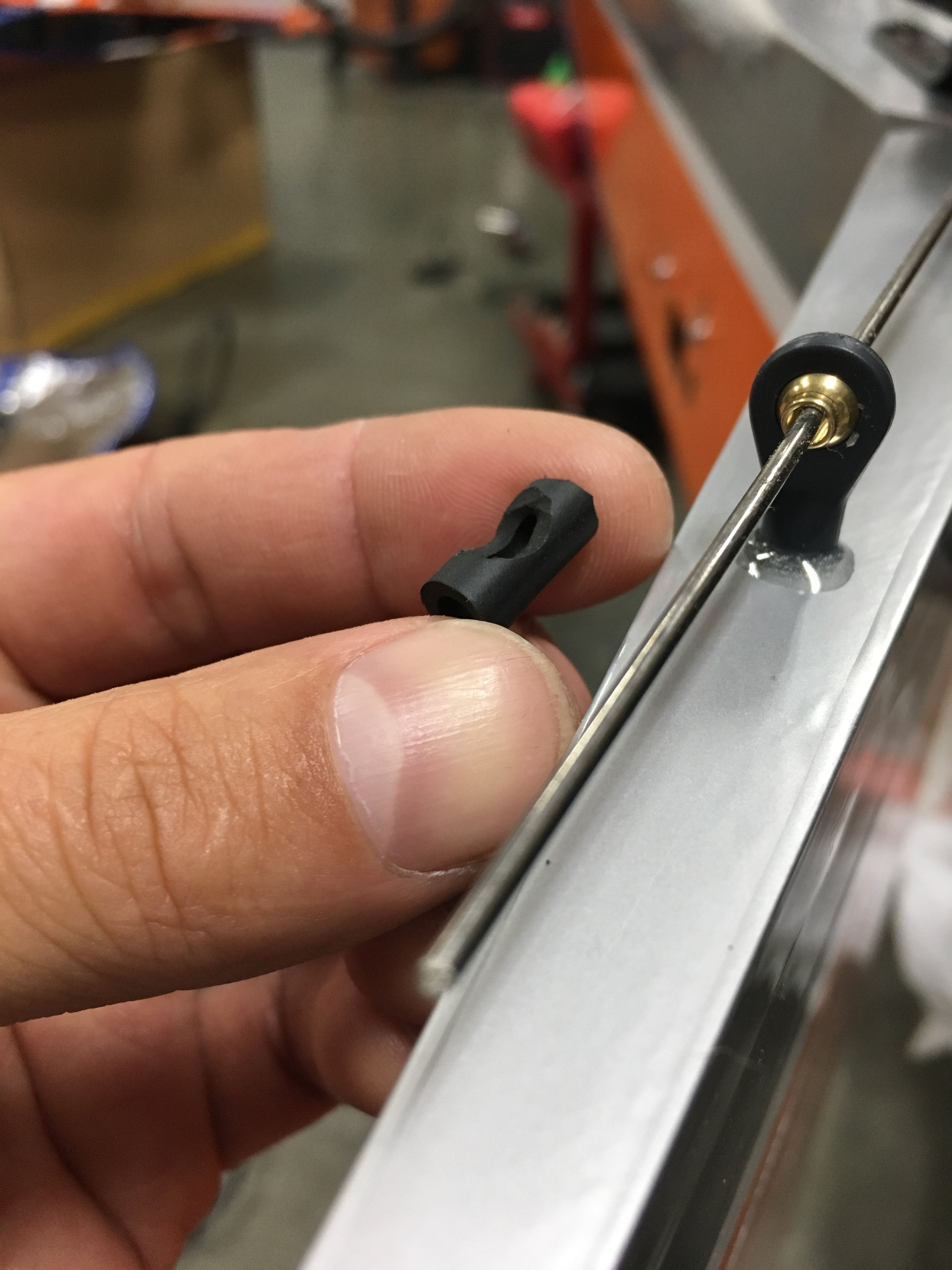

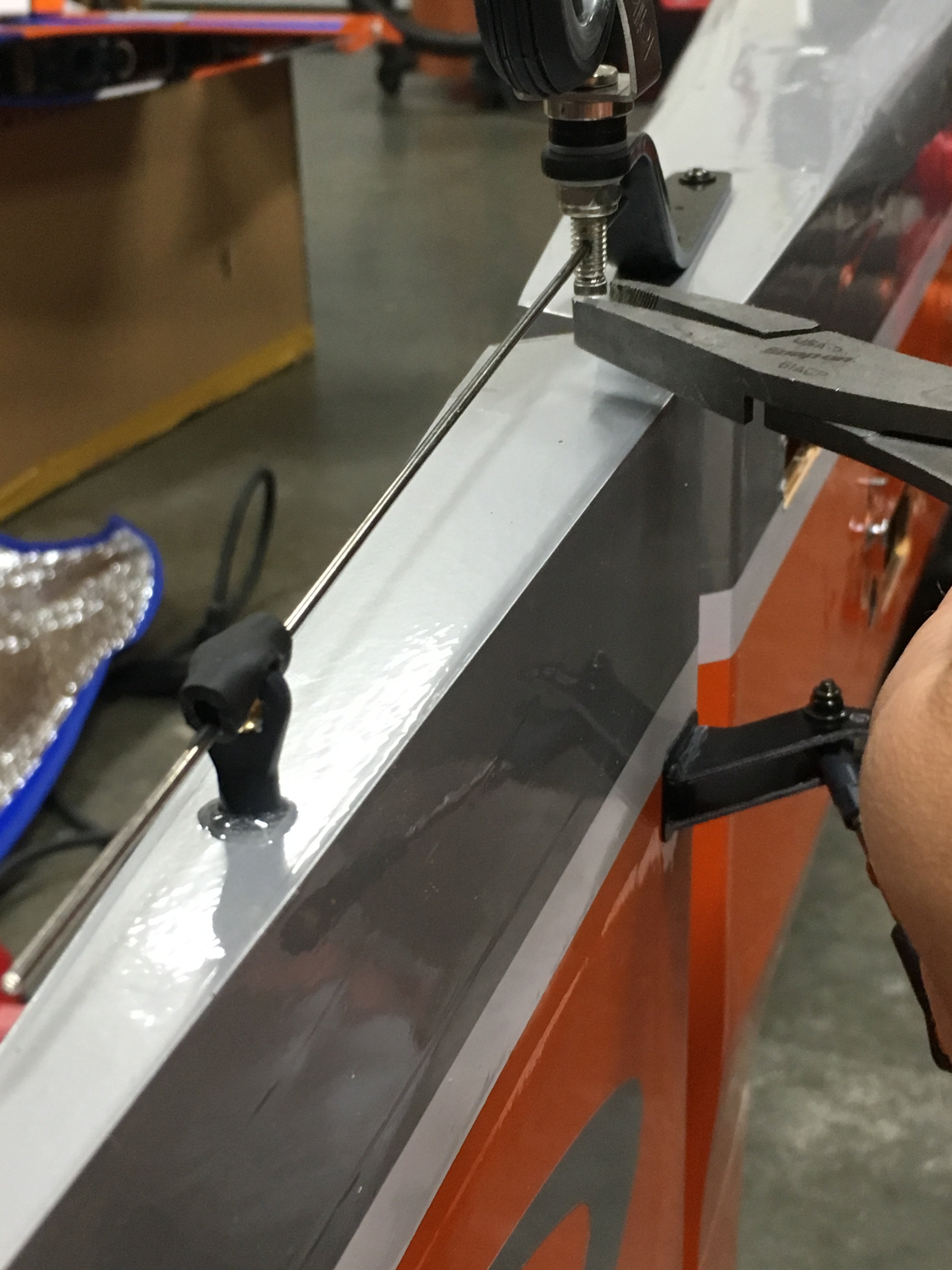

I’ve been trying a little trick out I’ve developed. Cut a piece of fuel tubing and slide it over the ball link to keep it from vibrating around like this:
There isn’t any room for an Allen key to tighten the screw, so either do this before or use pliers like I did.
It’s my first GP, and other than the baby RCGF21T it’s my first real twin. It’s also my first 70cc. Until the Timber I have never owned anything over 35cc.

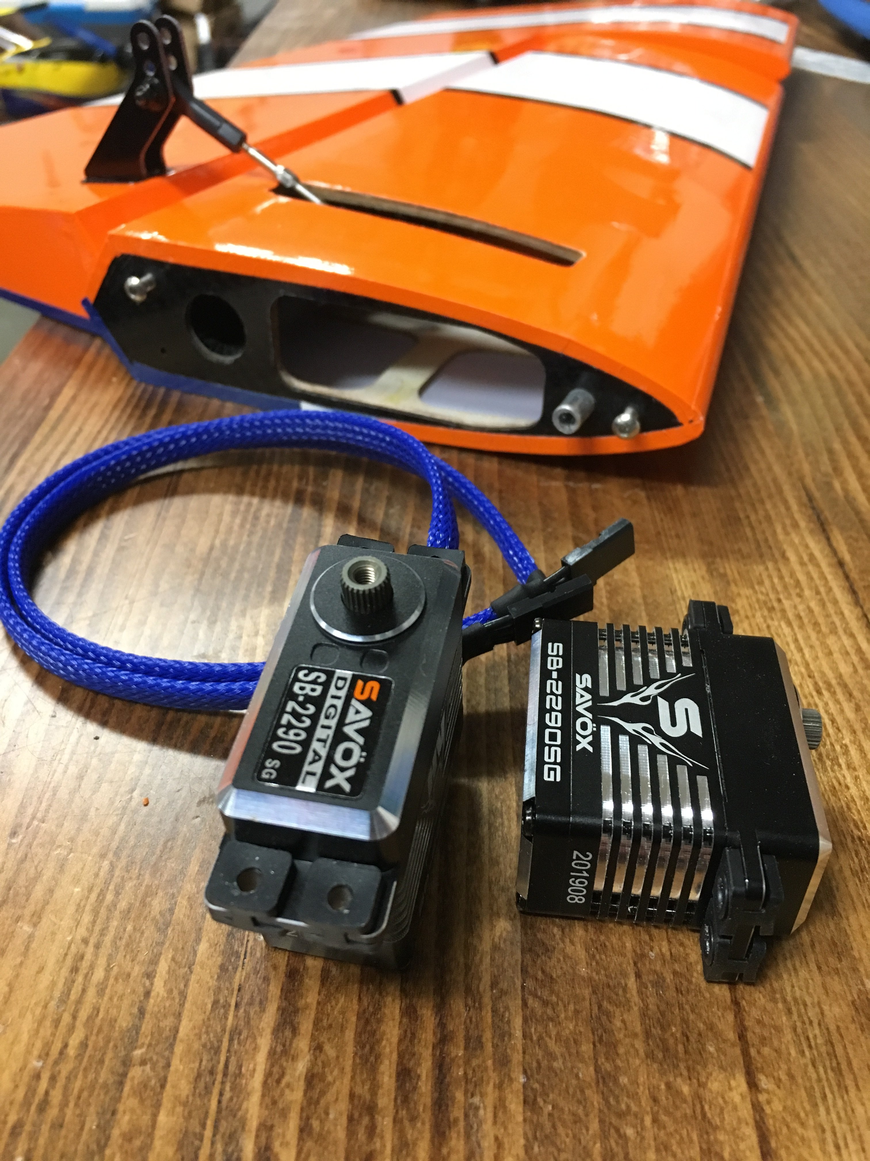

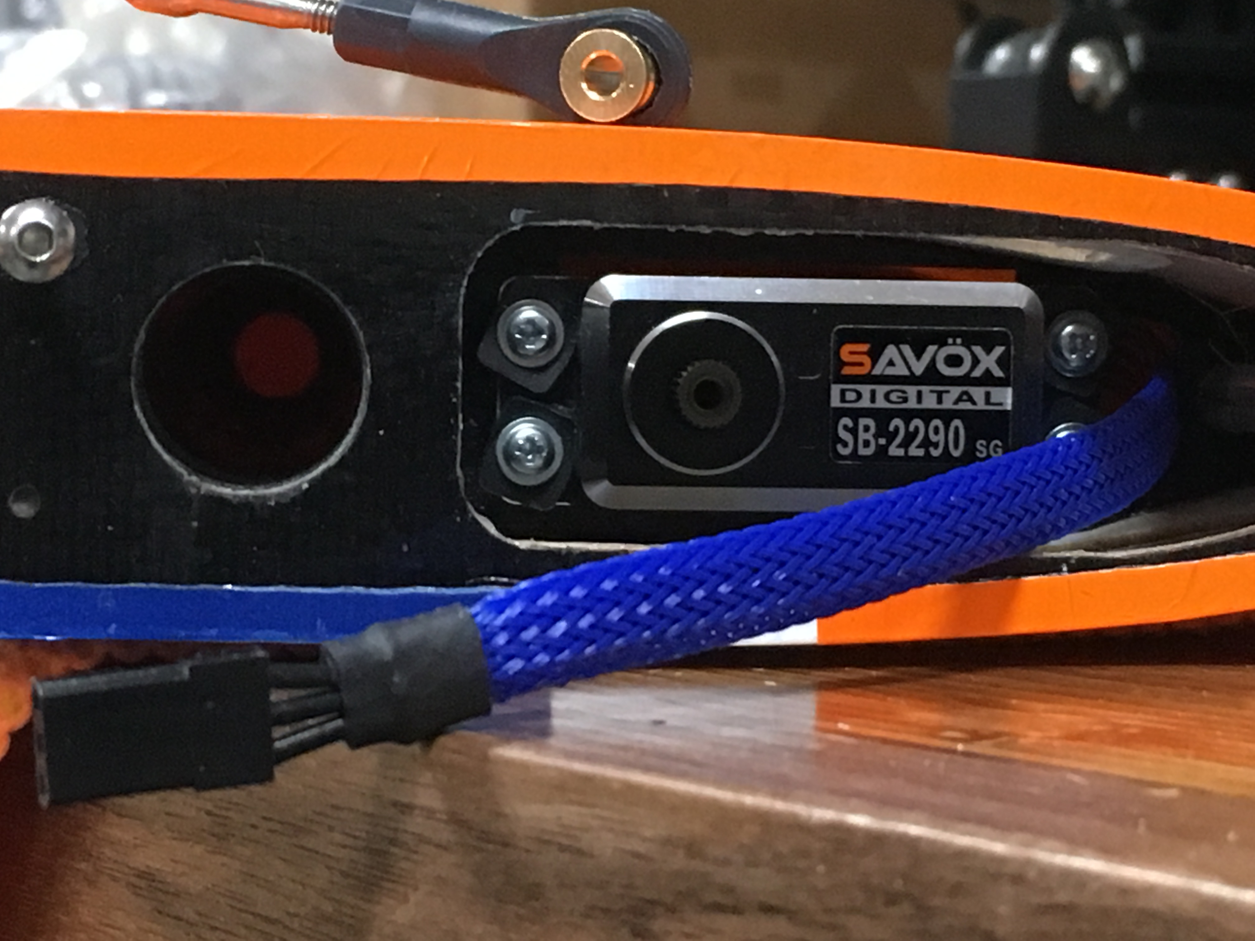

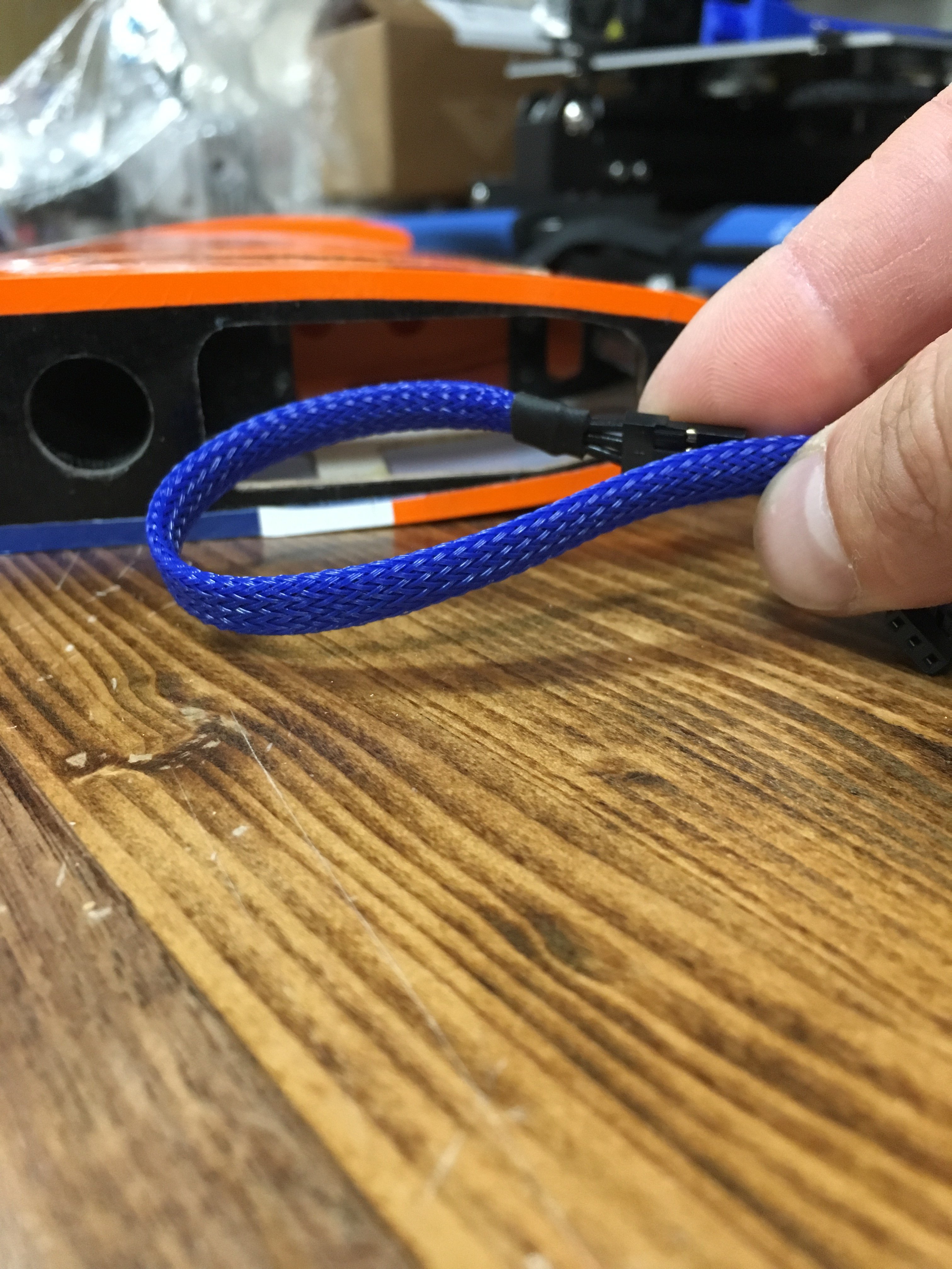

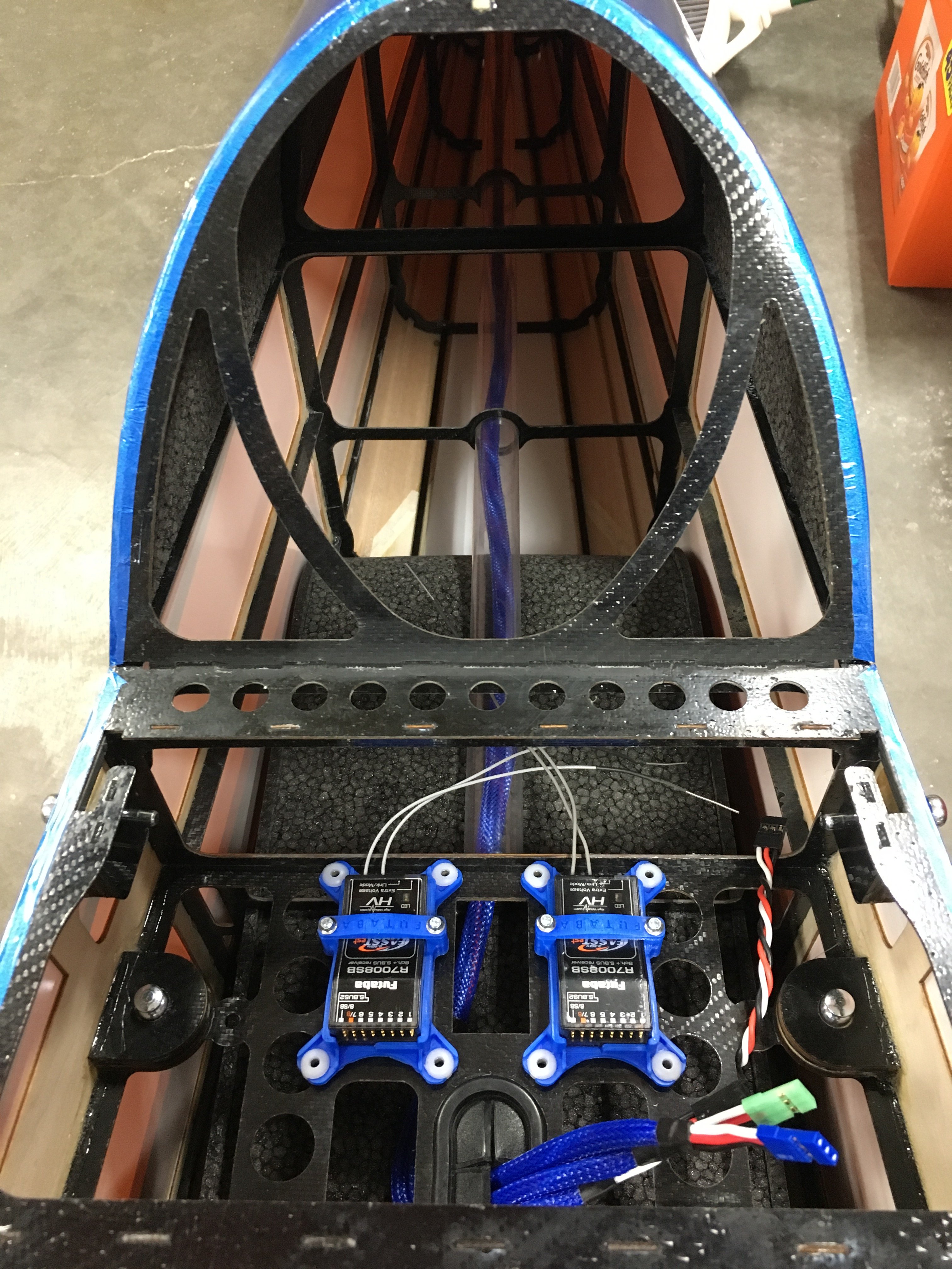

Put some snakeskin looming on the elevator servos and screwed them in place. The looming is from TDRC... if you haven’t heard they are closing
I’m running out of 1/4” heat shrink tubing with adhesive... need to go to the store and try and find some more... meanwhile an order online is coming.
AKNick

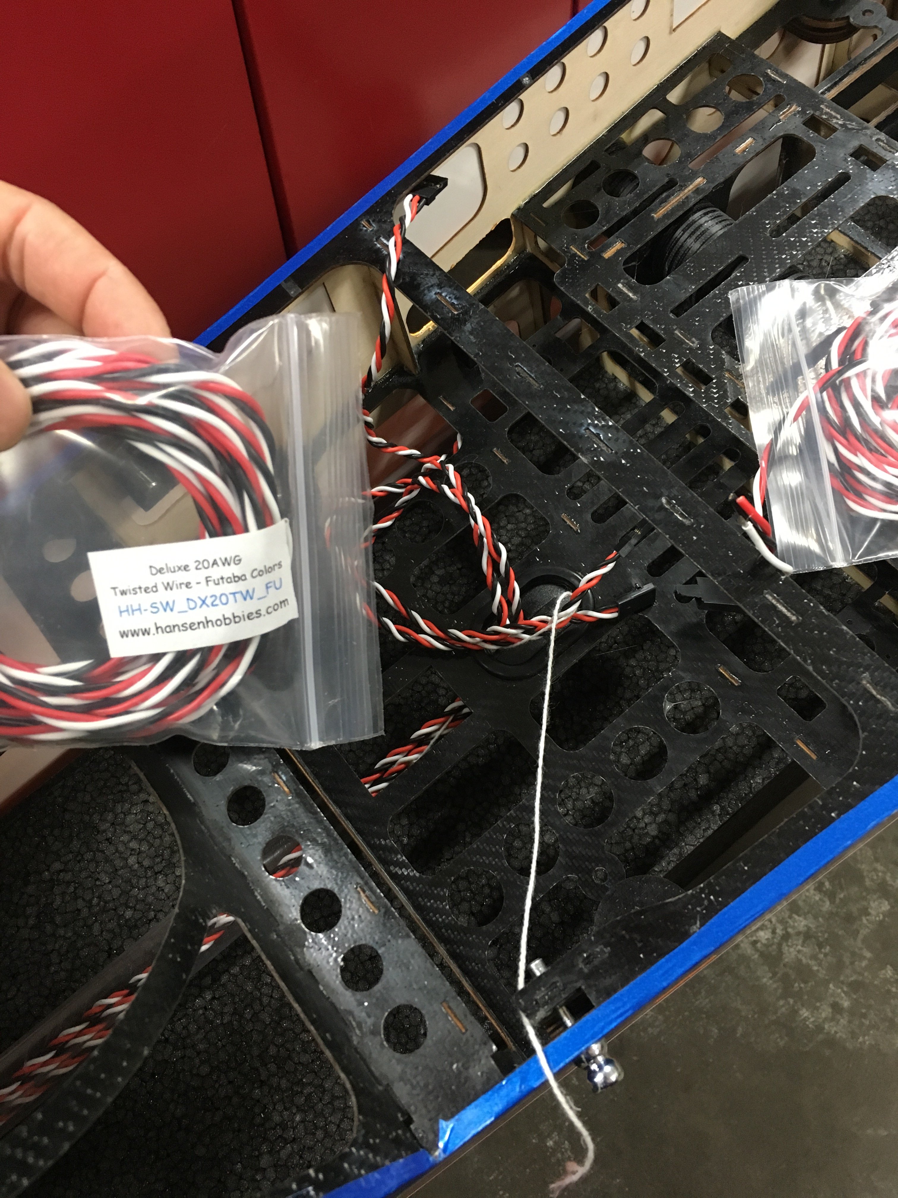

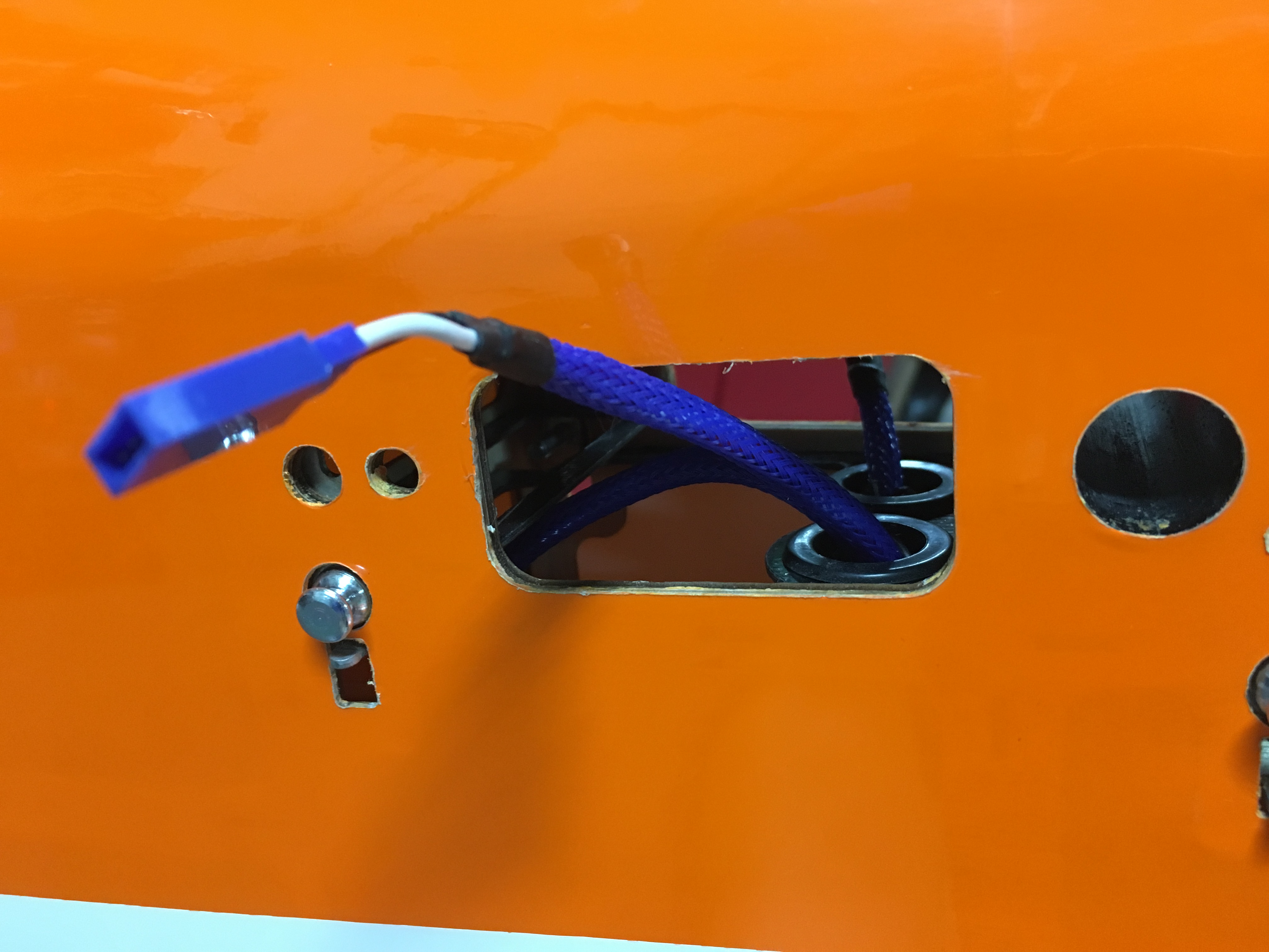

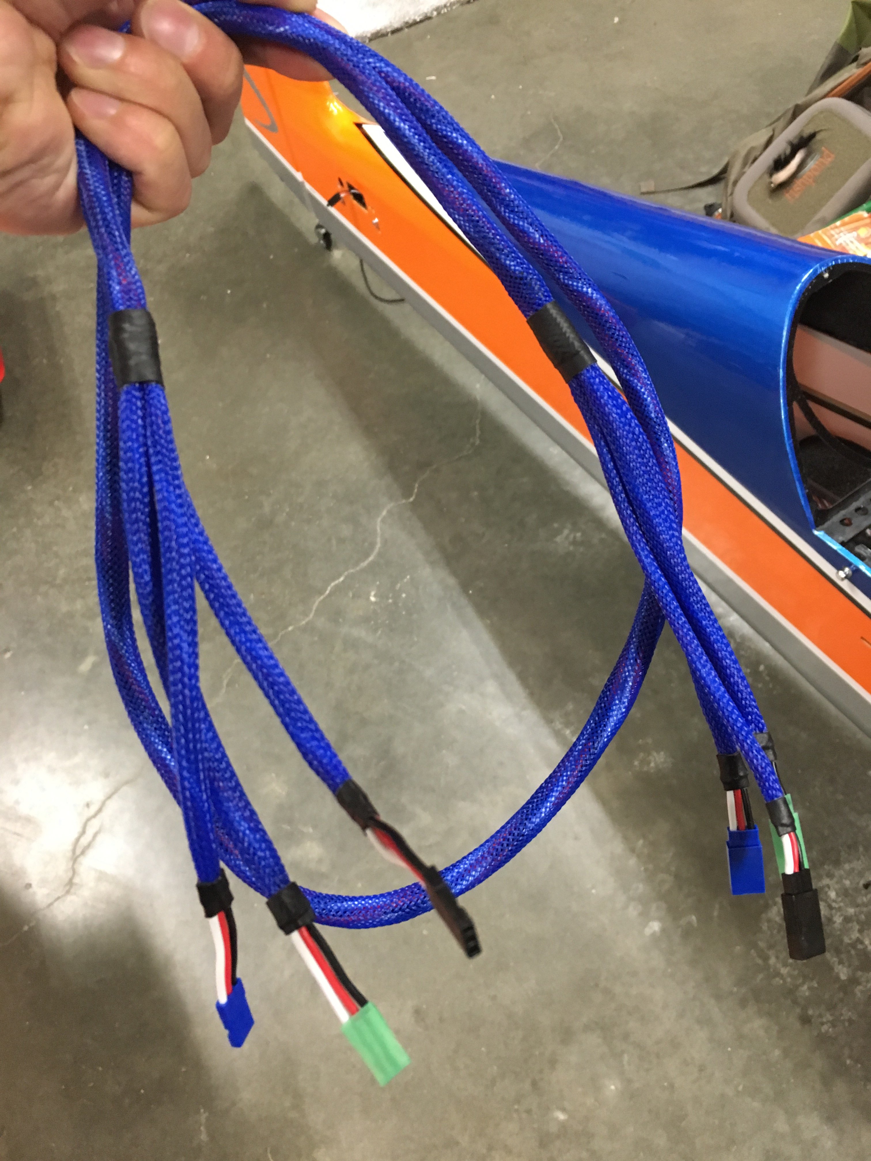

Something about long runs of wire to the tail and 22AWG just bugged me. So 20AWG from Hanson hobbies to the rescue. I’m crazy... I know. Brushless servos are very efficient. But it made my mind rest easy for some silly reason...
so BEHOLD!! Hours of measuring, crimping, heat shrinking and routing presents....The geeky blue trifecta wire color coded luminous extraordinaire!

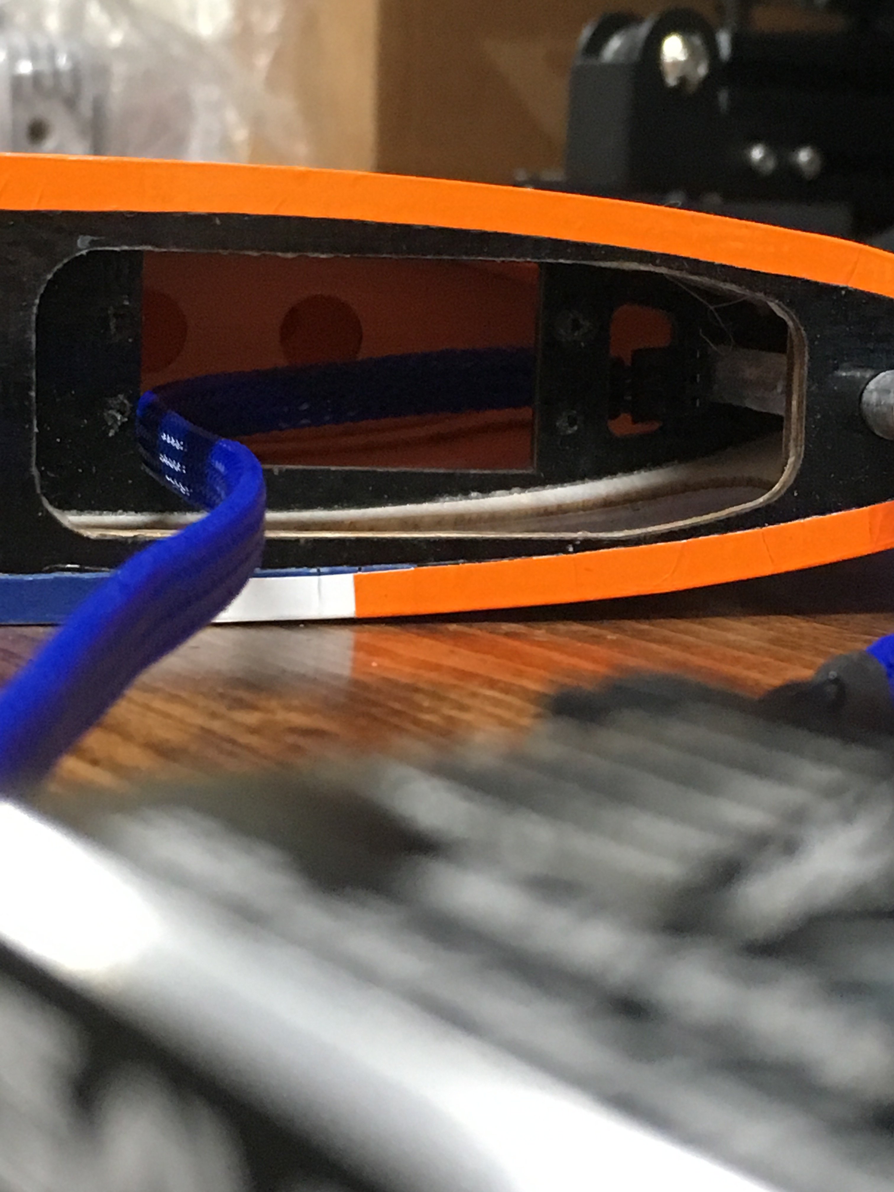

Check out these grommets in the tail. Saweet!!!!
