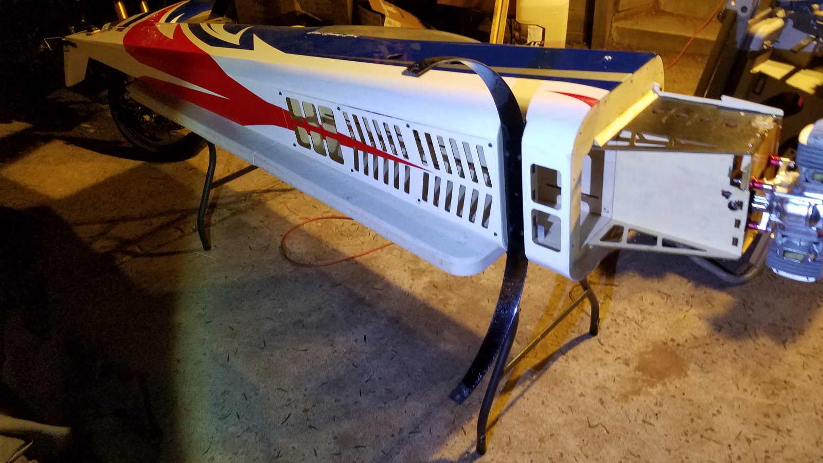

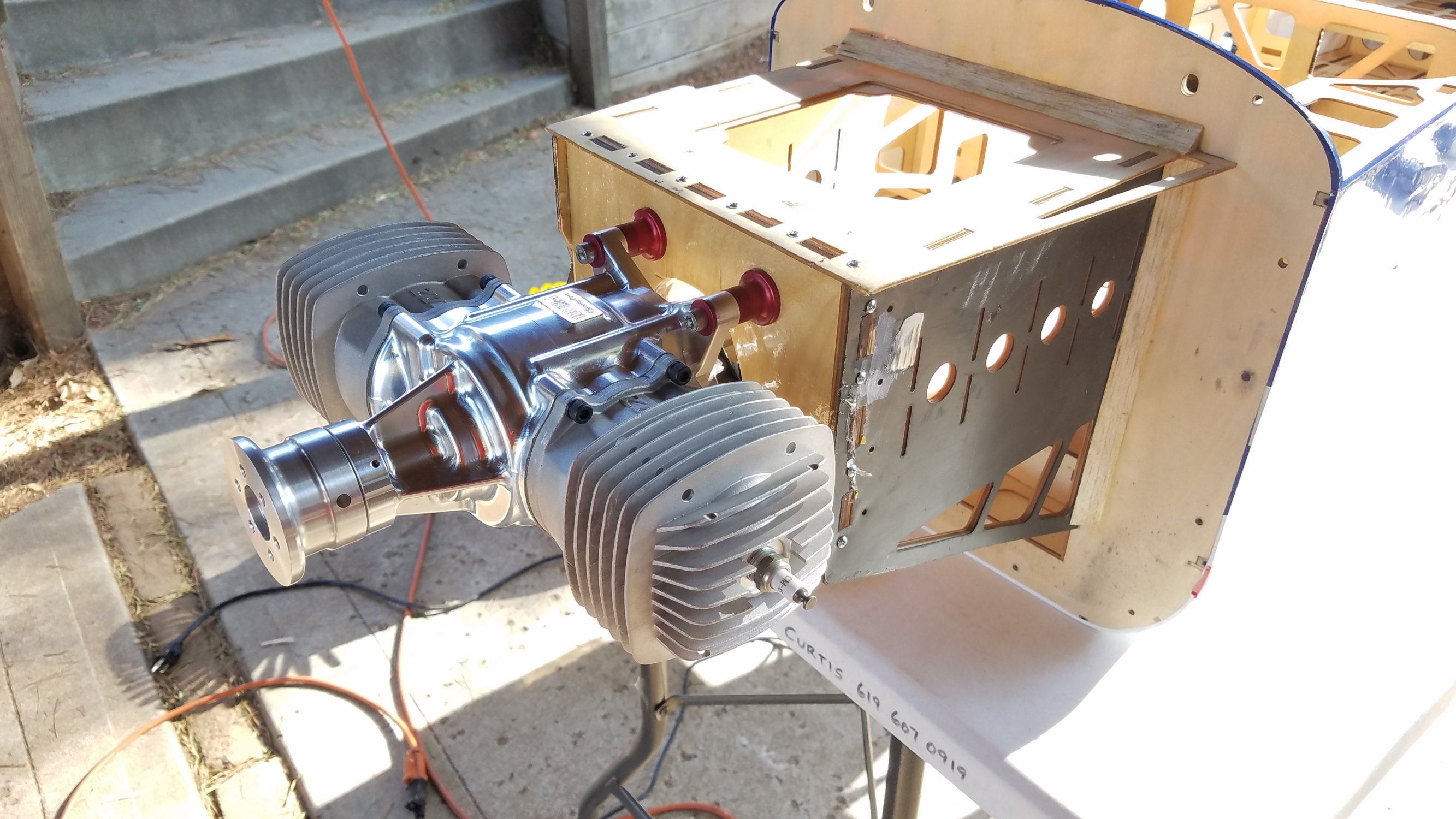

Well, I had a gnarly headache most of the day yesterday. As soon as it started to clear, I was out of bed and went to work on the Extra. First thing I needed to do was fill the hole where the DA200 mufflers poked through, then glue a new sheet of 1/8" ply over the front to help reinforce what is already there.
Needed some longer mounting bolts since I bought ones that were about 1/2" too short- somehow I managed to cross thread the nut onto the bolt (after it was half way onto the bolt already :oblong::confused:) and wound up having to break the bolt to get it off. Luckily I had another bolt in my bins that fit right in after some trimming. I also screw'd the firewall to help strengthen it. I feel confident this firewall can handle anything I can throw at it :)

Next up is peeling the junior stickers off of the wings and then figuring out how to best patch up the holes in the cowl (I can tell they will be nowhere near what I will need for the ZDZ mufflers).

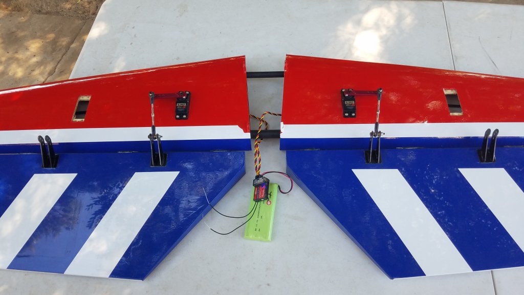

Both wings have servos, went with HS-7980TH's in them since that's what the pockets were cut for. The rudder gets HS-M7990THs because we are out of stock of 7980's :oblong:

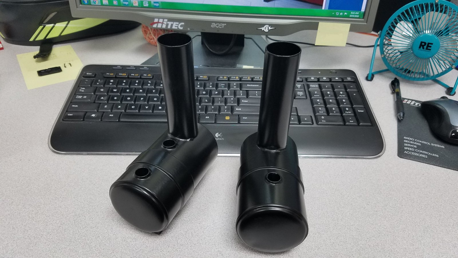

I have batteries, propeller, mufflers, and rudder servo arms now, just need a few little odds and ends. Waiting on the landing gear as well.

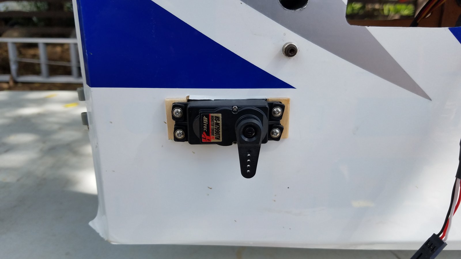

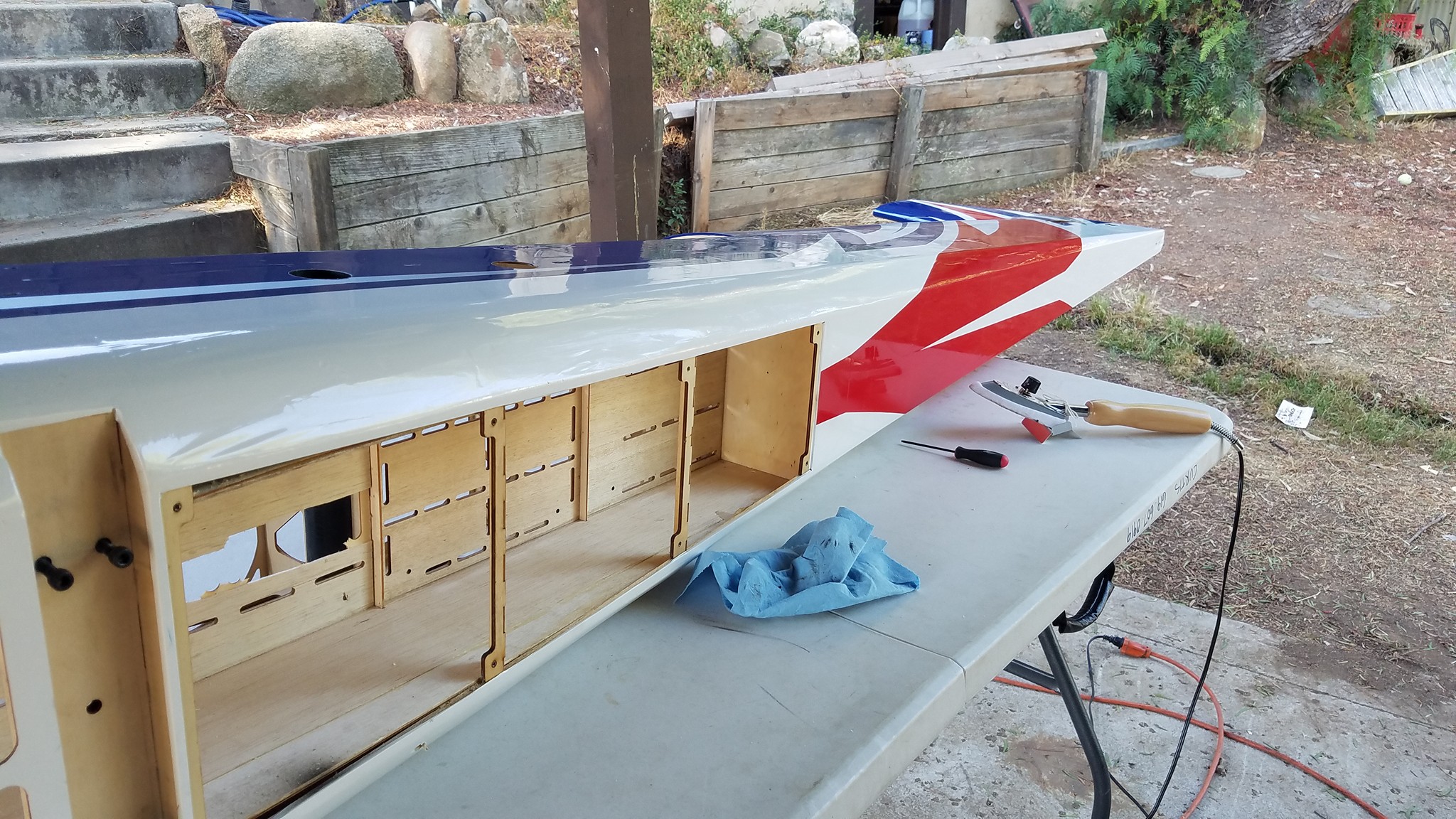

Since the 7980 case is larger than a standard size servo I had to make some 1/8" ply rails for the servos on each side to sit atop so they would not contact each other inside. I did also glue some 1/8" rails inside of the fuselage so I could really give the servo screws something solid to bite into (essentially clamping to the fuselage). Looks as though there were standard size servos back here which have a different hole pattern, thus the plywood inside the fuselage as well (the hole patterns were close, but not close enough).

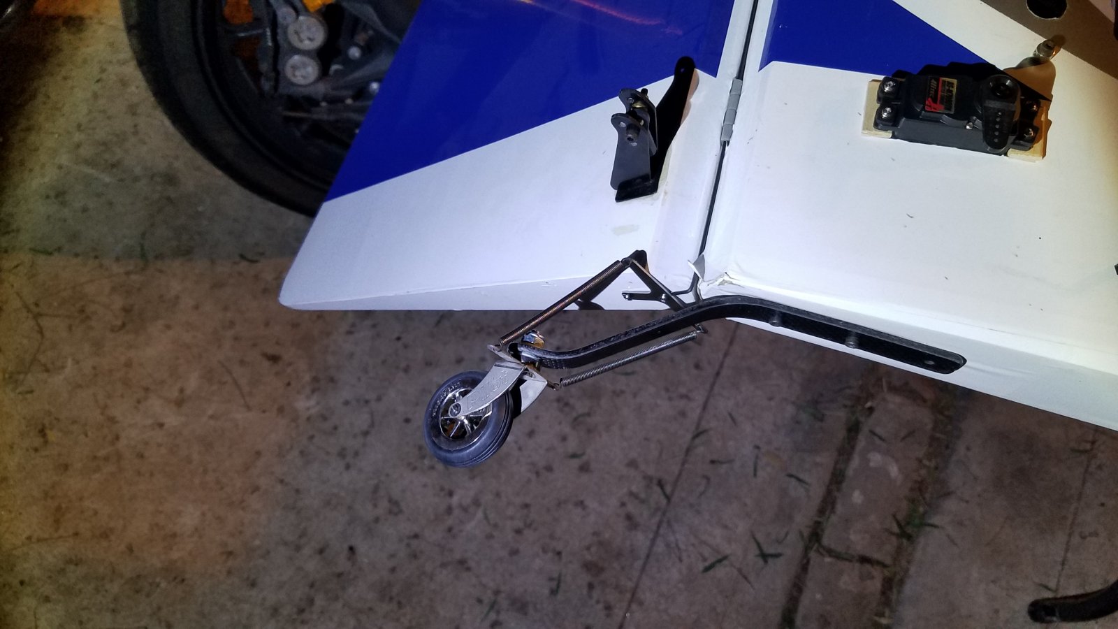

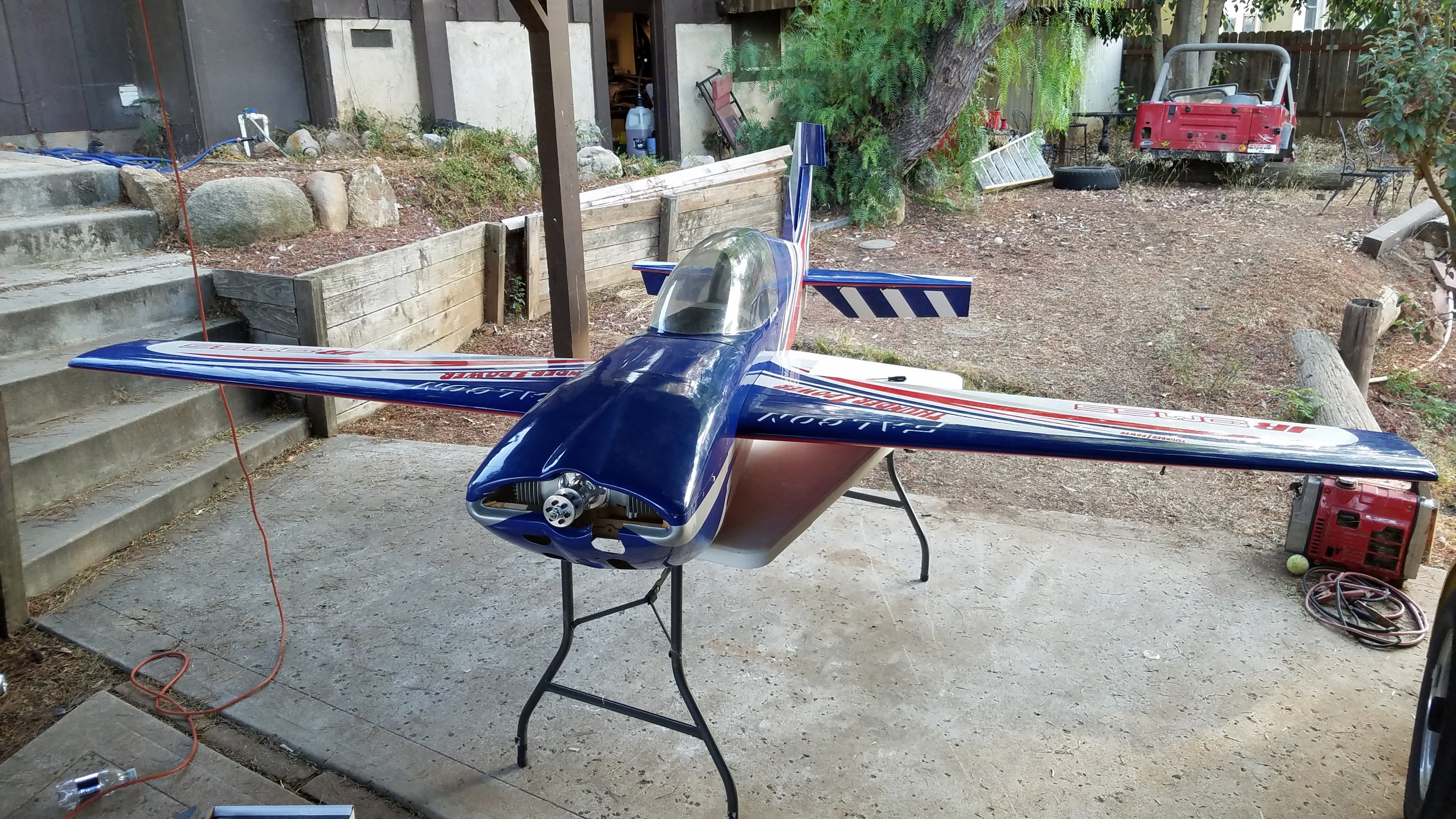

Life has been busy as of late!!! Looks like I should have everything I'll need to finish this thing this week, just waiting for it all to come in the mail.

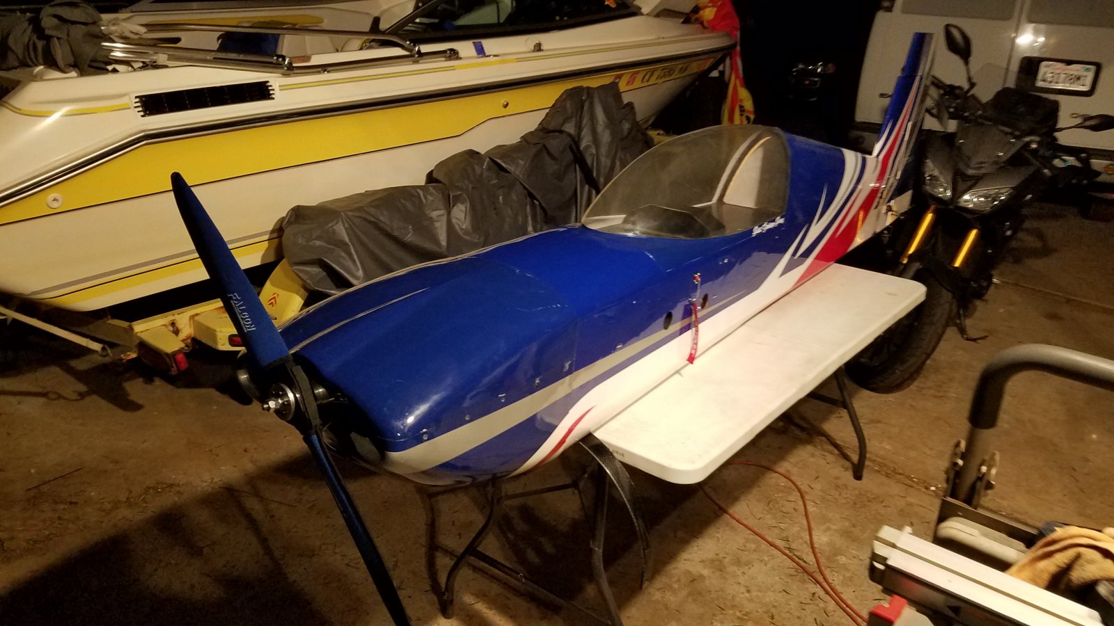

Last night I bolted up the main gear (waiting on wheels and axles), tailgear, and slapped the cowl on to appreciate my hard work.
