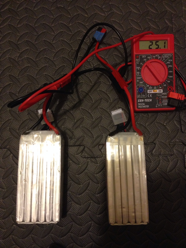

NJSwede is correct. You hook the watt meter up in line with one of the batts. Read the amps. It will show half the watts since it is only showing the voltage out of the one batt. The amps will be equal in both batts. I did this in my 12S setup.

I would do this on the low side which is the one with the negative to the ESC. When is doubt, get out the volt meter so you don't fry something. I remember something Shawn Spiker said about hooking up a Optima RX in a 12s setup about this.

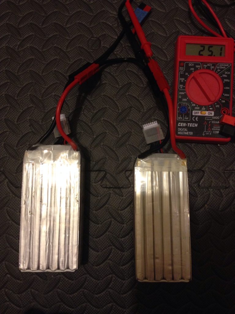

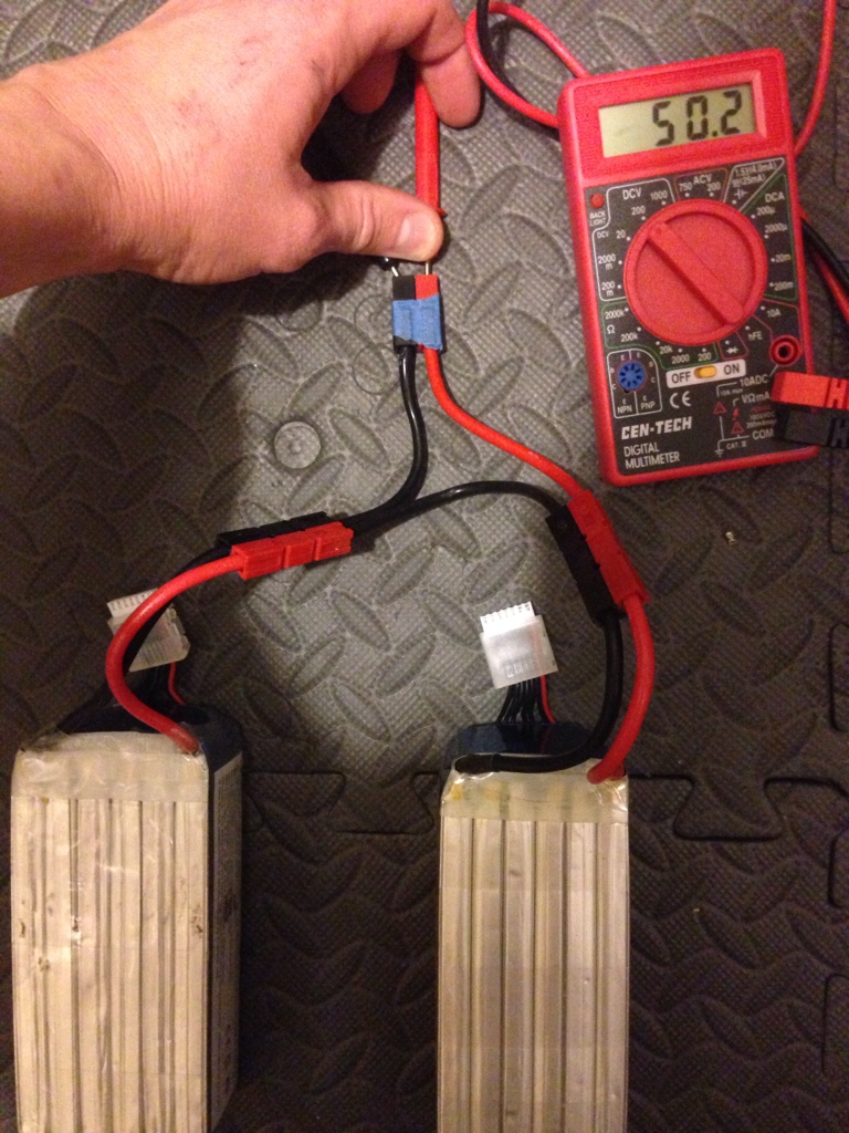

Volt meter to test that you have 25V Instead of 50V as that will fry most watt meters. I got out my old harness and tested. Both sides are 25v at the battery.

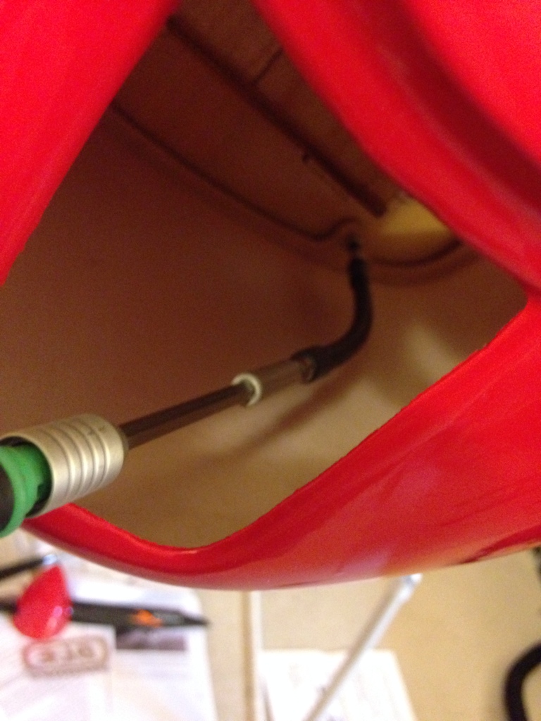

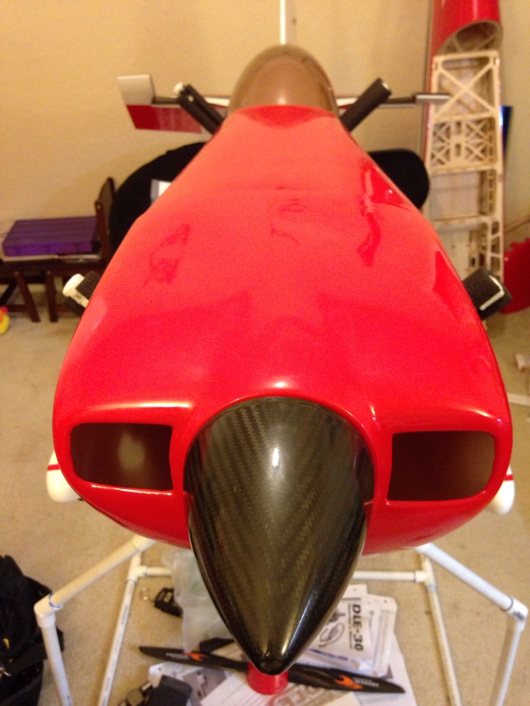

Getting to the inside/lower m3 socket head bolts for attaching the cowling is a little tricky, but nothing a flexible driver extension can't handle!

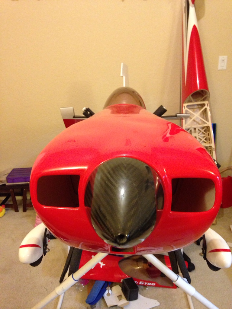

All ready for a prop and a maiden!
I'll I'll the bushing and cut the spinner soon. She sure looks sleek and fast!
The cowling bolt tells me just say no to a twin in this plane. No way you would get the flex driver in there without a special cutout for it.

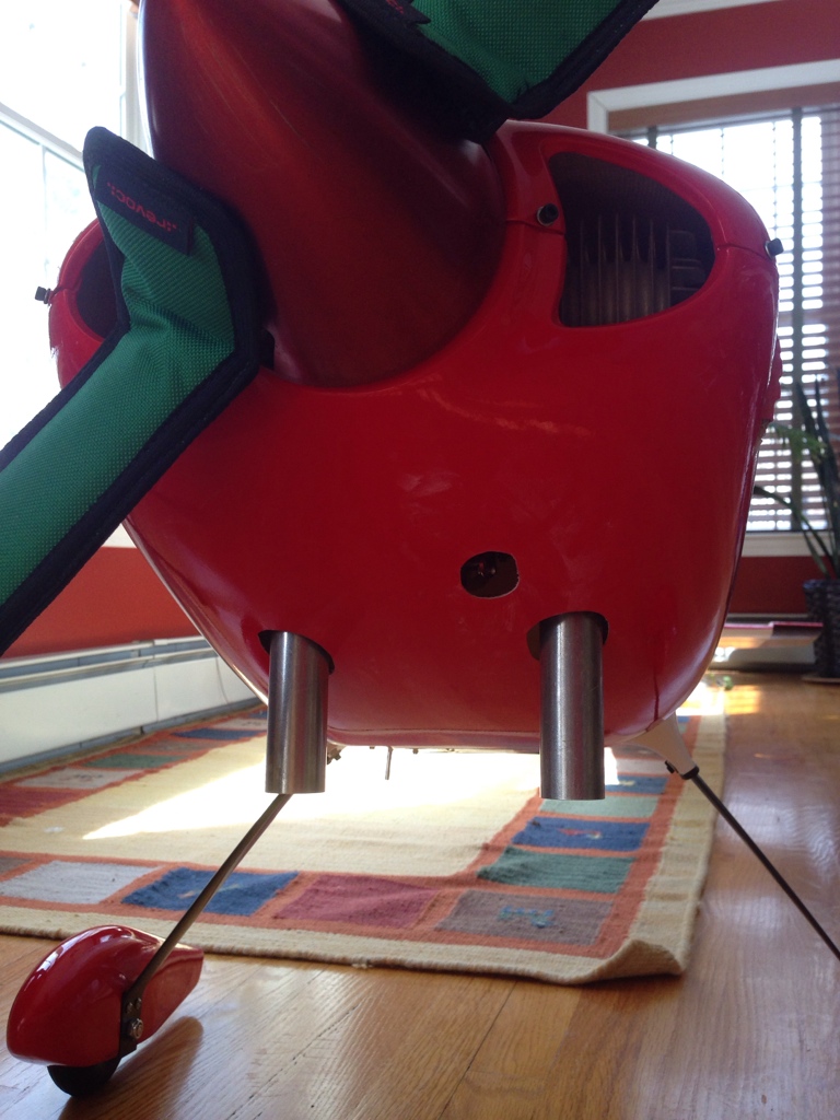

On a twin, there are slots in the cowl for the muffler output that could/should be long enough to use the flex driver.
Also the air inlet on the front of the cowl might work for that, or a cooling hole...
