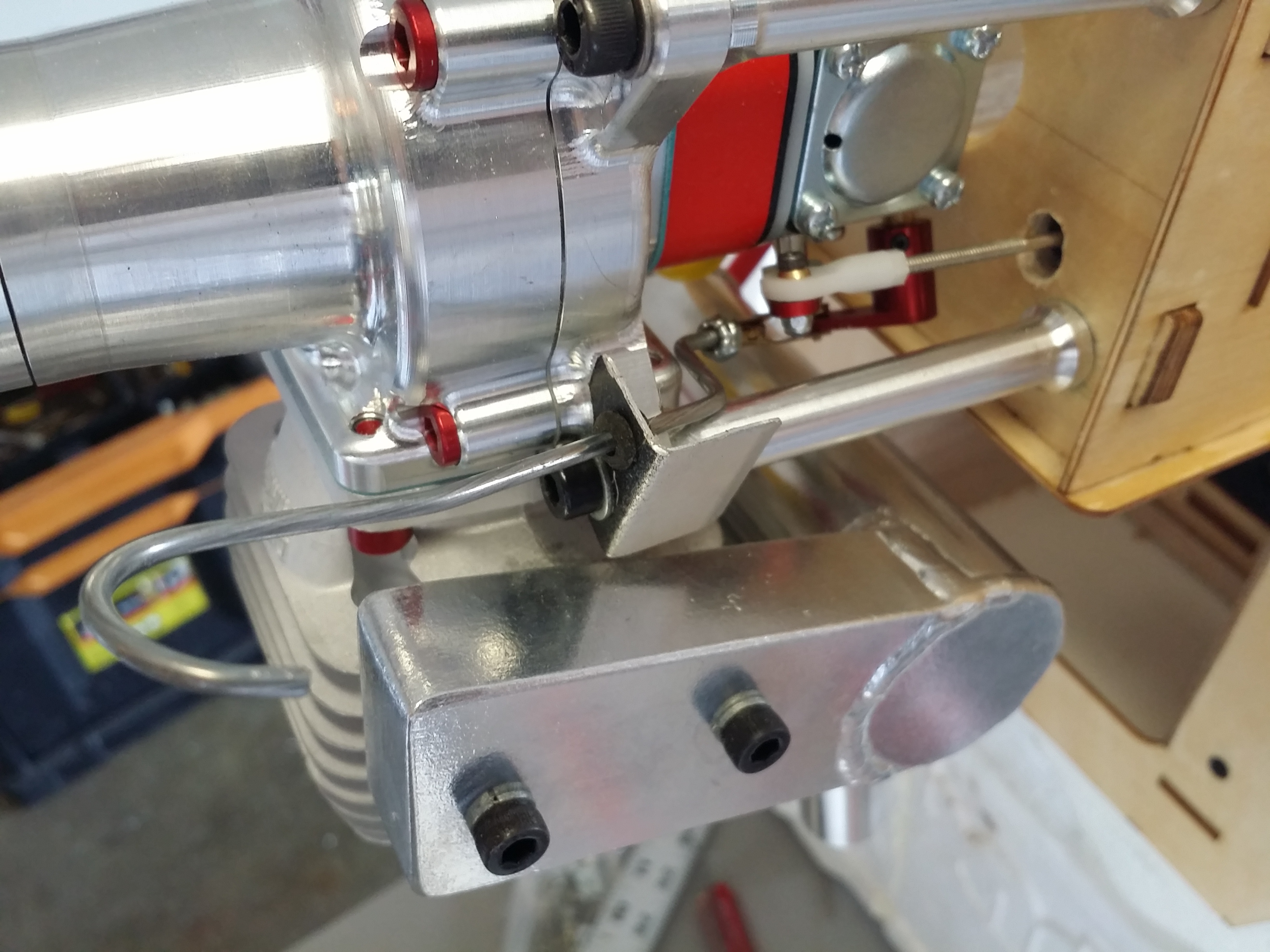

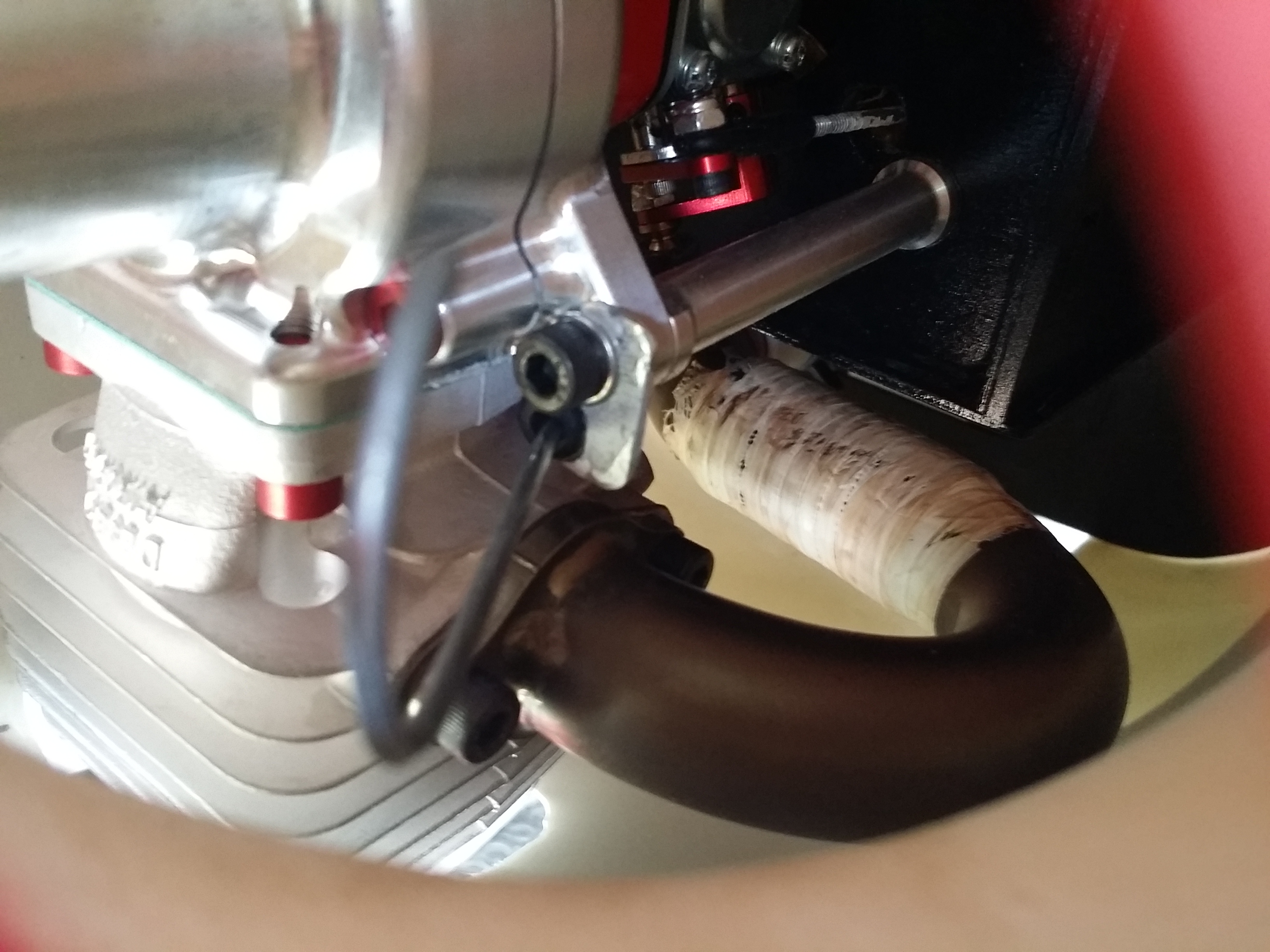

AK, I'm almost done my build, how are you operating the choke on the engine? I was planning on using a servo to operate it, but me thinks just to operate it with ball link and rod extending through the cowling. Just looking for an idea.
dc
vegasking
AKNick
I was having a hard time with this myself. Still trying to figure out the best method. It really depends on what exhaust you are running and how you position the choke arm on the carb. I like the top photo personally, but might run a phenolic board instead of the aluminum. I still haven't decided on my connections or exhaust. The 4-40 throttle arm doesn't actually give you enough room to attach 4-40 hardware which is ridiculous (the hardware will run into the engine mount or the diaphragm plate). And the choke... everybody seems to be flipping them 180 degrees. Horrible geometry when rigging these DA-35's... definitely not user friendly.
