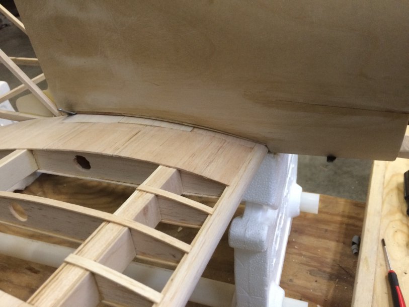

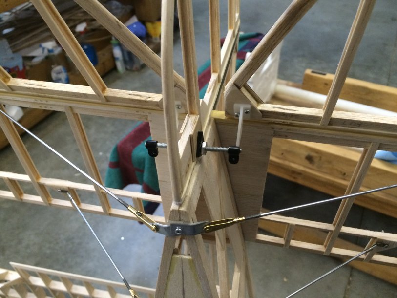

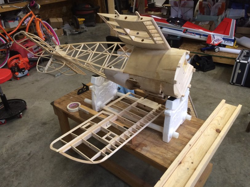

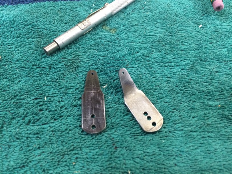

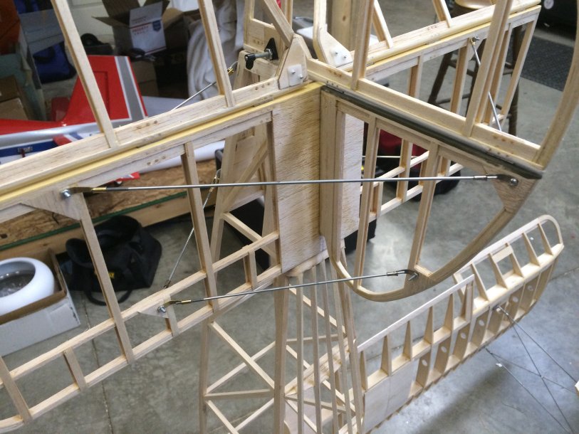

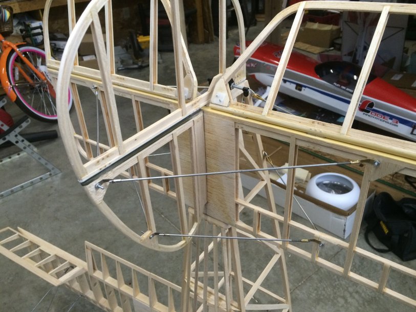

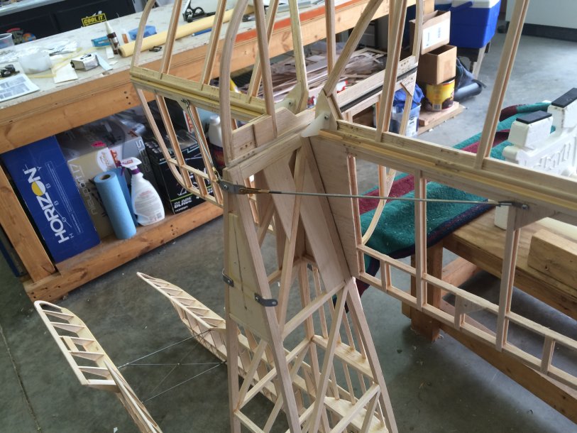

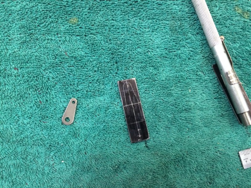

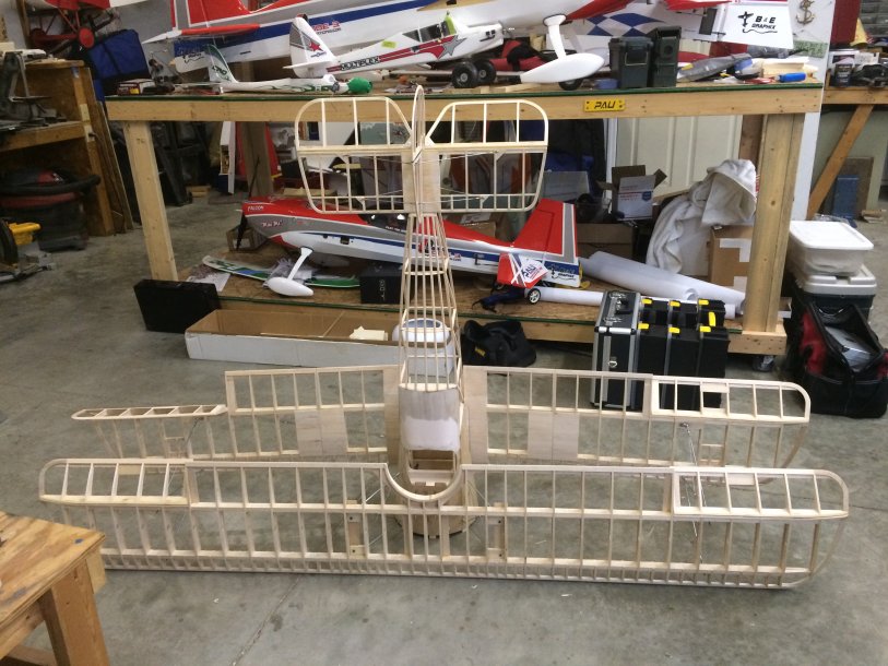

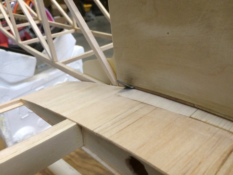

Made up the brackets and bracing wires for the tail. Don't have them soldered yet. Also cobbled up control horns for the pull pull on the Ruder

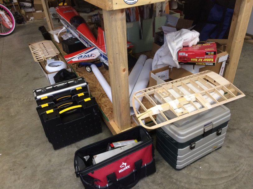

The nose of the plane makes a perfect plane stand for working on the tail. :)

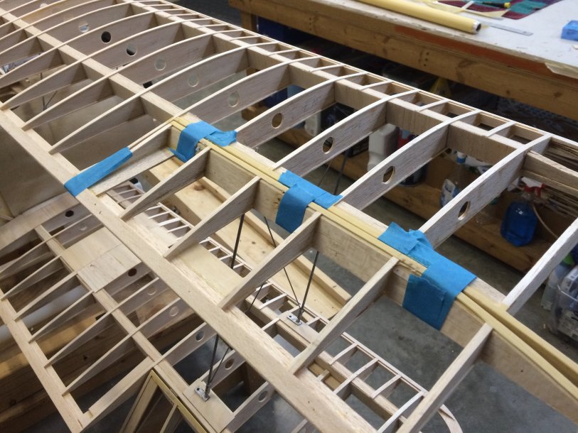

Today I soldered the bracing rods. Then I decided to finish up the top wing.

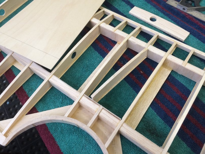

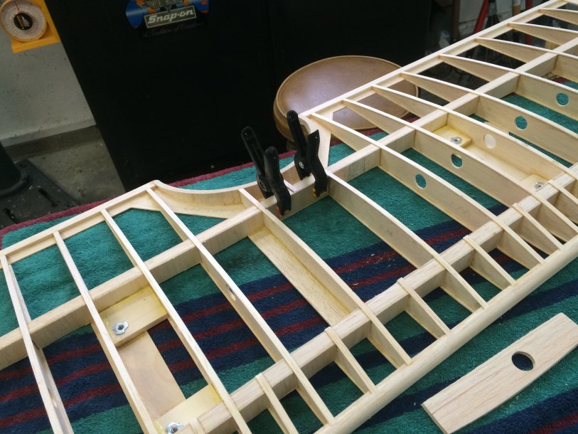

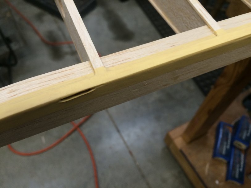

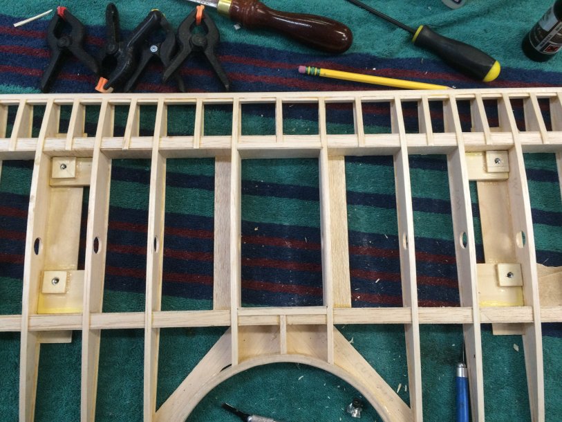

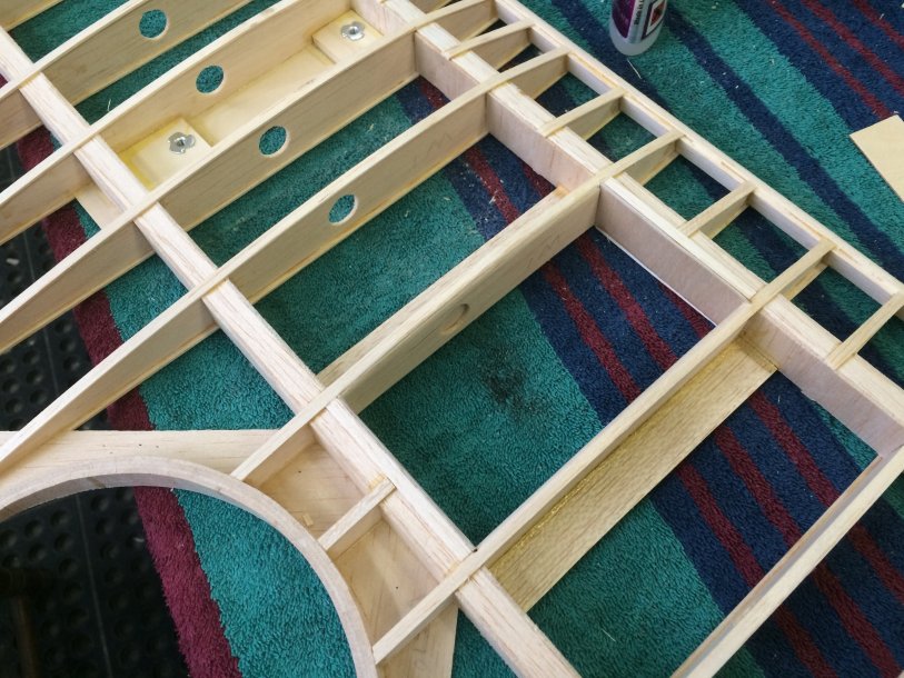

I took the Center rib out between the spars. On the full scale Camel there is a hole in the top wing in the middle of the wing. I believe this was designed in to give the pilot a better view of what's above him. The big wing limited the pilots view.

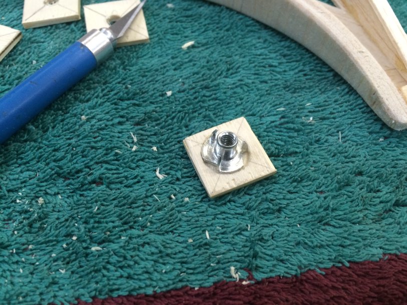

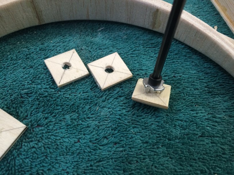

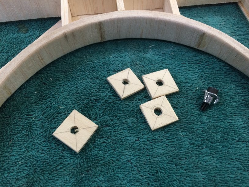

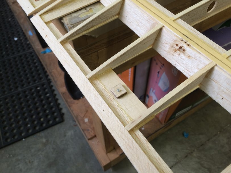

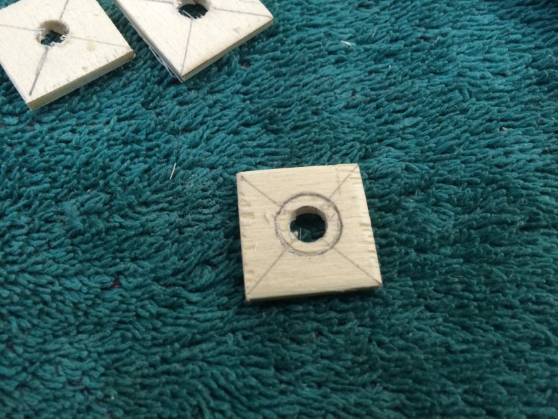

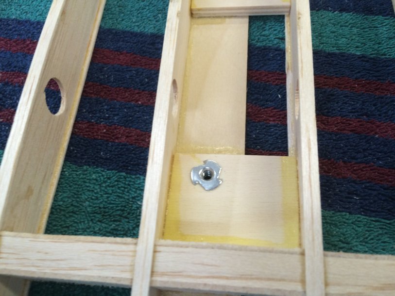

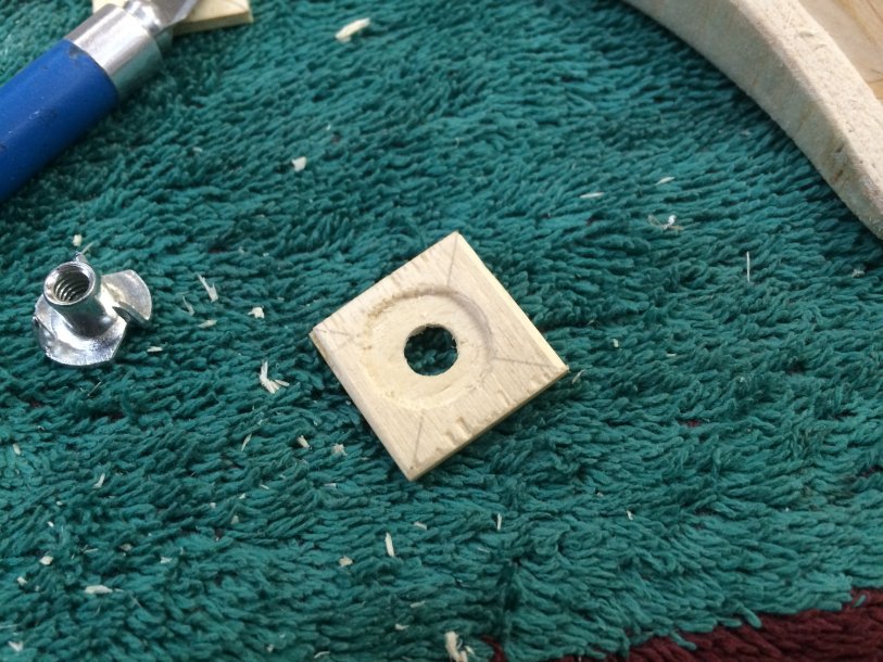

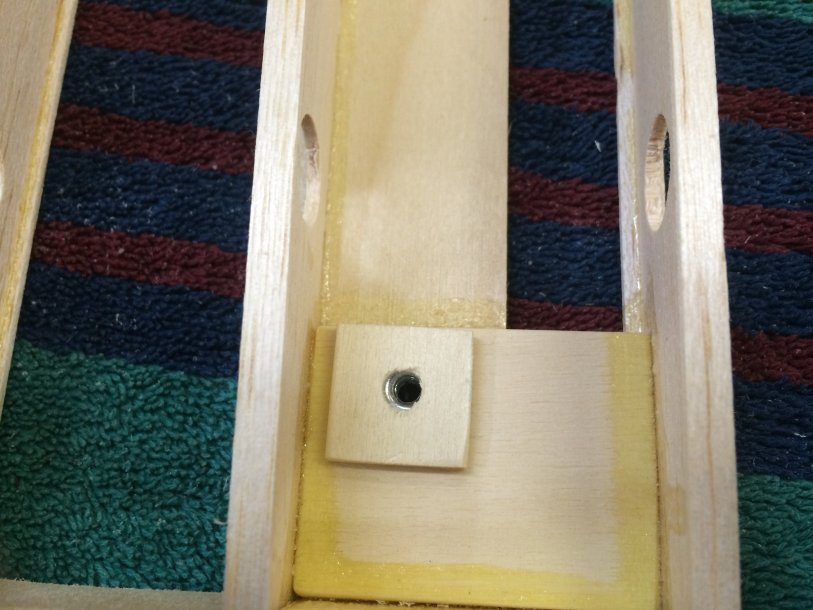

Here is something I started doing after I built my P-47. It's a cap over the T-nuts to help hold them in. I pushed out some in the wing of the 47 and it is a pain to repair them. I used to glue them in with Epoxy only. It let go on me once. That's all it takes for me to change the way I due things. I have not had a T-nut come loose since I started putting a cap over them.

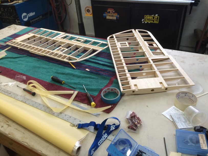

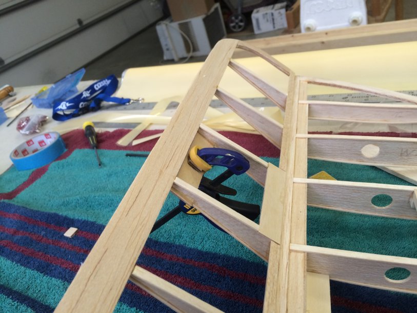

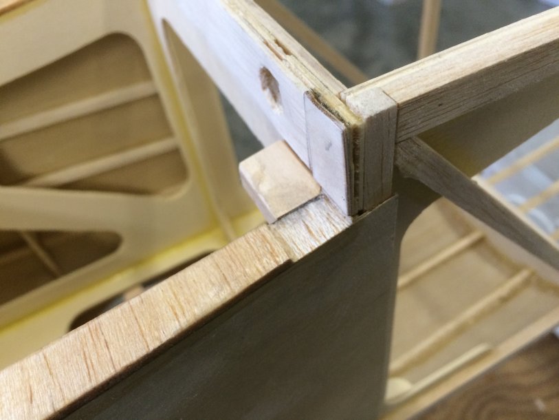

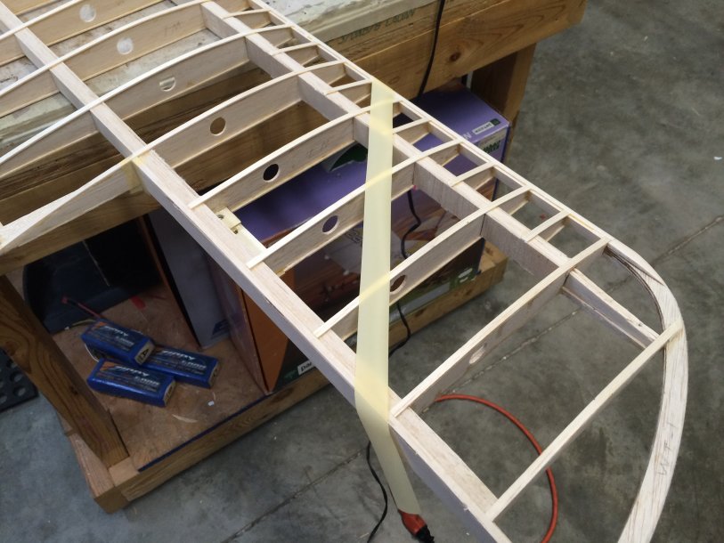

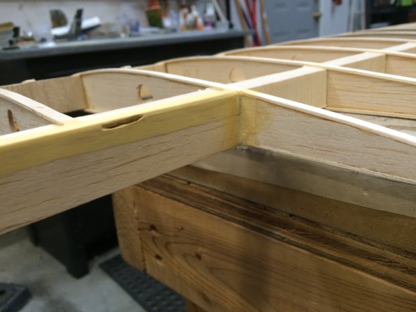

Someone asked me about my covering methods. I put a thin strip into corners first. I also put a strip where ever there's going to be some hinges and I cut a slot or in the case of pin hinges a hole. Then install the hinge. I ended up gluing the hinges on the wing part with Gorilla Glue. Messing around pining them takes to long. LOL. The weather was nice today so it reminded me that flying time is near. I'm going to have to pick up the pace if I want to fly it this Summer.

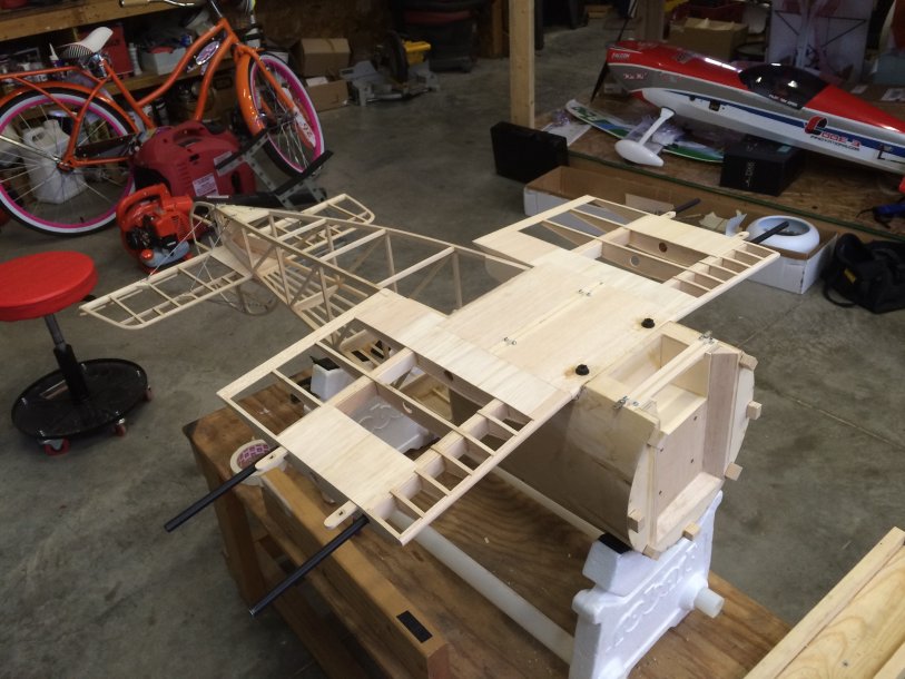

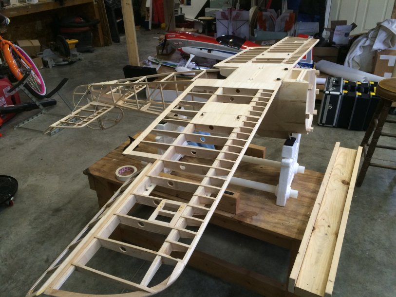

Finished up the top wing and stuck it up on the pegs. Then finished up the aileron pushrod brackets on the lower wings and Glued in the hinges on the lower ailerons and set them aside to cure till tomorrow.

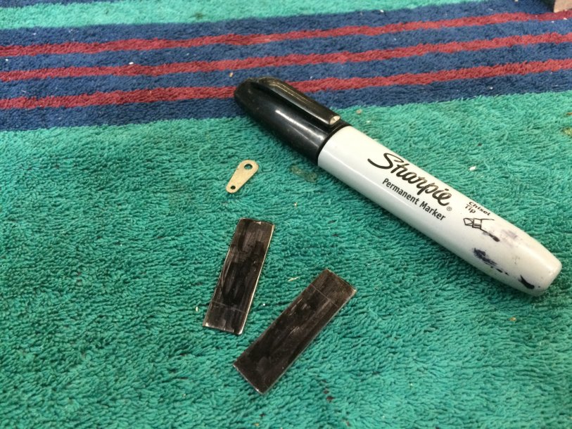

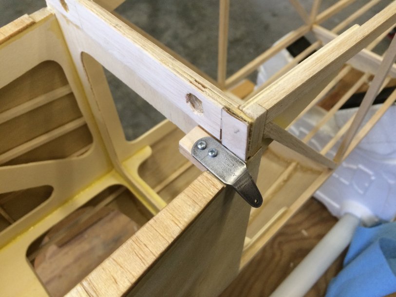

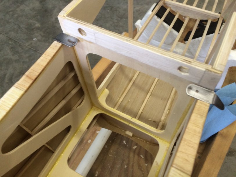

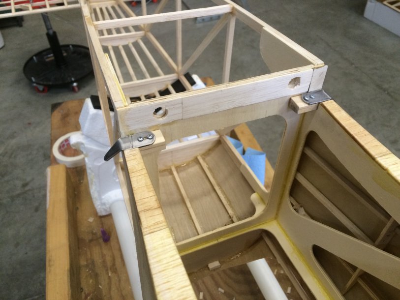

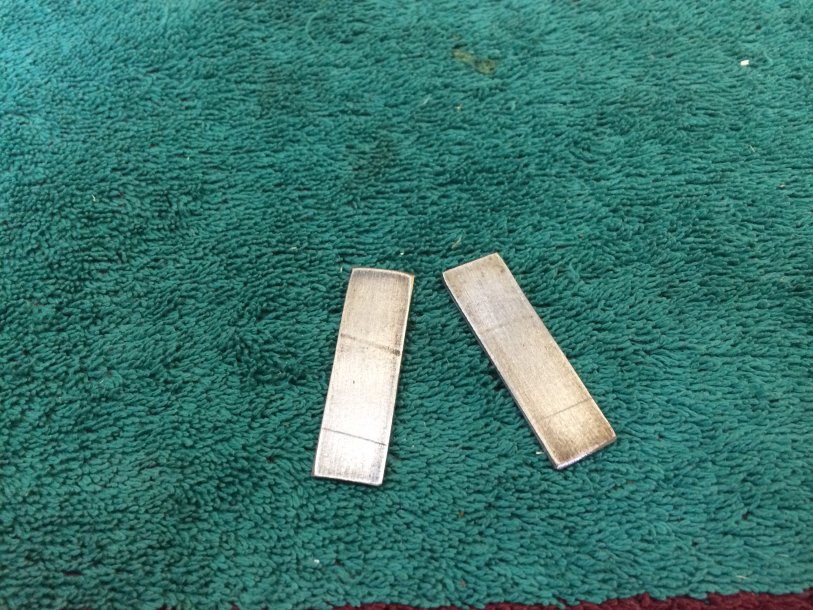

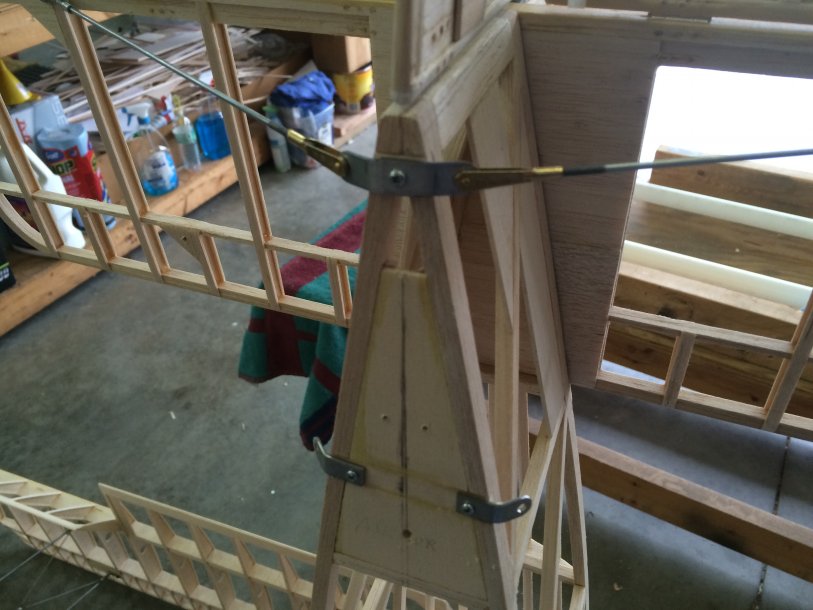

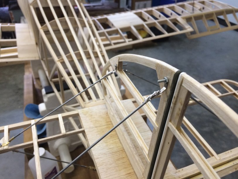

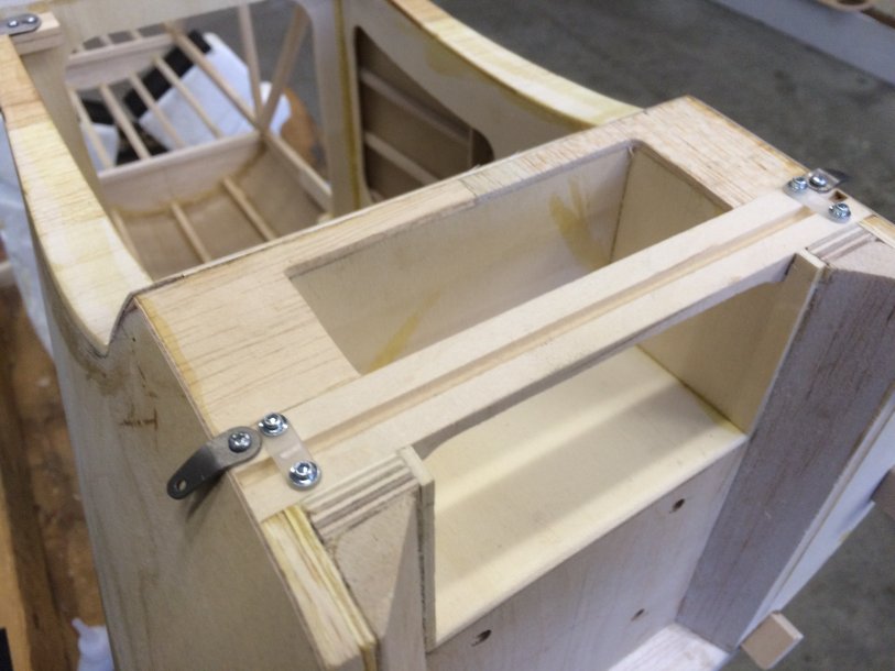

Made up some brackets for the wing cables to hook to. These are not part of the Kit so I'm winging it. Never done this before so I'm doing as I please since I don't know how to do it... But I'll find out. LOL. I used the front wire bracket from the kit. I found the hardware that I reordered. Now I'm not short on anything. I scratched out the rear ones from some sheet metal I found in the scrap can.

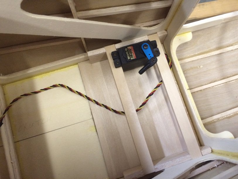

Started making the servo rails but I have no Idea where to put the fuel tank. So I'm just making parts for now. I'm open to some help here from the people that built these BUSA Kits before.
