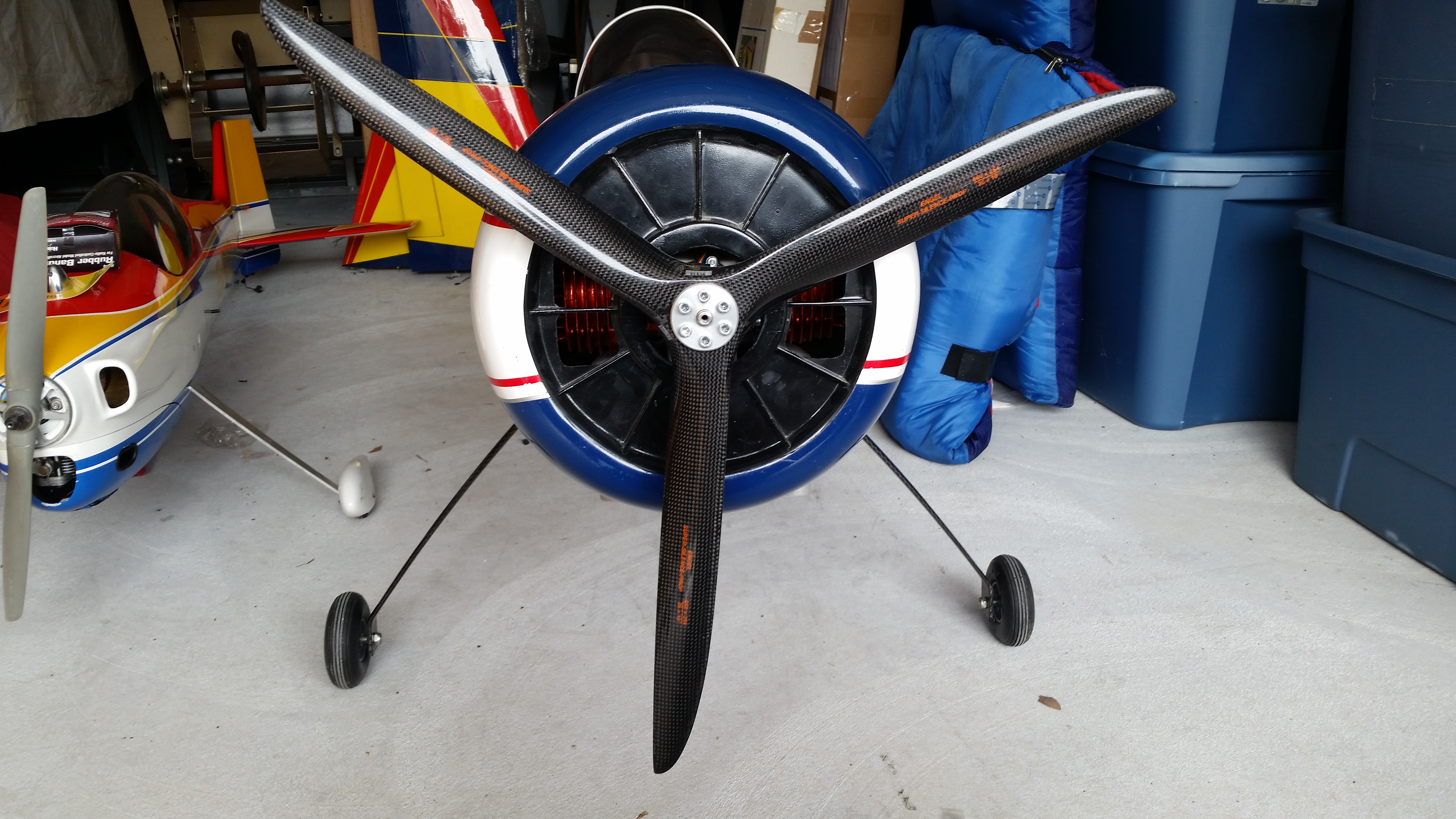

I got an email from my Buddy at work this morning and he told me he got quite a bit of work done after we talked yesterday evening. He was even nice enough to send me some pictures so I could share them with you Fellas.

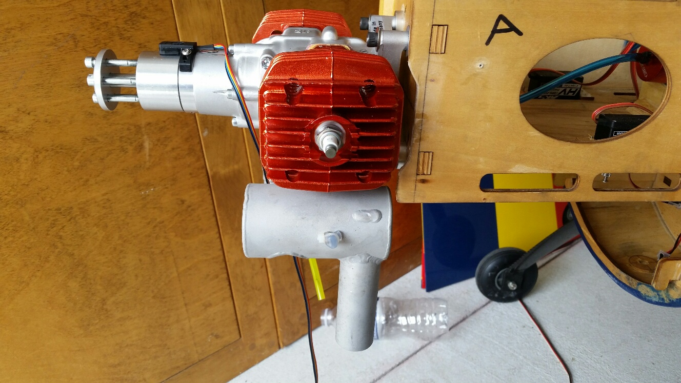

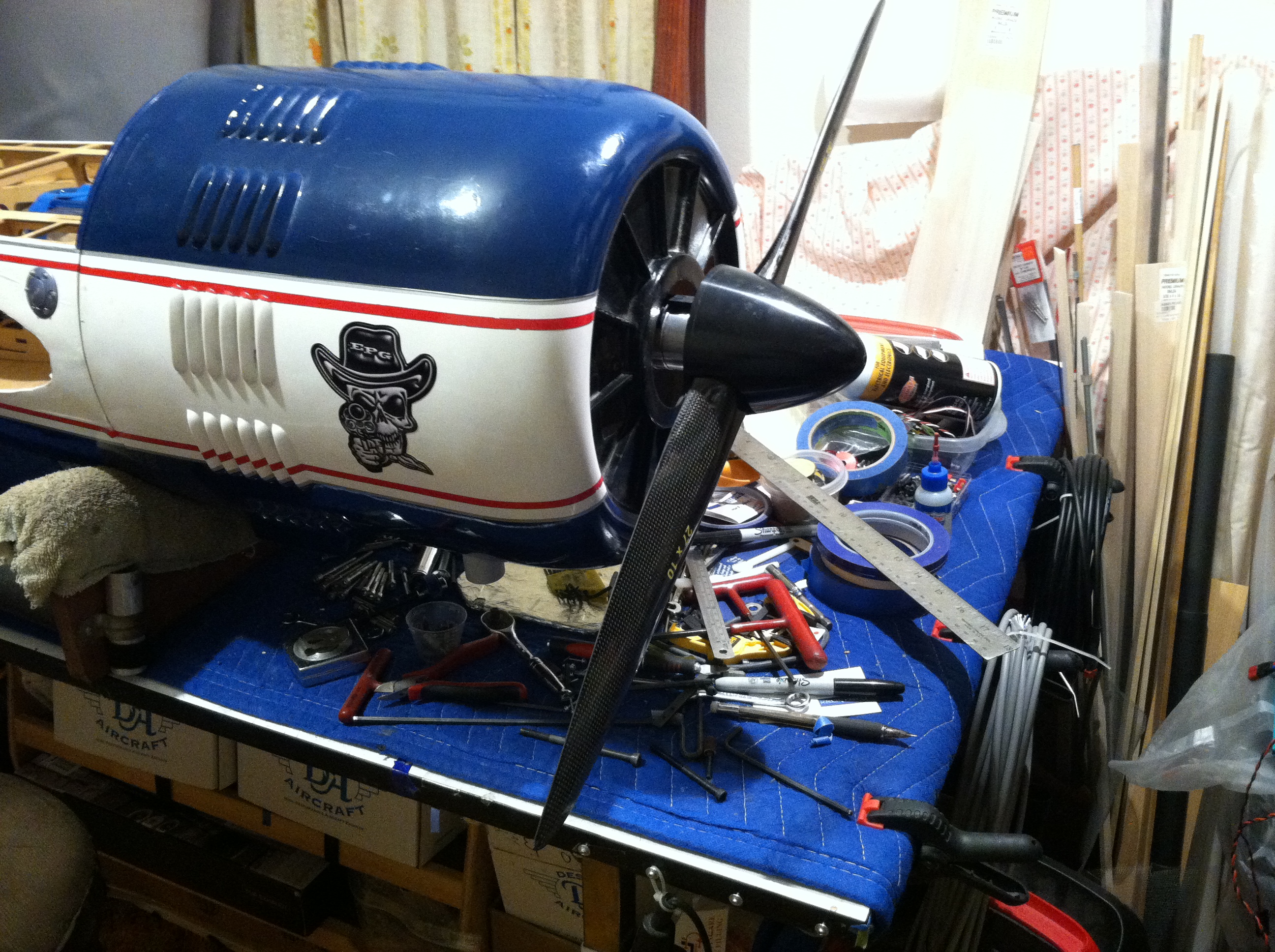

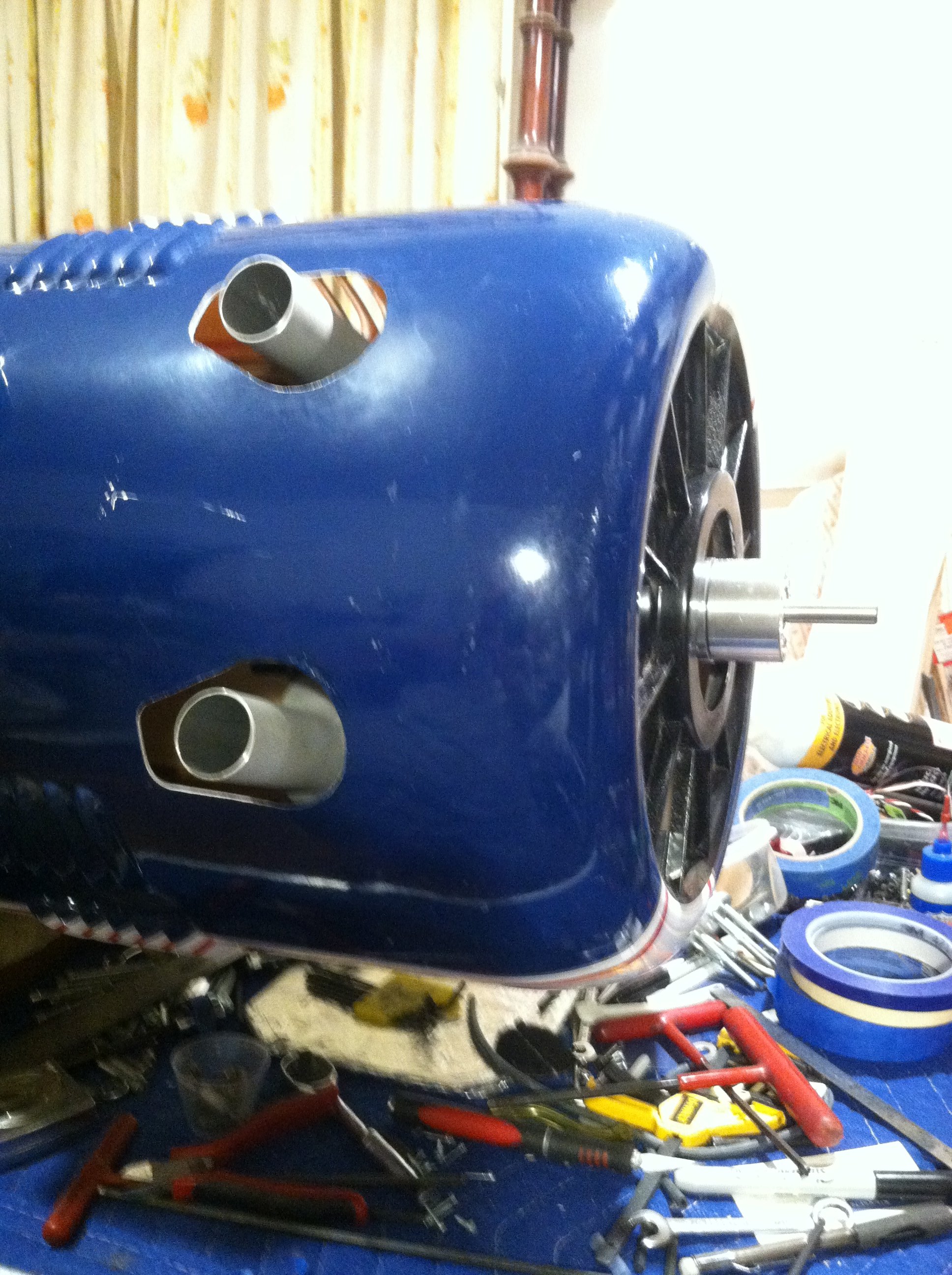

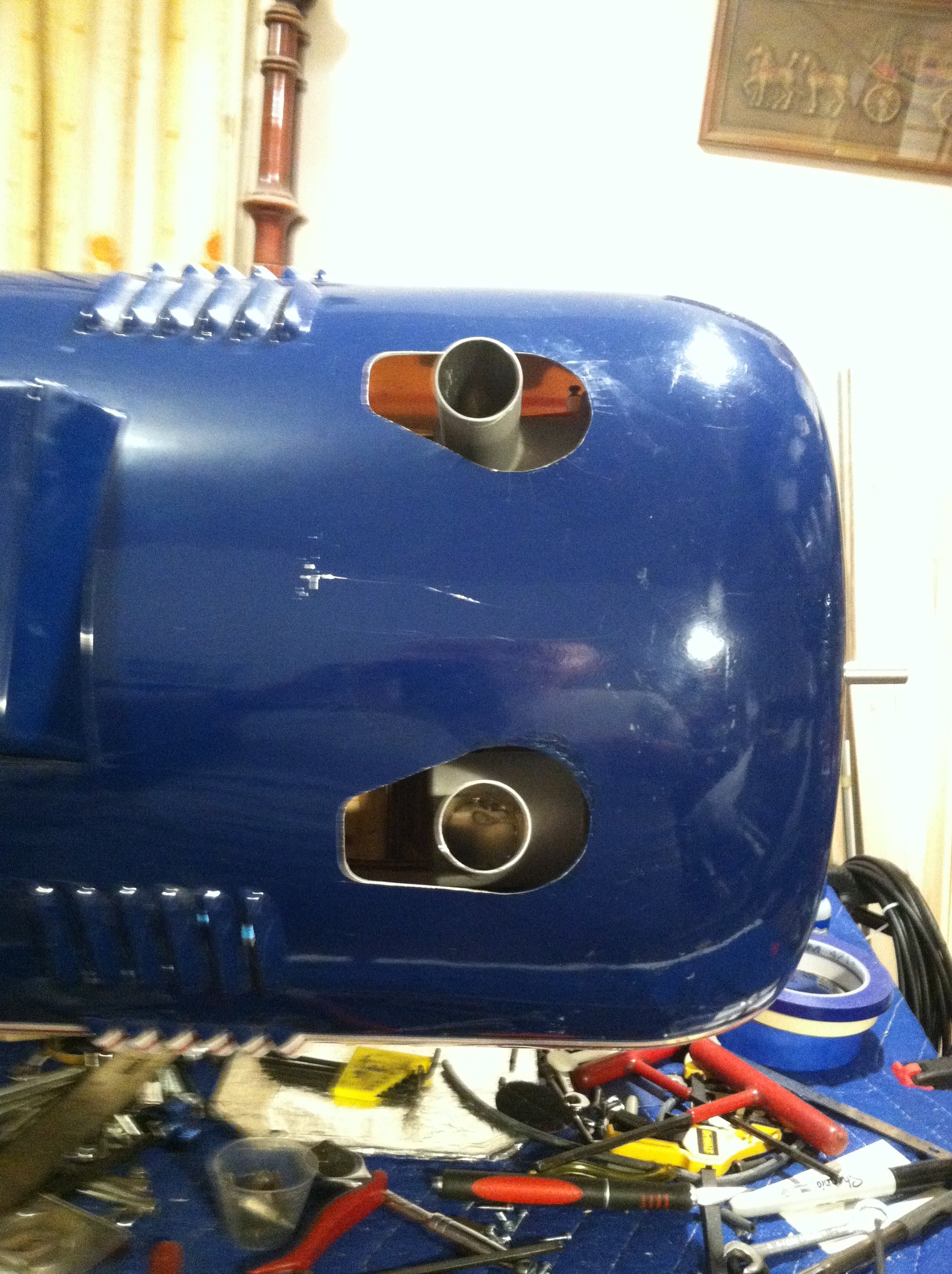

As you can see he had to slightly alter the holes in the bottom of the cowl to get it on around the pipes.

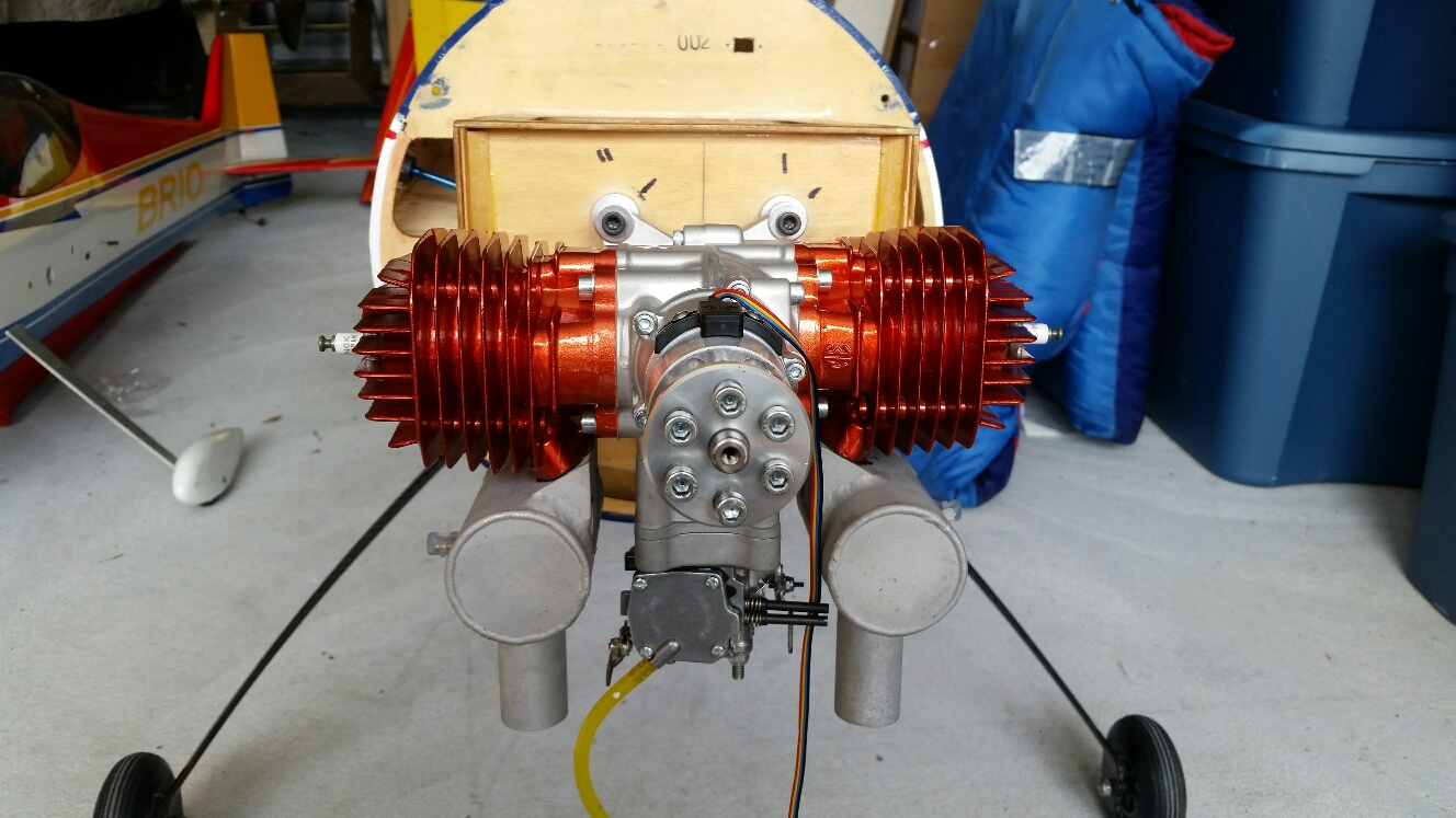

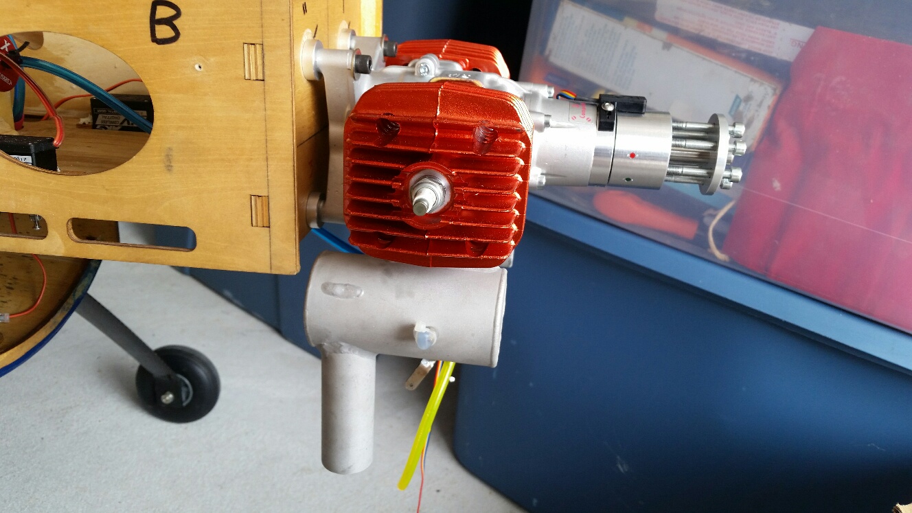

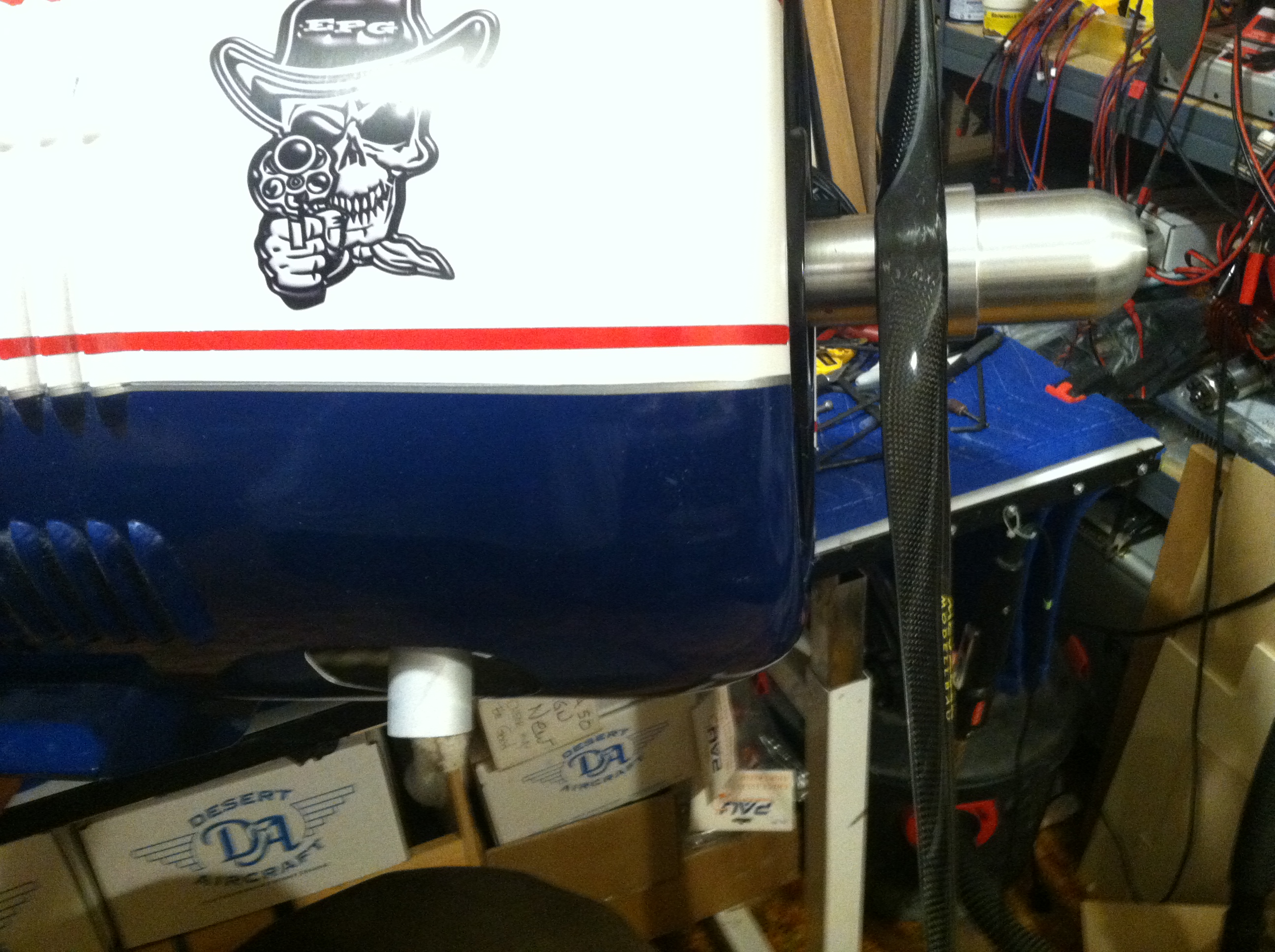

In this picture, you can see how far the prop hub sticks out in front of the cowl. You can see the right thrust as well.

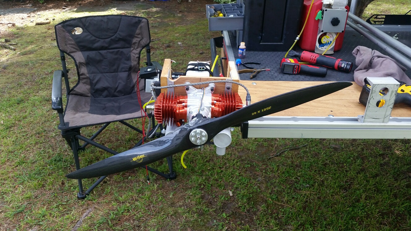

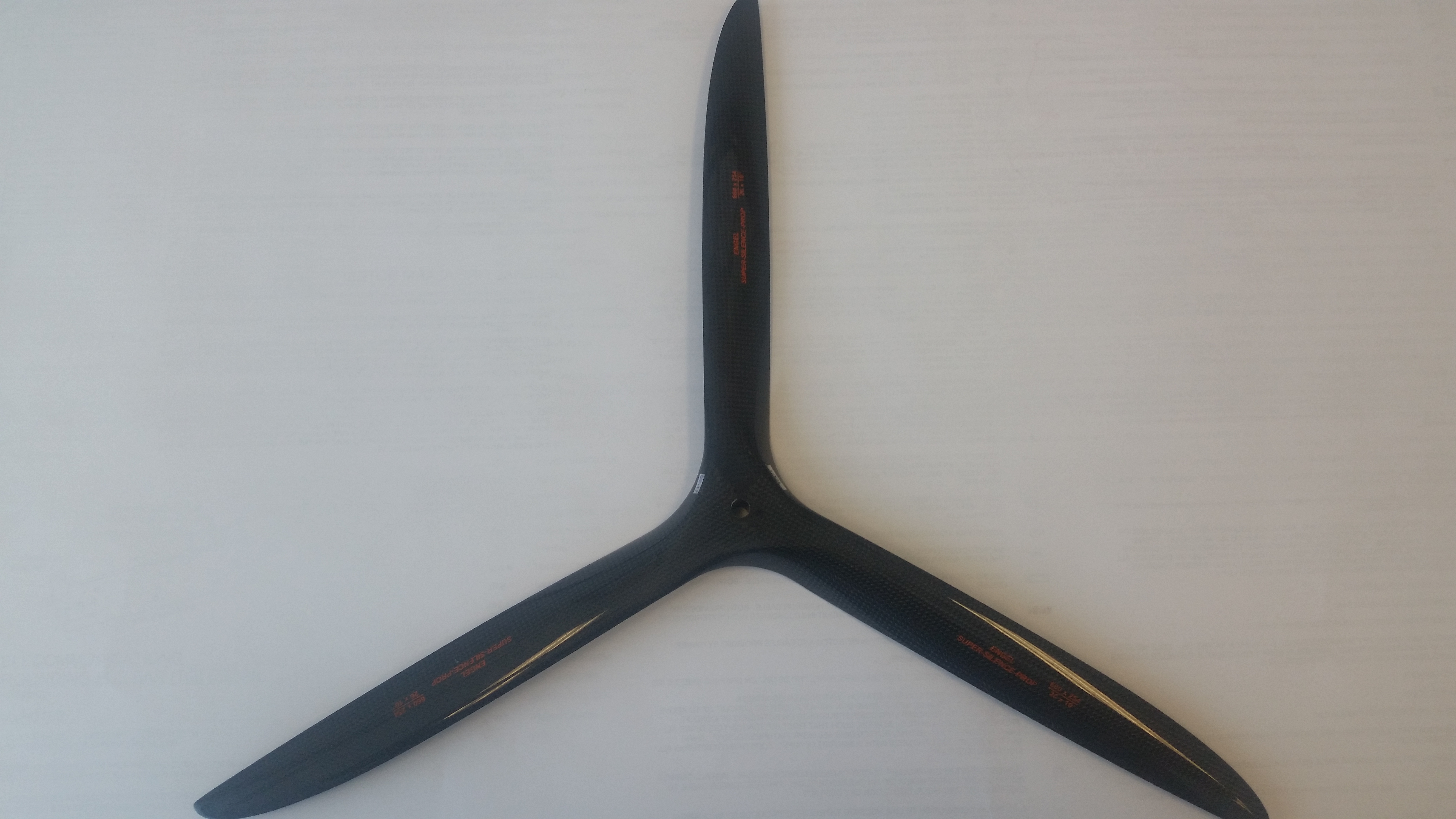

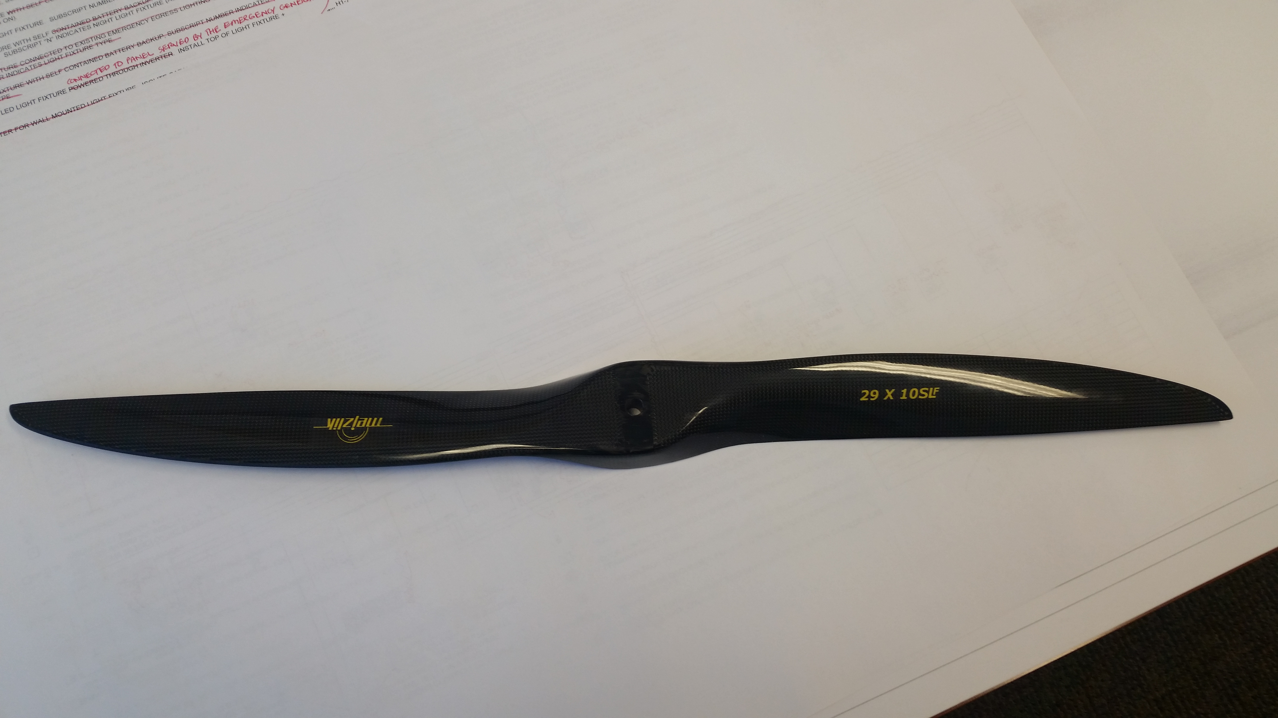

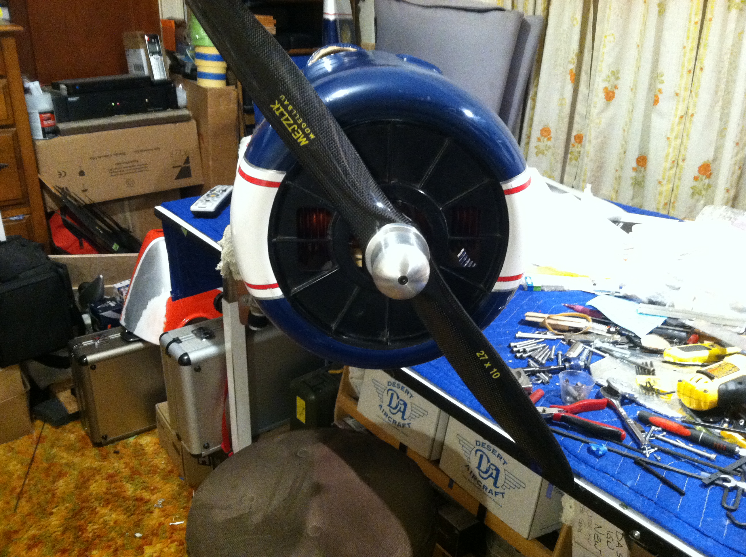

My Buddy and I talked Sunday night about my thinking of using a prop hub instead of a spinner, so he took this picture for me. You noticed he put a 27x10 prop on the engine. At my Buddy's suggestion, I called The G Man Monday and asked him for prop recommendations for my red headed beast. Gerhard said this engine will rip any prop 28x10 or smaller. He said if I wanted speed (which I don't), he'd suggest a 28x12. If I wanted pull, he suggested a 29x10. Out of curiosity, I asked Gerhard what he'd recommend for a 3 blade prop, his reply was a 26x10. I had wanted to try the Engel props he sells so I told him I would like to order one of each that he recommended. He checked his stock and as it turns out, he didn't have the Engel 29x10 in stock, so I ordered the 26x10 3 blade from him. When I finished talking to Gerhard, I called DA and ordered a Mejzlik 29x10. Both props should be here tomorrow.
My Buddy told me he had to shorten the muffler pipes to get the cowl on. I said that was fine because I didn't want to see long pipes sticking out of the cowl.

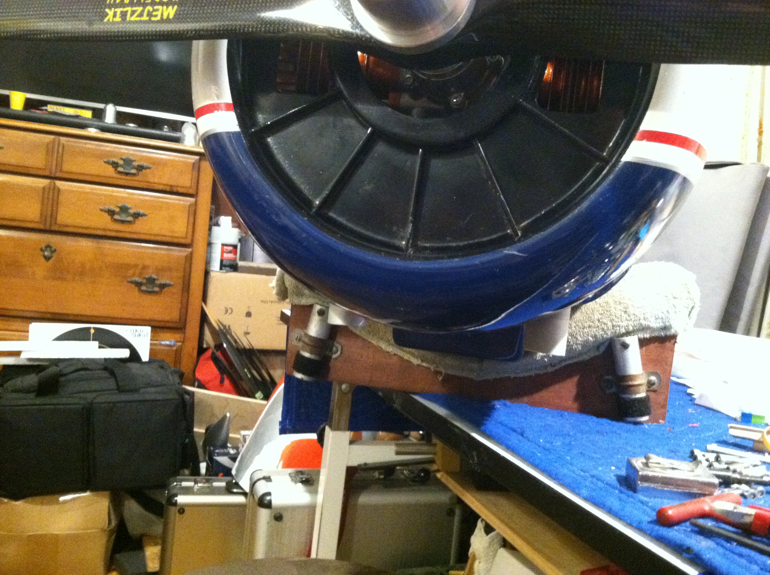

In this picture, you can see the up thrust that was built into the firewall too.
My Buddy took this picture, as he said "for the heck of it". That is a 5" P-51 spinner. After my Buddy mentioned that he ended up not using 1/2" stand-offs to help in putting the cowl on easier, I really got to thinking. The Beast is quite a bit heavier than a DA-100. The fact that the engine is 3/4" closer to the firewall than the DA-100 helps allot too, but those Tru-Turn prop hubs are HEAVY! So I've decided to go the lite route to help balance and get a 5" carbon fiber spinner. My problem is that I want one with an aluminum backplate and I cannot remember who makes them.
