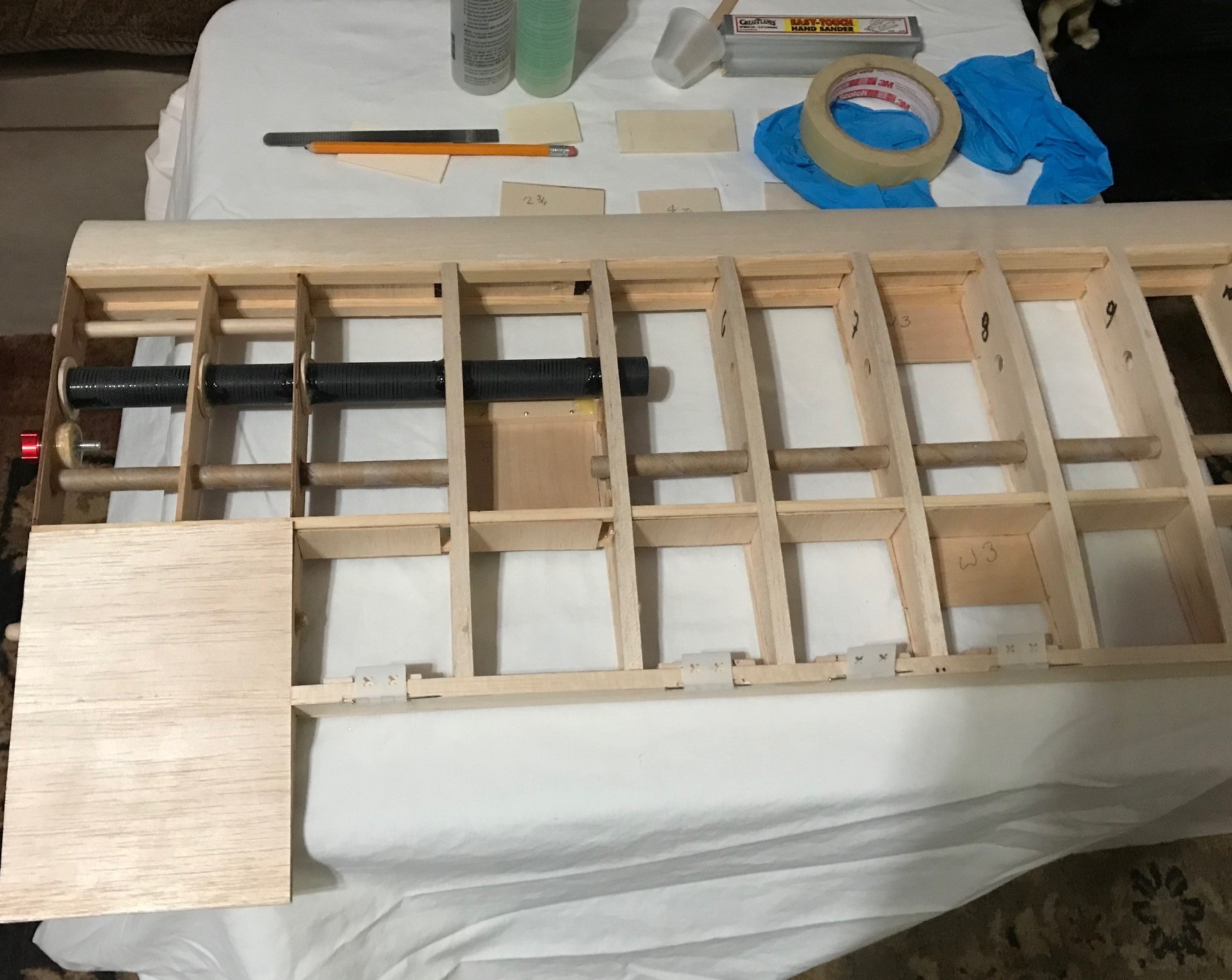

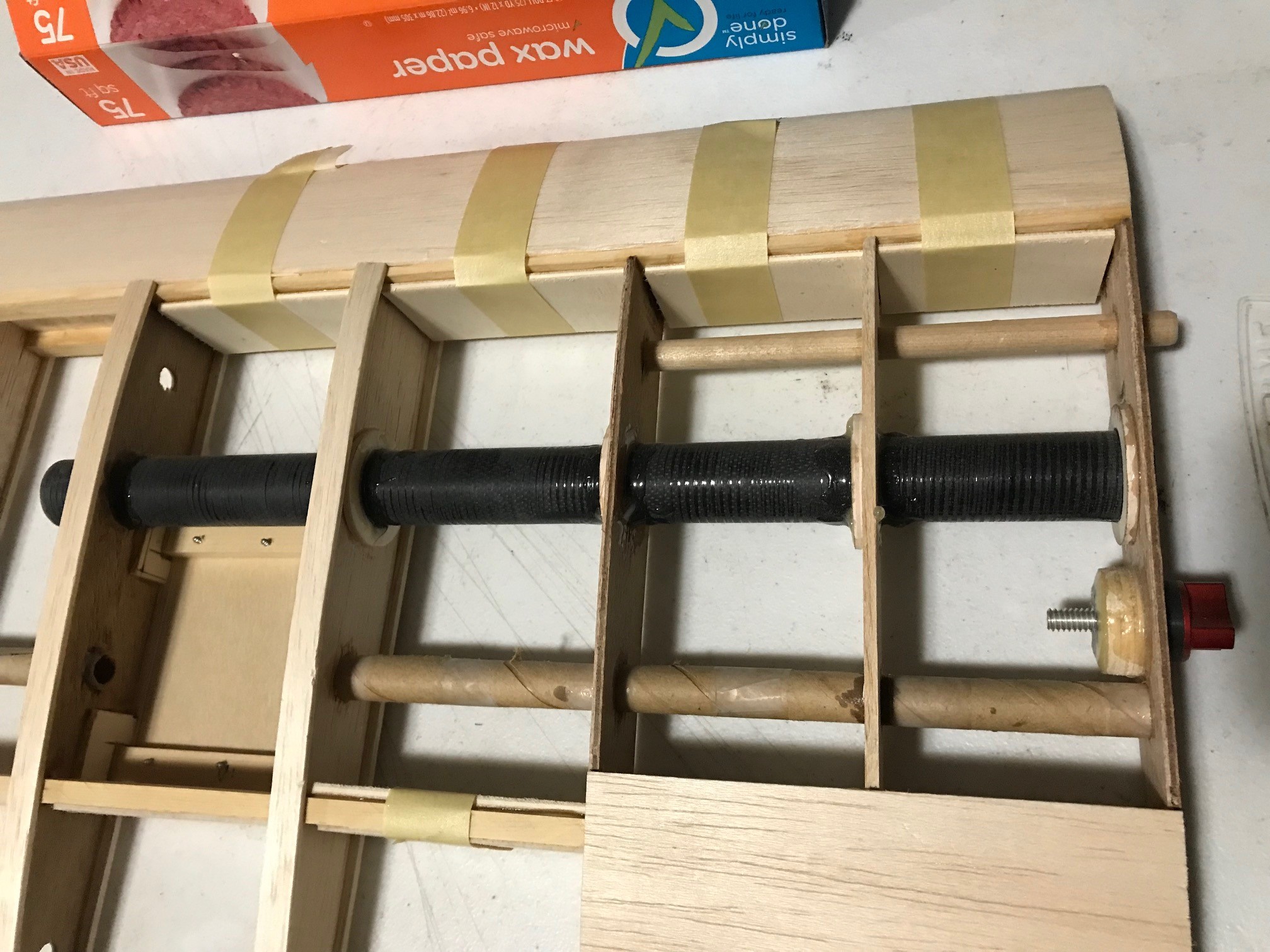

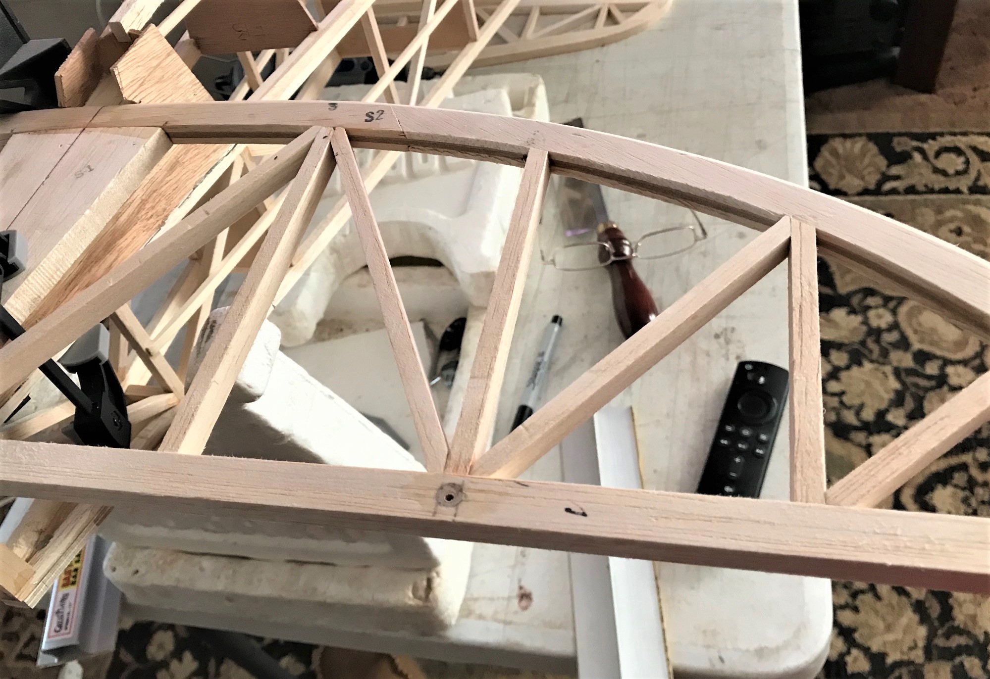

Got the light ply sheer webbing in place along the wing tube.

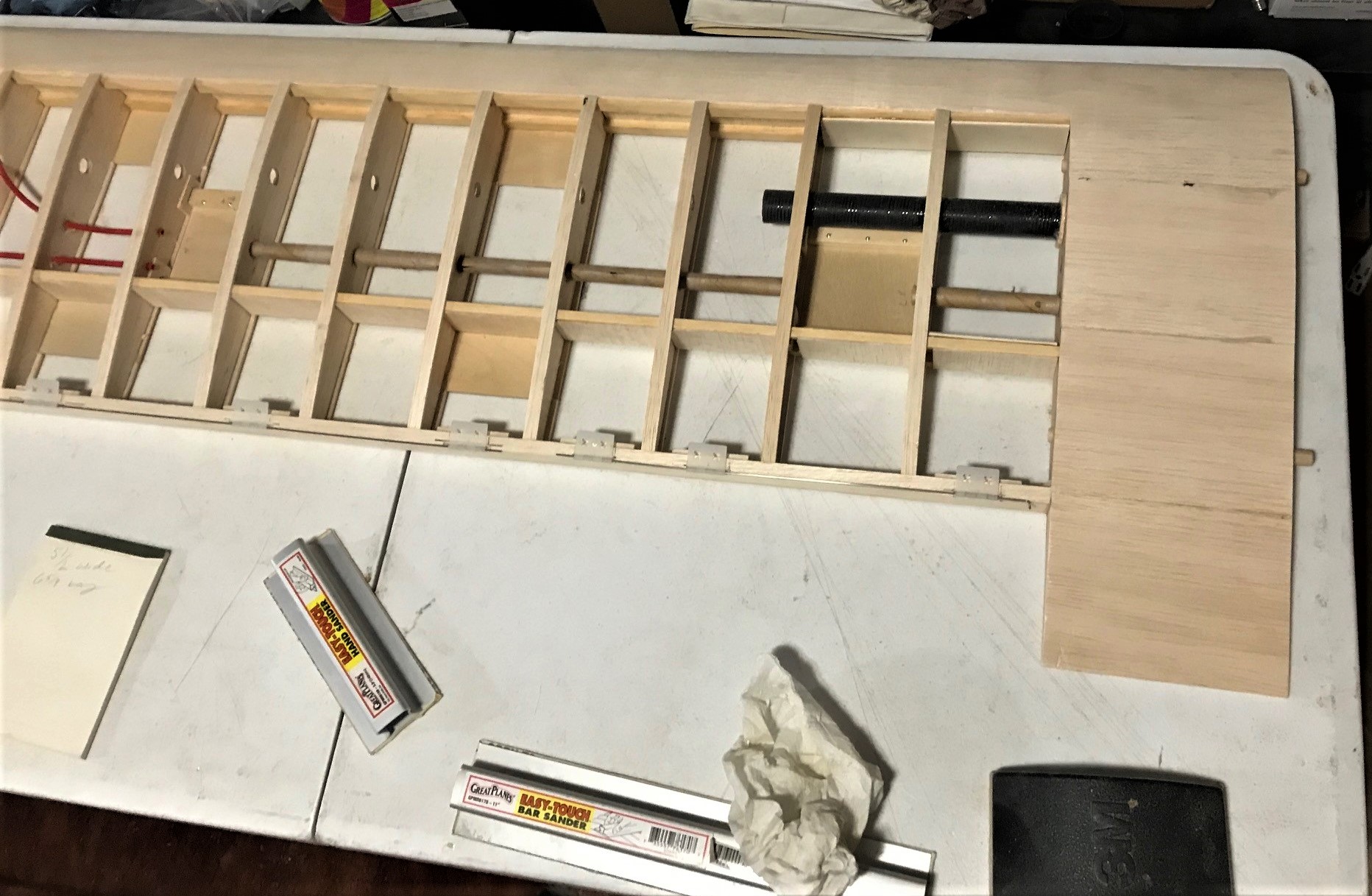

I got the center section of both wings finally sheeted today.

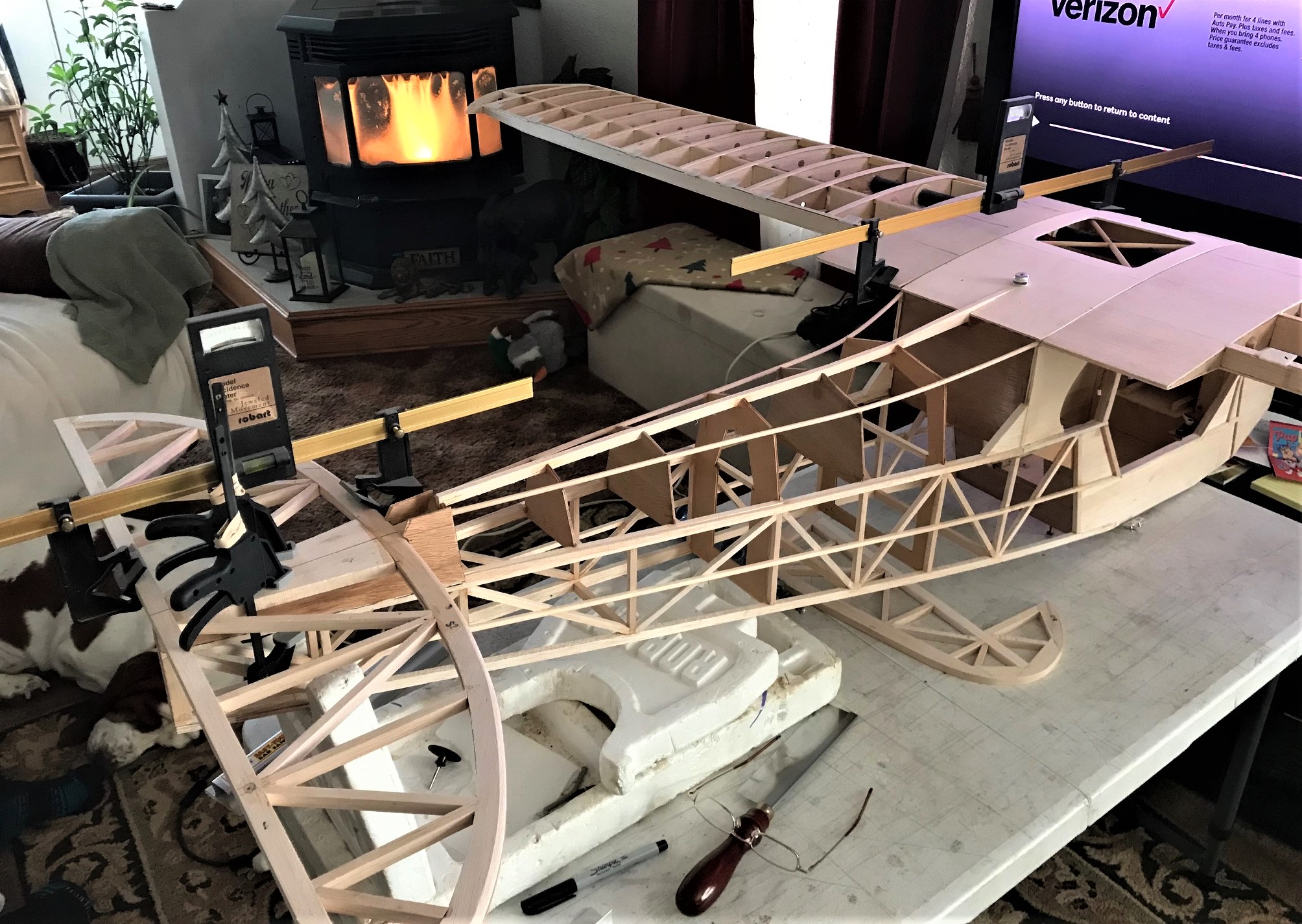

I could start my Tiger Moth, really make a mess here.

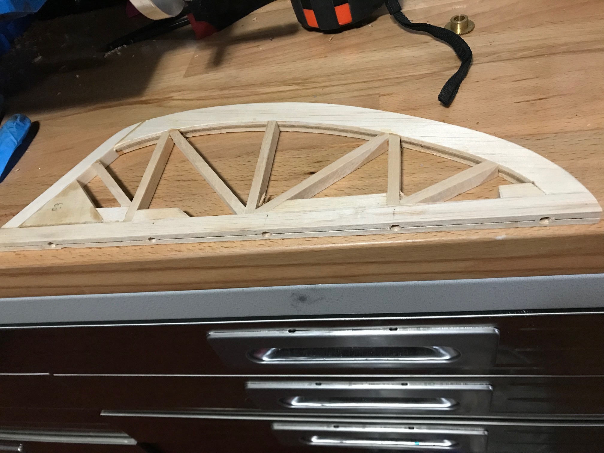

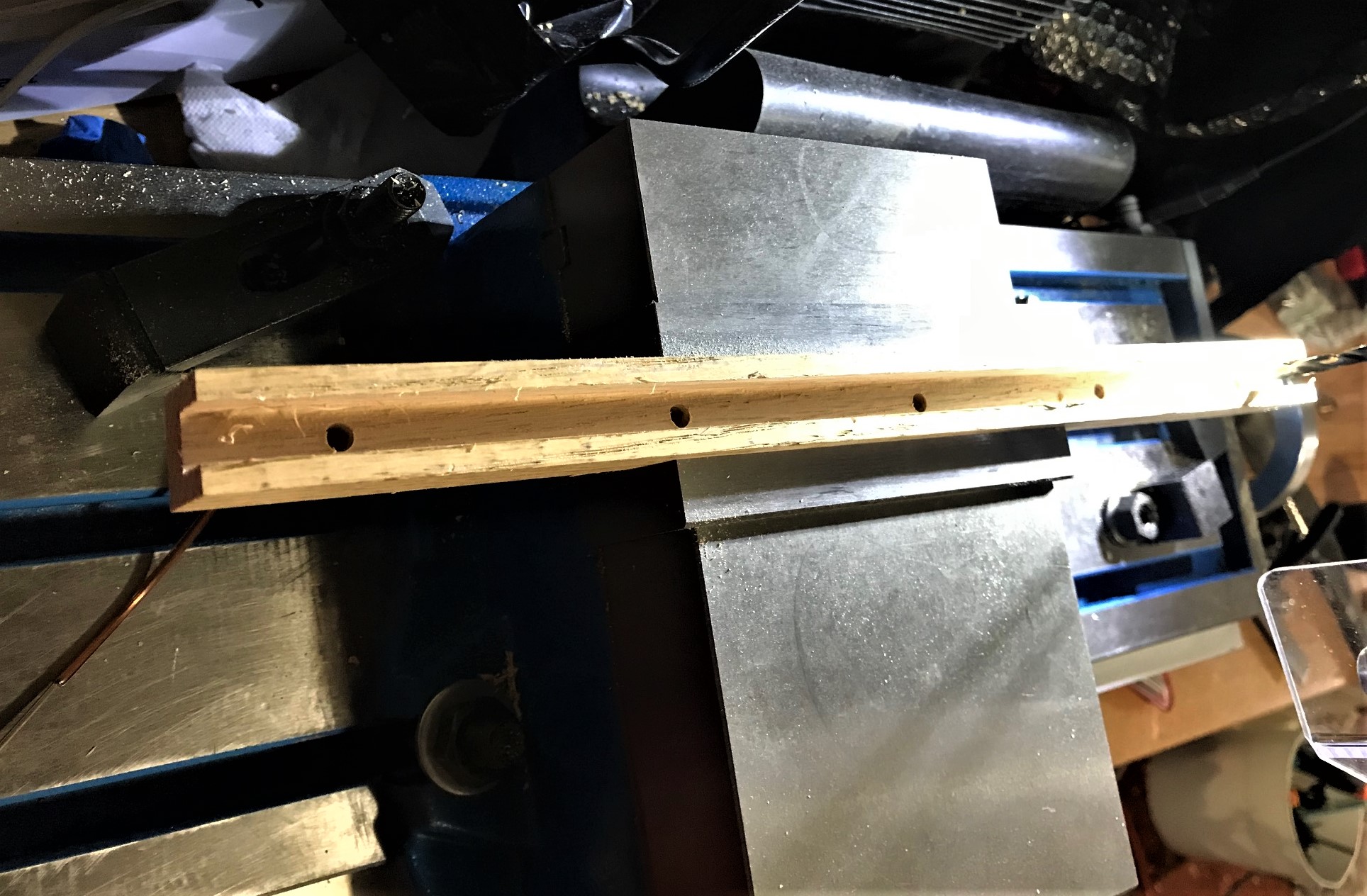

Got a little more work done on the Cub. I forgot how much still needs done on the tailfeathers! Got the hard points installed in the horizontal stab, for the tailbrace wires. Added more material for the hinging. I decided to go with Robarts for the tail surfaces. Made a jig out of oak on the mill. Made it much quicker to make! Got the hinge holes drilled in the stab and elevators. Did some more sanding on the stab mount and got the incidence set at -.5*
