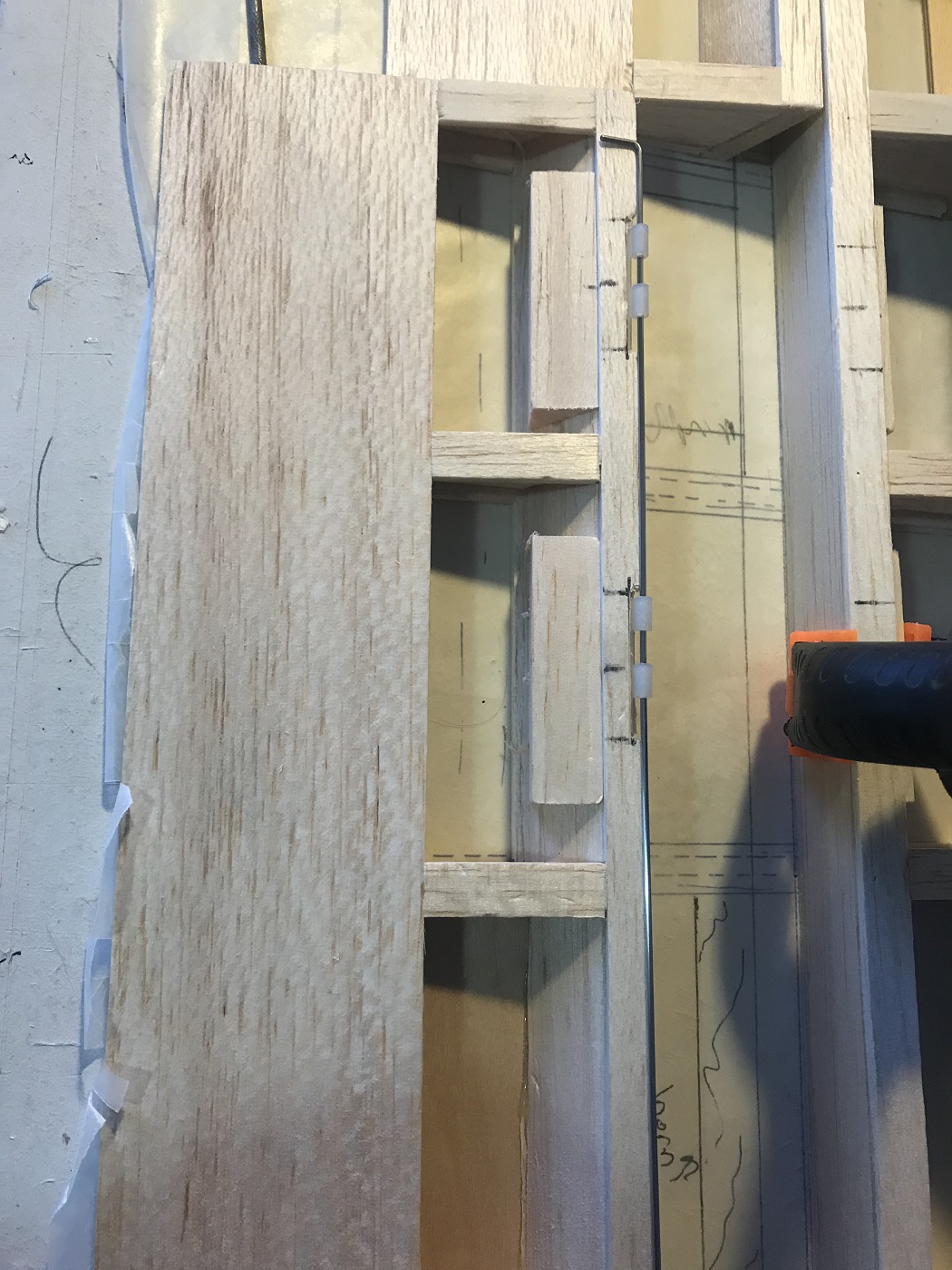

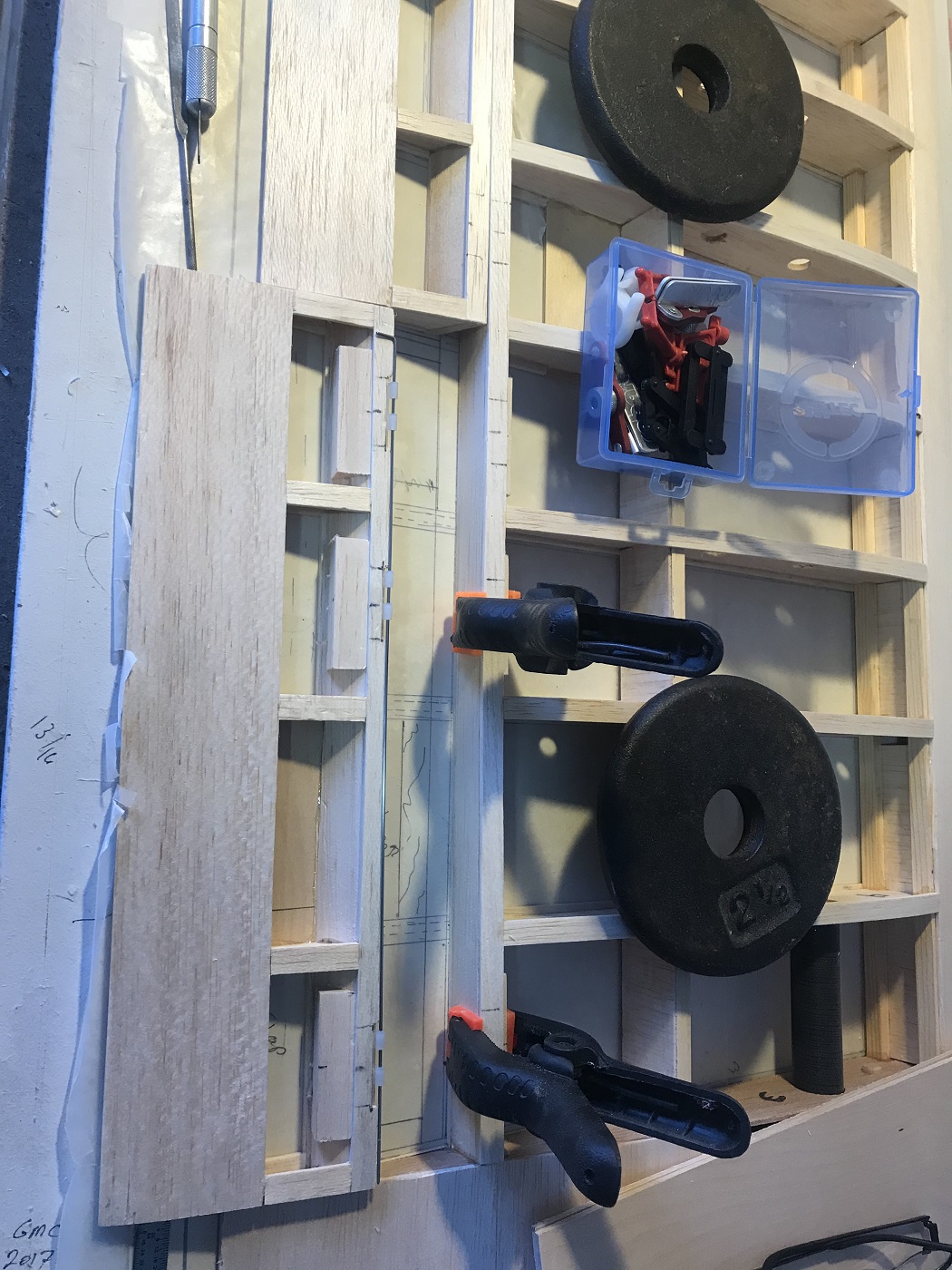

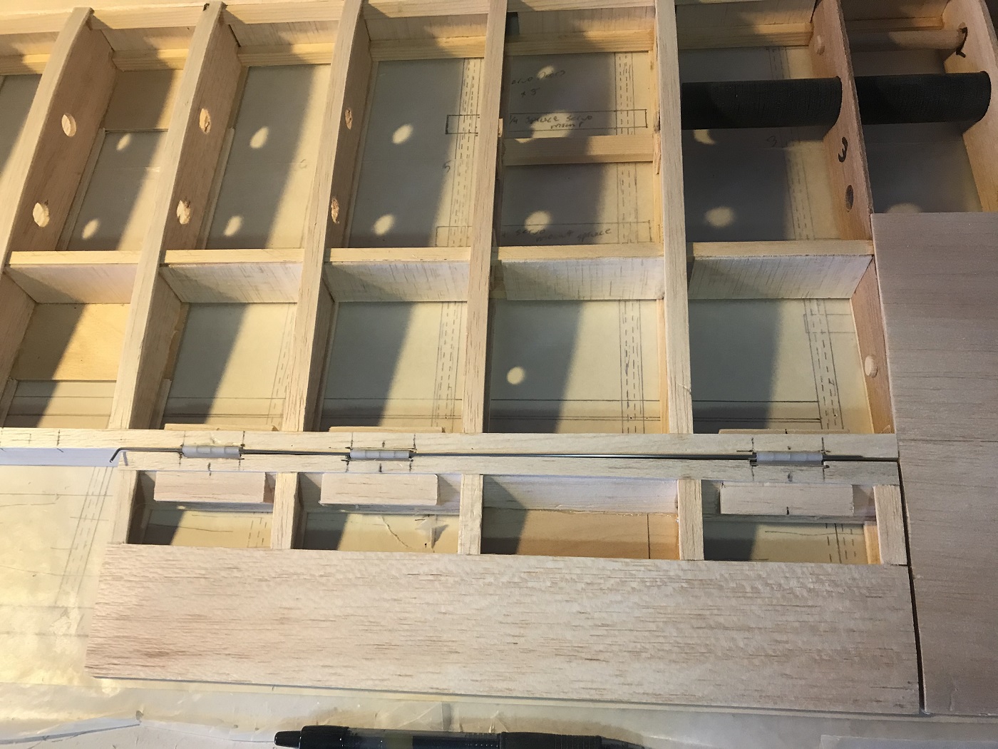

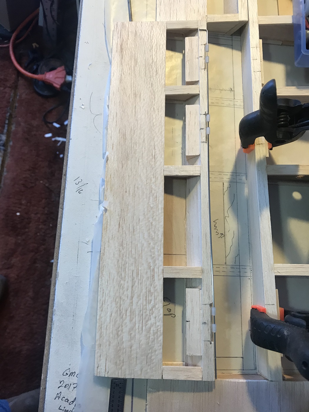

Well, I decided to use the Sig Super X hinges. I've used them alot in the past and like them. I'll be using some music wire to pin them so I can remove the surfaces if I need to. Here's some pics.

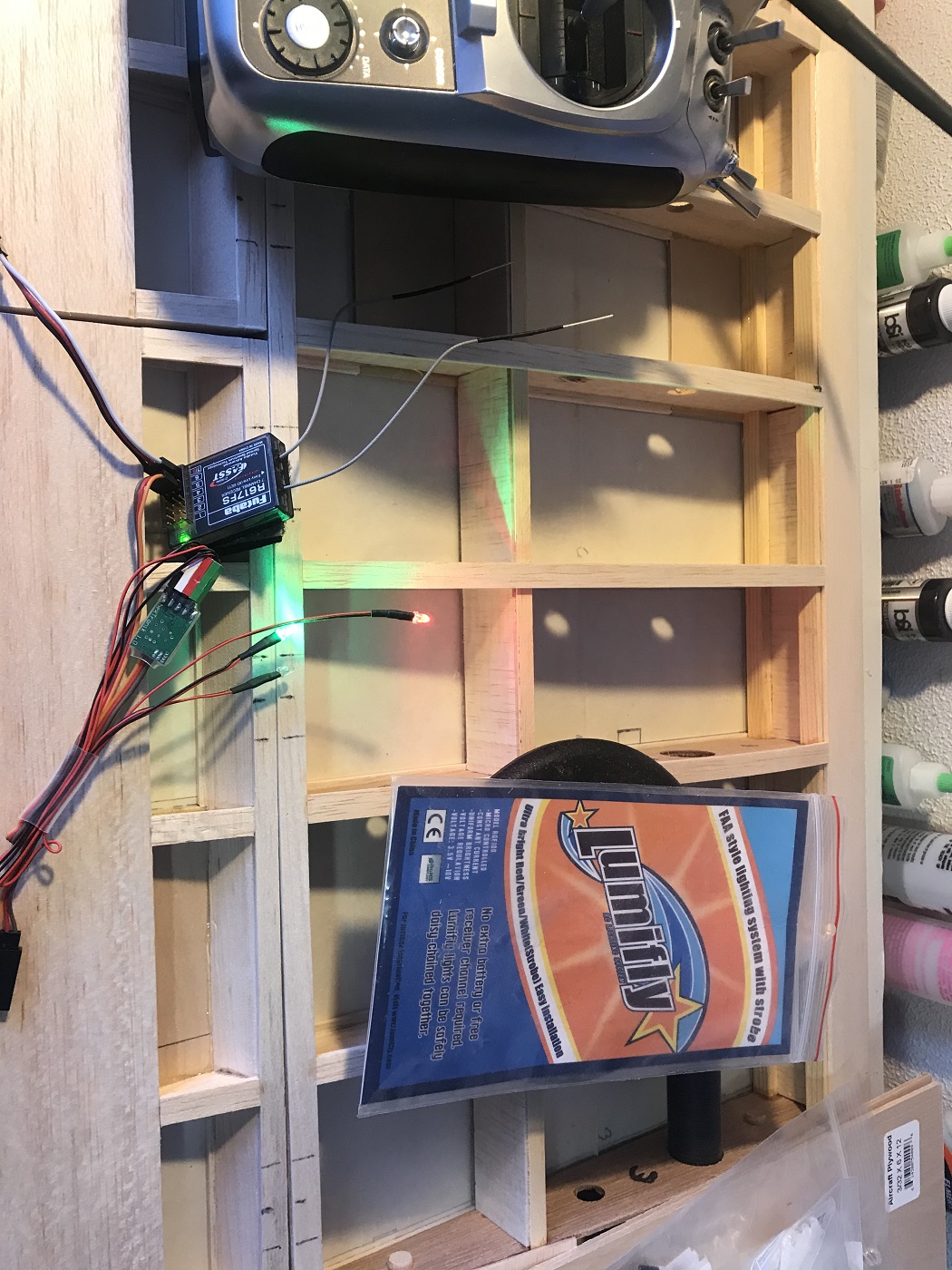

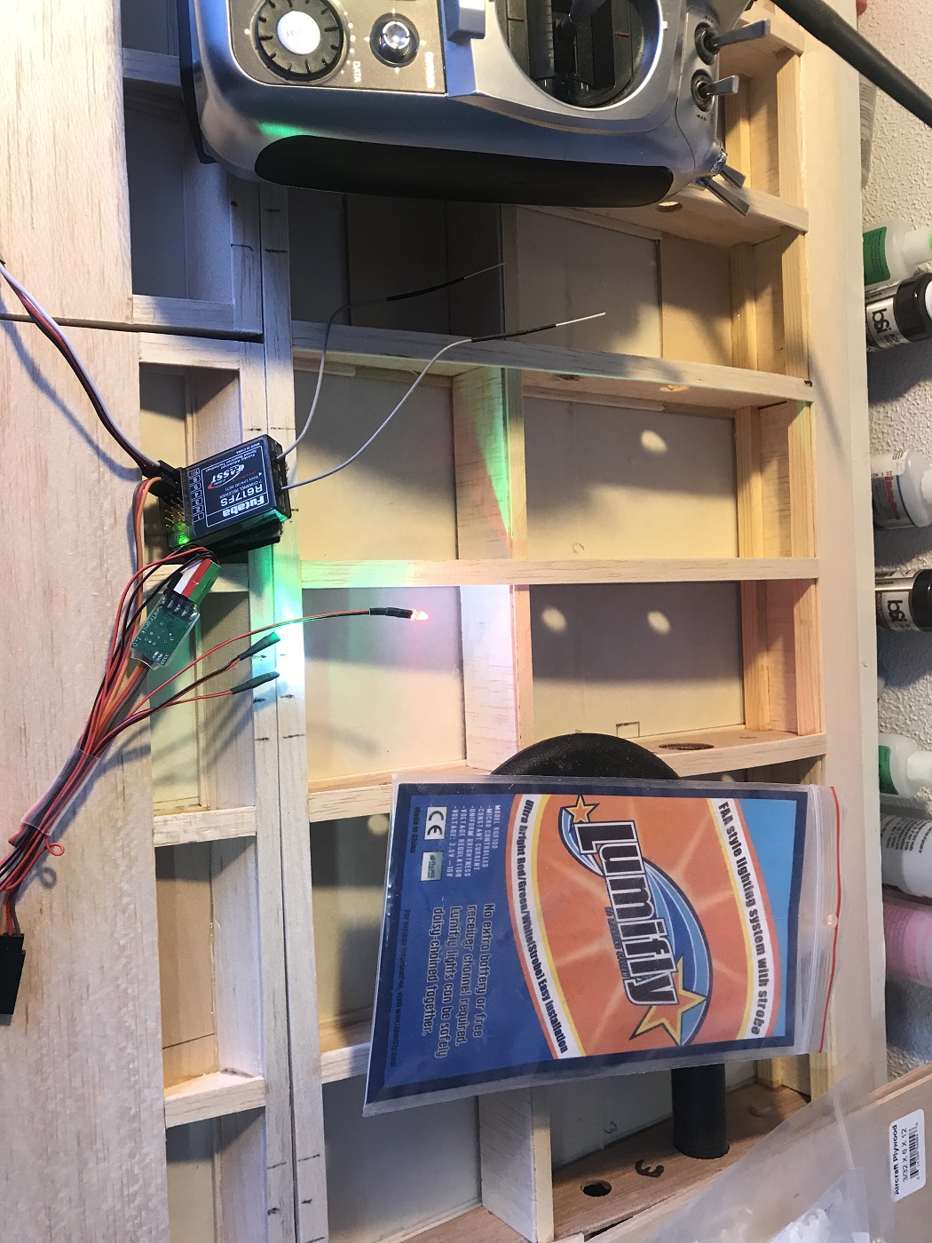

So the lights are powered from the receiver at 2S lipo. That’s handy looks interesting. And the port it is plugged into has control of on/off.
Yep, it plugs right into the receiver and I use an aux switch to turn them on and off. It does work really well.
