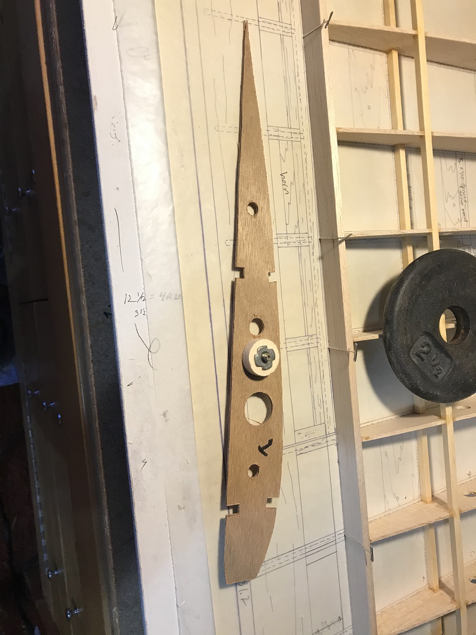

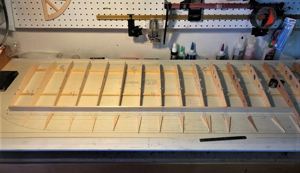

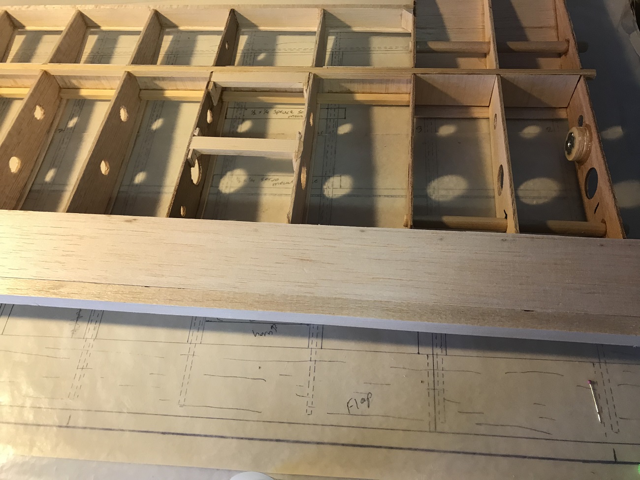

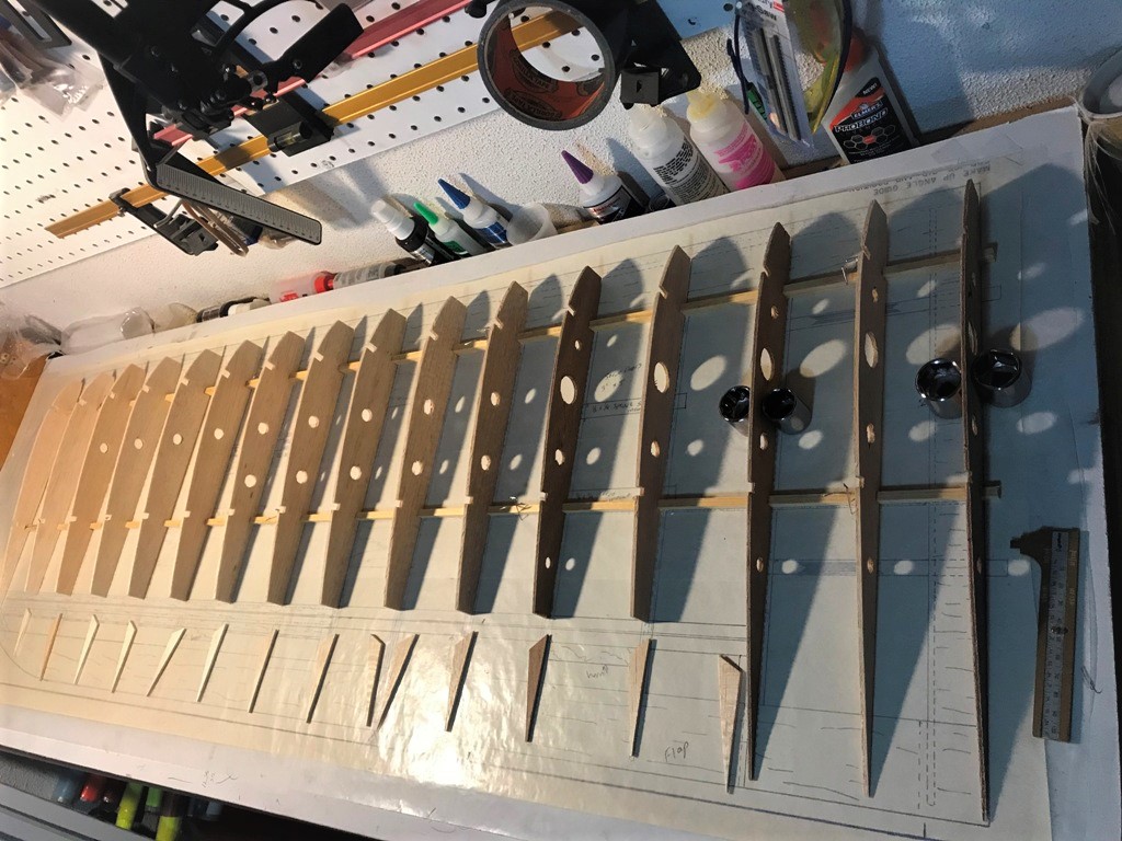

It sure has turned here in Eastern Idaho!

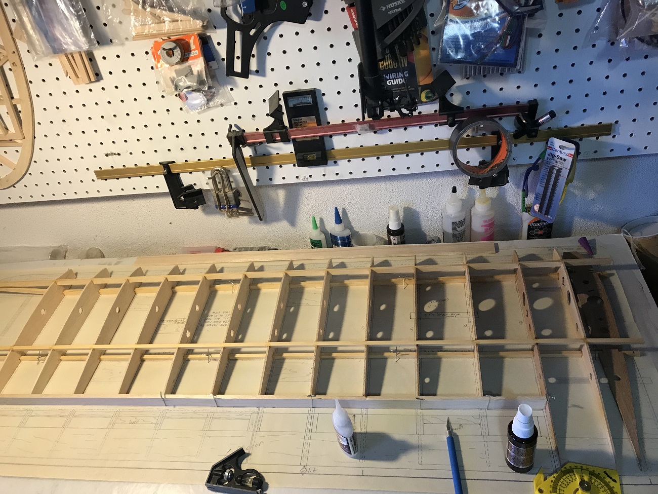

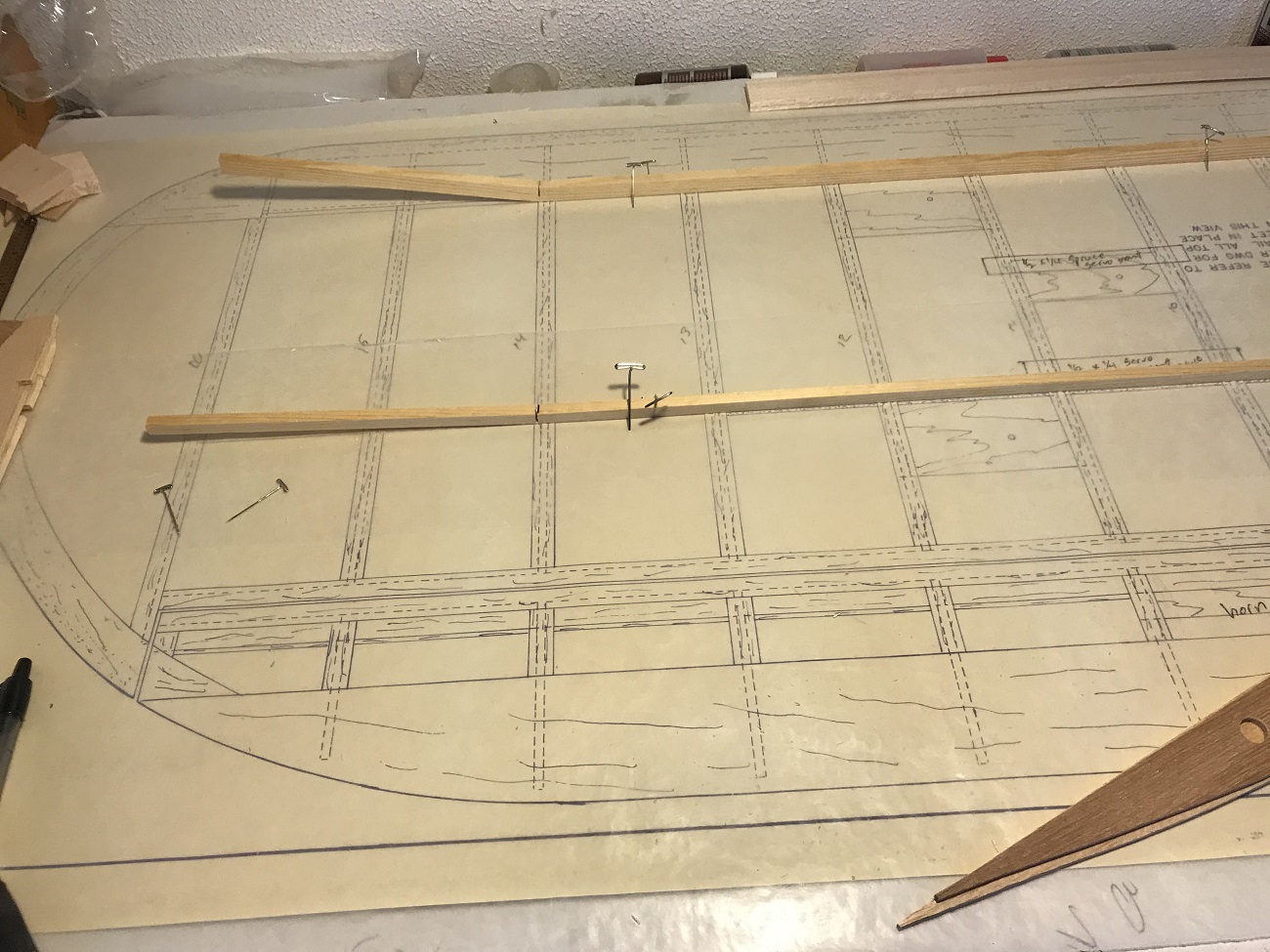

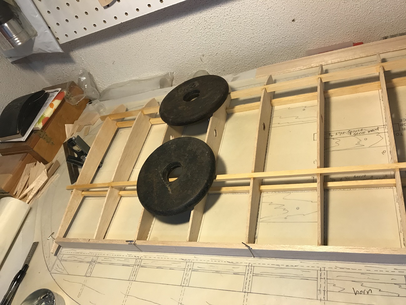

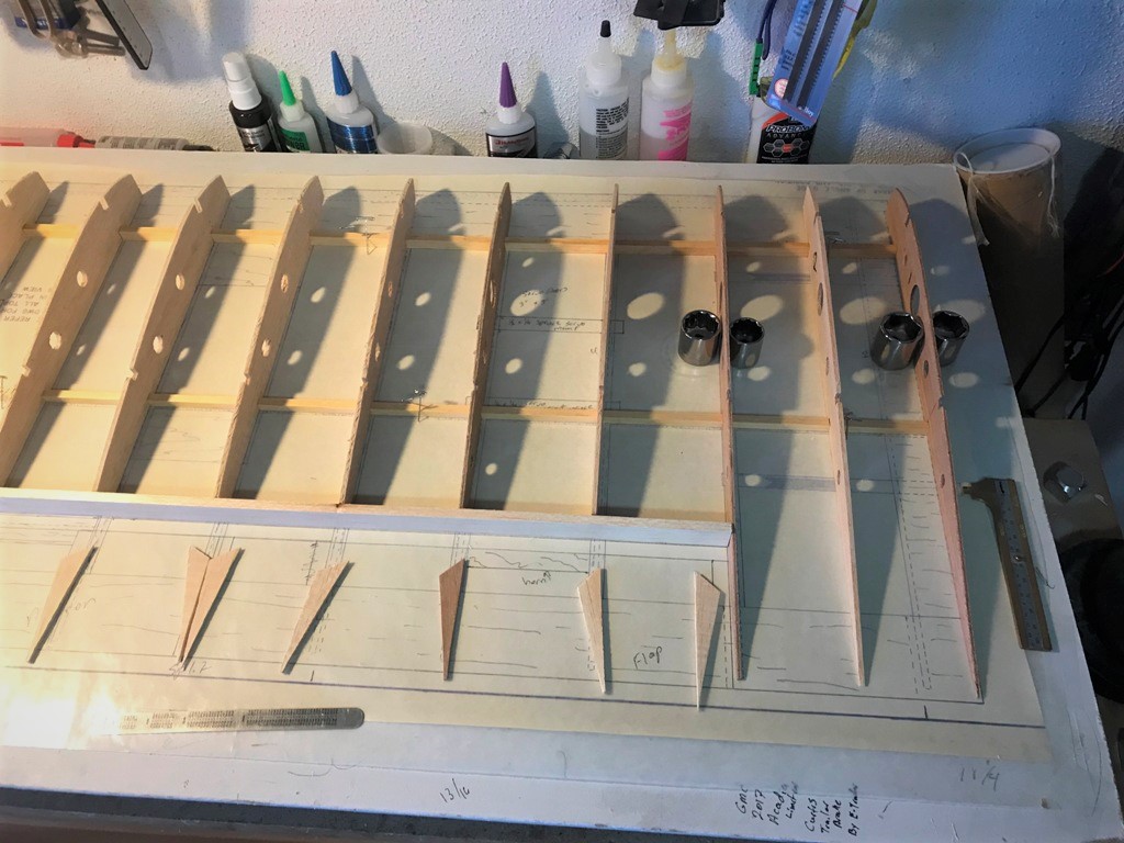

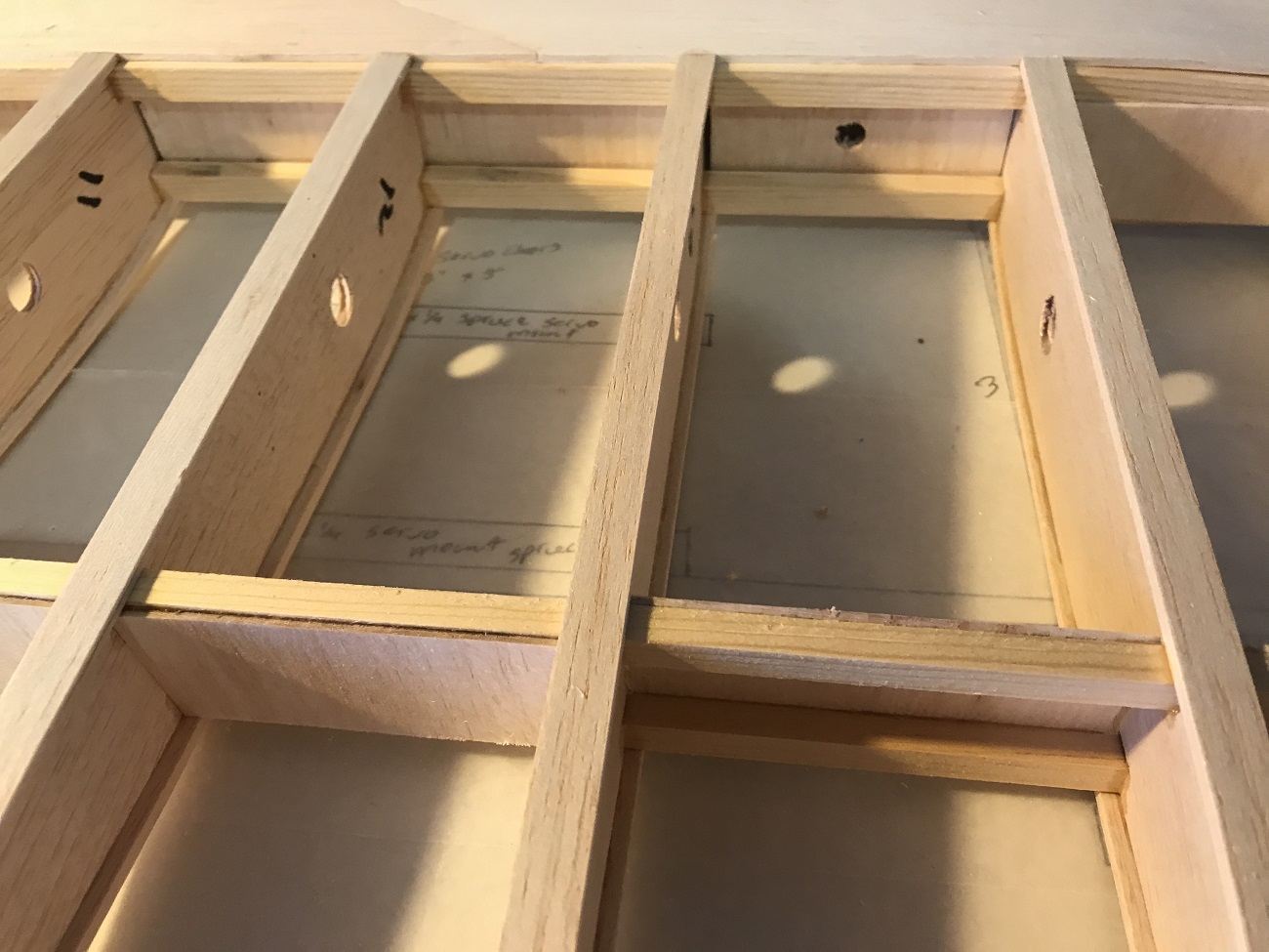

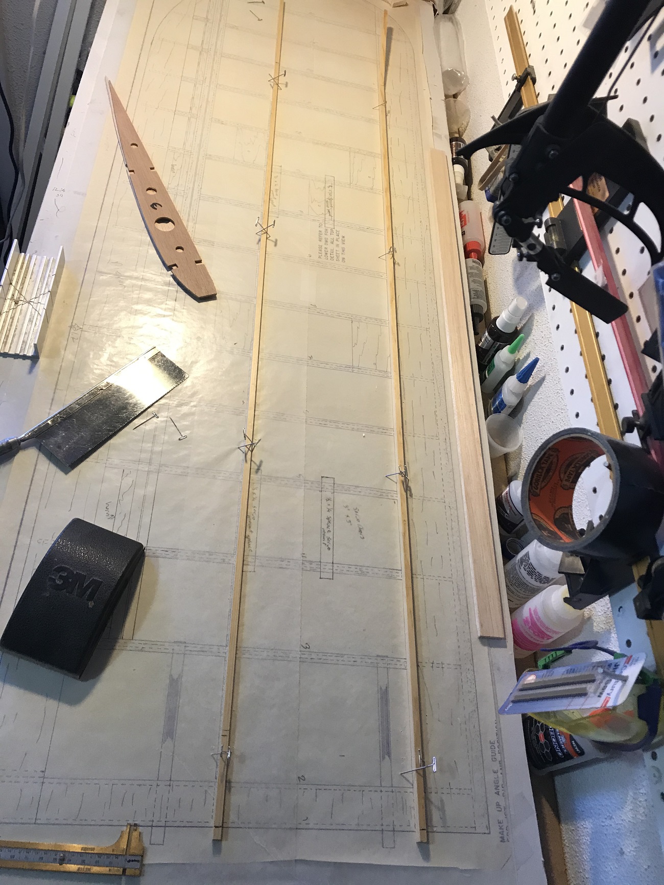

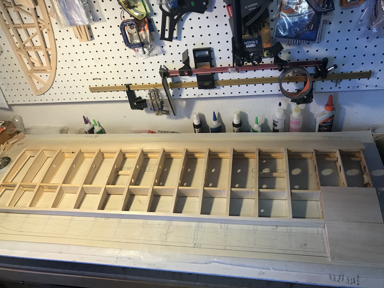

I did a dry run on the ribs, just to make sure I've got all the holes drilled that I need. I'm going to go ahead and make the top of the wing tip flat with the top of the wing, as the plans indicate. I think I'm ready to start gluing! I also cut some servo mounts out of 1/4 X 1/2" spruce. Also cut a new full length trailing edge.

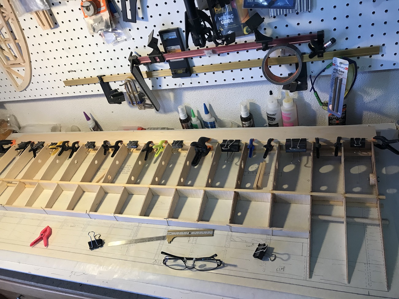

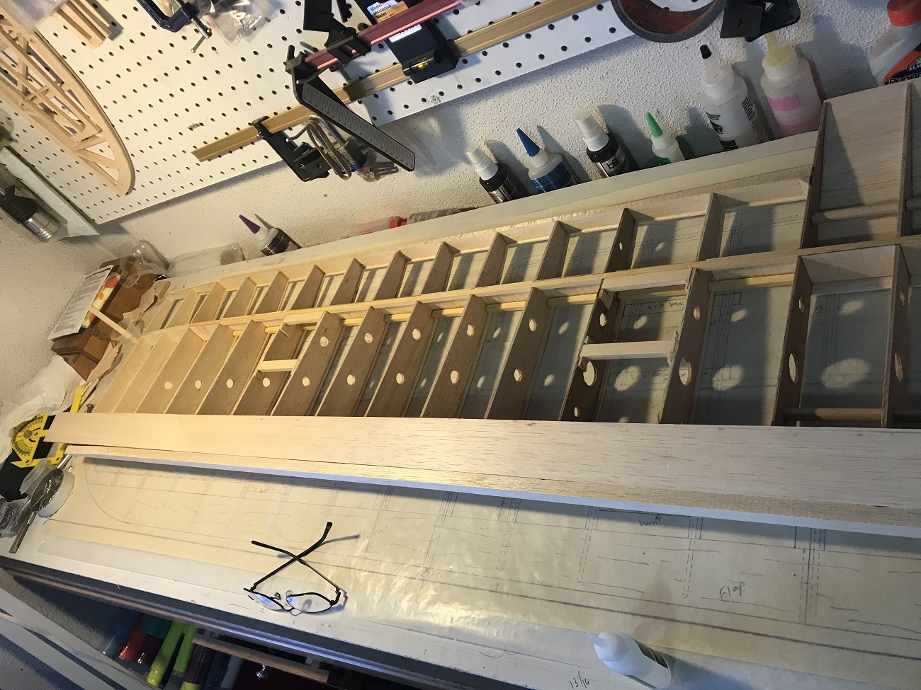

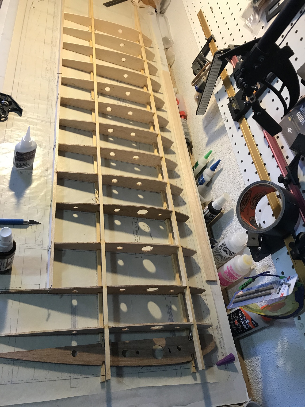

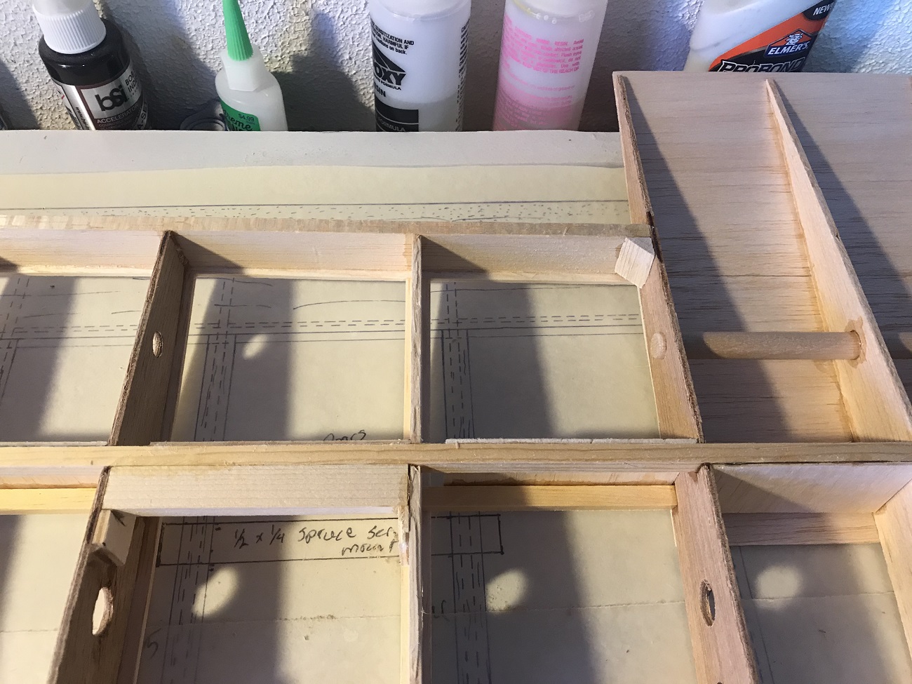

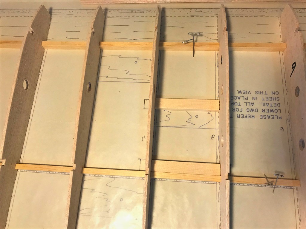

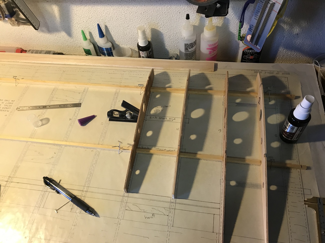

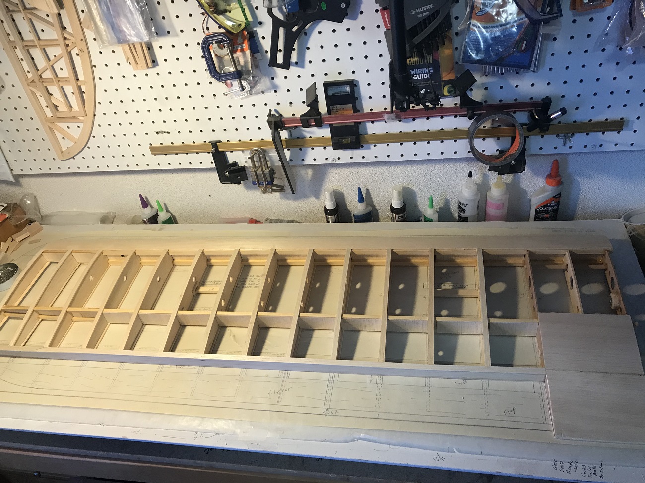

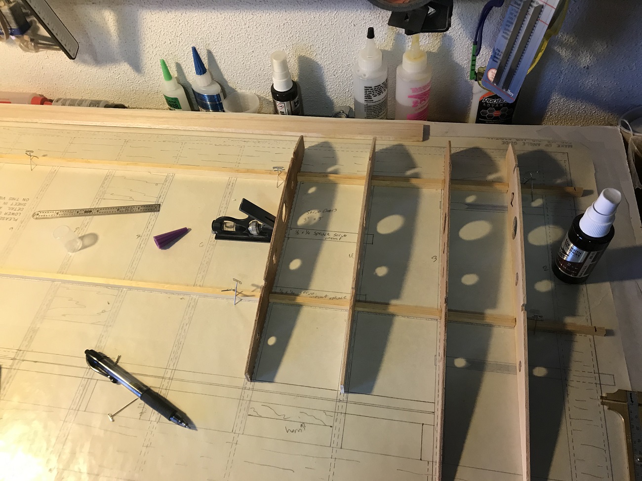

Slow progress as I'm trying to figure every thing out as I go. I built some doublers for the servo rails, put a couple gussets along the trailing edge. I also installed a ply backer on the leading edge where I might install a light kit. Went all the way out with the sheer webs, as the bottom spars are cut at the 3rd rib from the end.
