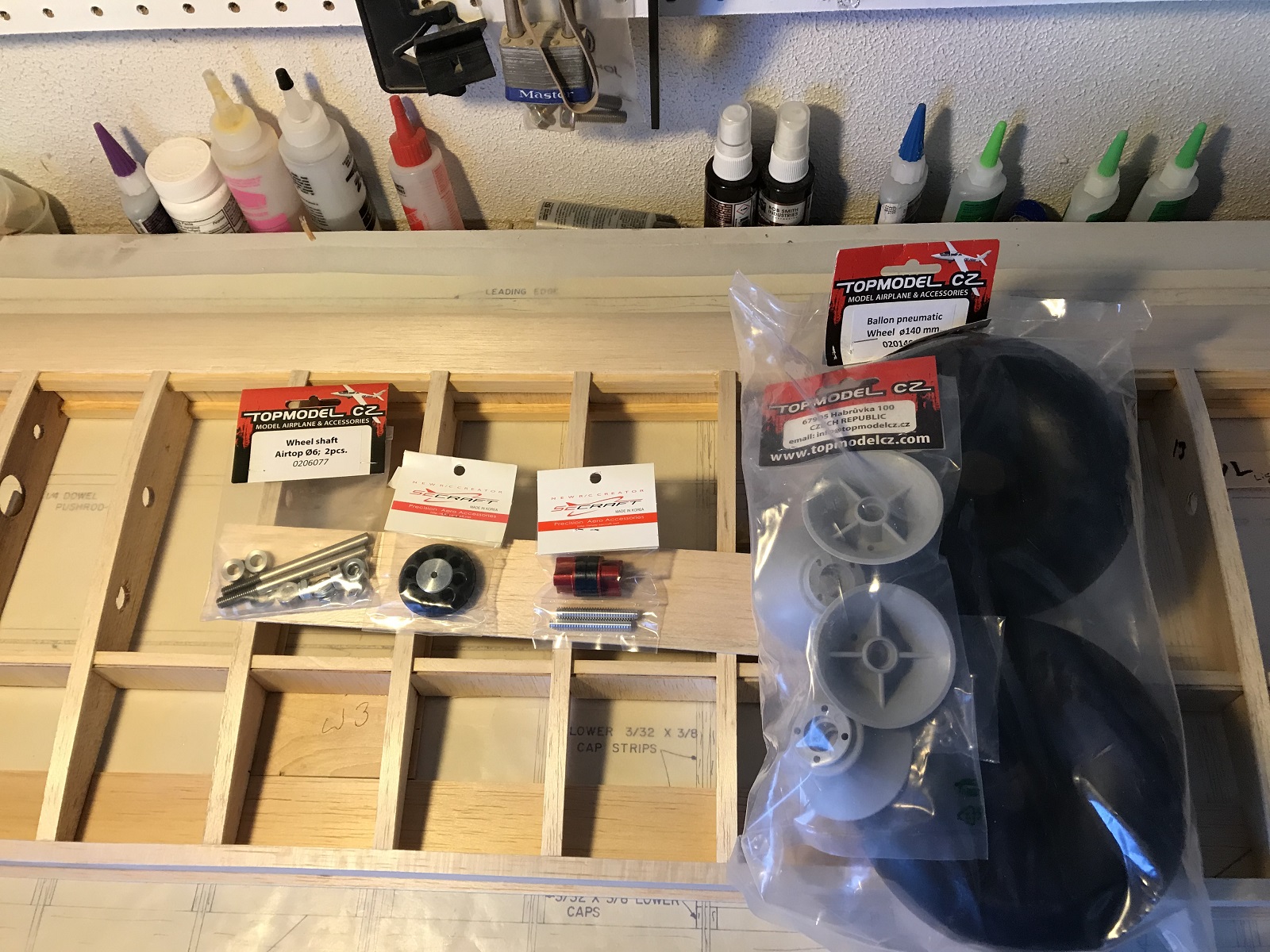

More goodies showed up today.

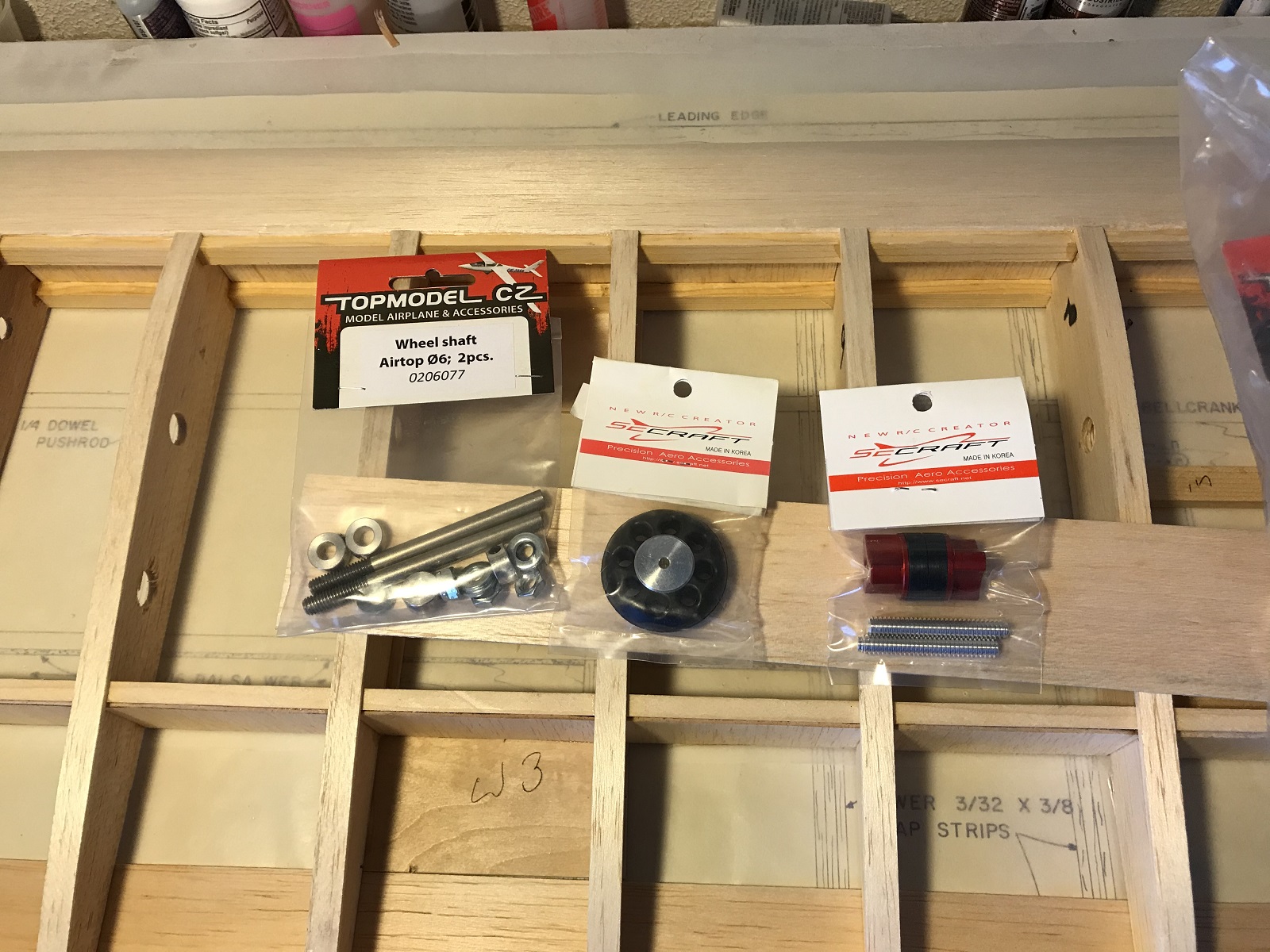

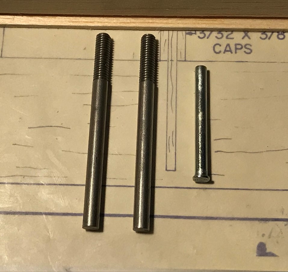

Can one of you guys, with a lathe, machine down these Airtop axles, "just the threaded portion", to the same size as the Robart axle? The Robart axle is 3/16" and the Airtop axles are 1/4".

Sure, you want 1/4" threads turned down to 3/16"? How long do you the 3/16" area to be? Can you make a drawing? I've made 1/4" axles out of 1/4" bolts, turn the head down to 5/16" or so and make it thinner, eliminate the need for wheel collars. The other option is to use 1/4" and 7/32" KS brass tube as a filler in the 1/4" hole on the wheels.

Just shoot me your mailing address and I'll get them out to you. The Robart axle is too short, so I have to use the Airtop Axles. Just turning down the threaded part, plus maybe 1/8" will do great! Thank you!

So just to be certain, you want the threaded portion plus 1/8" past turned down to the diameter of the Robart axle. How would you like the shoulder finished? Square, tapered, or radius? I'm thinking a square end would just butt the Robart housing an look good.
Yep and Yep! Square would be best for fitment. Thanks a bunch for doing this for me! :angel:
