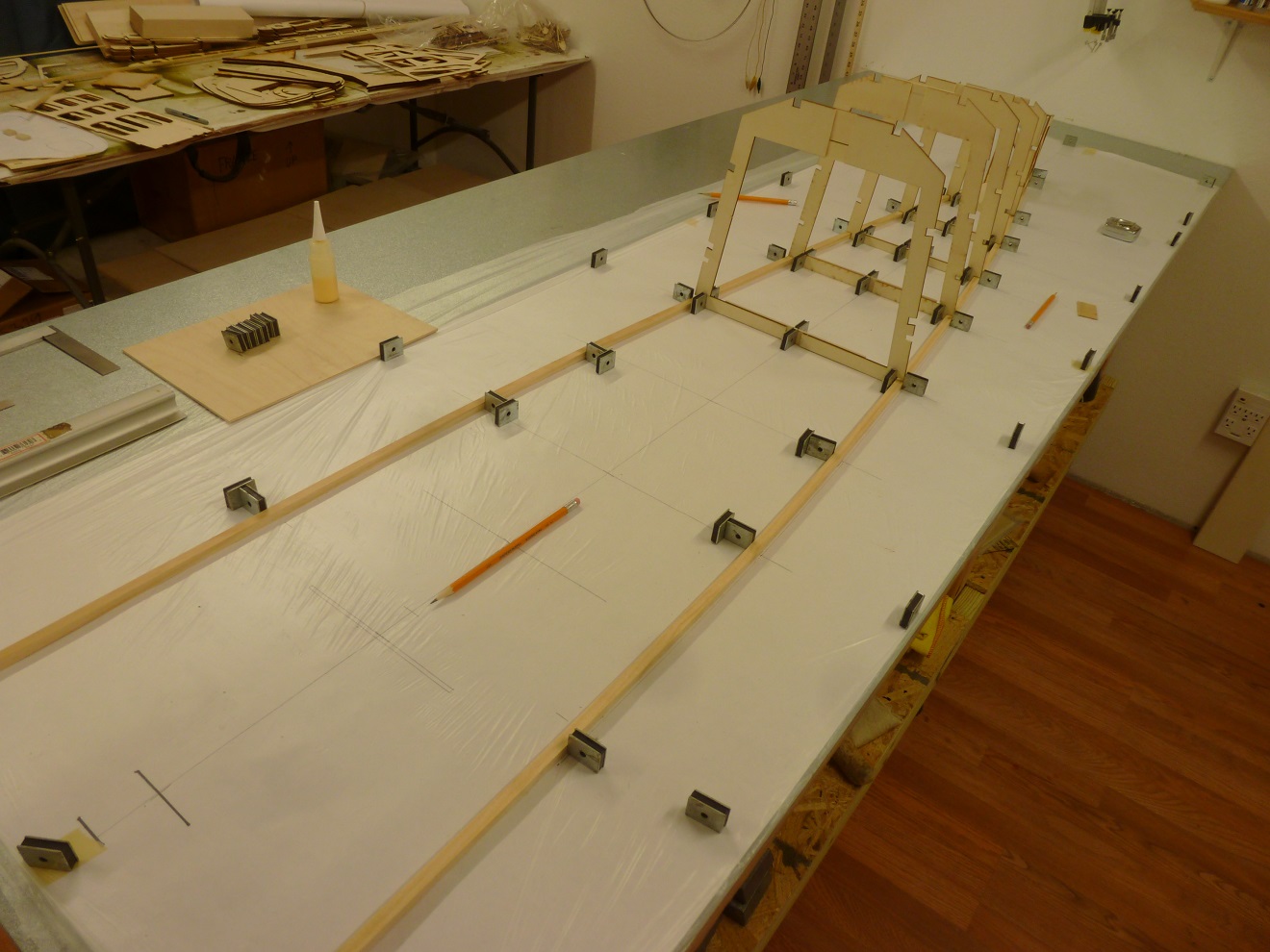

Who was I kidding, only myself. Cut the rear half of the formers in half, widened them to where they need to be, and glued strips across each end.
On the front former shown the side stringer slots are wrong, I cut the one that runs parallel with the datum but will wait to cut the other when the stringers are ready for placement so as to align it properly.

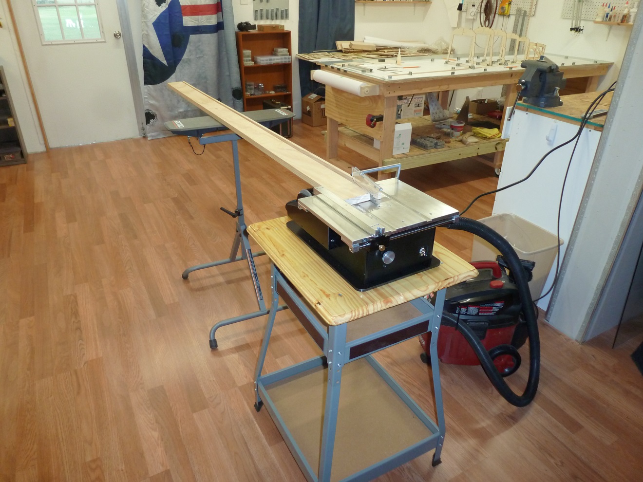

And no more than what I have cut I can honestly say, "I am thoroughly in love with this little table saw!"

Ok, I just ripped a 1x4 select pine for two strips of 11/32nds square and I do mean 11/32nds. How did I ever get along without it. Seriously, if you do any kind of building this is an absolute must have.

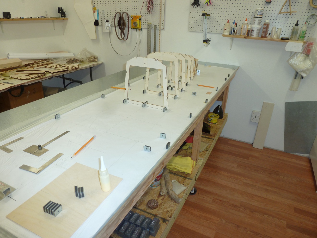

The two hardwood's on the thrust line are in place, now to cut a few strips of balsa.

I have that saw for a number of years and I do not think I could build without it. It is always within arms reach.
Nice building board looking at your setup it looks like you build on a steel plate and magnets. Never tried it but looks interesting. What do you have the steel plate covered with.
The steel top is galvanized and has no covering. The paper drawing is covered with painters plastic, nothing sticks to it.
