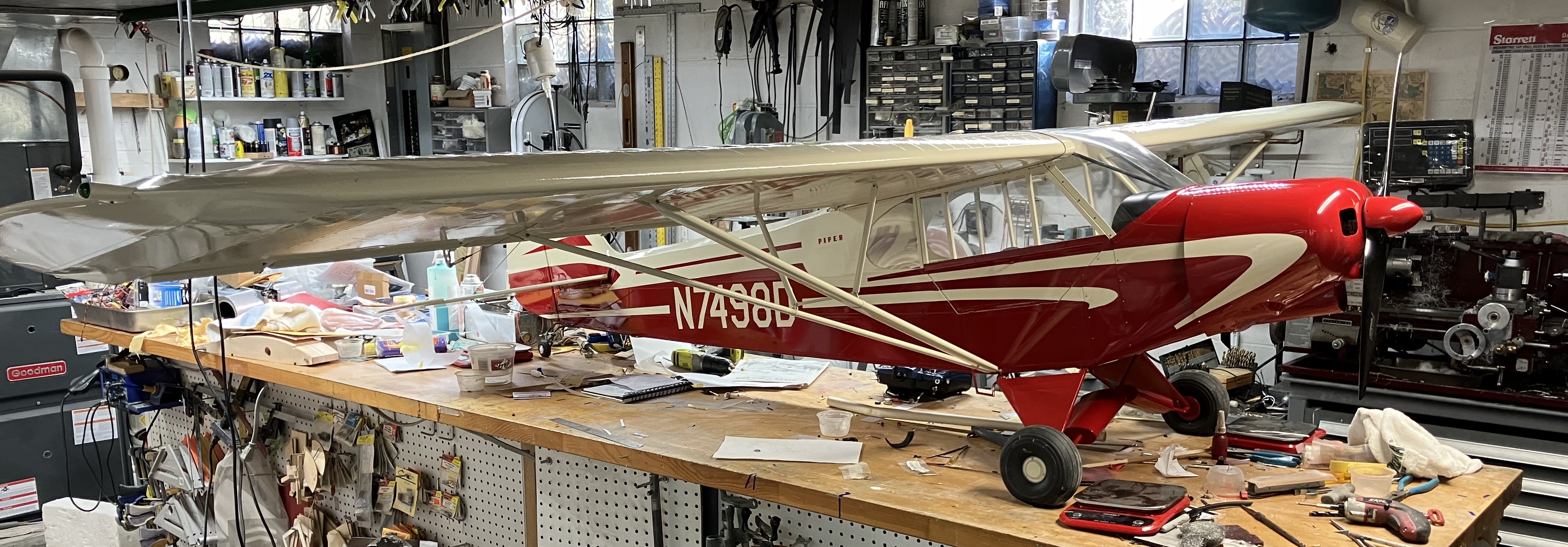

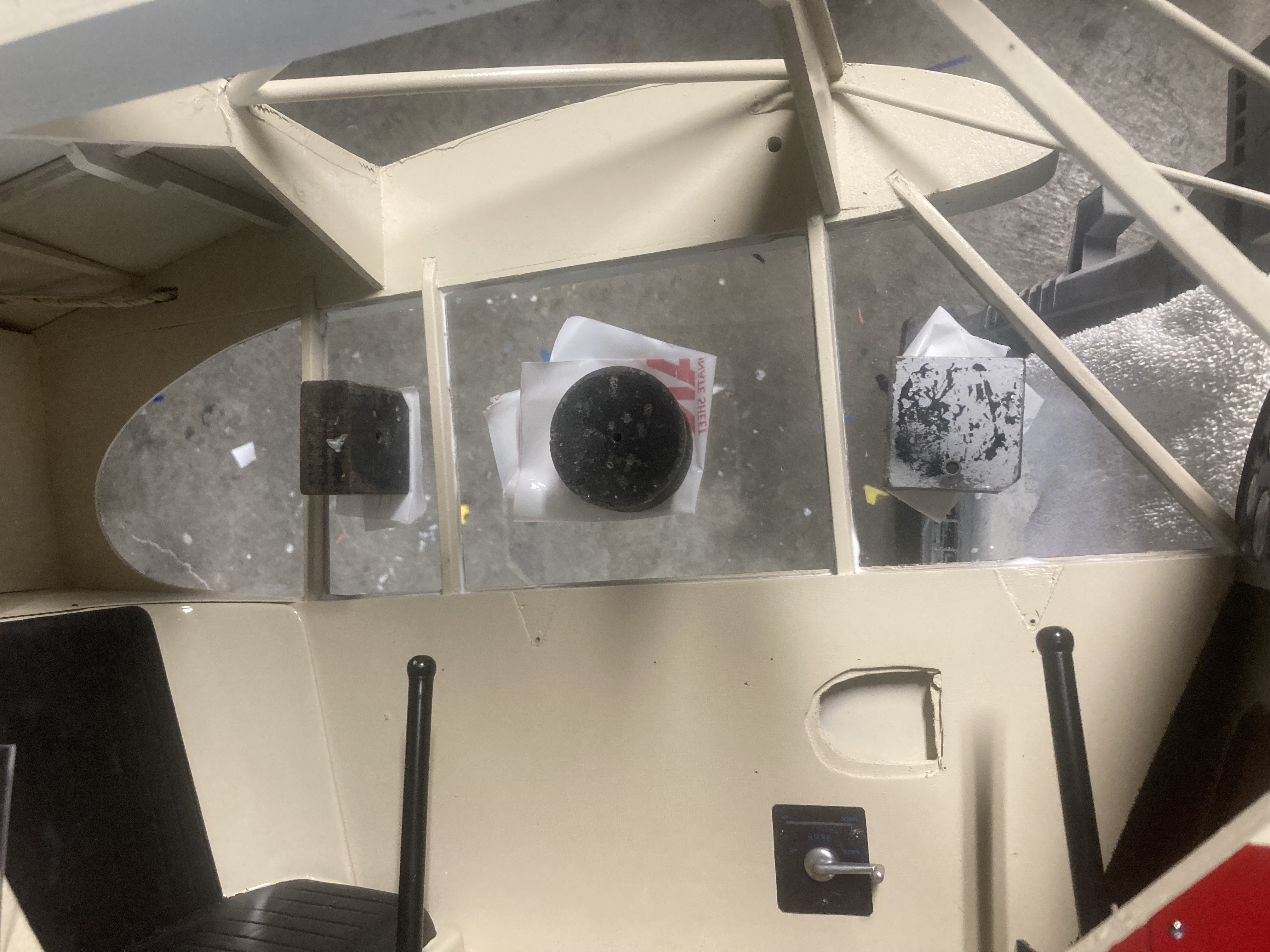

Spent most of today gluing in the side windows. Using .040" polycarbonate (Lexan) sheet. Much stiffer and more scratch resistant to PETG sheet. Using 560 canopy glue. The right side is already completed. Fuel tanks and batteries are next and I can put the plane on it's front paws and hind leg. Right now it is on saw horses. Might get it in the air for September. I really can't wait to start laying up the Cherokee mold.

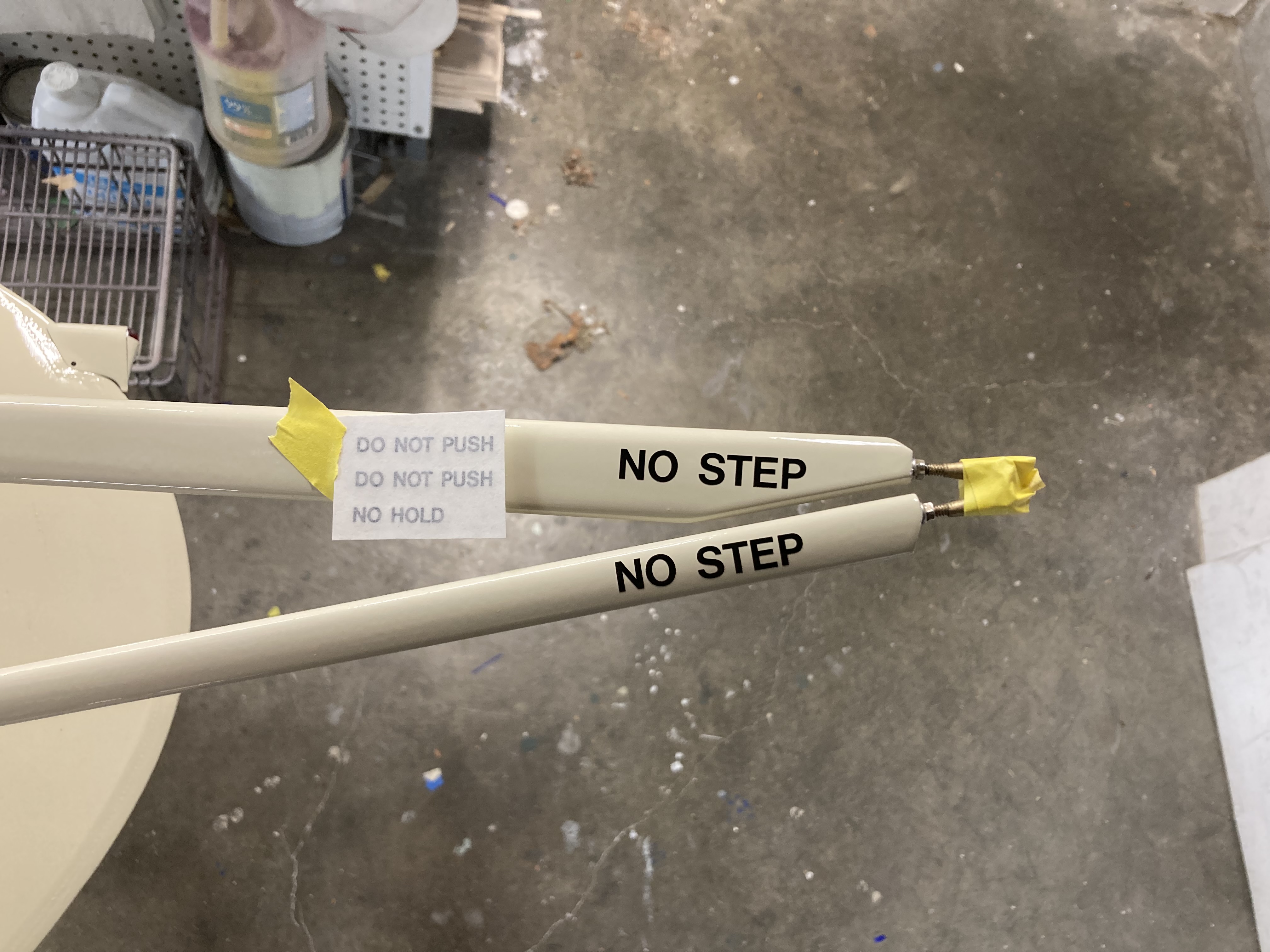

Aero Graphics cut the NO STEP, DO NOT PUSH, and NO HOLD graphics from their standard set of exterior graphics for the Super Cub. I know where the NO STEP goes, anyone have an idea where the rest belong? Only exterior I found on the Super Cub drawing site were for a military PA18.
  • Piper_PA-18_Super_Cub_Exterior_AeroGraphics_Placards.pdf

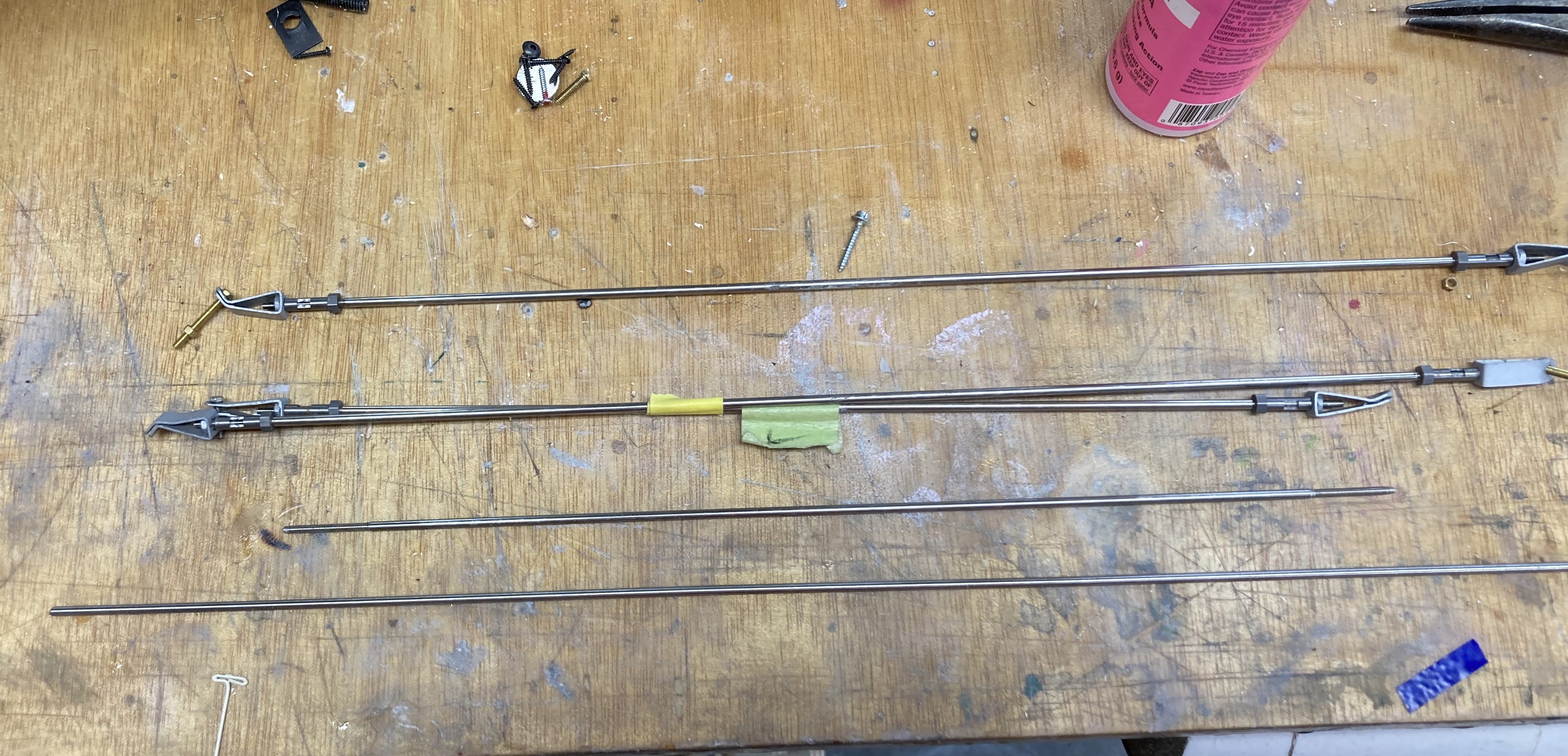

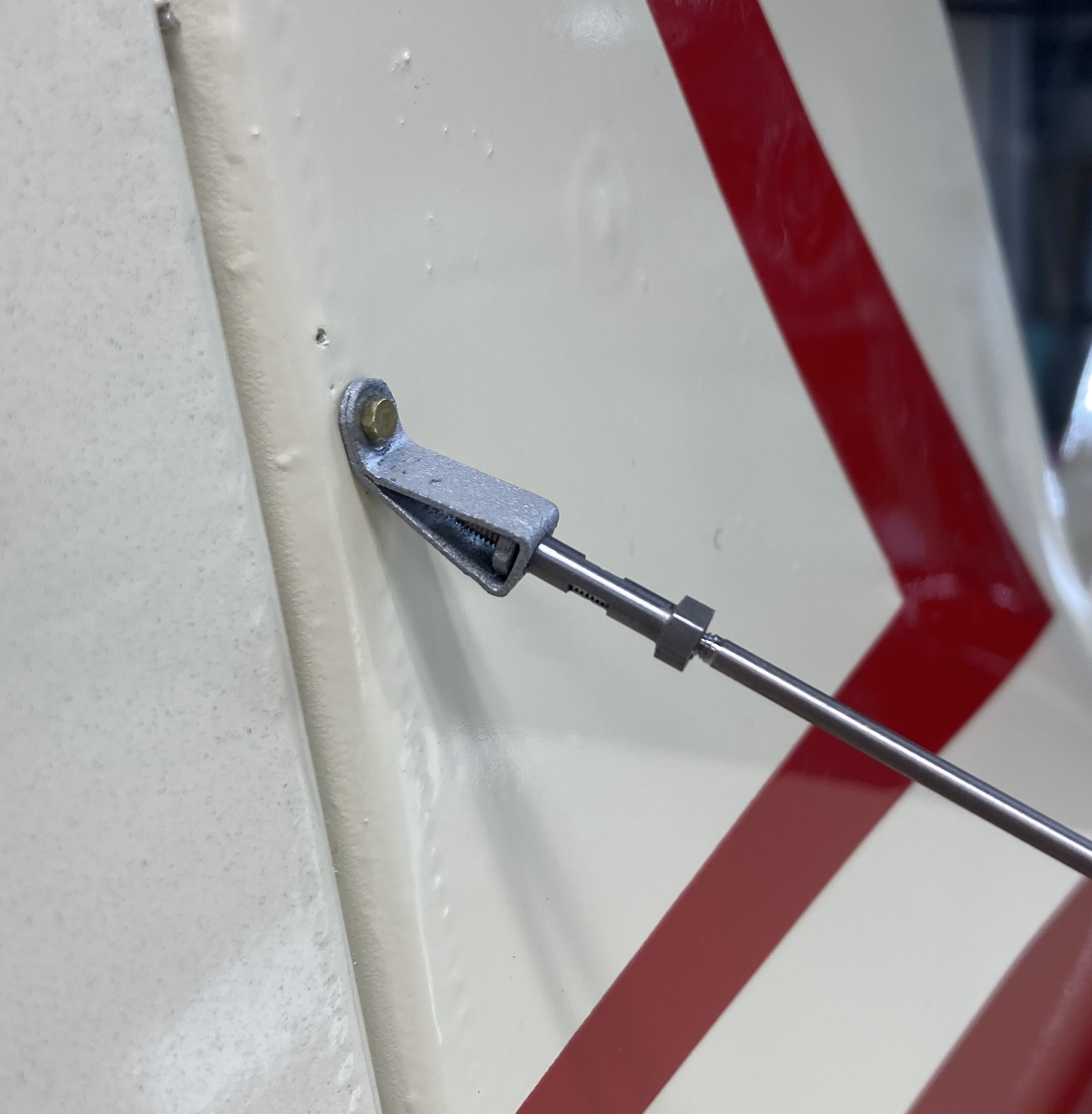

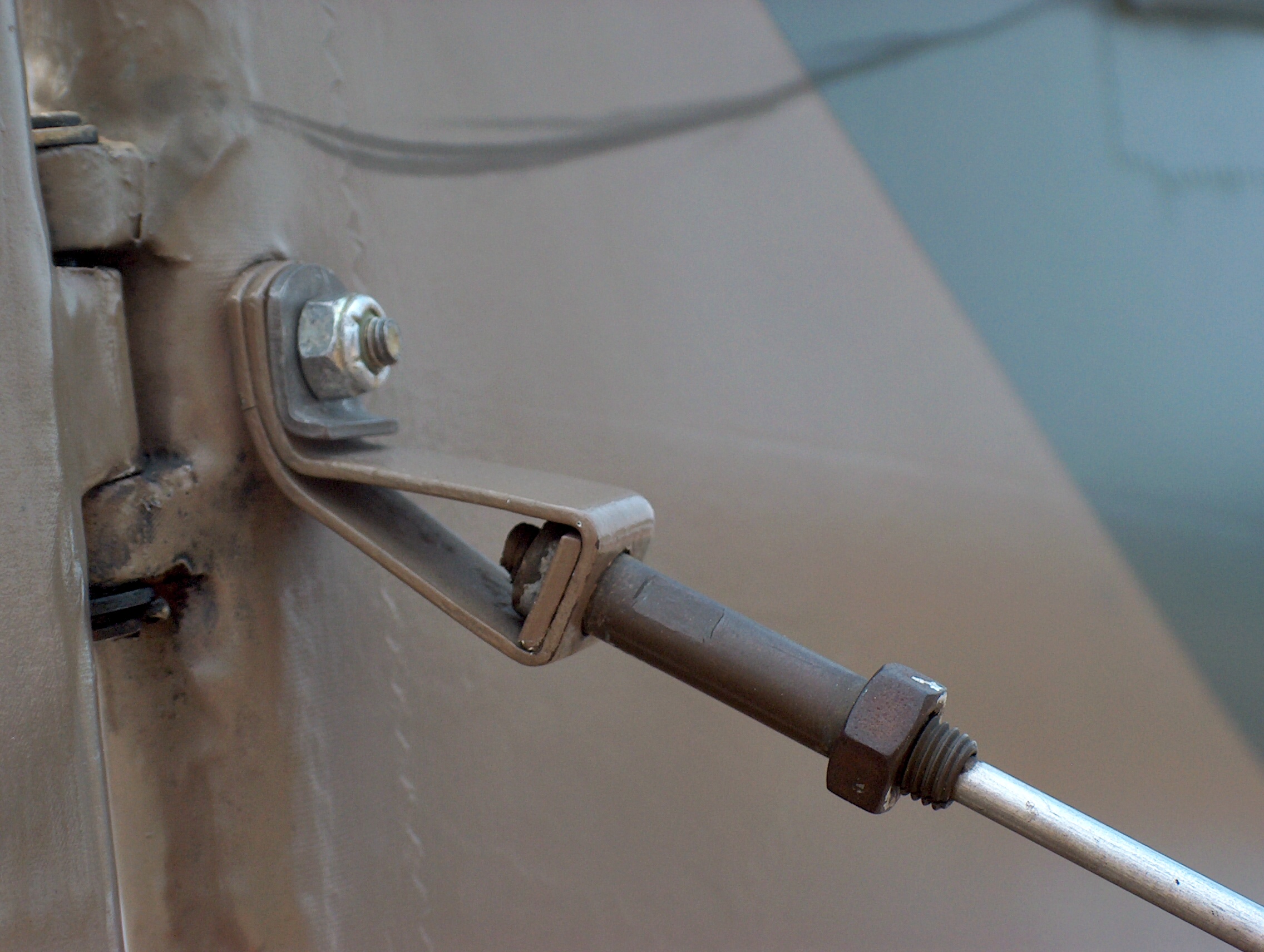

Have the engine installed and just about ready to fire it up. Working on the tail brace wires now. The initial weight and balance indicated a tail heavy condition so I decided to replace the stainless steel tail brace wires with titanium TIG filler wire. The wires on the top are the original SS wires, the bottom wire is a piece of 3/32" titanium filler wire. This is my first exposure to titanium, in machines and threads well. Putting 2-56 threads on the wire after reducing the diameter by .005". The total weight savings will be about 16 grams which leads to 2 ounces less nose weight or a total weight saving of 2 1/2 ounces. Two wires are completed, two to go.

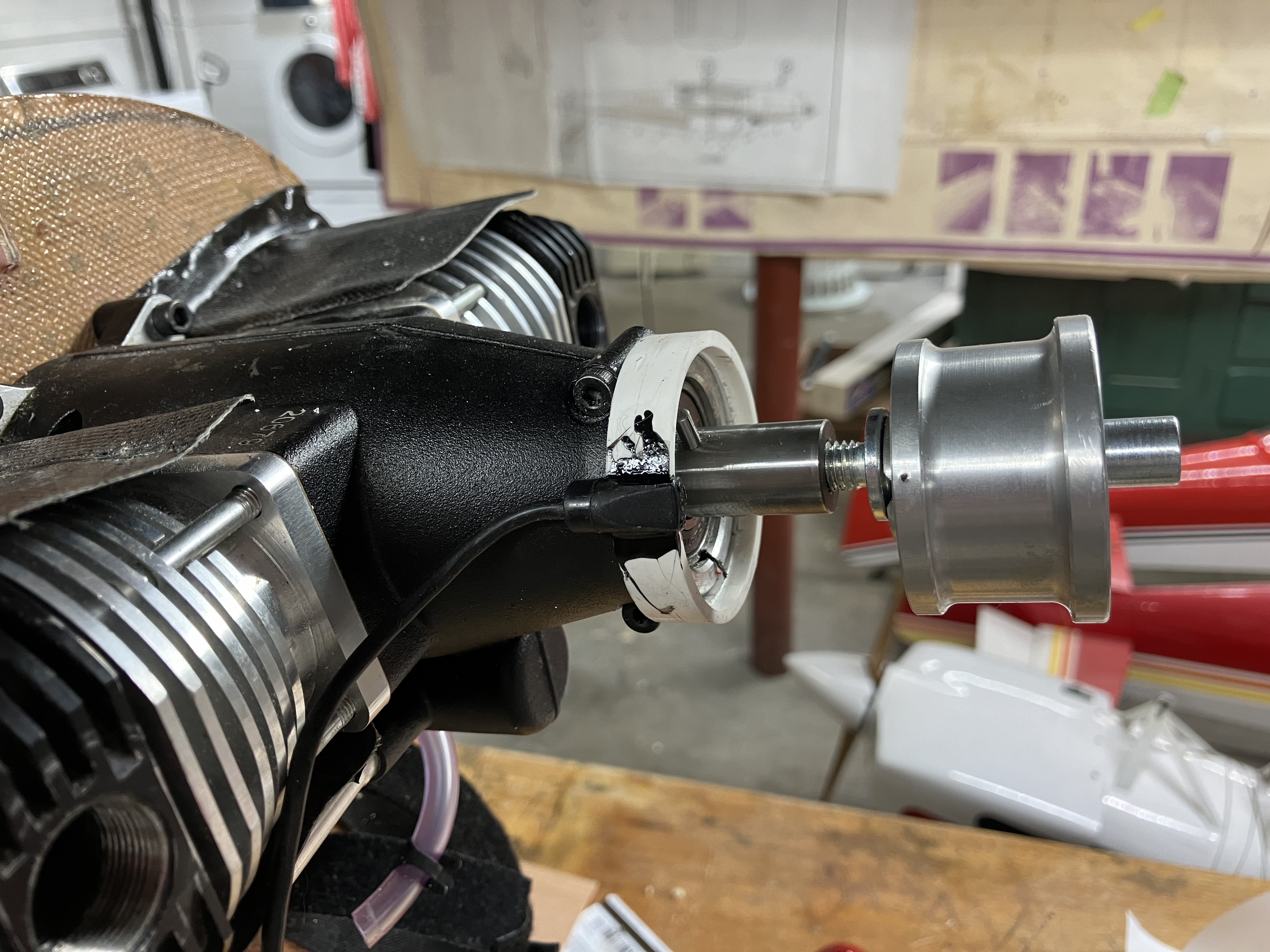

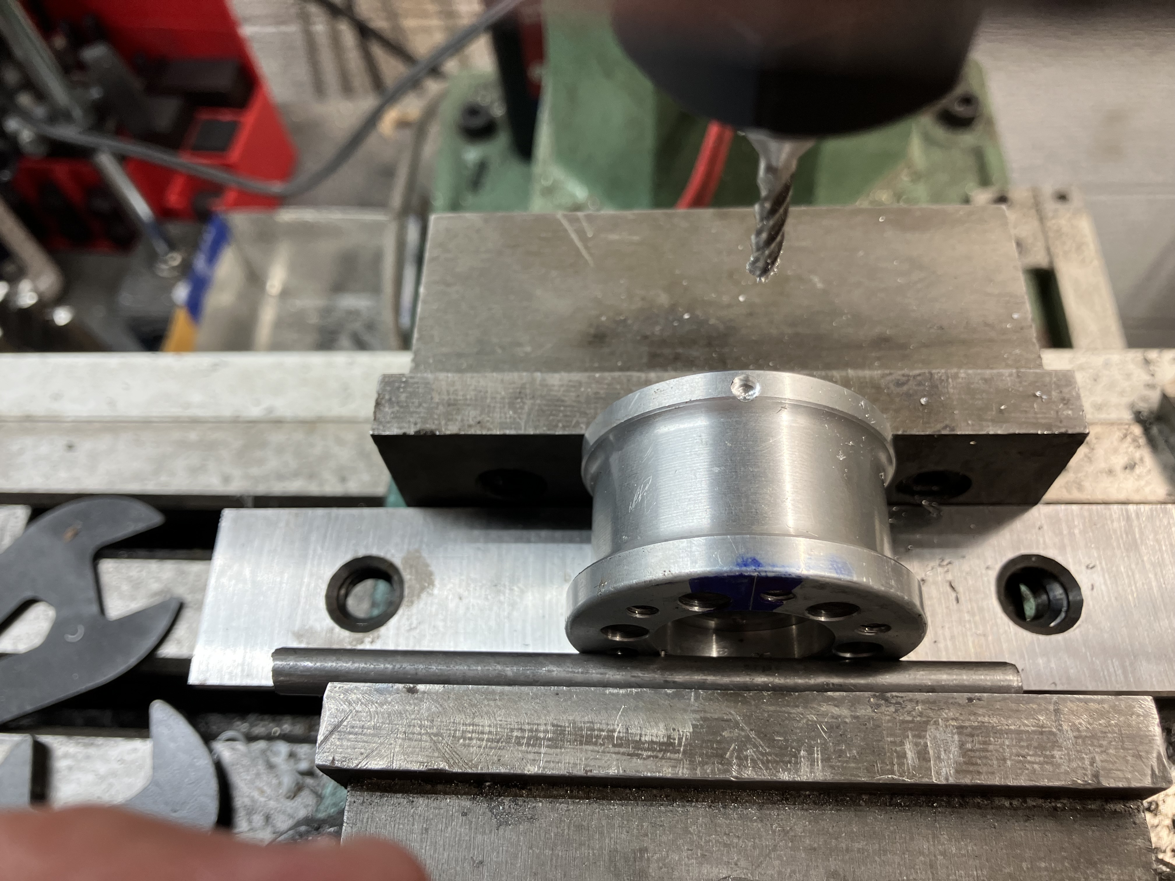

I could not determine what Roto uses to trigger the ignition so I decided to add a Hall sensor and magnets to the engine. I pulled the prop hub and surprised to find it is a straight bore and not tapered. It came off with a little heating with the puller engaged. 1 1/2" pvc pipe was used the make the Hall sensor holder ring as shown in photo below while actual holder was cut off a commercial ignition holder. This is attached with rubberized CA, seems to hold well. 1/8" x 1/16" rare earth magnets were ordered from Amazon and should be here on Wednesday, these will be installed after the hub is reinstalled since heat man damage the magnets. Installing two magnets 180 degrees apart to improve low end resolution. The tach in the Champ drops out at 1000 rpm.
I tested the Roto trigger sensor with a VOM and found a meg ohm resistance between each wire, also checked with a DLE ignition tester and could not get any trigger for both south and north magnets. Proping the engine over with while measuring the voltage found nothing as well. I don't knows what's inside but I sure hope it runs.
