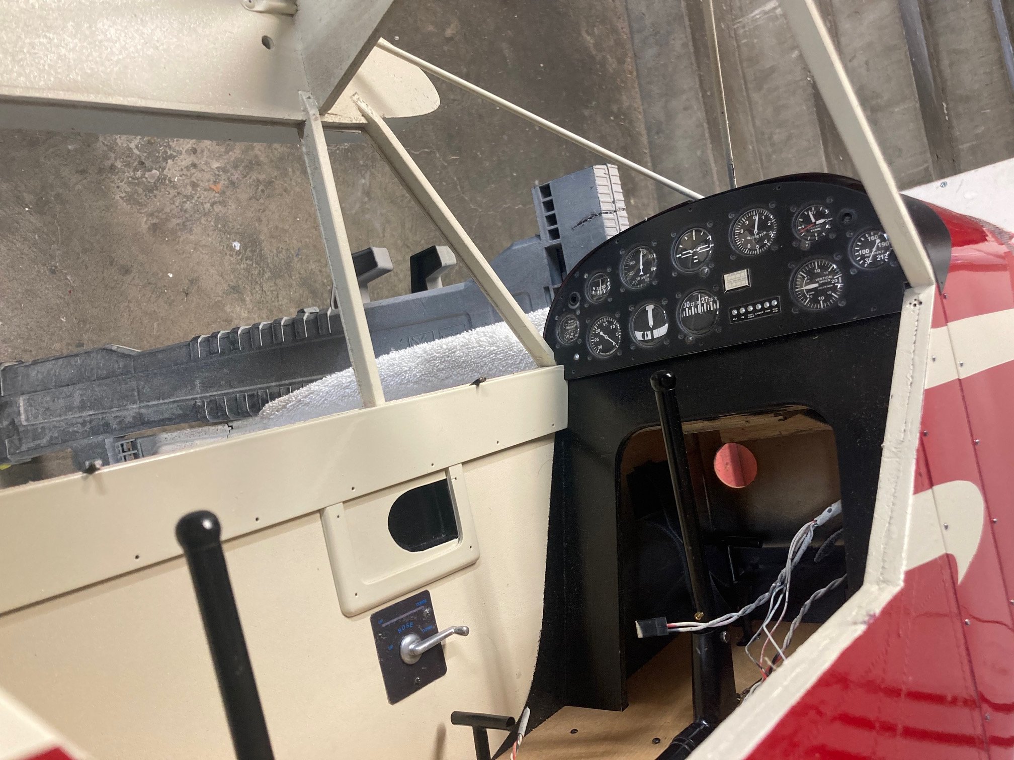

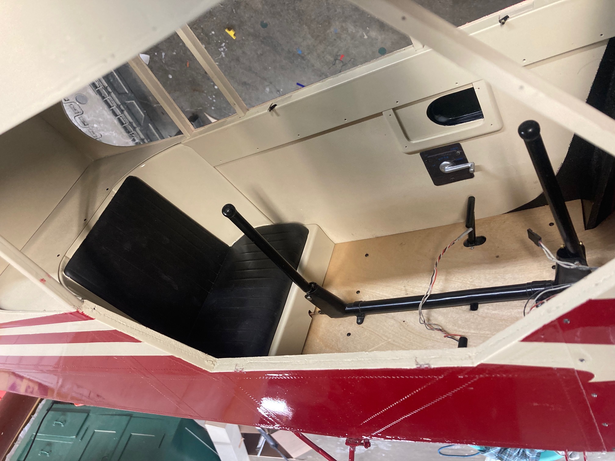

Assembling the interior, the front seat will remain out until the fuel system and ignition are installed.
