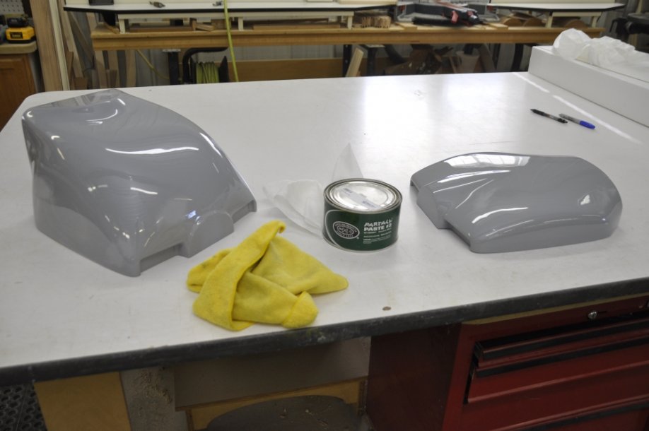

Back in the shop today but won't me much exciting happening on the CAP. I buffed off a couple of dust particles with 1000 and today's project is 6-8 coats of mold release wax, and maybe later assemble parting boards.
Wax on, buff off with microfiber, wait one hour, repeat......

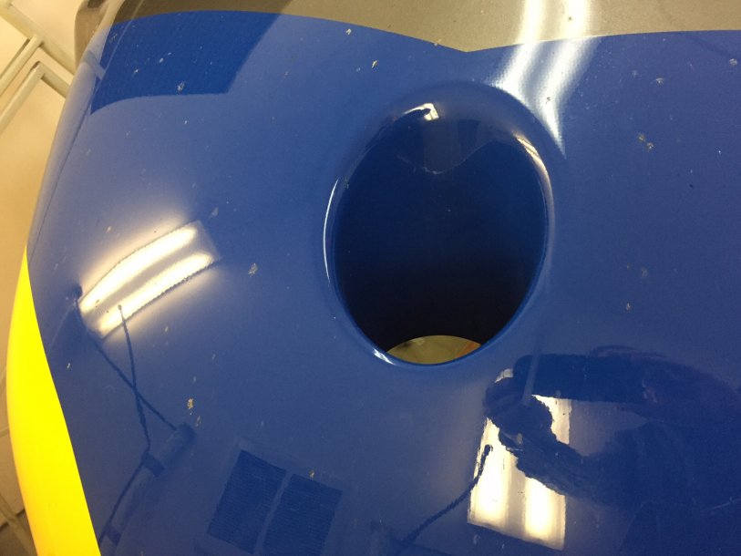

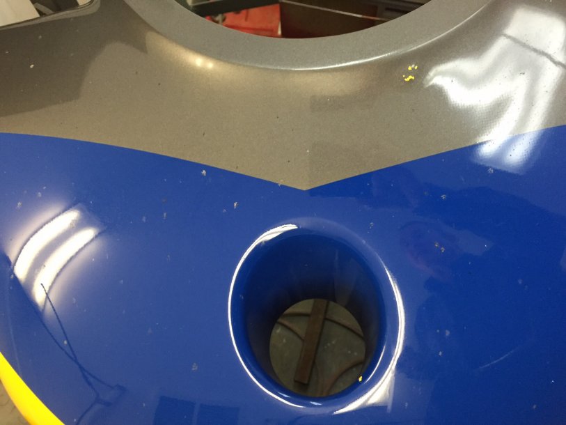

I always liked that version of the CAP cowl... Made it much easier to design a flowing paint design, unlike the cheeked version that all CAPs left the factory with. It was made by a fellow in Texas...not sure how many he sold... Figured I'd share a couple pix of the air inlet on my cowl for reference.
Terryscustom
OOOHHH, I like that!! An innie instead of an outie snorkel! I think I'm going to do that. I'll make a mold for it and lay it up separately and install it after the cowl is made. I plan to do the same for baffles for the engine. Thanks Matt!!!
