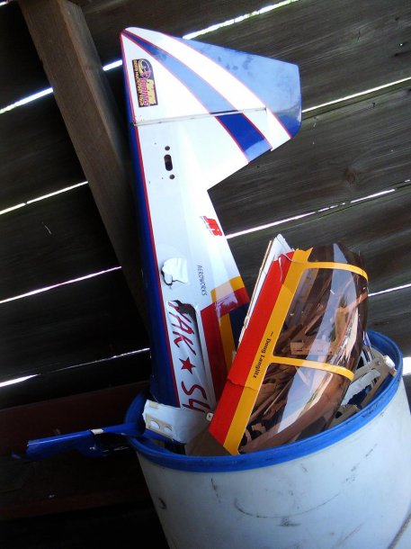

Sounds like a good plan. I can tell you what can happen if number 4 isn't right. Eventually your airplane winds up looking like this.

I'm sure it wont. I know your a perfectionist and that you wouldn't be happy with an airplane you designed that didn't fly great. The airplane in the picture I posted would snap off to the right every time you breathed too hard on the elevator at any kind of speed. I tried all kinds of fixes, none of which worked, until the three T's, Too low, Too fast and Too much elevator, fixed it permanently as seen in the picture.
