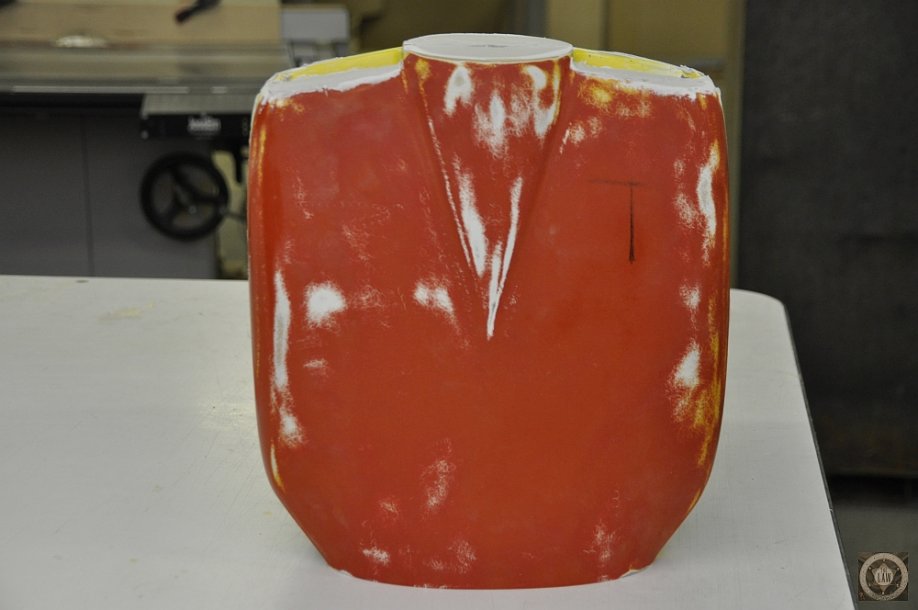

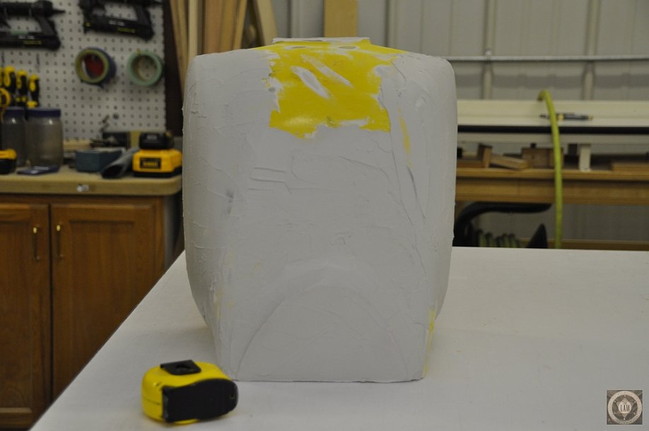

I've put a few more layers of foam on and really getting some shape. I really think if there was a snorkel it would be so short it would look bad so I think I'm going to leave it off. For our engines the prop is back a little further than scale so the front is snubbed a little bit. I'm going to spread some filler and try to take a couple pics before I call it done for today.

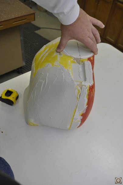

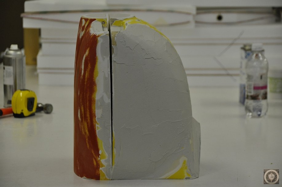

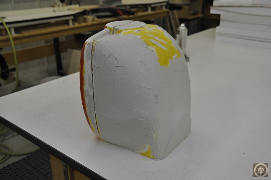

OK, now we're getting somewhere. If you look under the globs and smears of drywall compound there is almost a really badass cowl cap starting to take shape!!! Tomorrow I get to sand on this and grind about 1/4" off the top above the openings, that should be exciting! That is where the foam that is now inside the cowl will really make sense. I've already cut some fiberglass out of the back corners to round out the belly a little more and will likely be shaping that more tomorrow as well.
Right now it's beer thirty and The LAW says it's time for supper so more in the AM.
