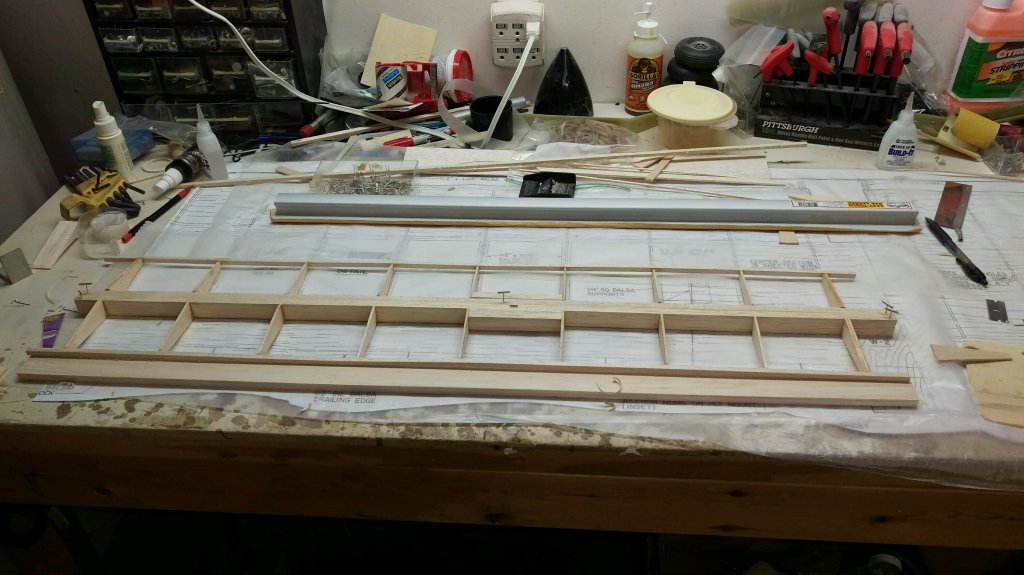

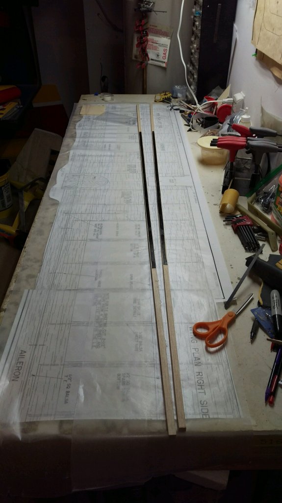

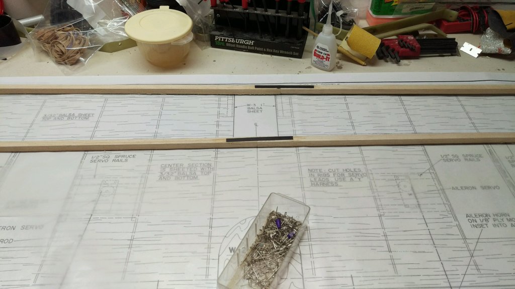

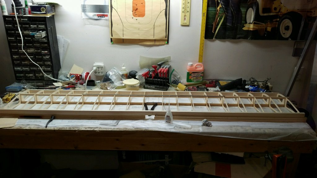

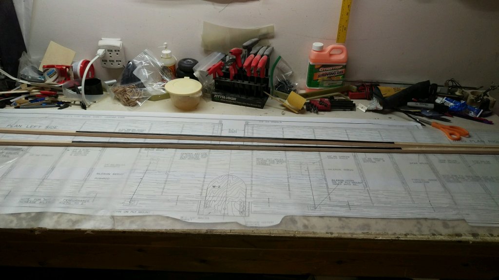

So construction began with the wing. The plans called for Spruce Spars. I didn't have spruce nor did I want to buy any so I used hard balsa, and added carbon tow to the outside, and a very short piece of scrap I had to the inside center section.

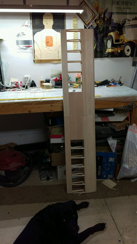

The original wing span is 81" or so which I felt like was too much so I am clipping one bay off. This also allows me to use 36" wood without a splice.

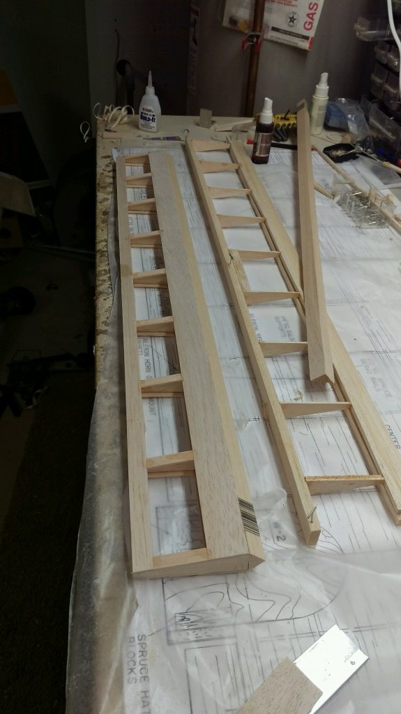

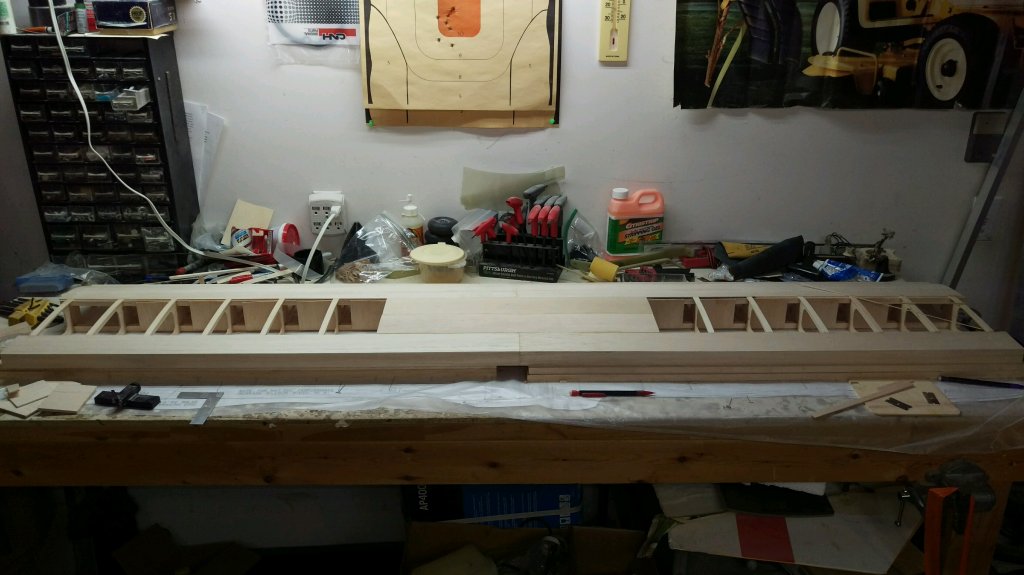

Here you can see wing rough framed with sheeting and shear webs etc all installed. I have not added the servo mounts yet as I am moving them out a little to center then in the ailerons.

You may notice the black dog in some of my posts. That' my 115lb Rottie puppy Tough! Unfortunately he loves to eat Balsa wood but then throws in back up. I can tell you the only thing that gets you out of bed quicker than a suspected intruder is the sounds of a dog about to yak on the carpet....

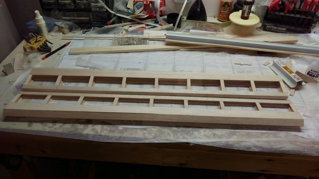

Once the wing was framed it was on to building the rons. The plans call for strip rons that are I think 1.5" in cord. I made my own rons using the TLAR method and the wing plan as a guide. These are 3 3/4" not including the 3/4" tri stock I used for the leading edge. I also moved the servo horn attach point to a more centered position.
