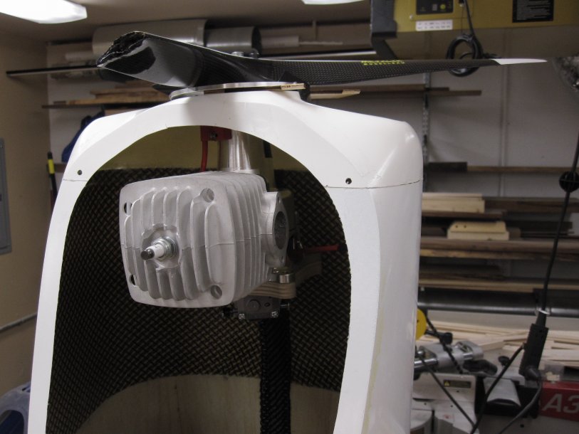

ANYWAY...Got some time to get back to the Raven and work on drilling the engine mount holes into the firewall. Earlier I showed how I located the engine based on the front of the fuse as it has both the diameter to match the spinner as well as the thrust angle built into it. that sets the spinner backplate location perfectly and gives me thrust angle.

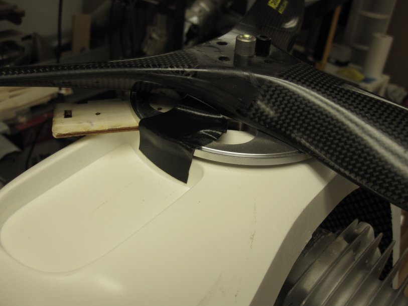

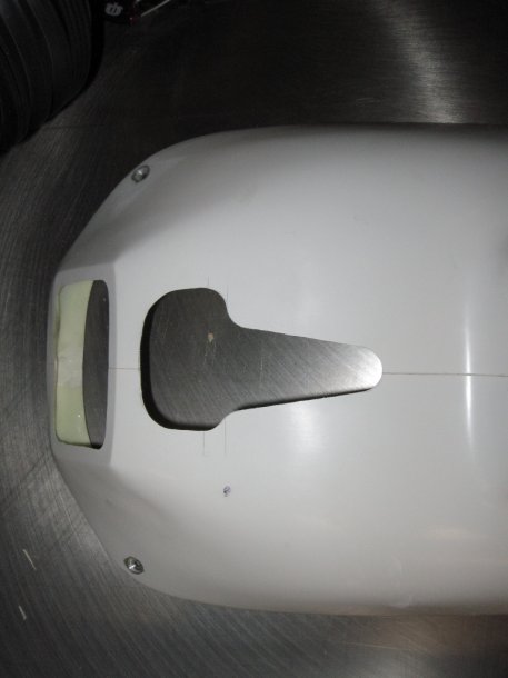

I determined that the best engine mount position was cylinder exactly down, so I cut clearance in the engine bay hatch for the tiny bit of cylinder that sticks out as well as the spark plug wire...
Wacobipe

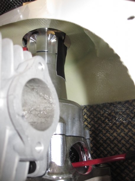

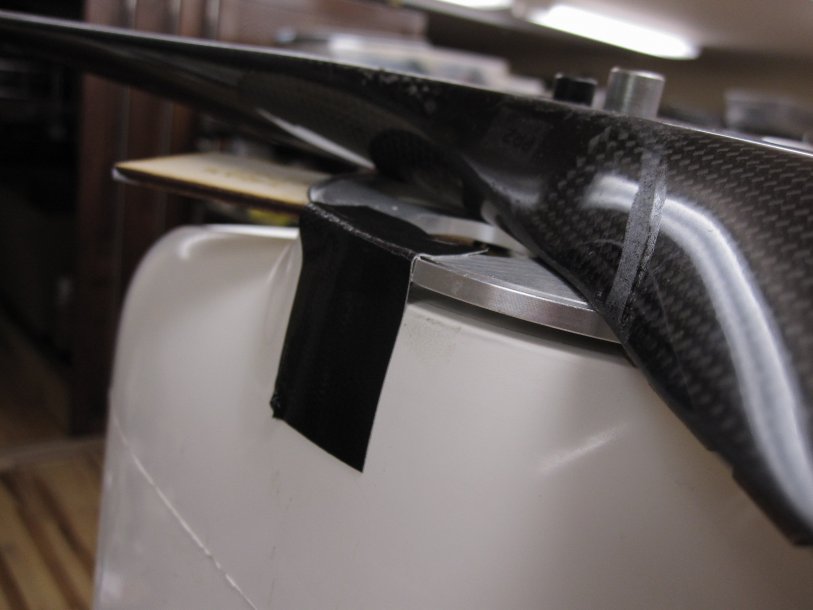

That allowed me to set the final critical position which was rotary angle of the engine in the plane...I the taped the engine block to the prop drive lug so that the engine could not turn from that positon...

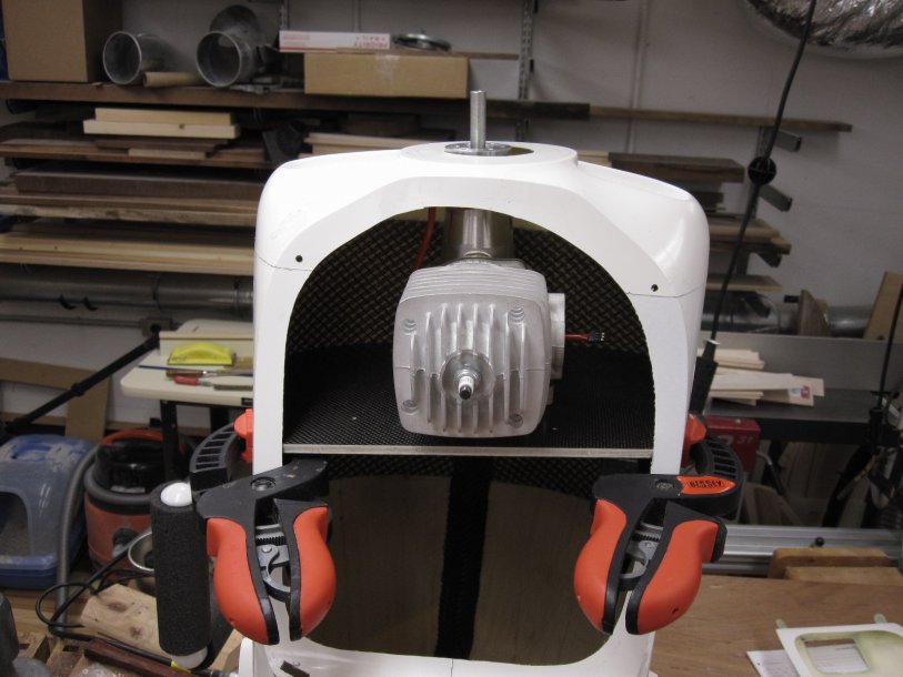

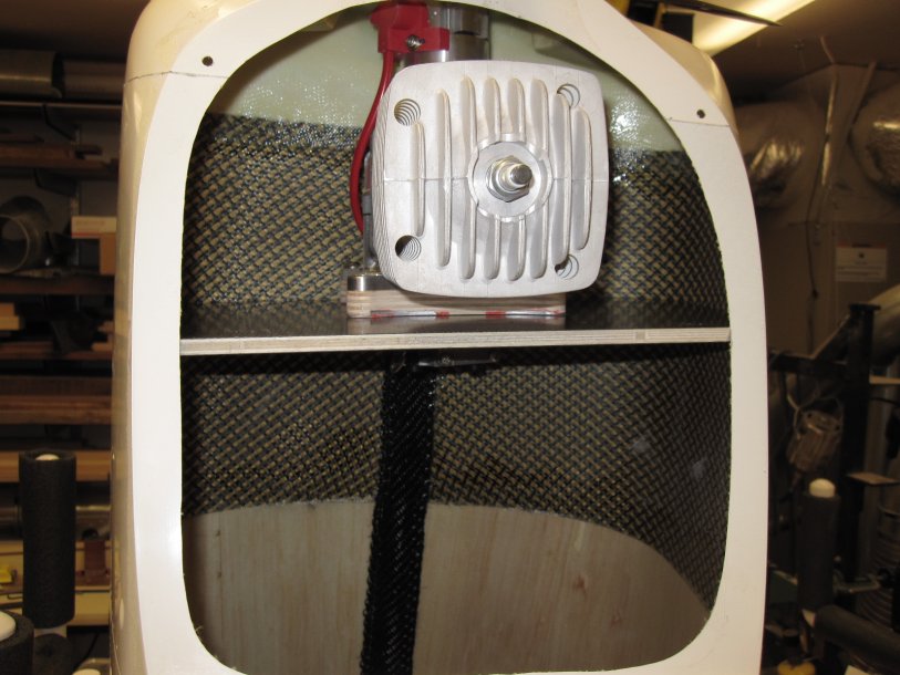

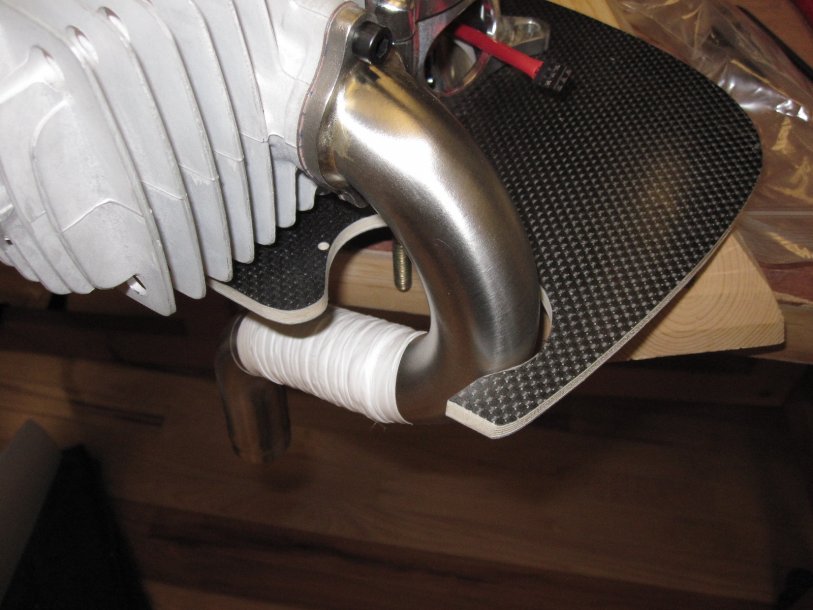

So now i have the engine spinner locked in place and the rotary angle of the engine as well....setting everything to allow me to position the firewall to the engine and mark the location precisely! :big_yes:
Engine Mounting (2).JPG Engine Mounting (1).JPG Engine Mounting (3).JPG Engine Mounting (6).JPG
Wacobipe

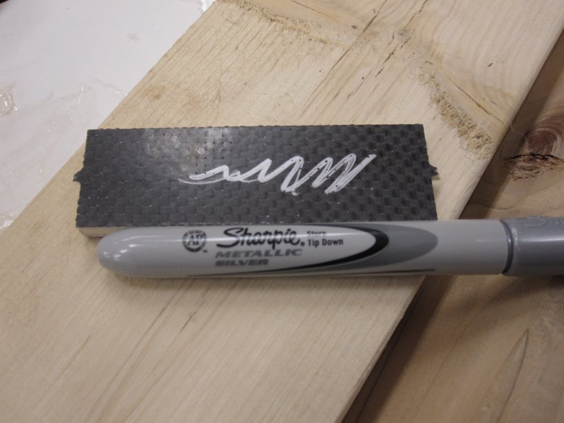

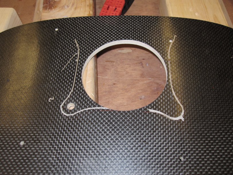

Next problem I encountered is that the engine bay is too tight to allow me to get much of anything inside to mark engine mount center hole locations...and the carbon fiber is so slick I couldn't find anything to mark it :confused:...
My wife came to my rescue...she had this awesome silver metallic Sharpie (getting these on order tomorrow...they are awesome!dries really quickly too.) so I was able to precisely mark the position of the engine spacers against the firewall, which allowed me to then remove the firewall and drill it properly on the workbench :first_place:
Engine Mounting (6).JPG Engine Mounting (7).JPG Engine Mounting (9).JPG Engine Mounting (8).JPG

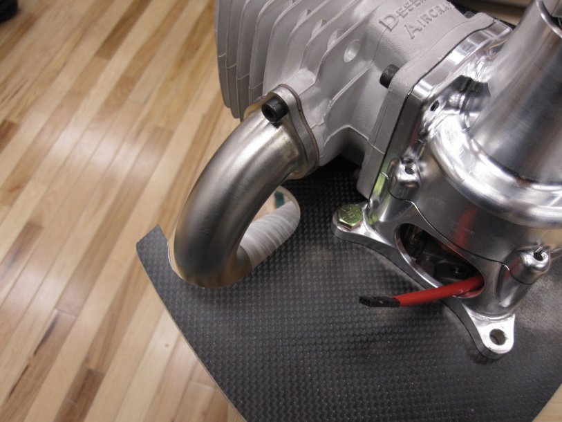

I got the holes all drilled tonight before a glass of wine called my name and I had to go take care of that :on_the_go::on_the_go::on_the_go: I need to cut clearance intothr firewall for canister clearance, ignition wire, throttle and choke control arms, and fuel tubing and then I can Hysol this baby into place for good!

Looks like you didn't have to cut much cowl too accomodate the single.:)
Barely any at all...and it's underneath the plane so you'll never see it (I can't knife edge that close to the ground :frown:...and I don't hover). I'll try to get a photo of it installed with the engine in place.
