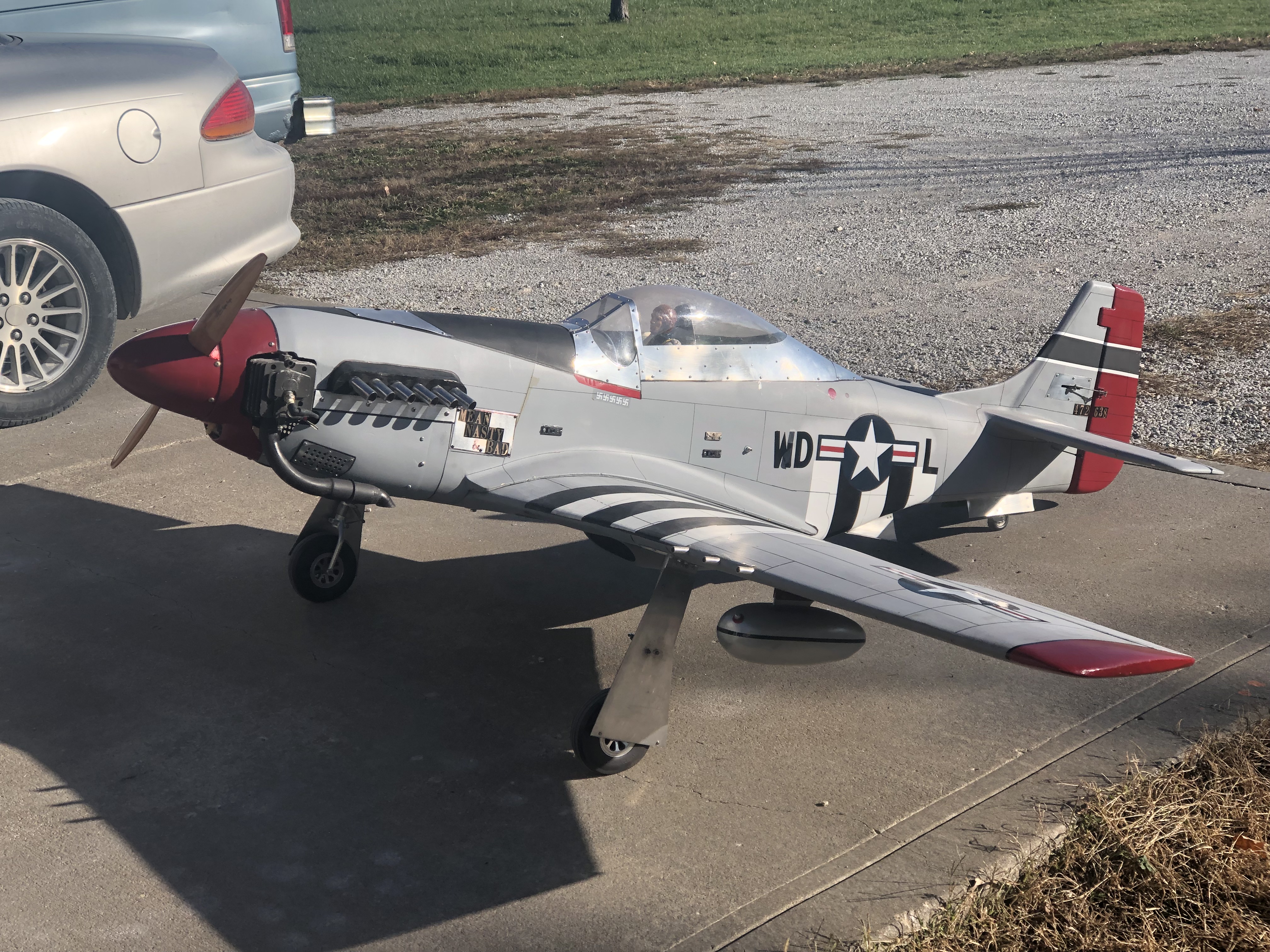

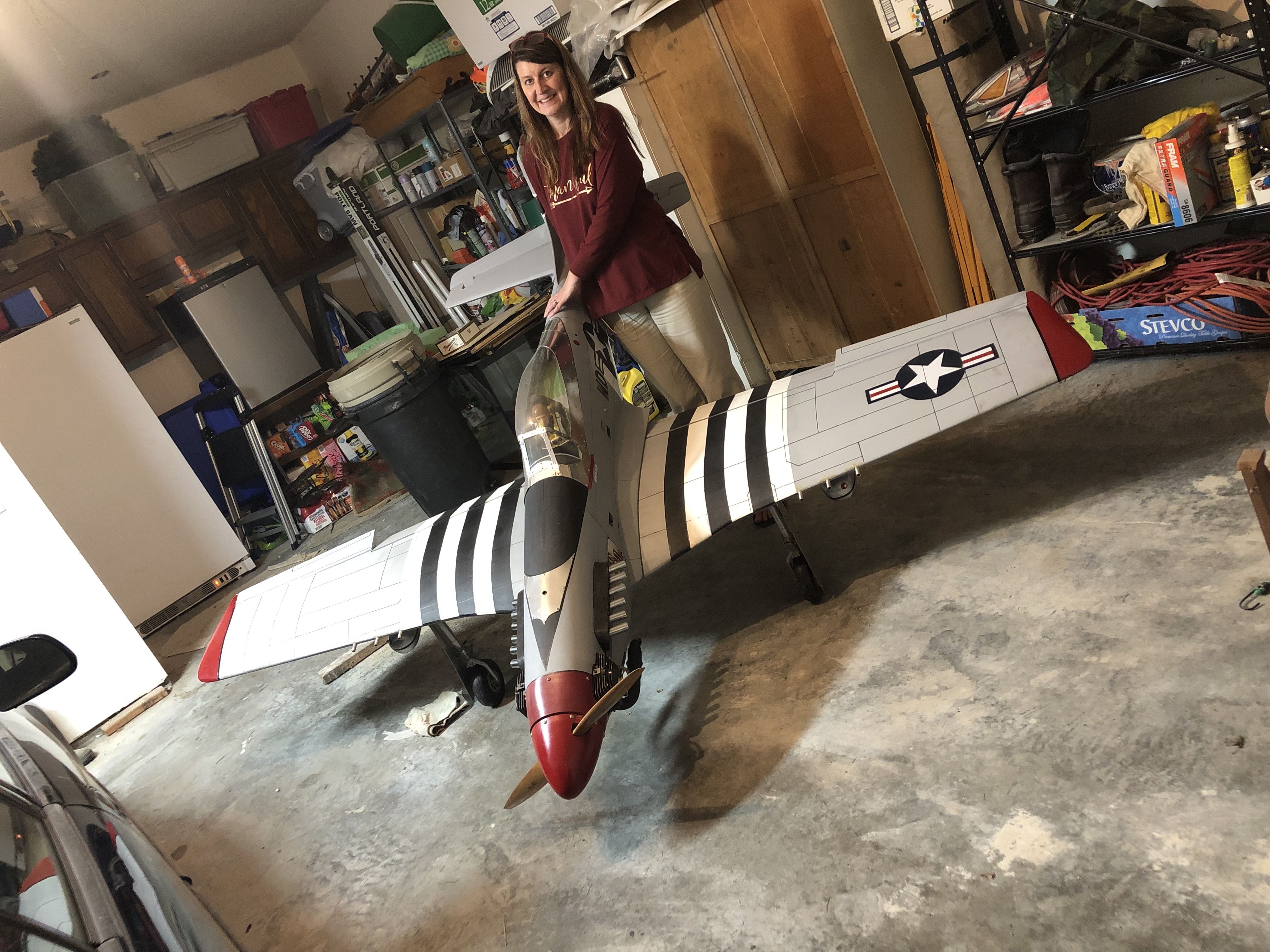

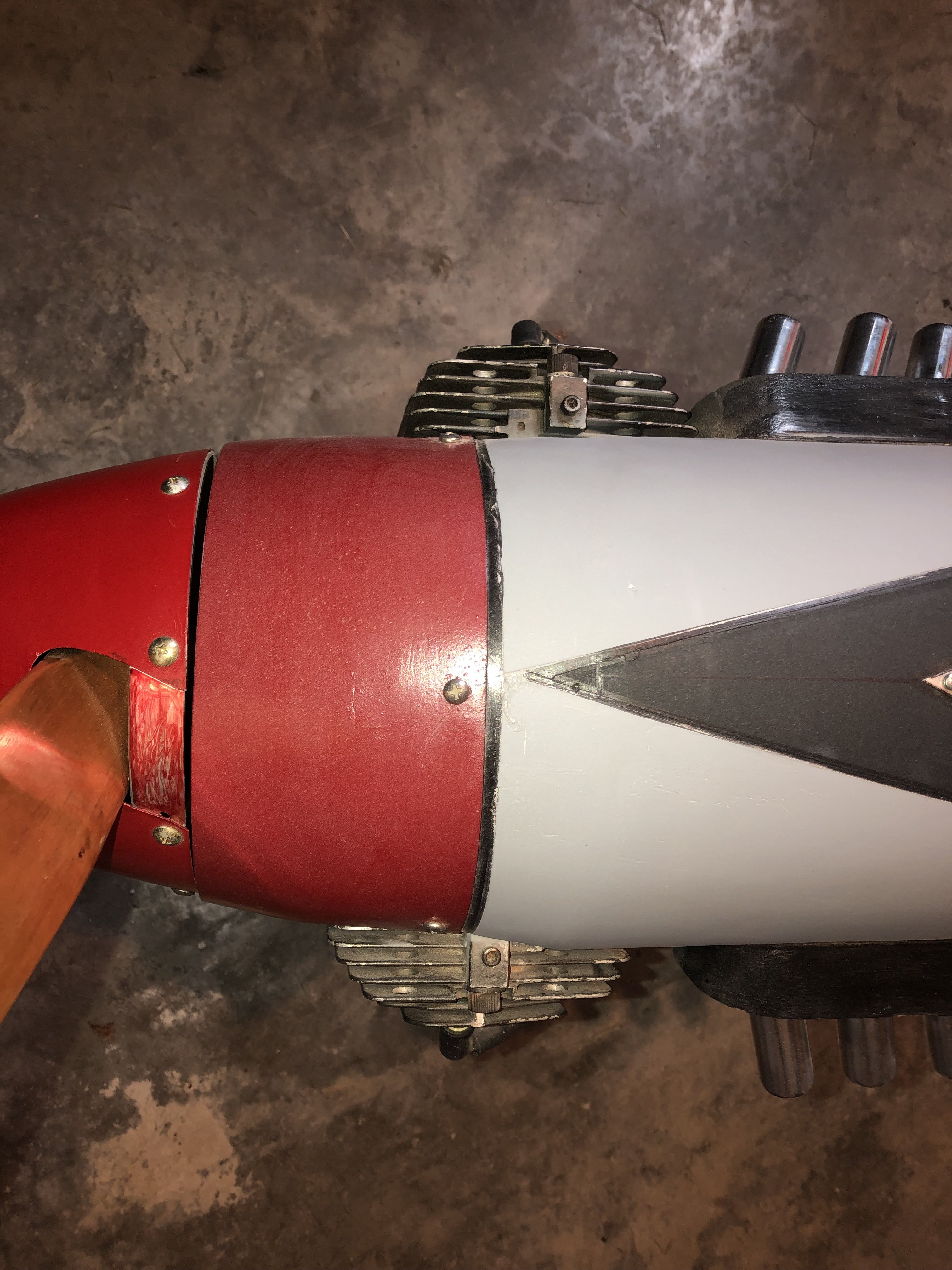

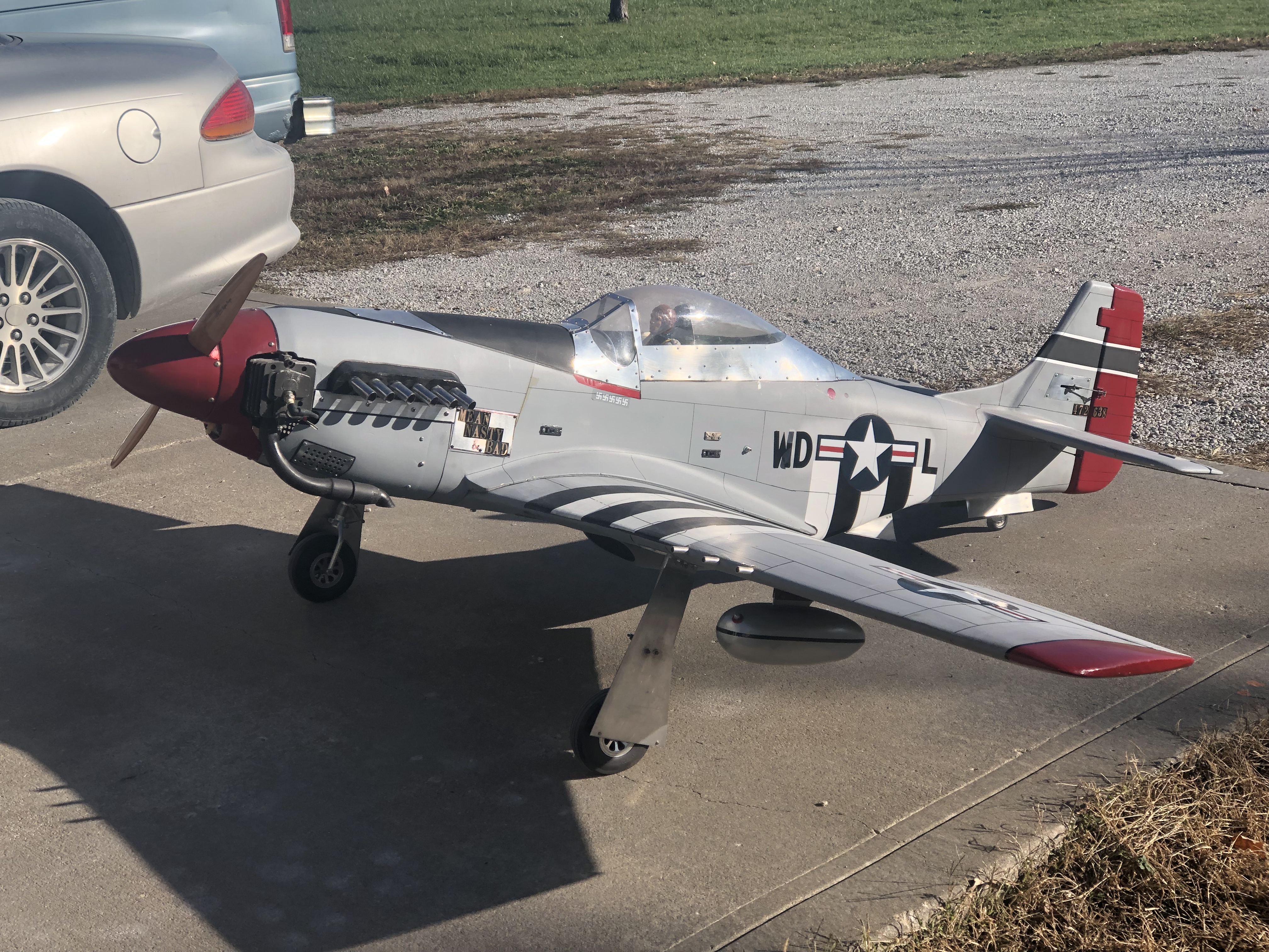

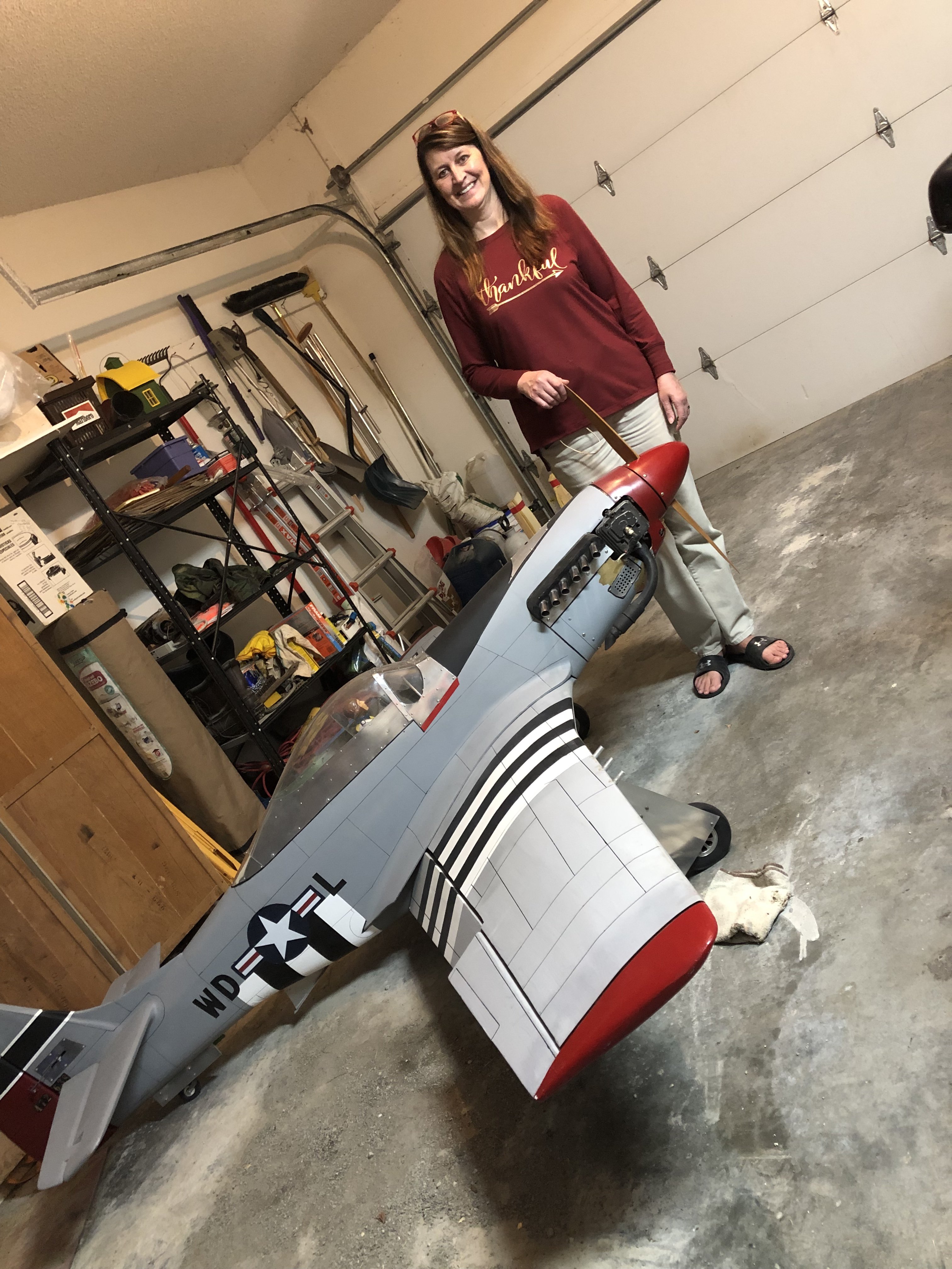

I have a Don Smith P-51. It was inlarged a little. It has a Quadra 200A in it. I was going to put a DA85 in but it’s to small. The 200 is a twin.

Have to say it that looks like a typical Mustang at JoeNall. If there are a bunch of fellows that come to JoeNall with some pretty impressive warbirds and they mussel some real big engines into them. Them every couple of hours or so they get together and chase each other around the circuit, it’s fun to watch and those boys can haul the mail.

Yepp, I agree.... this one has a 27x27 prop!! But I want to put a 4-Blad on it.

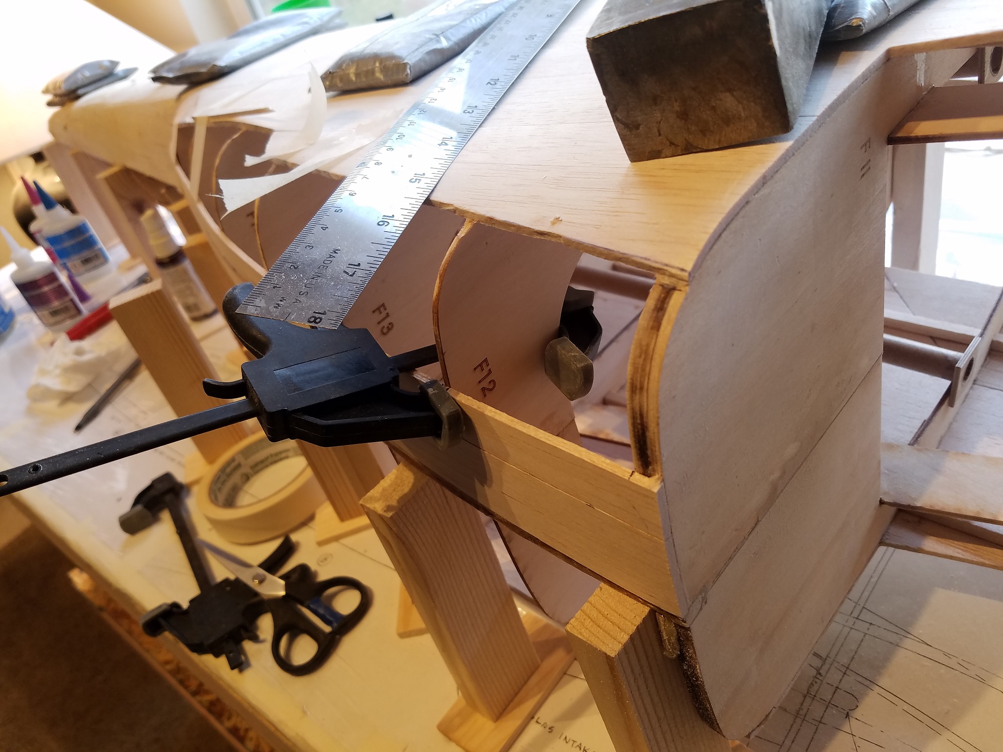

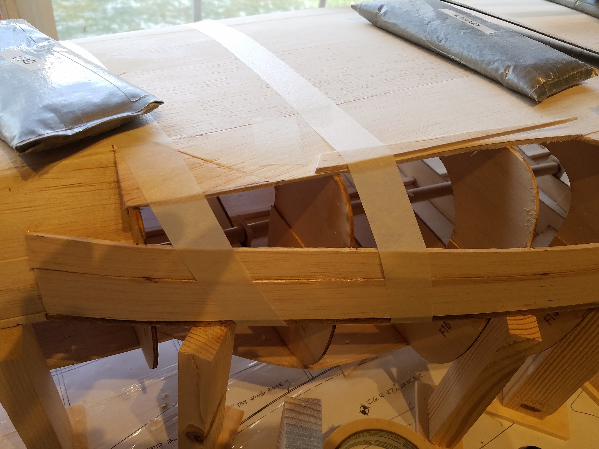

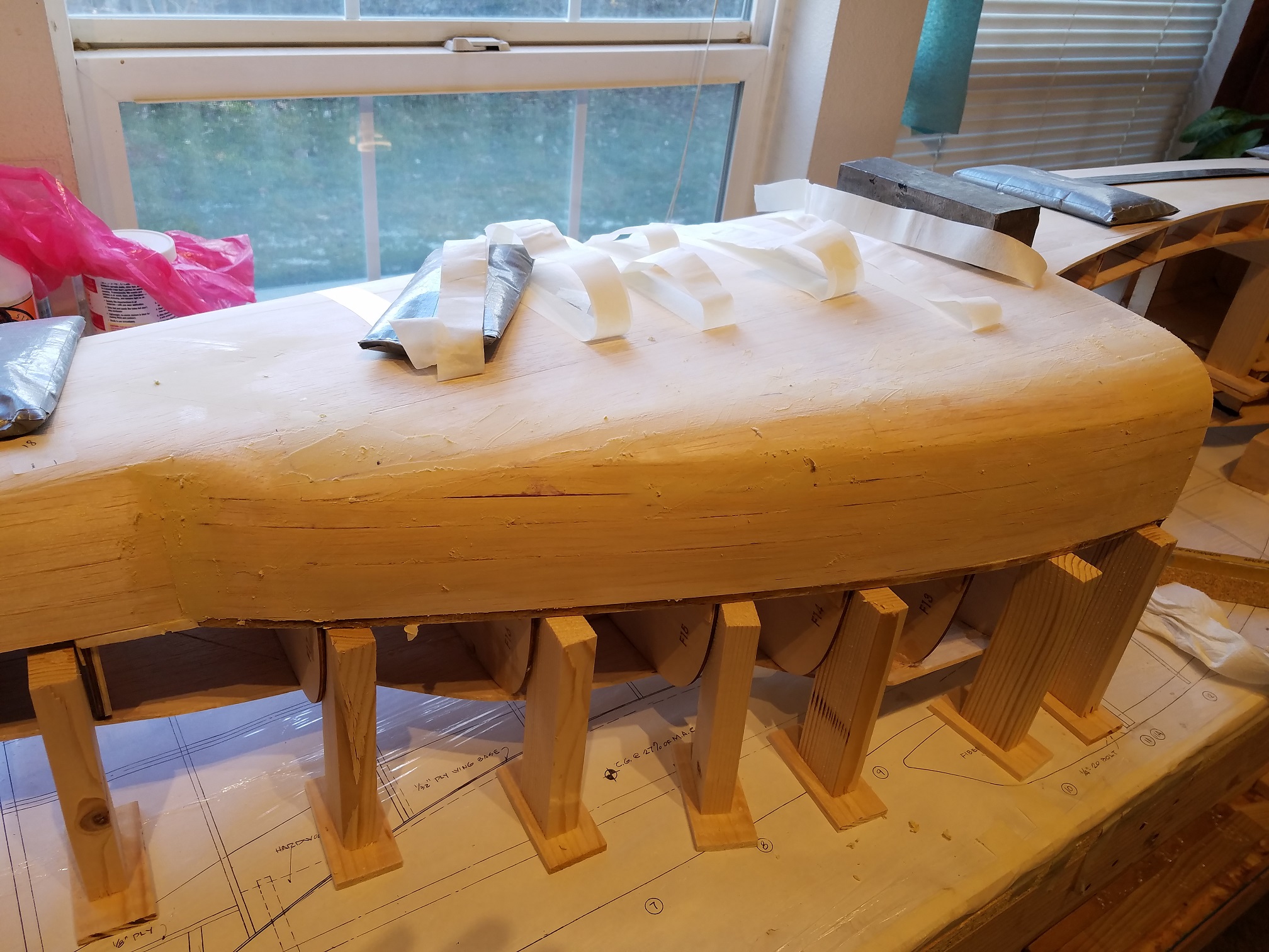

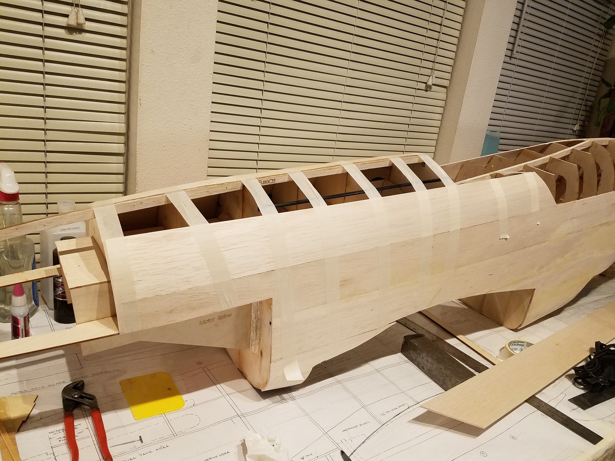

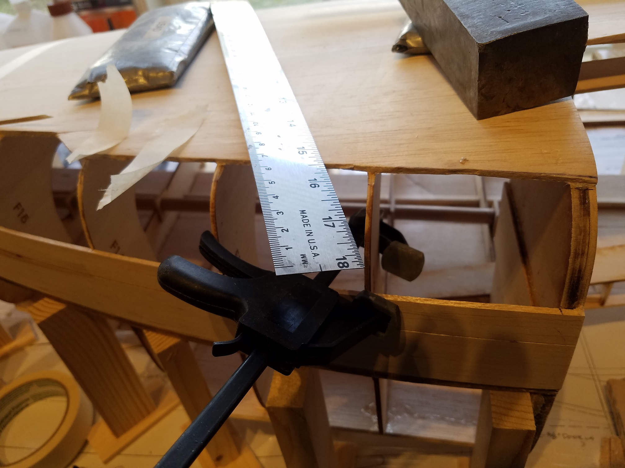

Today I started sheeting the radiator and bottom of the fuse. Wow! Talk about a royal P.I.T.A. I did the radiator just a tad different than the plans call for, but really with all the compound corners it is about all I could think of.
20181230_114158.jpg 20181230_114202.jpg 20181230_114206.jpg 20181230_123324.jpg 20181230_123327.jpg

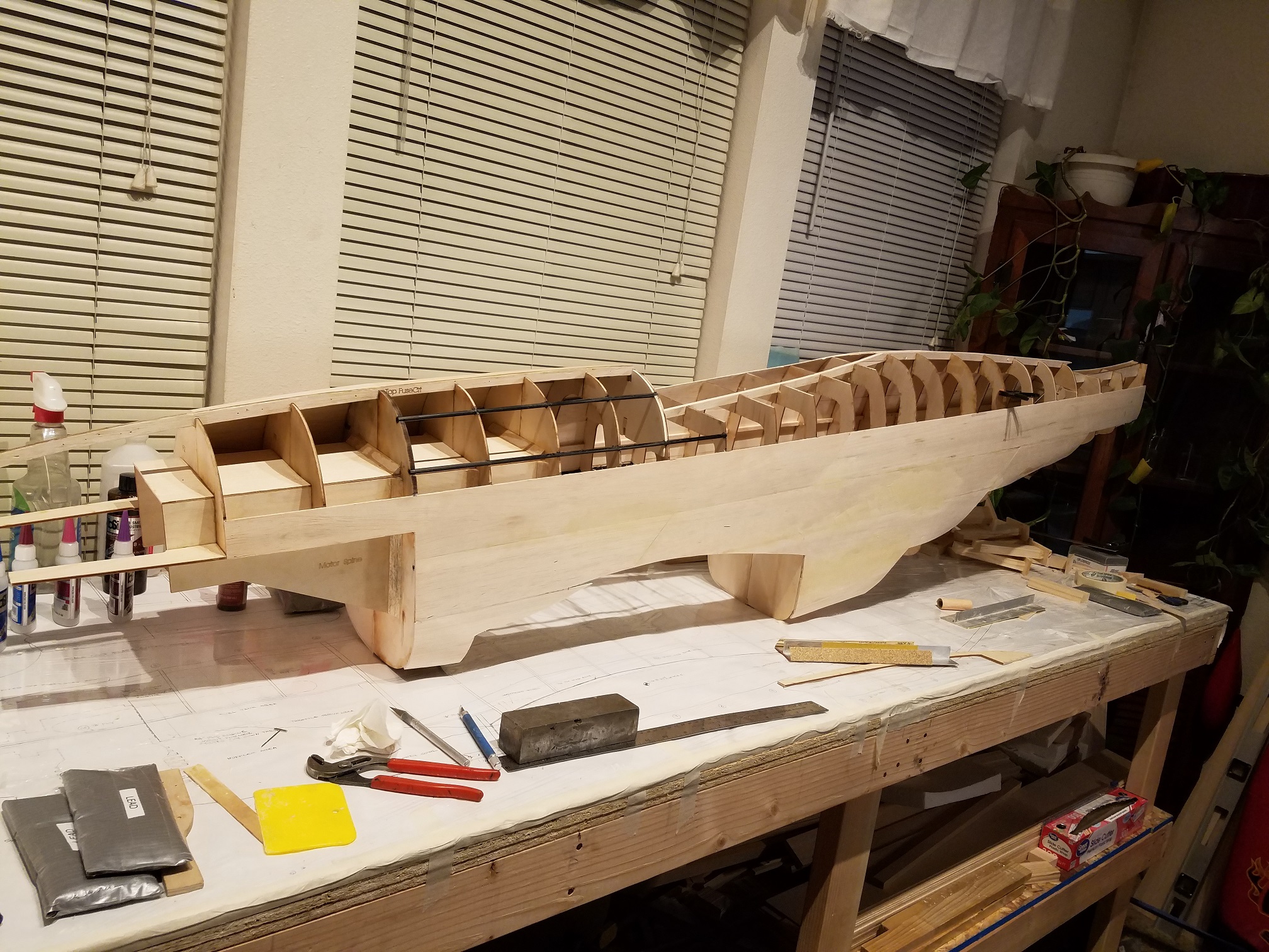

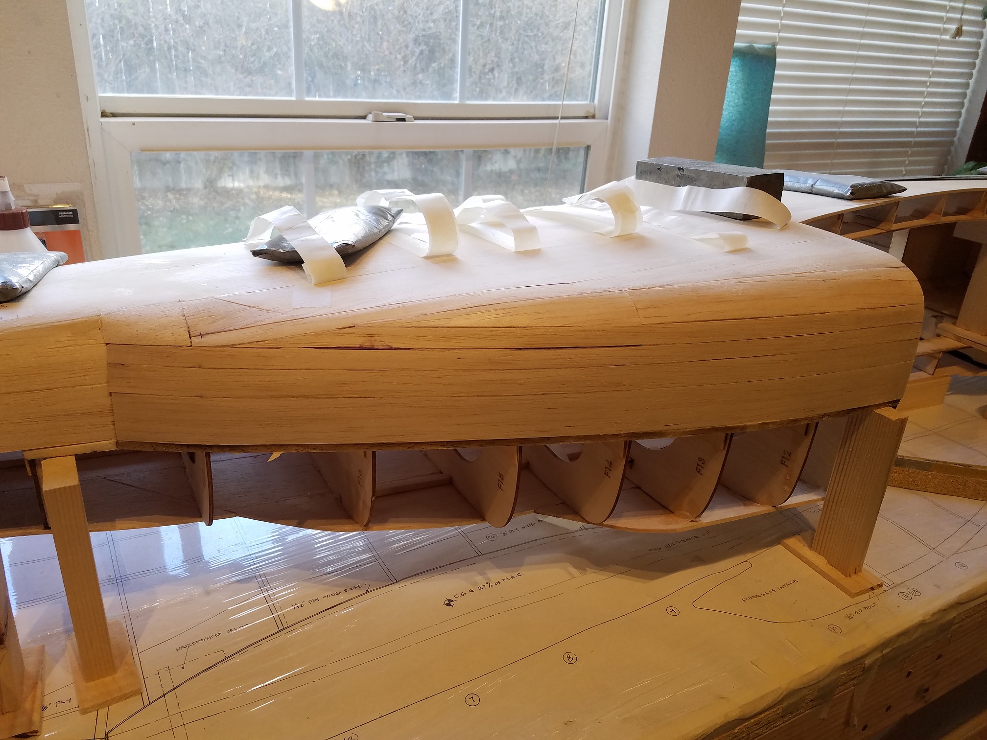

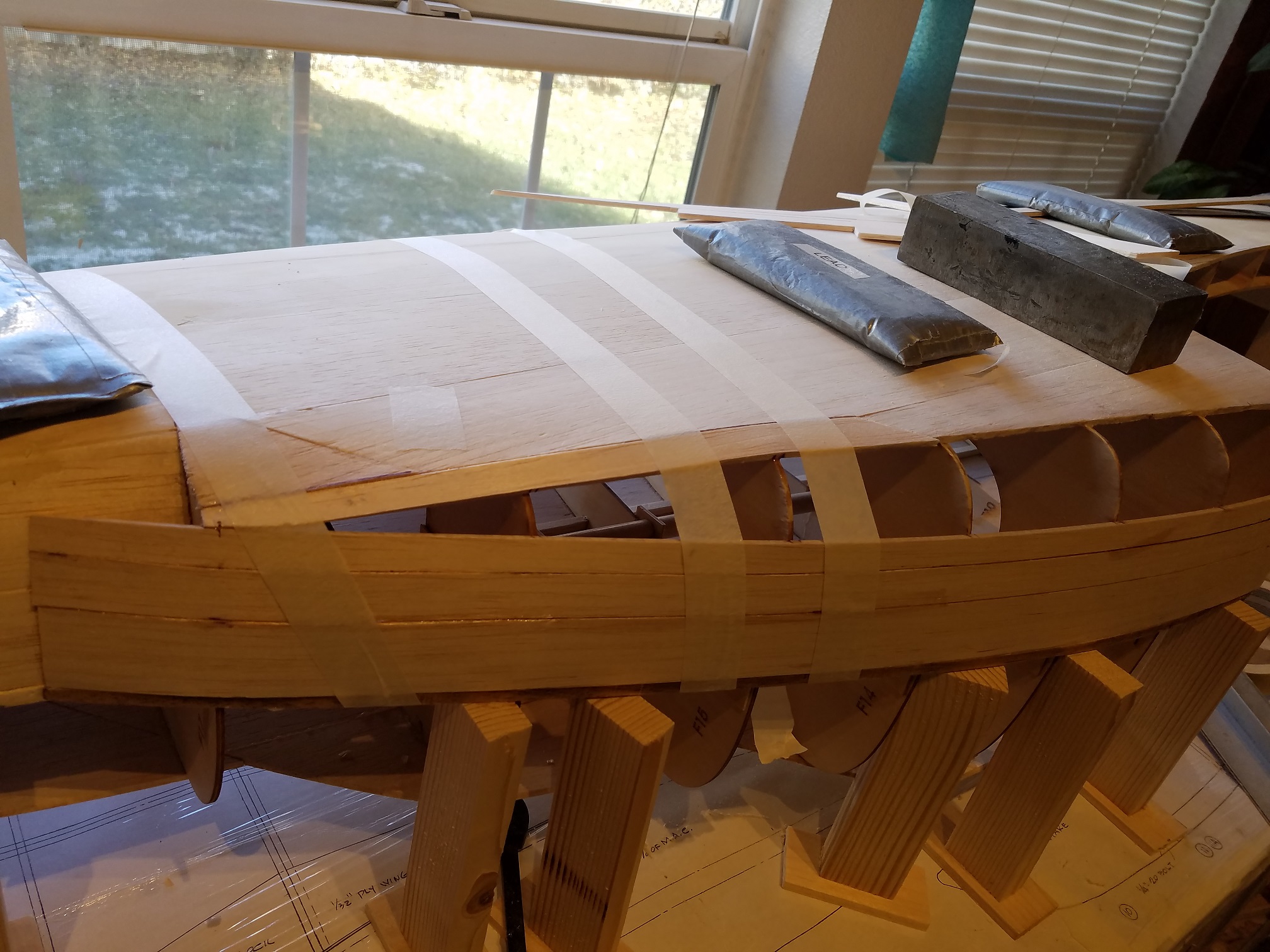

A strip at a time and slowly the bottom started looking as it should. I researched many Mustang photos to make sure I was getting the right curvatures and proper angles.

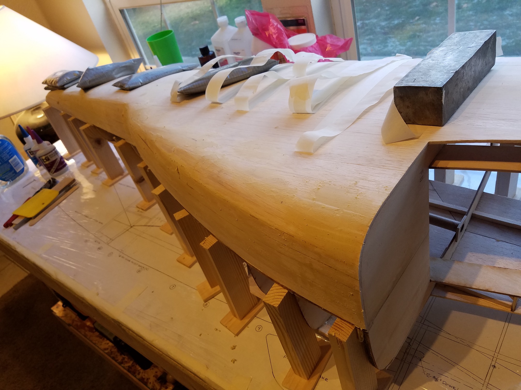

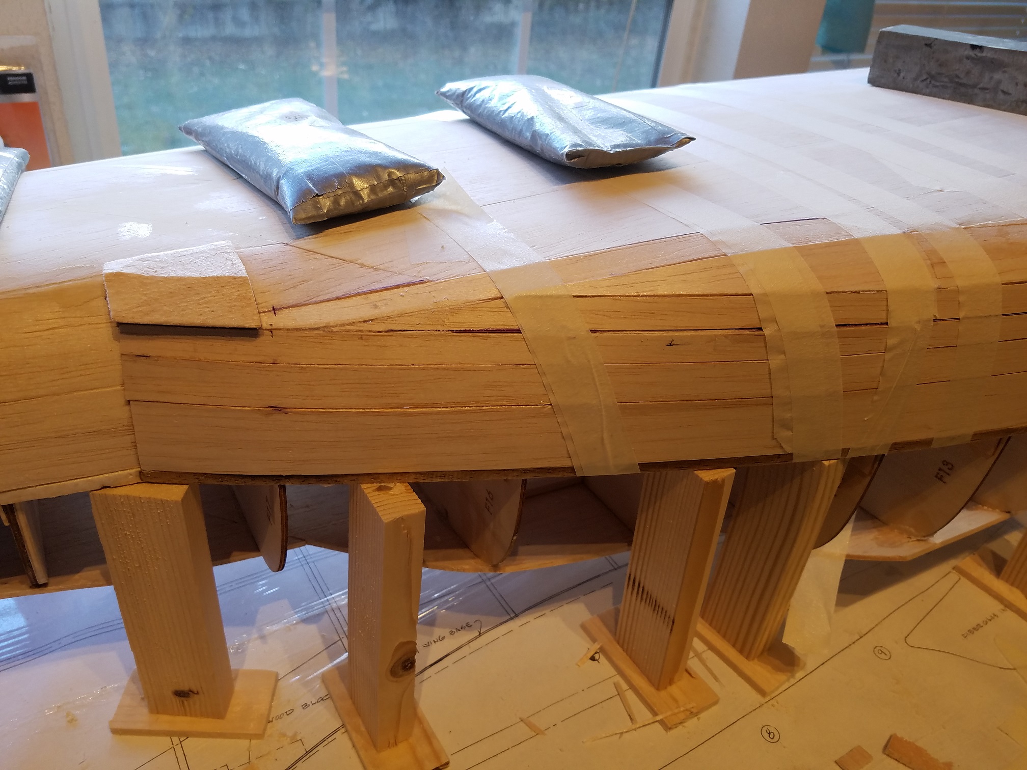

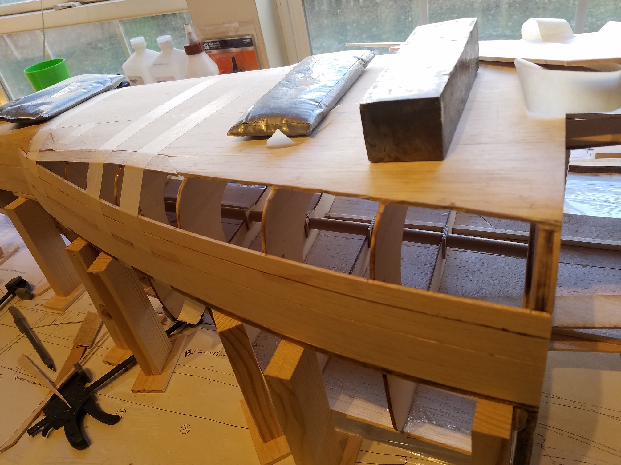

The last balsa sheets placed and glued in. I added a balsa block at the end of the Keel to fill the void where the sheeting was just too much for my patience to endure. LOL. Worked pretty darned good though.
A little course sanding to knock off the sharp edges of the sheeting where they came together at the glue joints then added just a skiff of balsa filler to touch up those areas. Of course this will all get a really good sanding before I prep the fuse for "glassing". 20181230_145342.jpg 20181230_151220.jpg 20181230_151337.jpg 20181230_151344.jpg

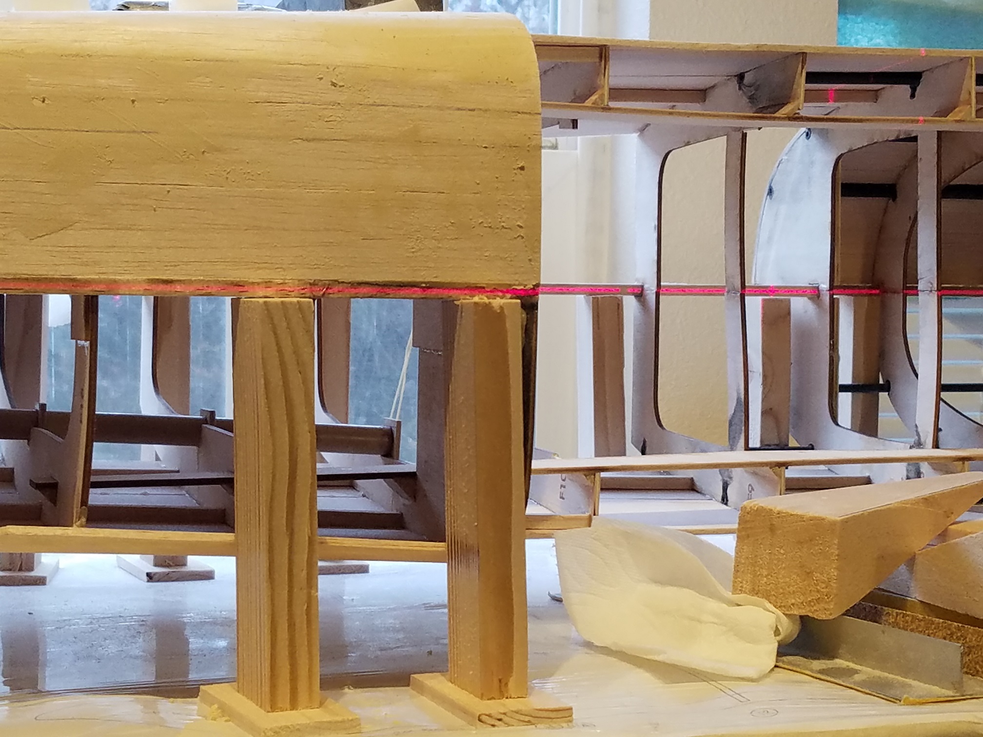

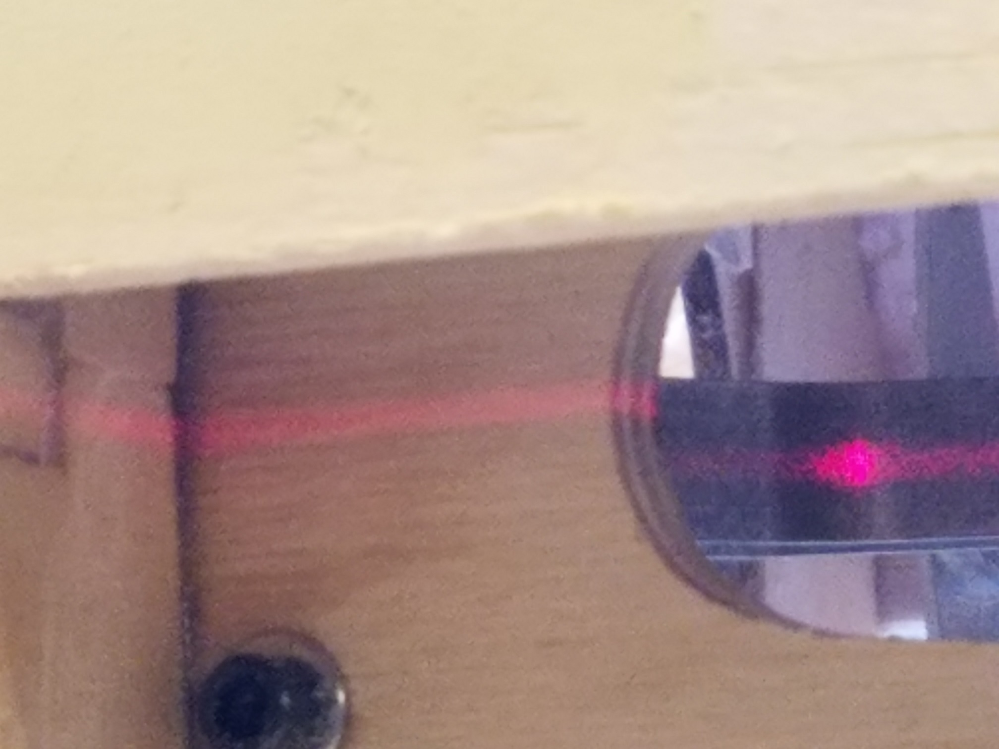

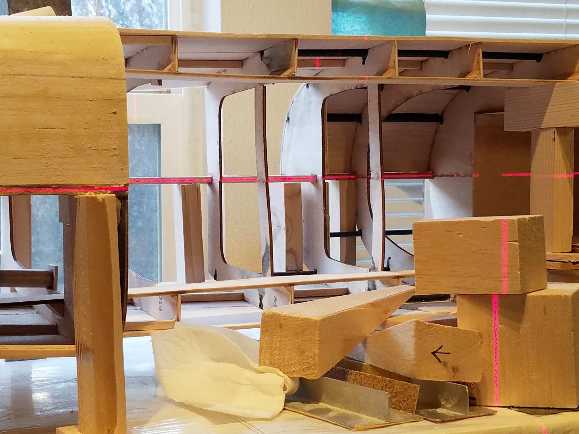

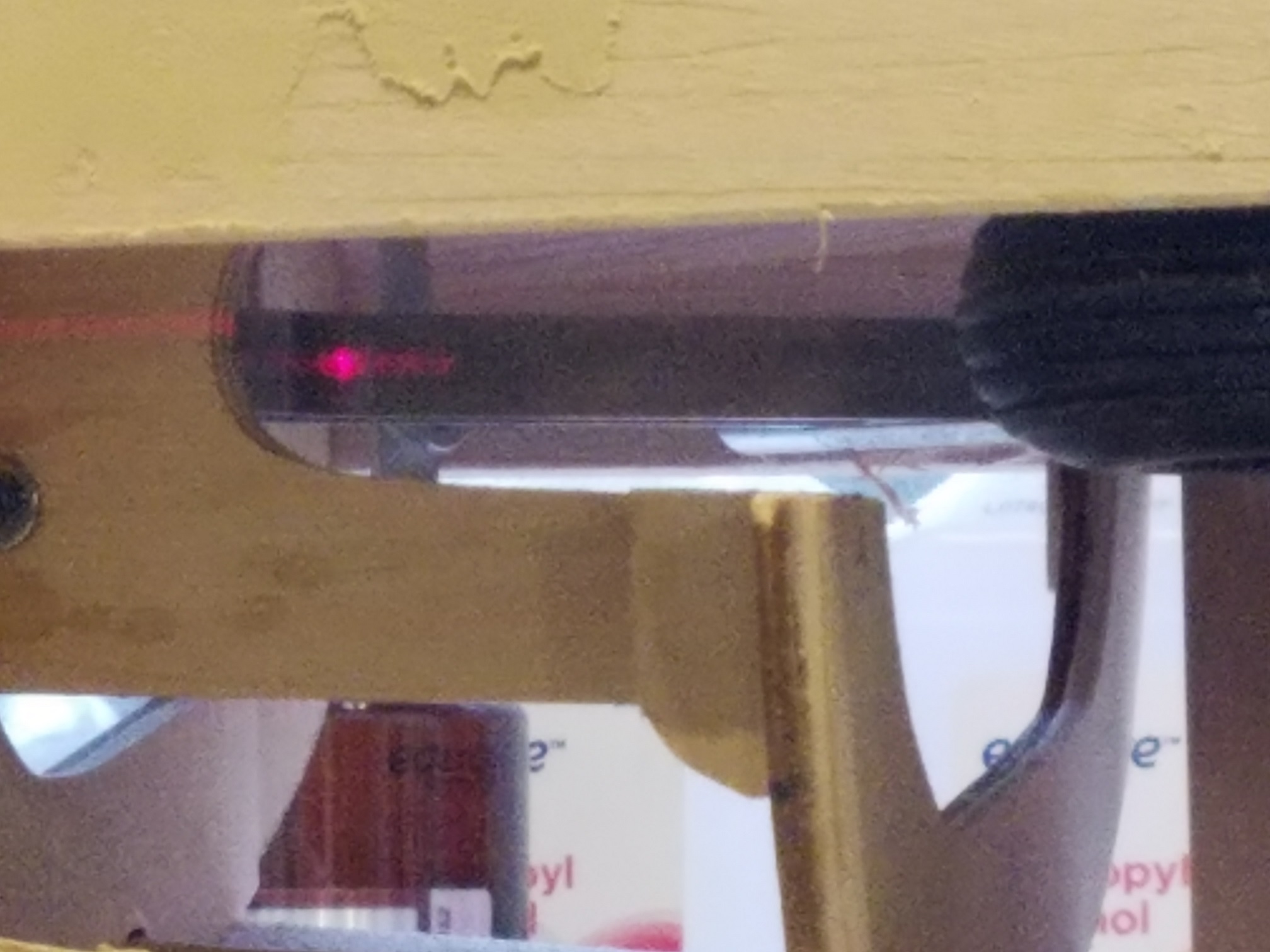

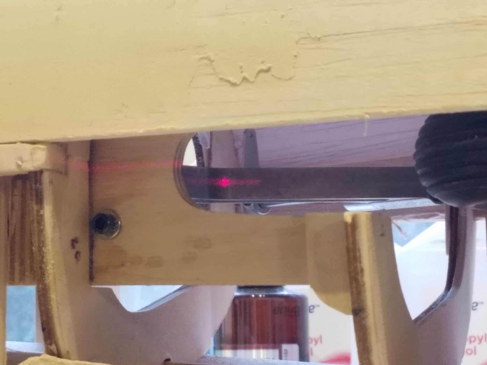

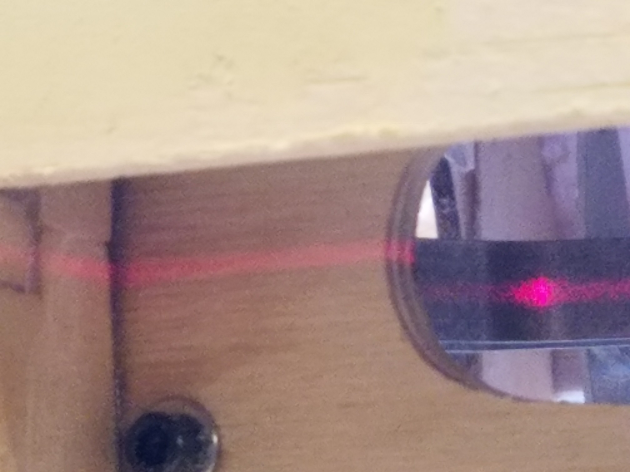

While my son was here, we set up the laser as "Ace" had pointed out. Ok...so I was so "NOT" expecting this. I mean, I have been trying very hard and being extremely "anal" about making sure the fuse was straight and jigged perfectly. Oh, I expected the fuse to be straight. But to have it turn out this good just...well, it really blew me away.
Heck, even the tail gear is in perfect alignment with the centerline of the fuse. How cool is this?
At this point, we're up to just a frogs hair over 6 pounds. Yes, I do believe I will make that 8 pound goal on the fuse when the basic construction is complete.

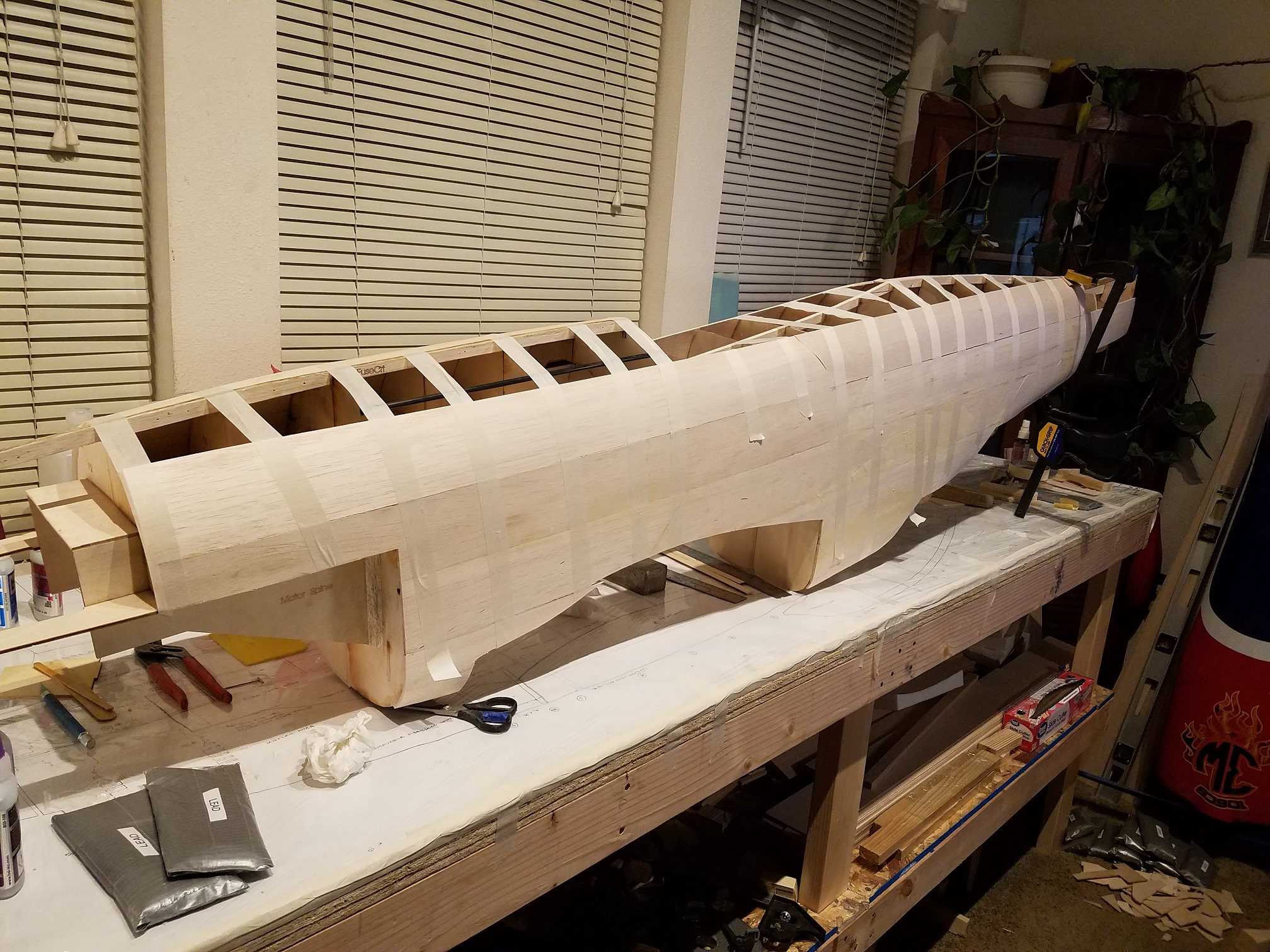

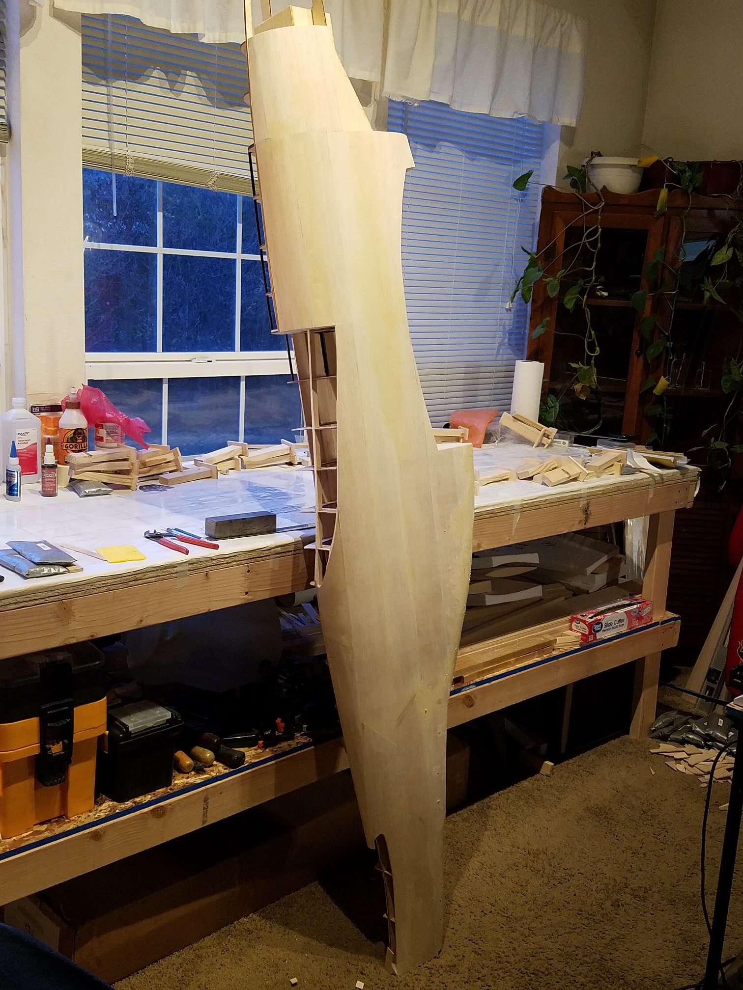

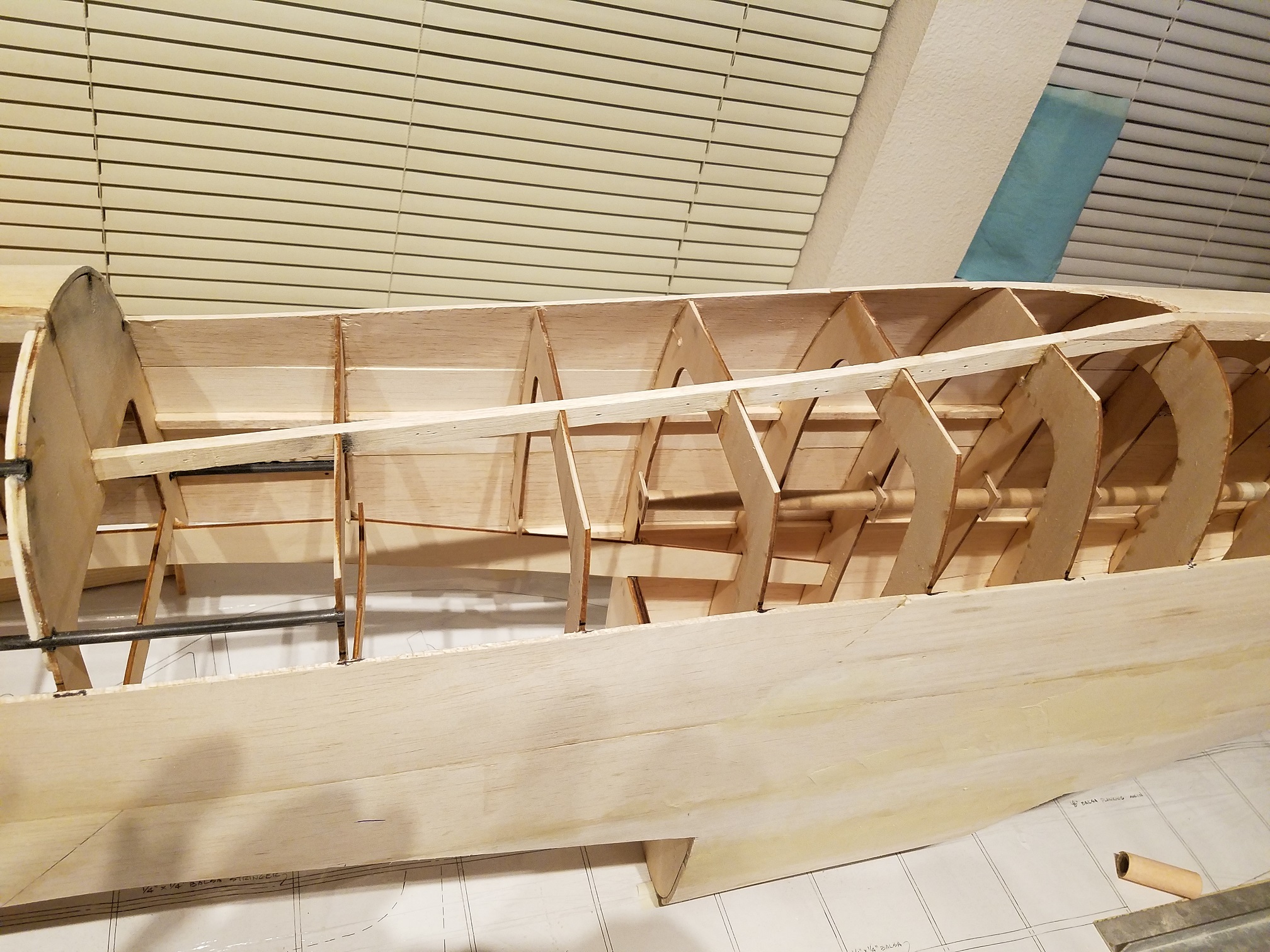

With the fuse removed from the building table, I took the opportunity to do a little straightening and cleaning up.

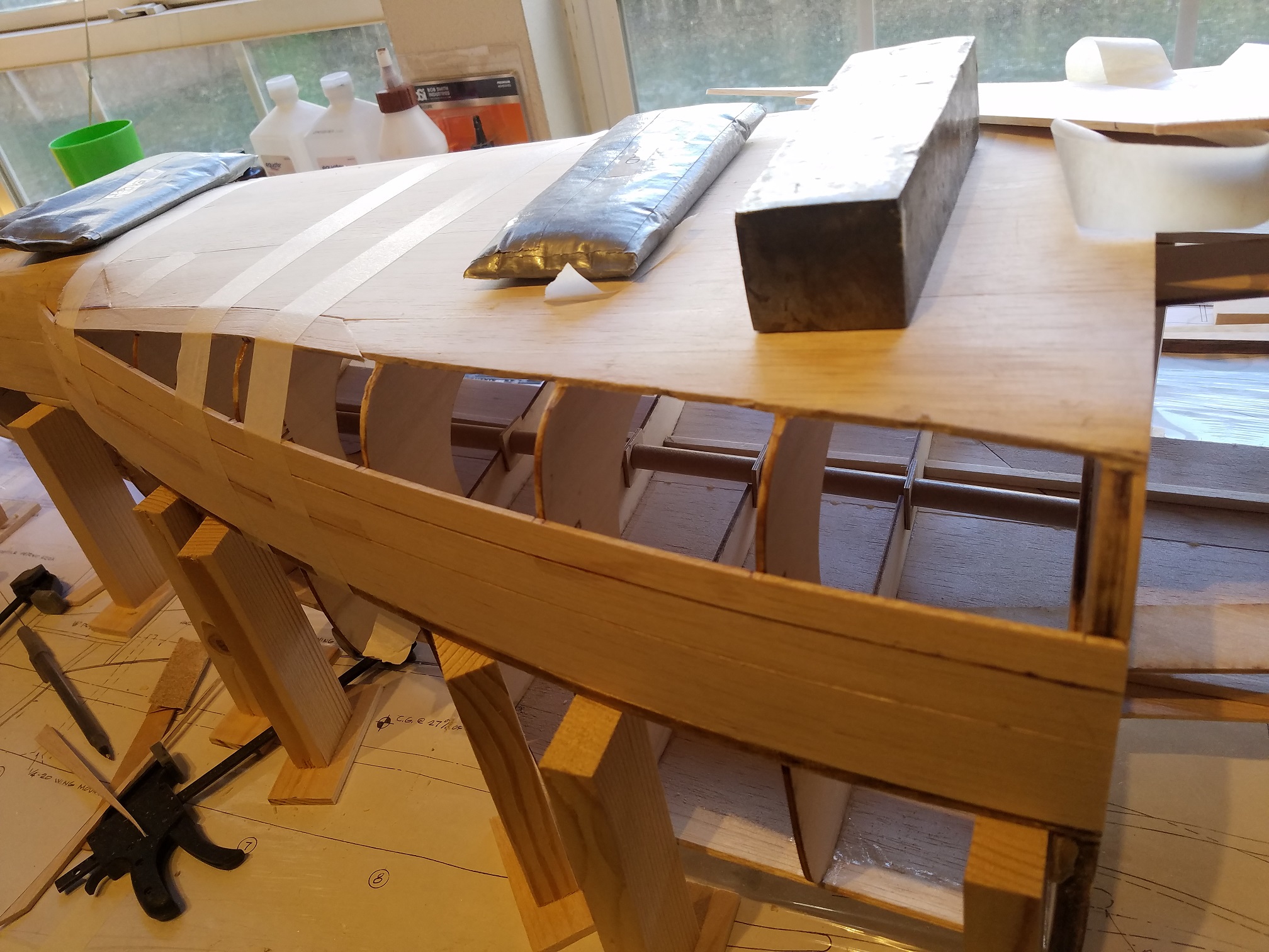

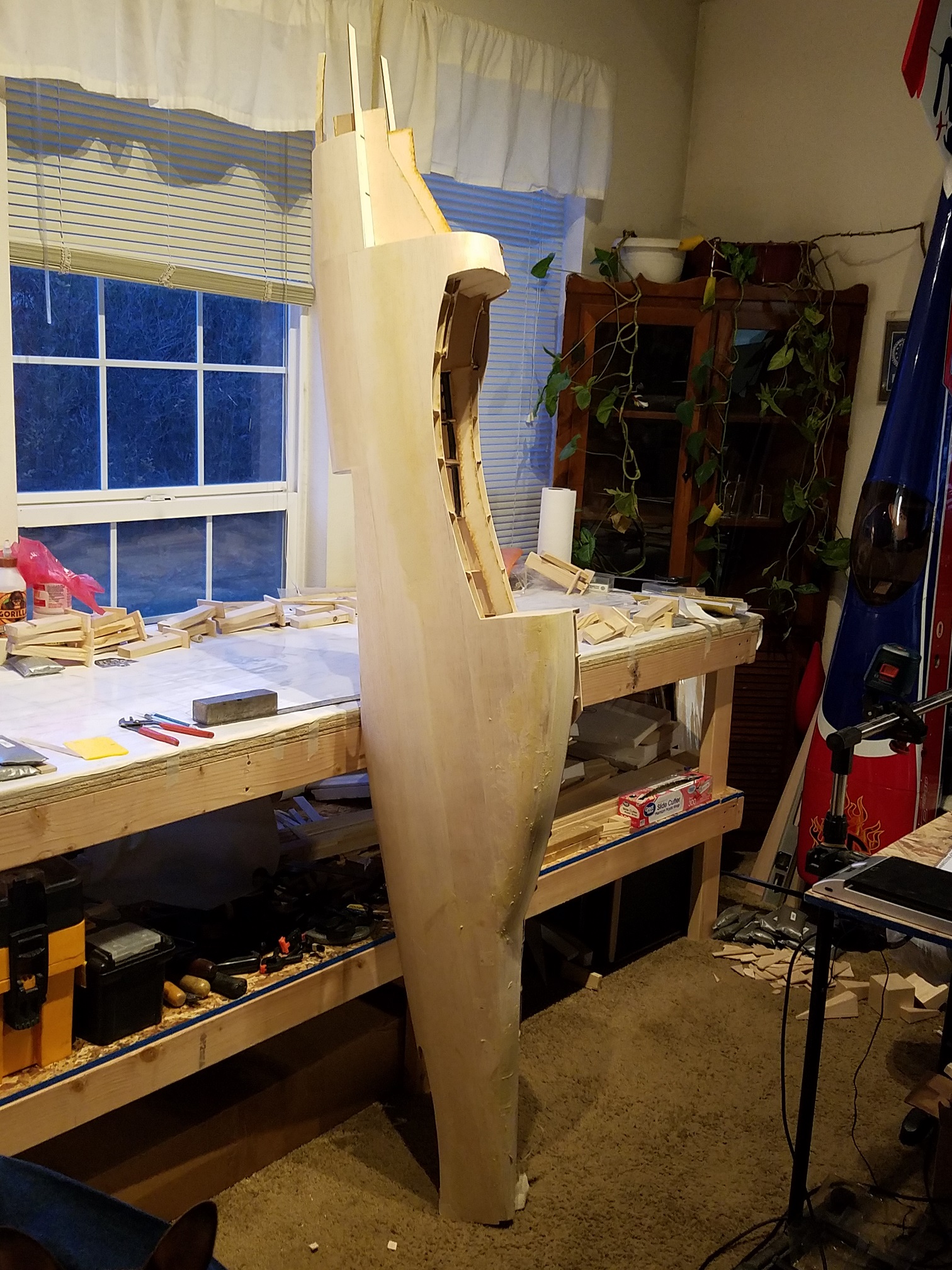

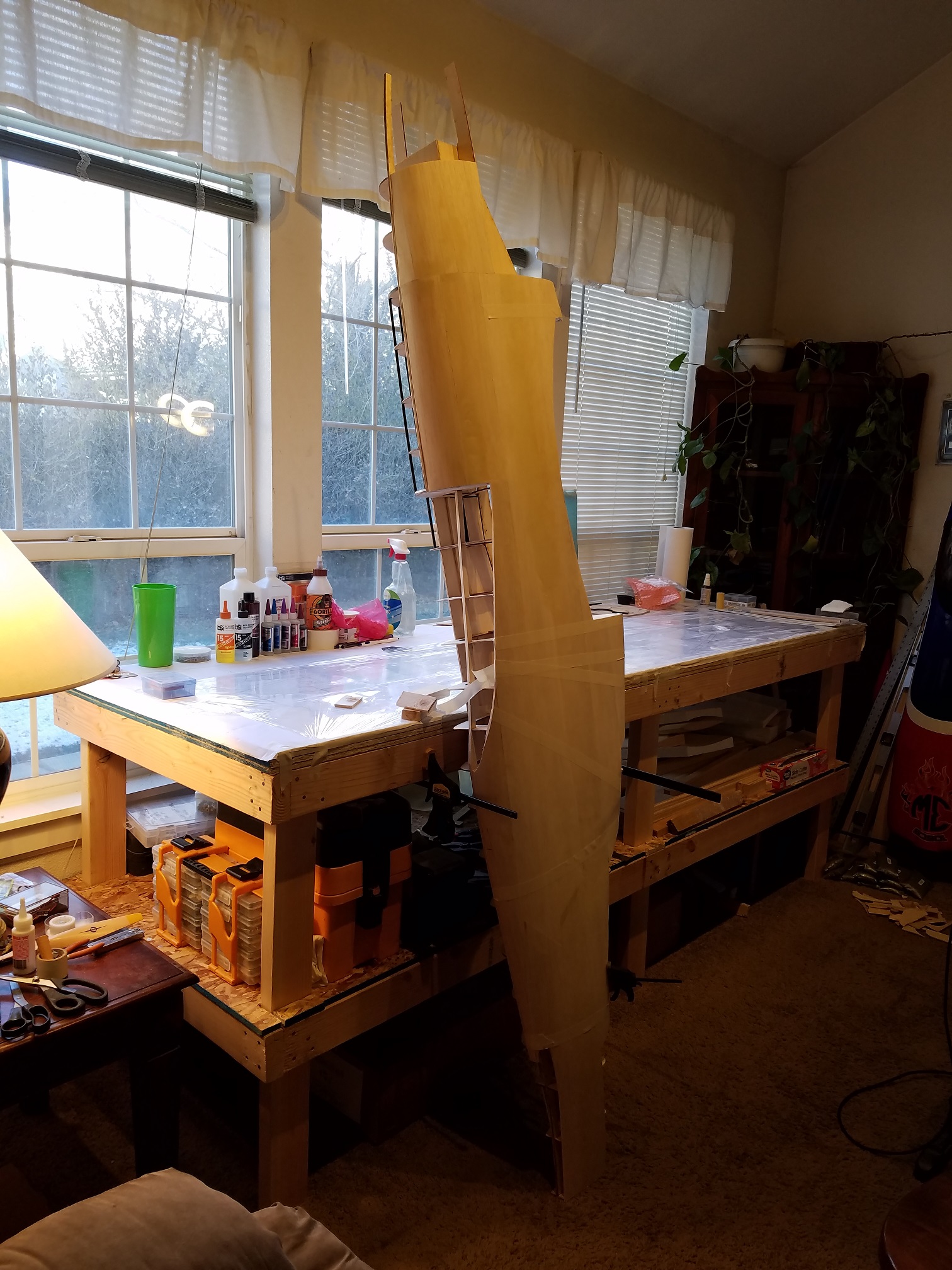

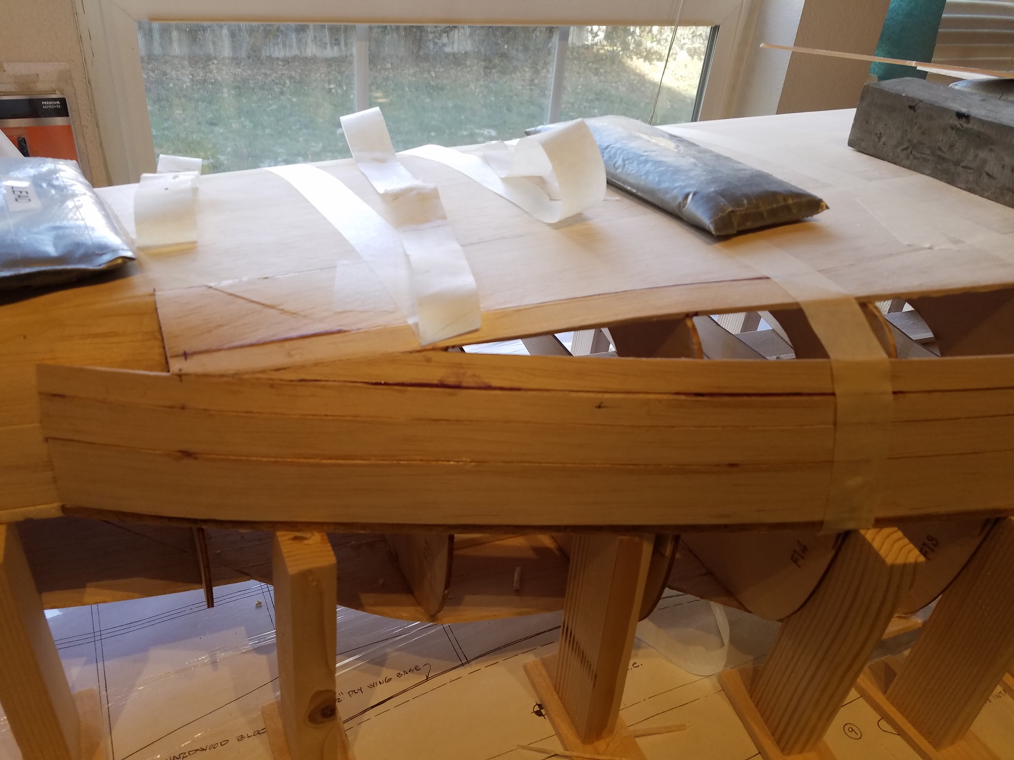

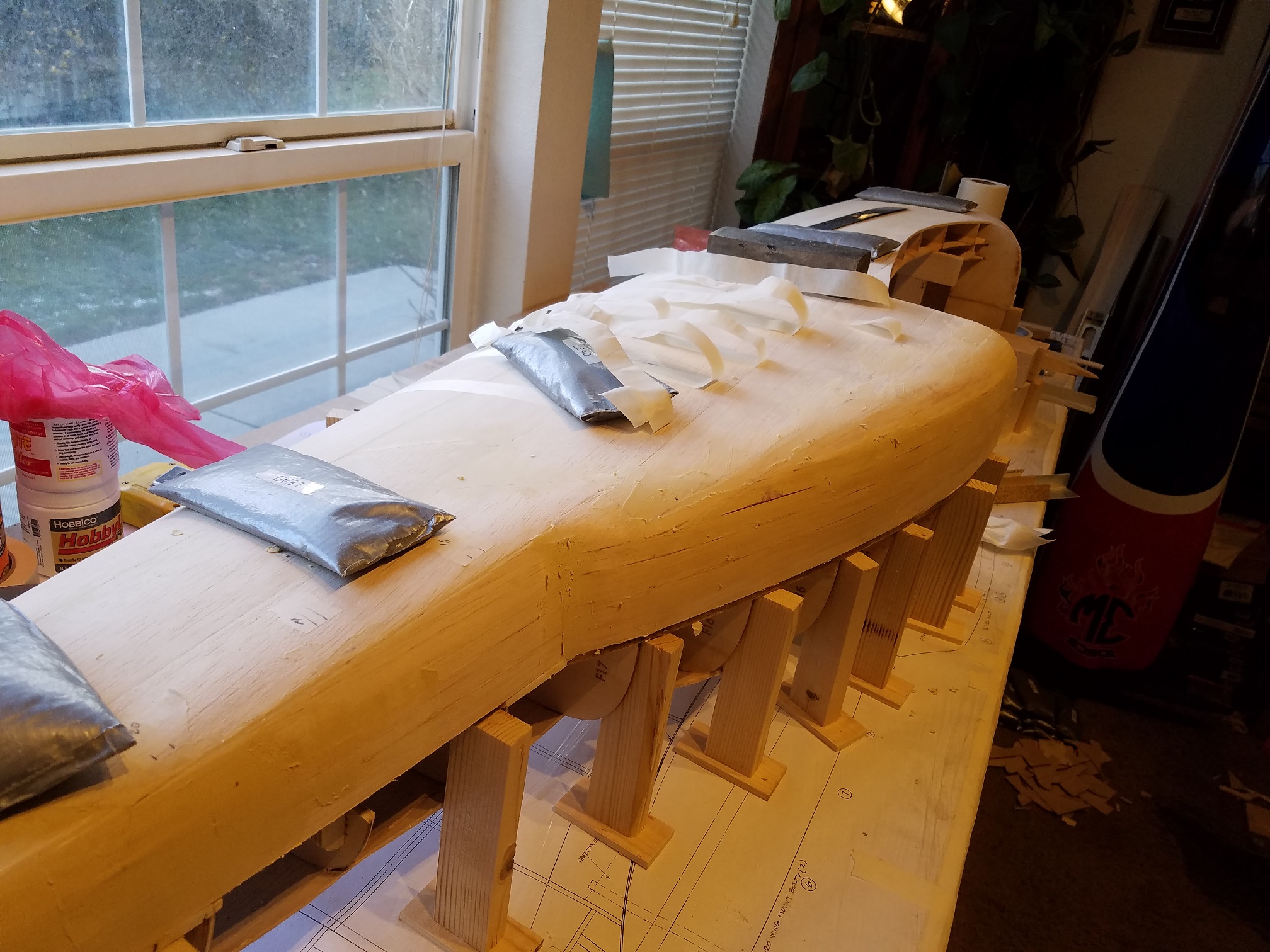

Time to start sheeting the other side of the fuse.

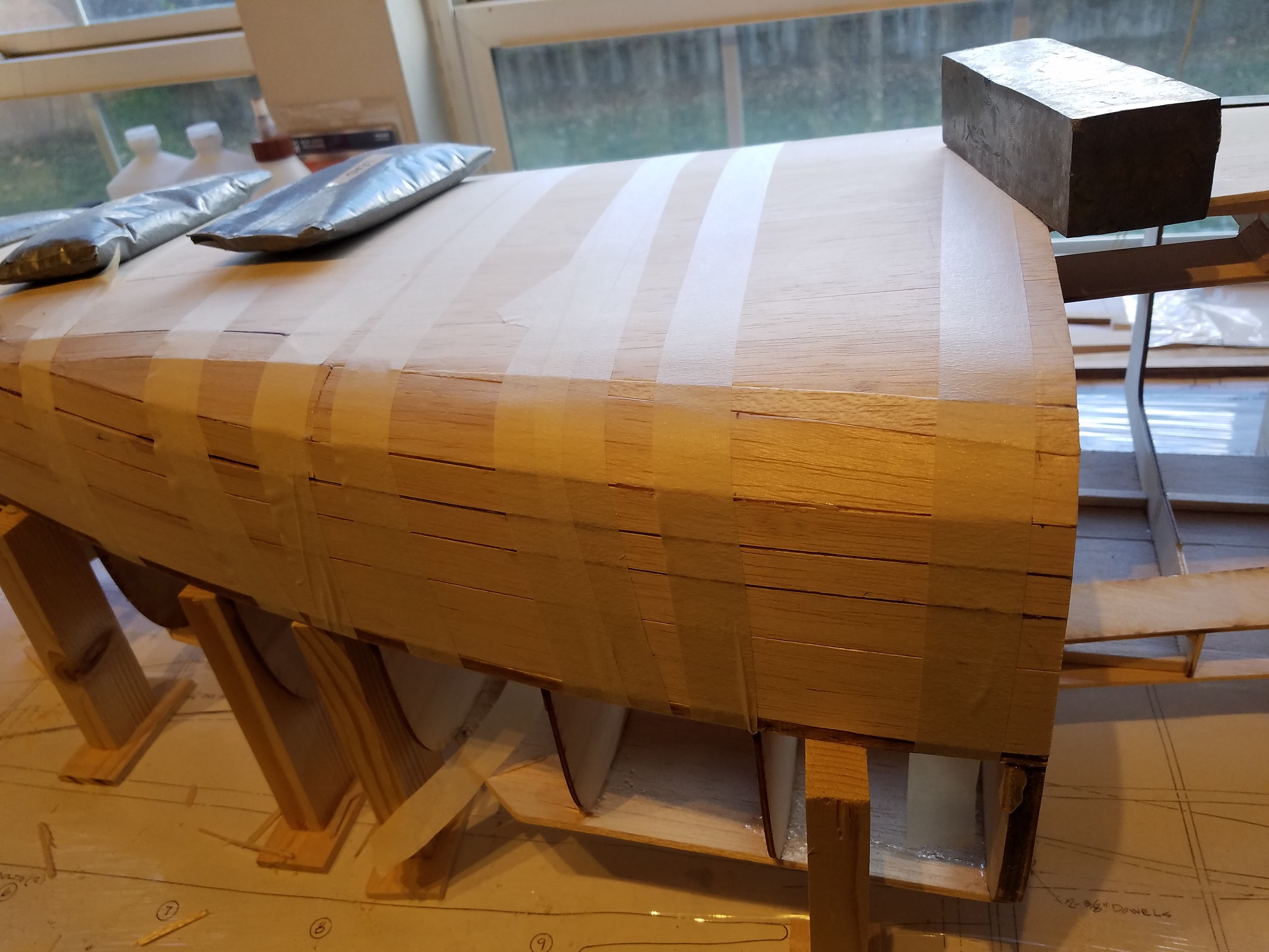

First the nose section splitting mid cockpit area.

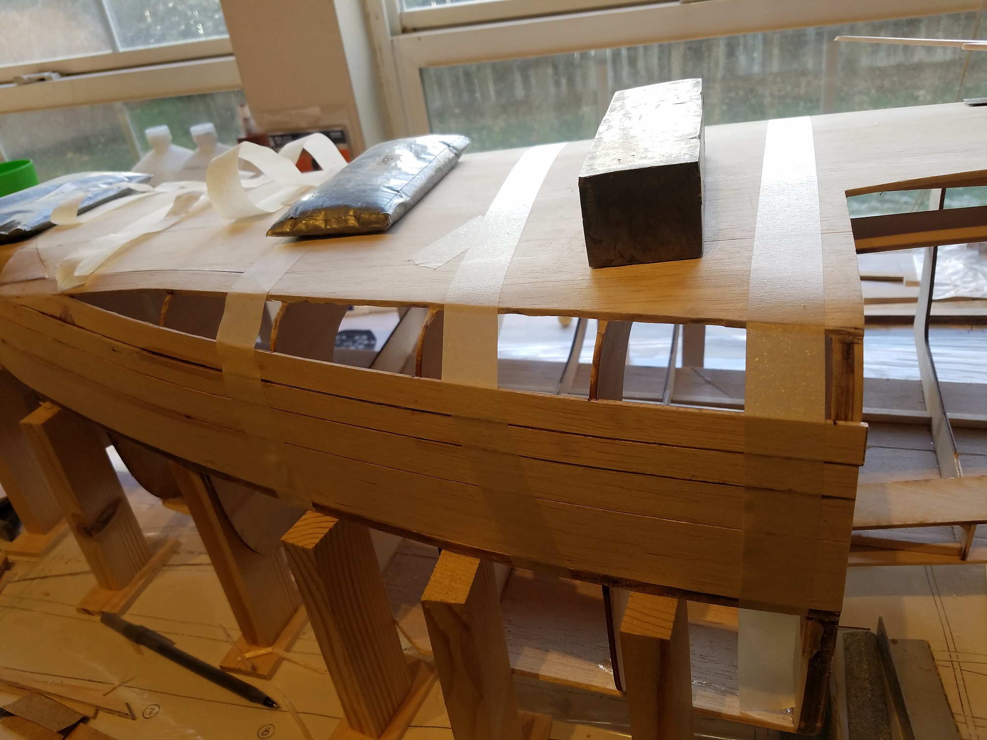

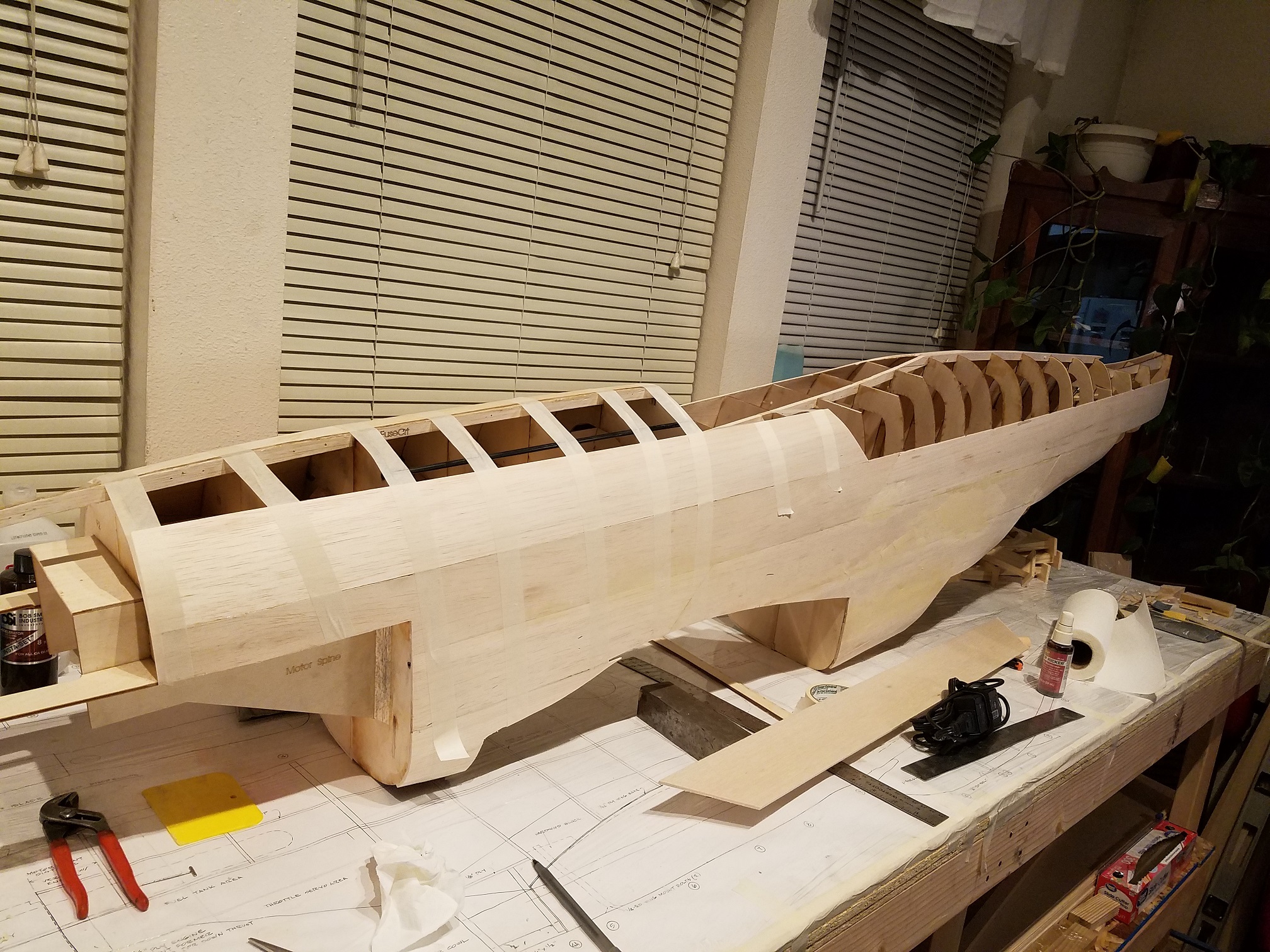

And then to the rear half of the fuse. I am making sure I don't put any sheeting joints near any of the previously sheeted areas. Also keeping it inconsistent from the opposite side of the fuse. As it stands now, the fuse has lost any flex it previously had. It has become quite strong.

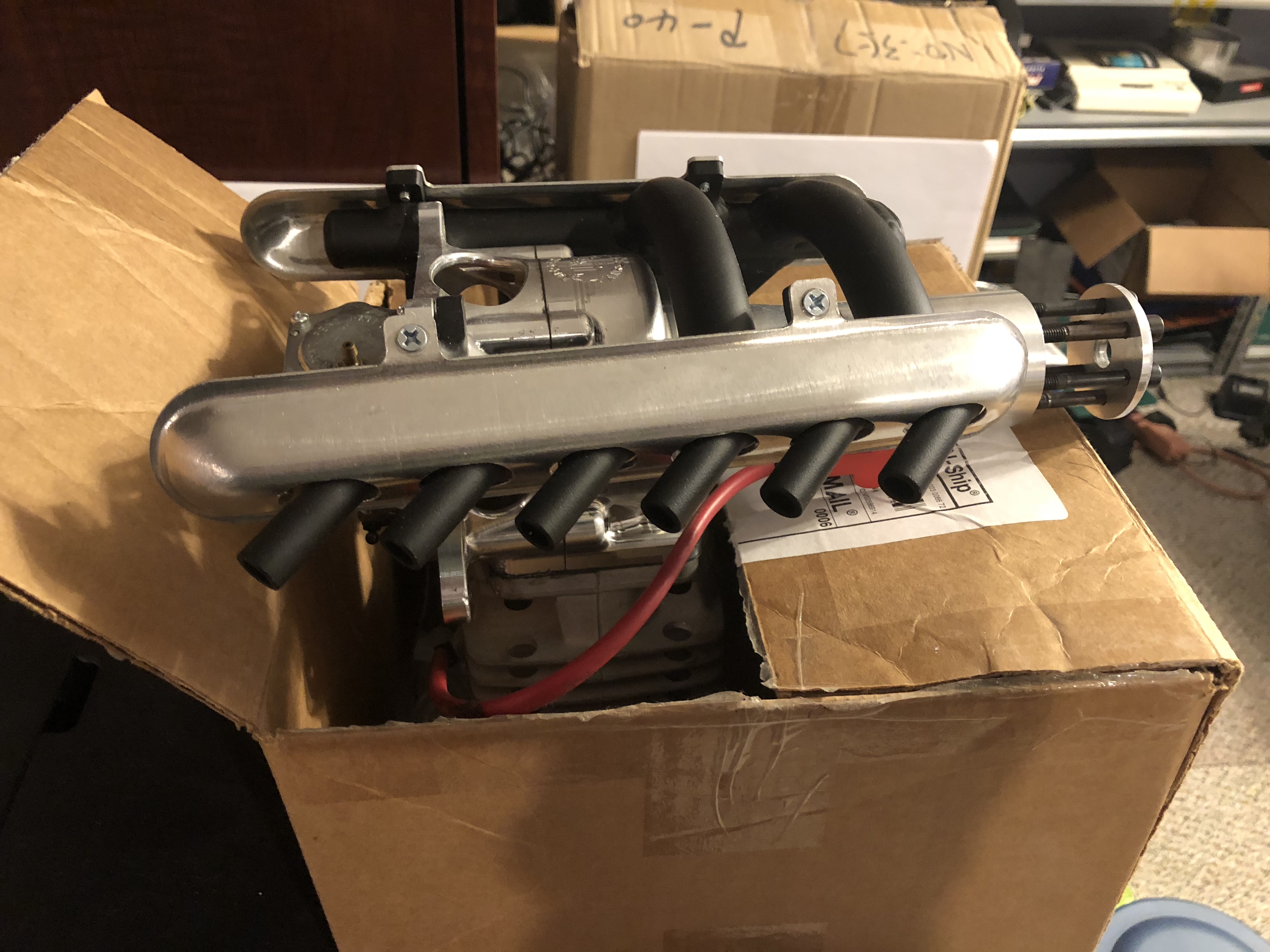

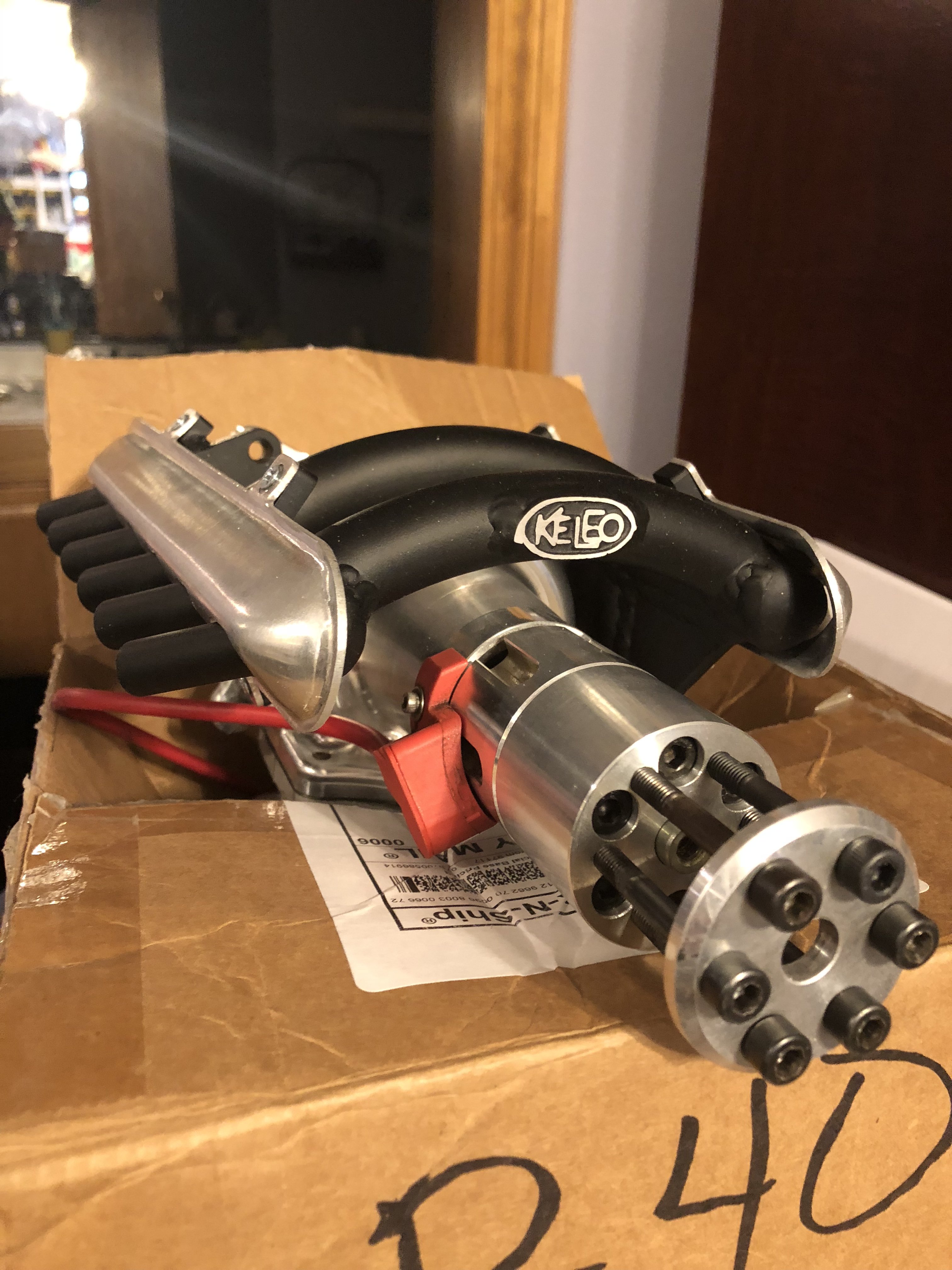

Looking GREAT! I like your "Datum" Laser. Rob I have had this thing built and engine running in my mind and can hardly wait for you to get there. BTW.....Going to entice all us with a bench run of that marvelous engine ?
You think you have been thinking about it? Ha...you should try it from my shoes. I can hardly wait to see this thing in the air. To hear the "ROAR" of that Mighty Kolm wailing across the sky.
Ask and you shall receive my friend.
