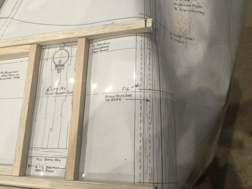

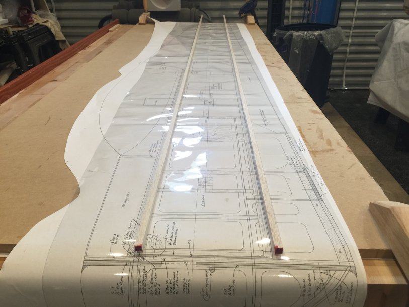

Earlier today, I was able to cut the longerons for the Carden #2, and then I assured that my table was flat. Just now, I laid out the plans, and covered them with this plastic film.
This is the step I must do next, from the manual:
4. Build the Truss side over the Plans. (3/8” sq. and 3/8” x 1/2” Vertical Braces are pre-cut) Install the Fuse Socket Supports. We line up the socket hole over the Plans and mark the Truss Sides for an accurate installation. Using the Socket Support as a guide, mark the Socket hole on the 1/8” Balsa Fuse Side. Cut the Socket hole in the 1/8” Balsa using a Circle Cutter or Dremel. Properly position and glue the 1/8” Balsa Fuse Side to the Truss. Trial fit the Motor Box and Fuse Sides upside down over the Top View Plan. Line up the Motor Box so F-2 matches the Top View Plan. Make sure to position the Motor Box so the Top Plate hangs over the front of your building board so the Box can sit level with the Fuse Sides. Sand the taper on the front and back edge of the Fuse Side to match the Plans. Complete steps 5, 6, & 7 in this position.
what glue should I use for this step? Epoxy or Titebond II or III?

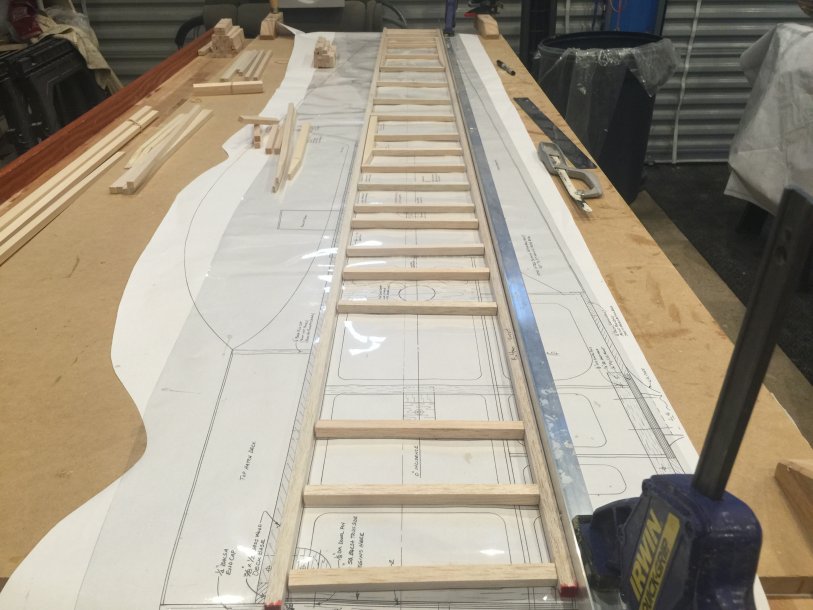

Here is one of four.

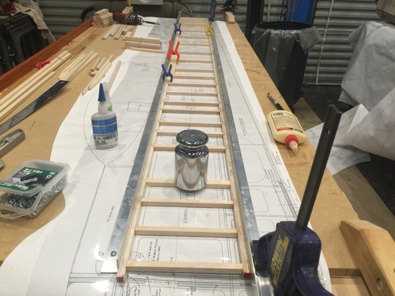

Got three more to do. I will do one per day.

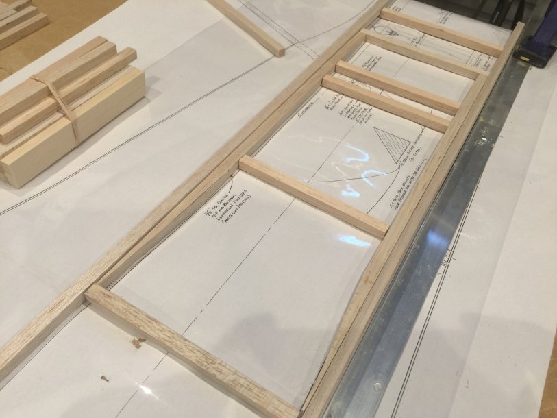

I used medium CA to glue balsa to balsa, and sometimes thin CA to help hold it. For the hardwood to the balsa, I used Titebond glue with clamps. No hurry here for me, I will check it tomorrow morning, remove it, and then tomorrow evening, do the next one. And in few days, all 4 sides will be done, meaning, truss only. Then I will still have to do the sheeting and remainder. But so far, so good. I am starting to understand the principles of the build for this section.

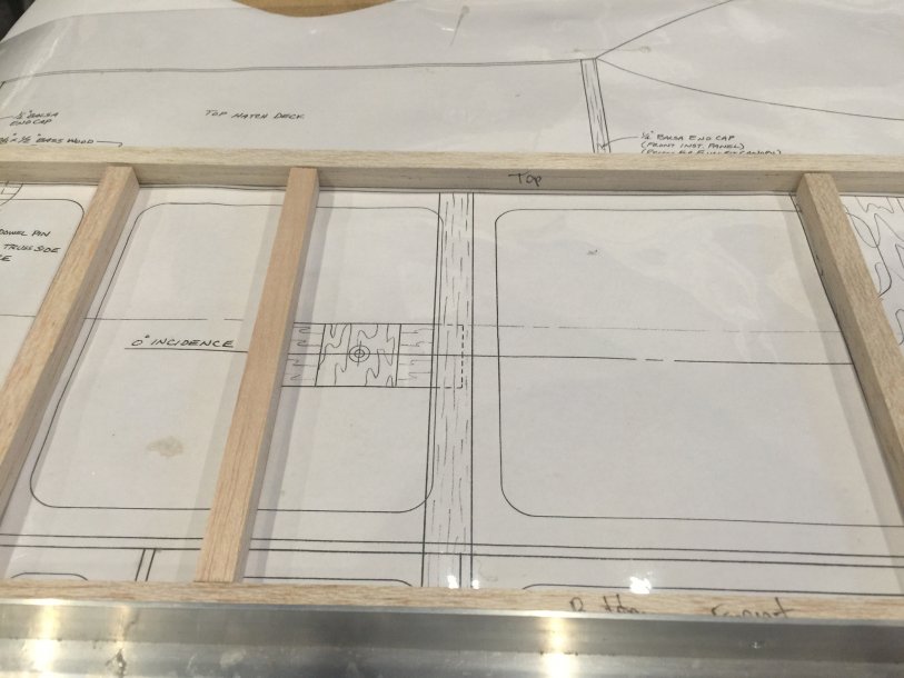

I want to mention, that, again, I am so impressed by this kit, and I forgot to mention this last night. All of these vertical 3/8" balsa truss sticks are pre-cut, and carefully packaged. Just amazes me, they are perfectly cut to same length. and Square. all you have to do is glue them, on, inside the lines of the plan. Very easy. I just went and checked on the 1st truss, and it looks great. I started on the 2nd one. When I get home from work this afternoon, I can do the the 3rd one. Now I have to study on how do I align the wing tube and stab tube supports.
