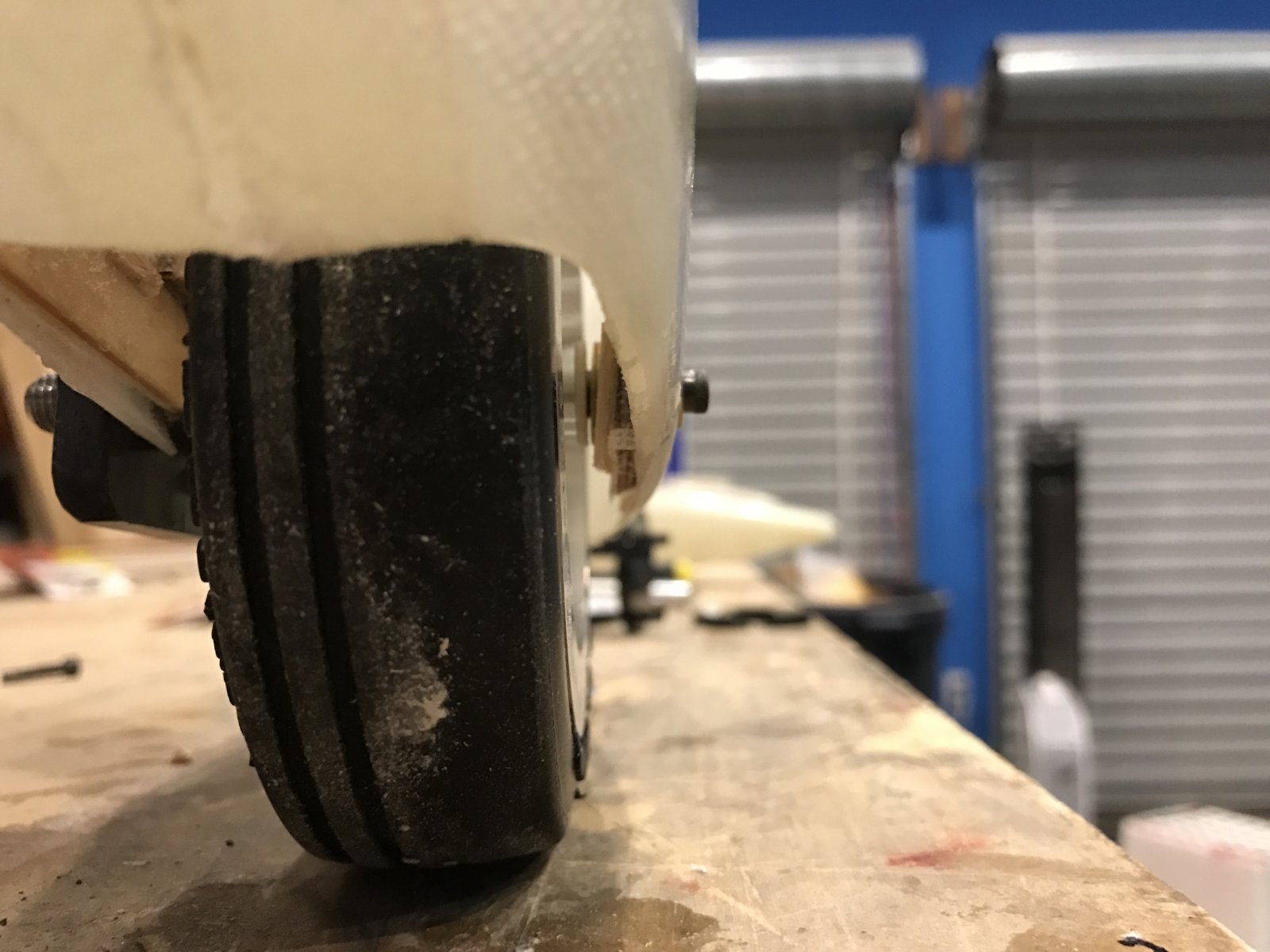

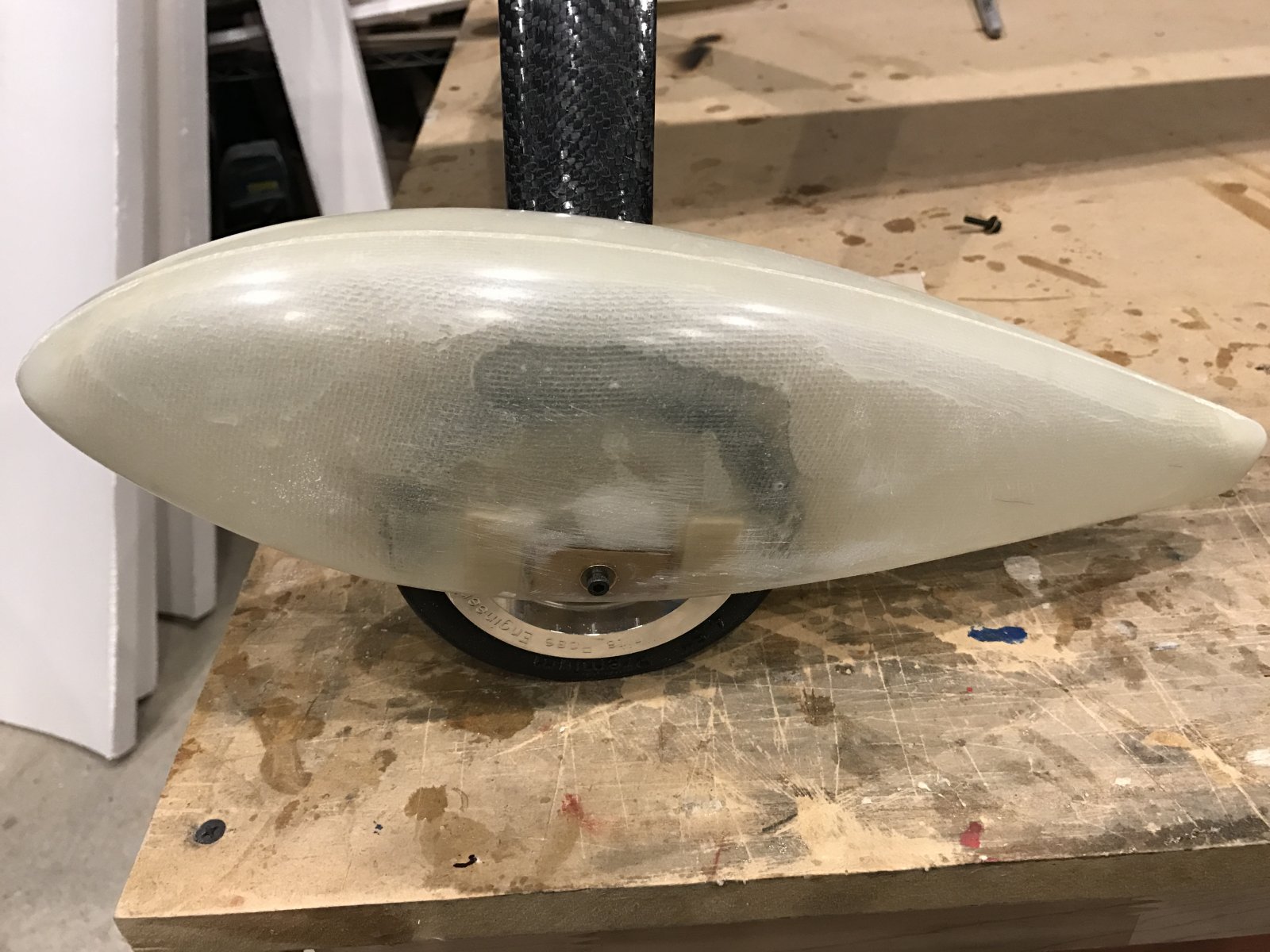

More wheel pants! Now, they are done, primer time for them. Next up, the cowl....

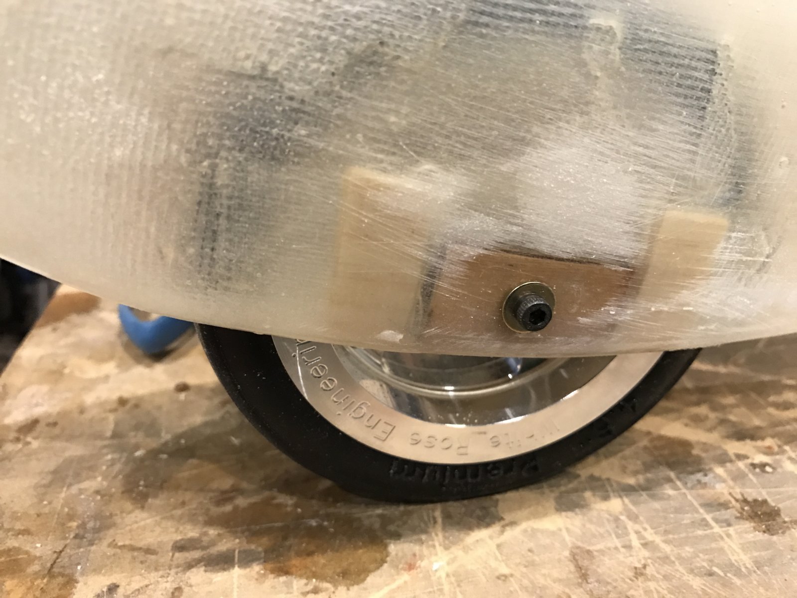

the wood block, on the outer side of the wheel, inside the pant, is glued on with WEST resin, and then fiber glass tape, then thin balsa to be able to compress the fiberglass tape/resin to the inside of the wheel pant.

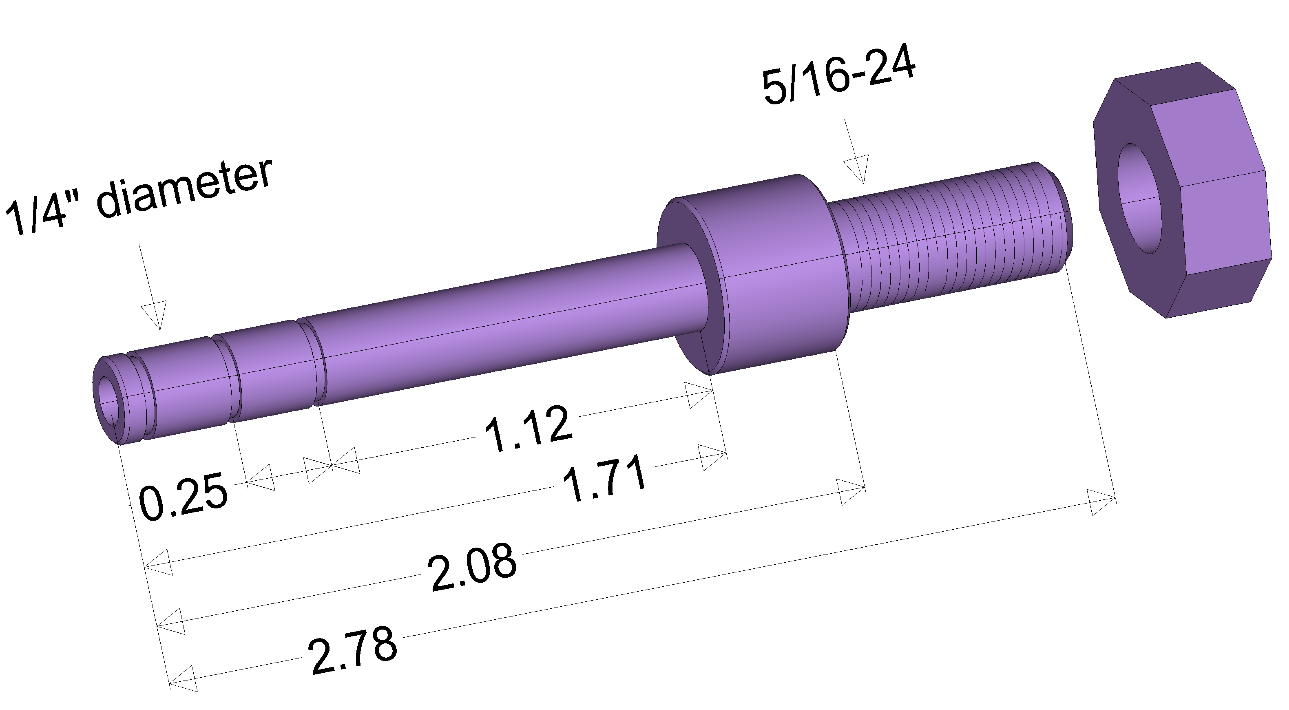

Hi Ben, these are the standard titanium axles from White Rose Engineering. Been using them for years for this reason, among other. These axles are very tough. I have bent a few, but considering hundreds of landings, I think they are much better than most out there. Some of the axles that come in 40% sized arfs have landed as little as one flight!
The ends of the White Rose titanium axles are drilled and tapped for 6-32 screws.
