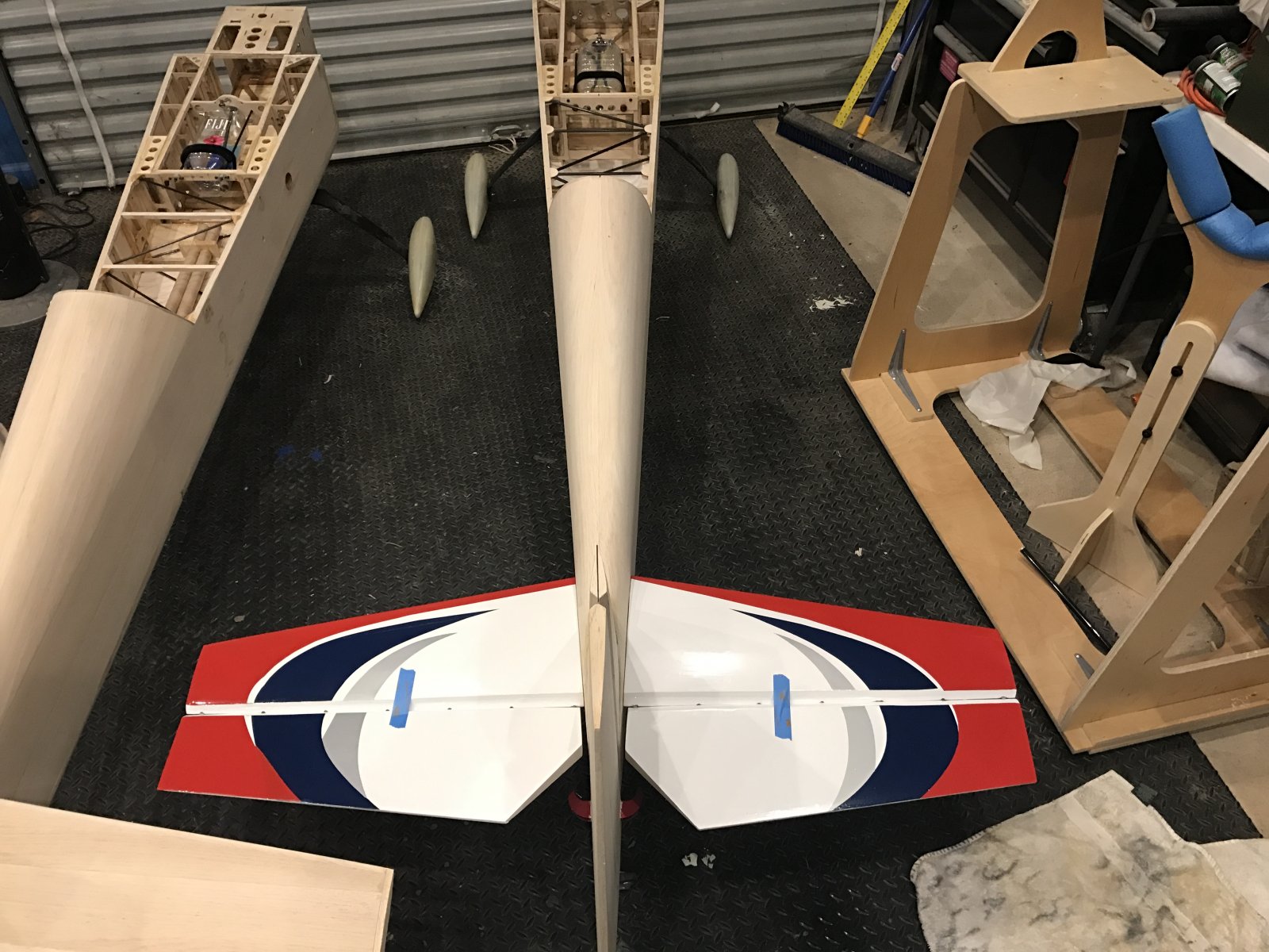

One set of stabs is done.
Lots of work to do that!

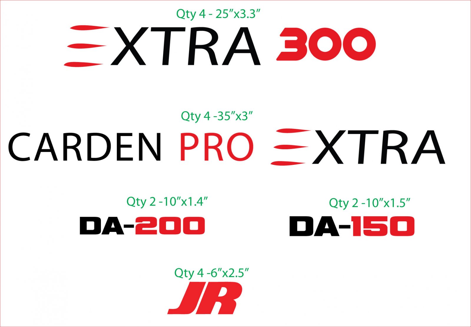

I also contacted Eric from B & E Graphix and he has designed these graphics for the airplanes:

Like the graphic design B&E made for your planes , they are very good for design ideas .

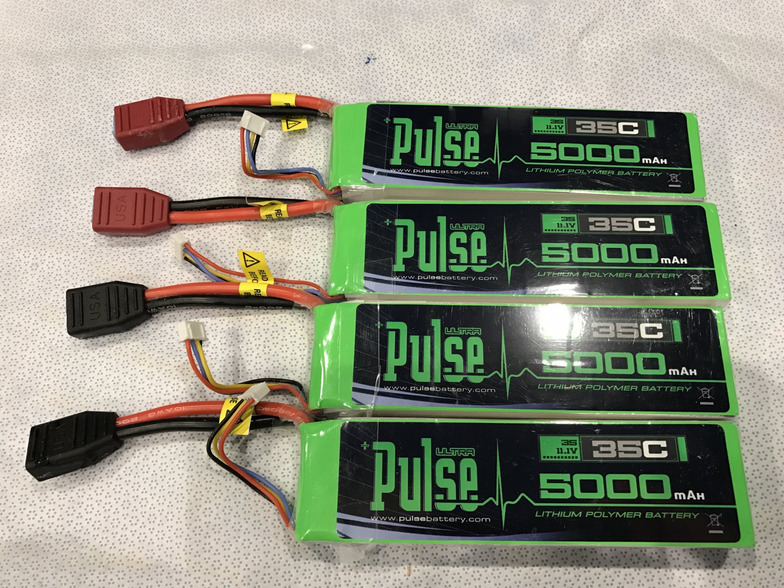

Where did you get the batteries and what type are those ends you soldered on , not Mpx ?

The batteries are 3S lipo batteries from Pulse. I will be using a central box 400 from Jeti, that will down regulate the voltage to 8.0 volts. that way, from flight after flight, servos are seeing same voltage throughout the day.

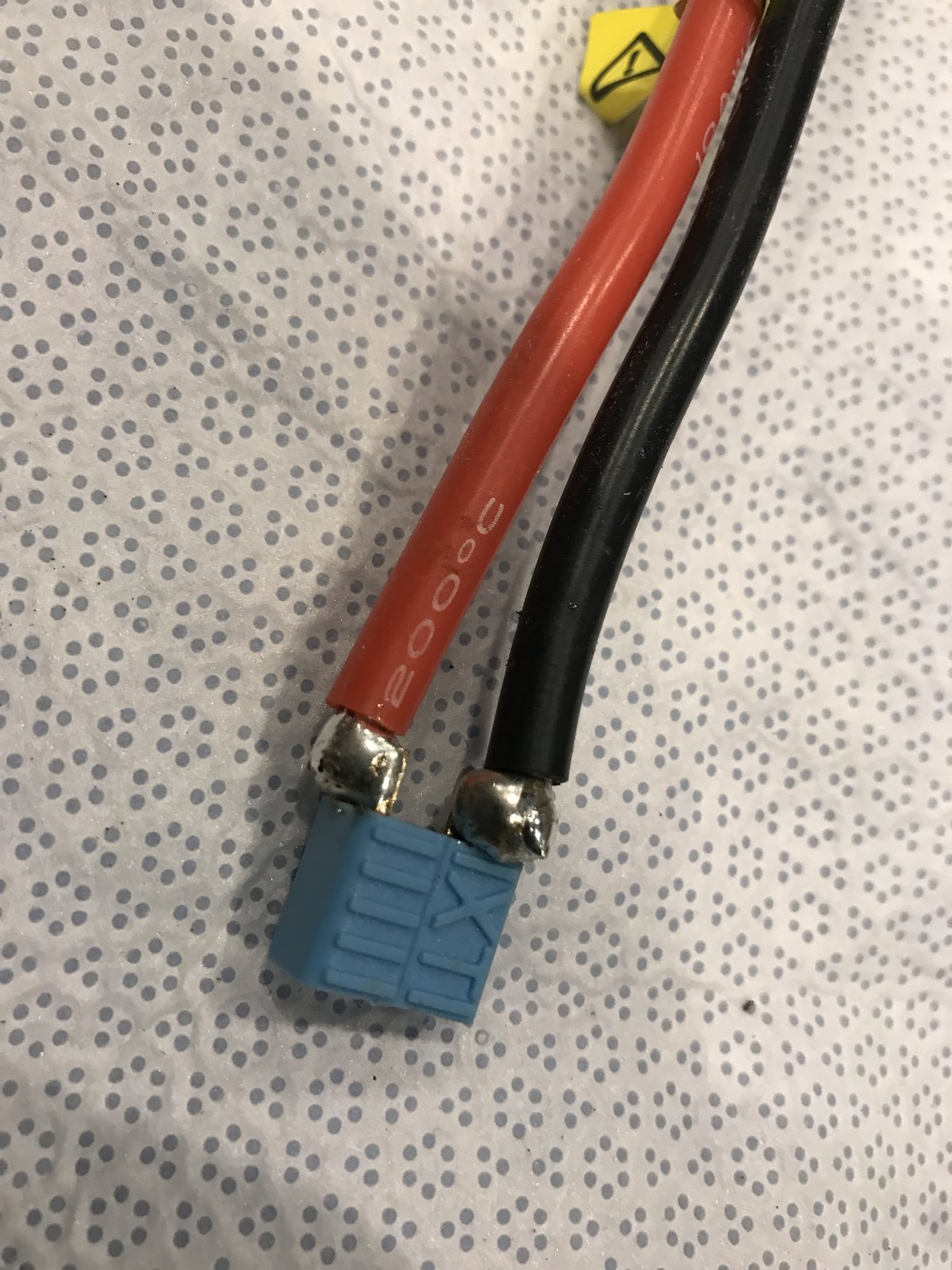

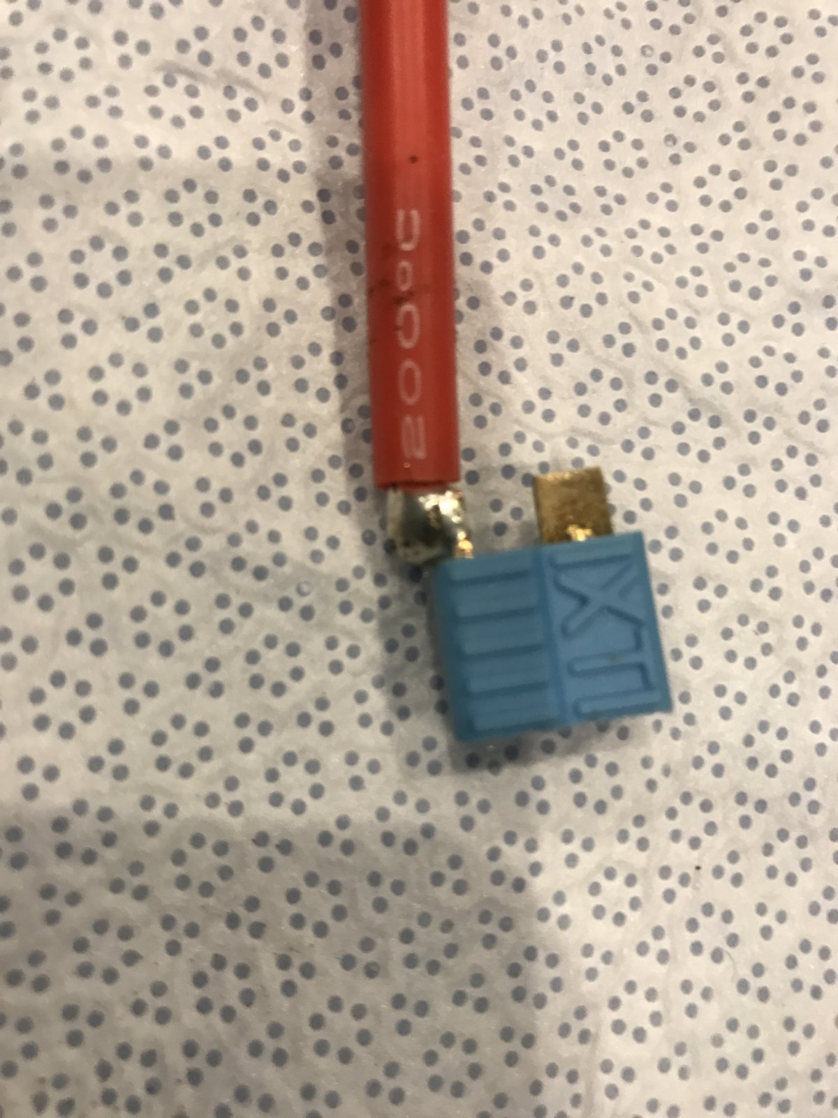

I soldered on Deans plugs. Then, i glued on the plug covers, sold by Esprit RC.

Looks like you have more than adequate voltage for the new Aircrafts and those solider joint look great should stand up to the vibration .

Hi Rusty, yes, you are correct. I do not like to plug anything in and out of the receiver/powerbox. will make an extension, with an MPX that plugs into the central box, and then other end will have a male deans plug. On this airplane, i can use either 2s or 3s, but 3s will guarantee that the servos see constant voltage throughout the 4 or 5 flights i make in a day or during competition. Yes, i took my time soldering those bad boys on there. Always have to make sure you do not get a cold joint. otw, badness can happen!
