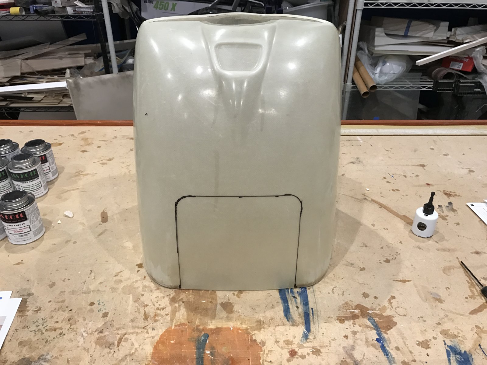

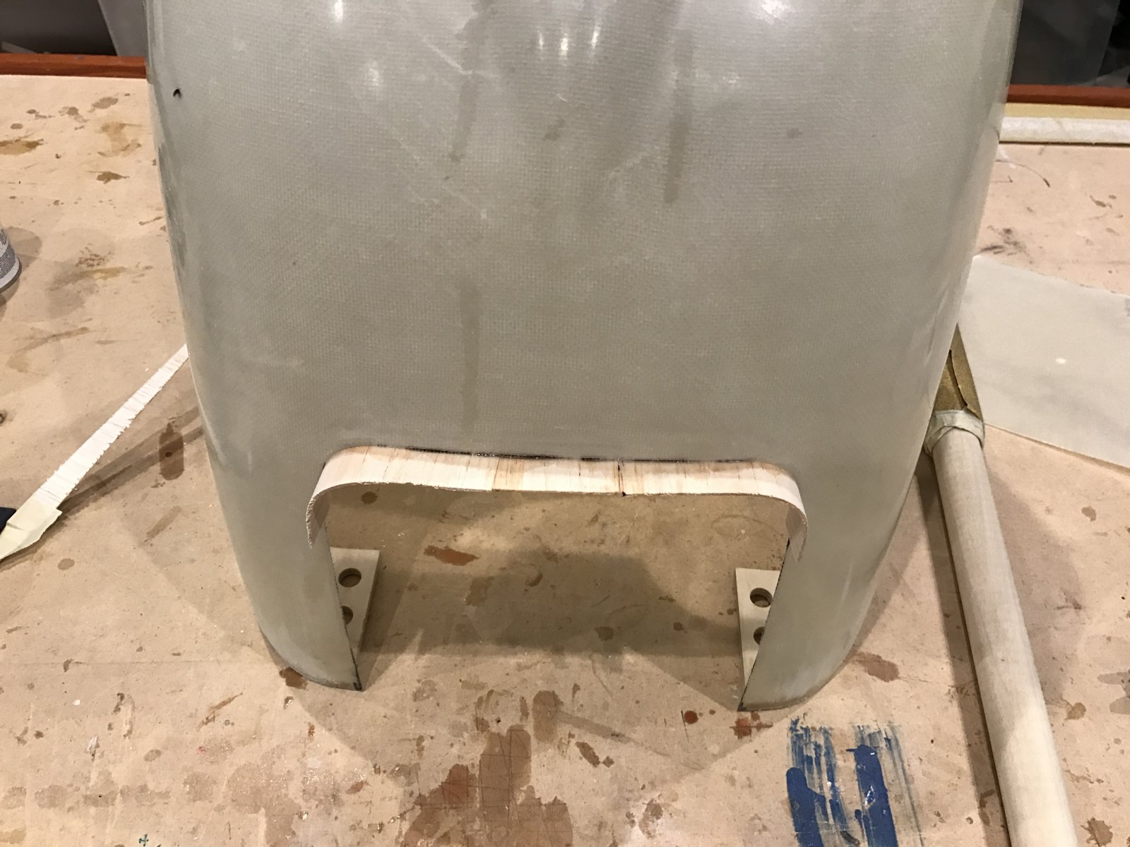

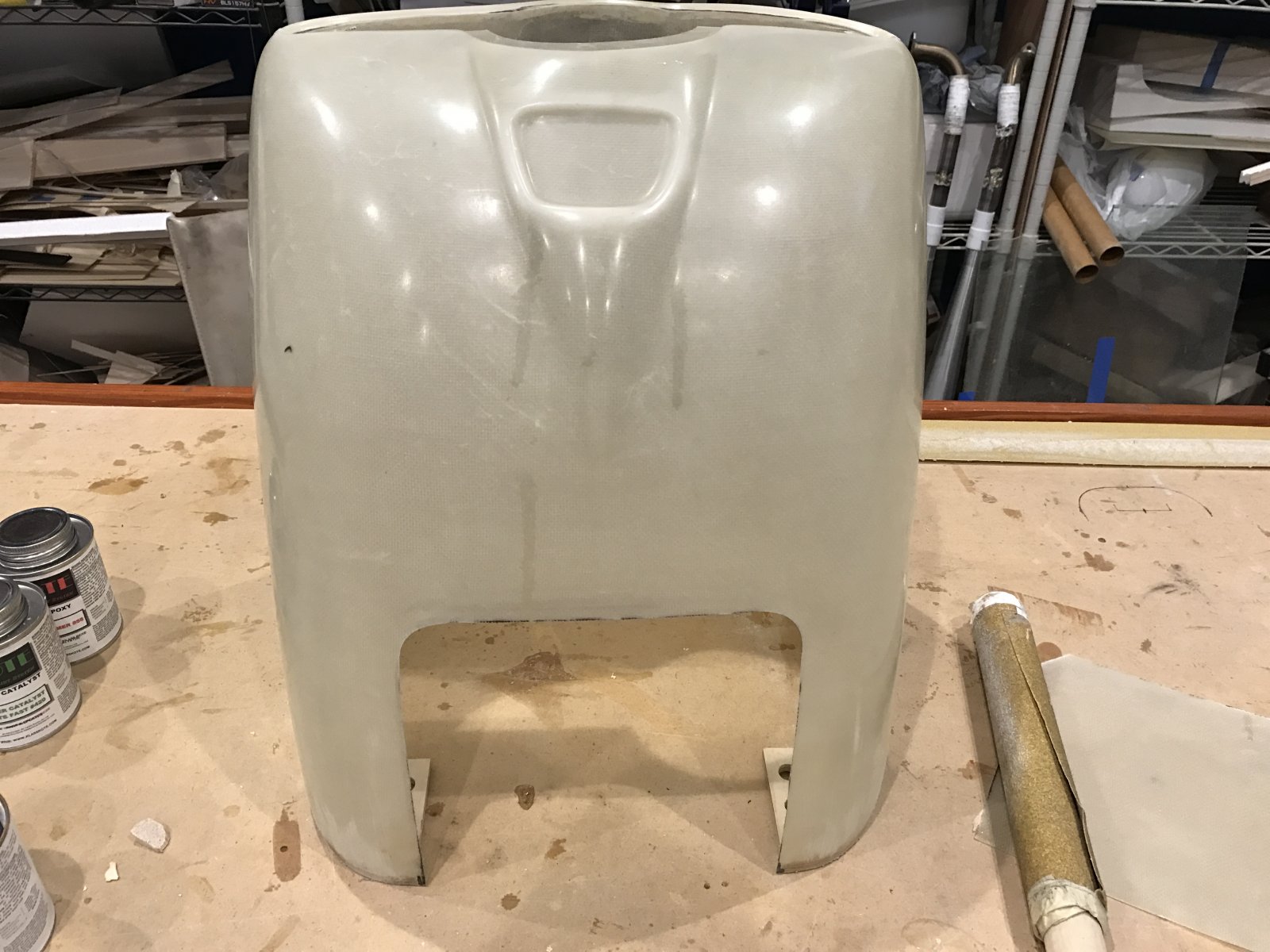

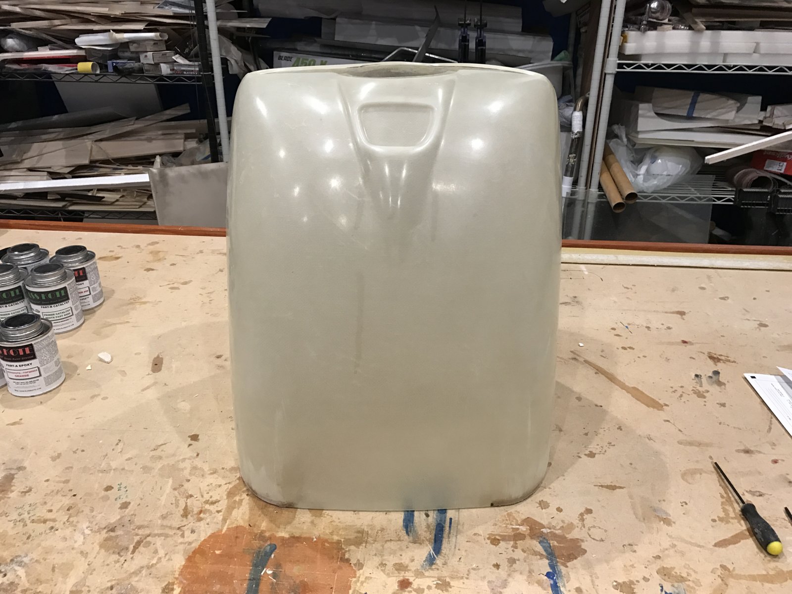

finally got to work on the cowl. Cut out the hole in the bottom...
after cutting out the hole, I used 1/16th balsa, edge glued to the cowl with thin CA. Then, iu began to lay the very light cloth, (3/4 ounce), multiple layers, with WEST epoxy resin. In 4 hours, I will apply another set of layers of resin, then tomorrow, I will sand the lip down to make it look pretty. By then the balsa will be doing nothing, purely a scaffold for the resin and cloth.

I like the lip on the cowl ,PAU has it on their cowl , it will greatly increase the air flow out of the engine bay.
When I had to built up an area like the lip I have used micro balloons filler and mix it in with the epoxy .
Add a little rubbing alcohol to thin out mixture an apply, it has worked great for fillets like this .

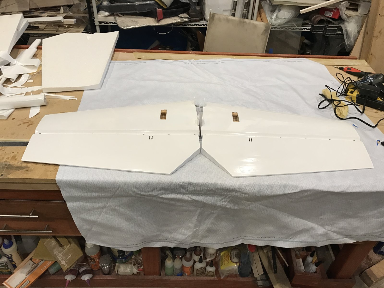

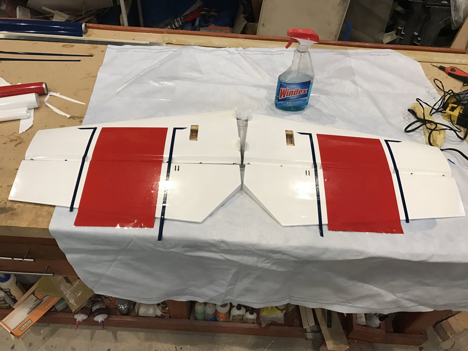

You've been busy covering the tail pieces , i like the red stripes with the black accent lines .
I like the way you use the ammonia to set and squeegie the trim into place .

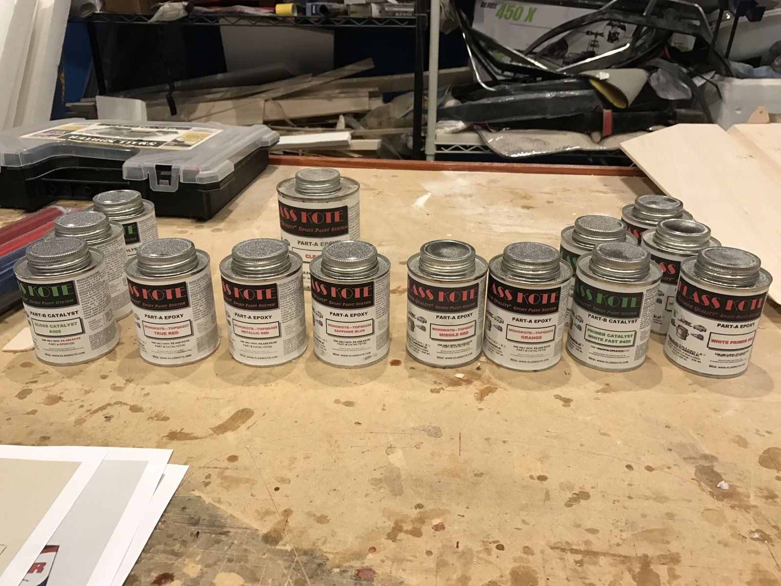

The glass kote paint , is it water base or does it have or old school chemical paints...like the matching color to the covering .

Klass Kote is good ole fashion Epoxy paint.
In the old days, there was a similar paint K&B
the paint is mixed 1 to 1 with a catalyst. SO mixing is involved.
Also, primer has to be laid down first, and it all has to be done within 24 hours, so that the paint has a chemical bond to the primer.
Meaning, Prime, wait 1 hour, prime again, wait another hour, possibly one more coat, or wait 3 to 4 hours, and sand it down. then time to start spraying paint.
When preparing the paint, the paint can be brushed on, or, it can be sprayed on. Spraying it on can be done with a HVLP gun or with an air-brush for smaller jobs, or even a cheap system known as Pre-Val.
