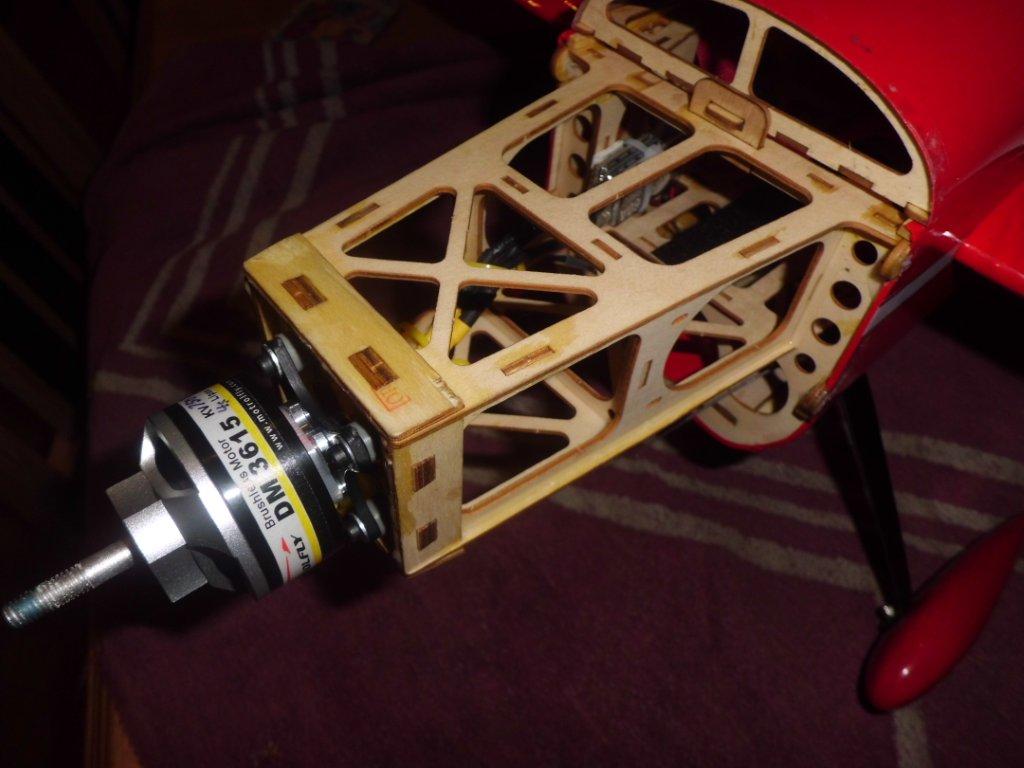

So if anyone wants to turn their laser from a superb all-rounder into a rabid foaming at the mouth beast.. you could bolt a Motrolfly DM-3615 to the nose:
Seriously though. the 3615 may seem like extreme overkill but it actually works fine in the Laser. The lightweight version of the motor picks up the stock mounting points and with it being such a short can motor length is no issue, in fact I had to use some 5mm spacers. It spins a 14x7 xoar. The only negative is that it's 18g heavier then the DN-2820 it replaced, I had to move the ESc as far back as it would go to get the CG right.

Did you test fly it yet? My Laser is pretty explosive with the DM2820 and a Xoar 14x6! Can't imagine how it would be with that motor! :megaroll:
Steve_B
Yep, I put 5 packs through it today. Top speed in level flight is similar to my old DM-2820 750kv, but it's now got unbelievable acceleration and 'punch' out of the hover (not that it was lacking before). It does seem noticeably quicker in the verticals too, with the increased speed pop-tops are brutal. I've been flying my EF Edge with a 3615 for a while and I just had to try one in the Laser, they are fantastic motors (as is the 2820).
