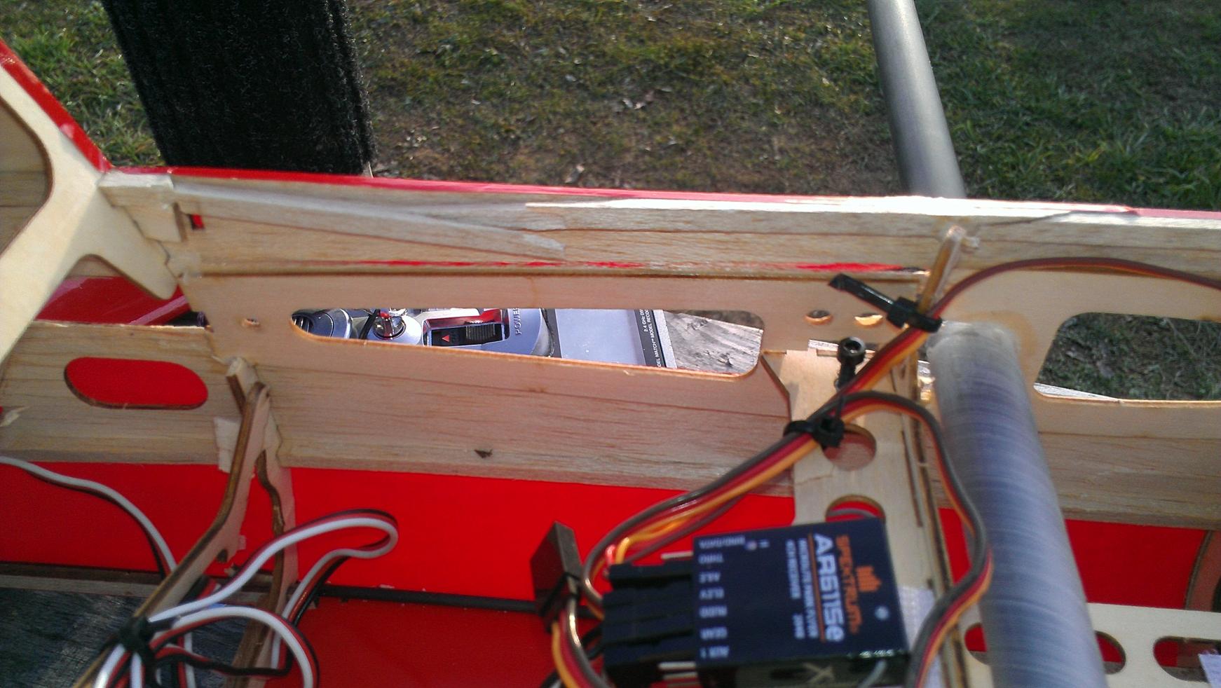

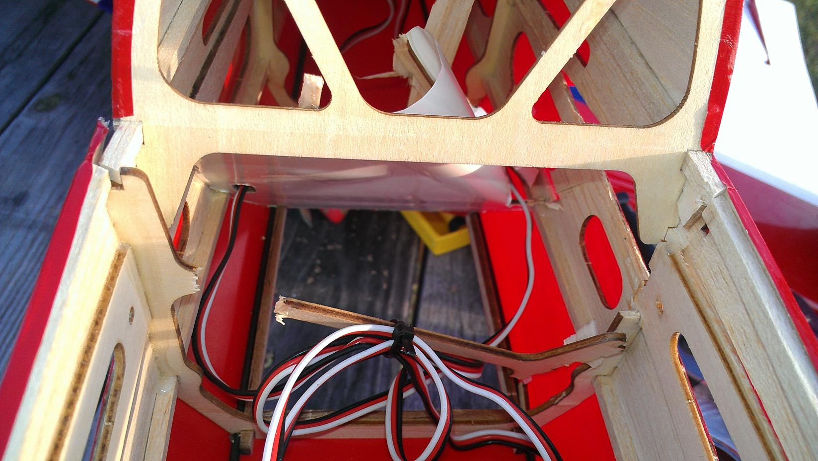

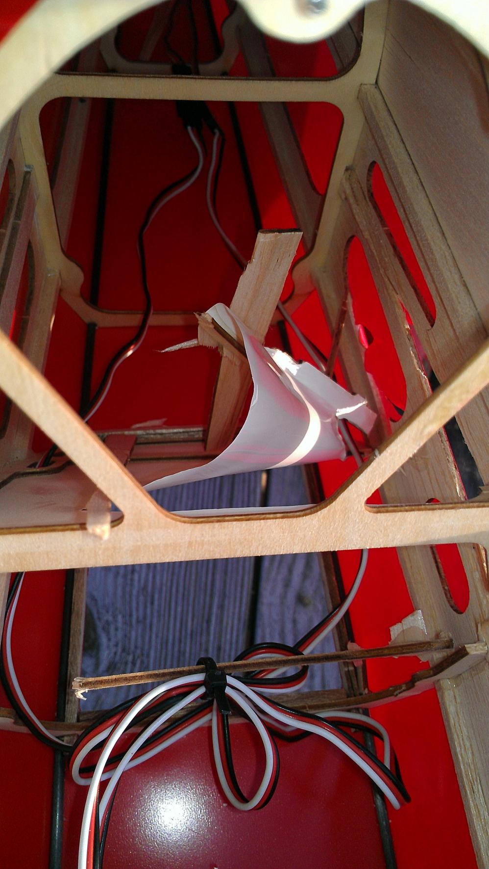

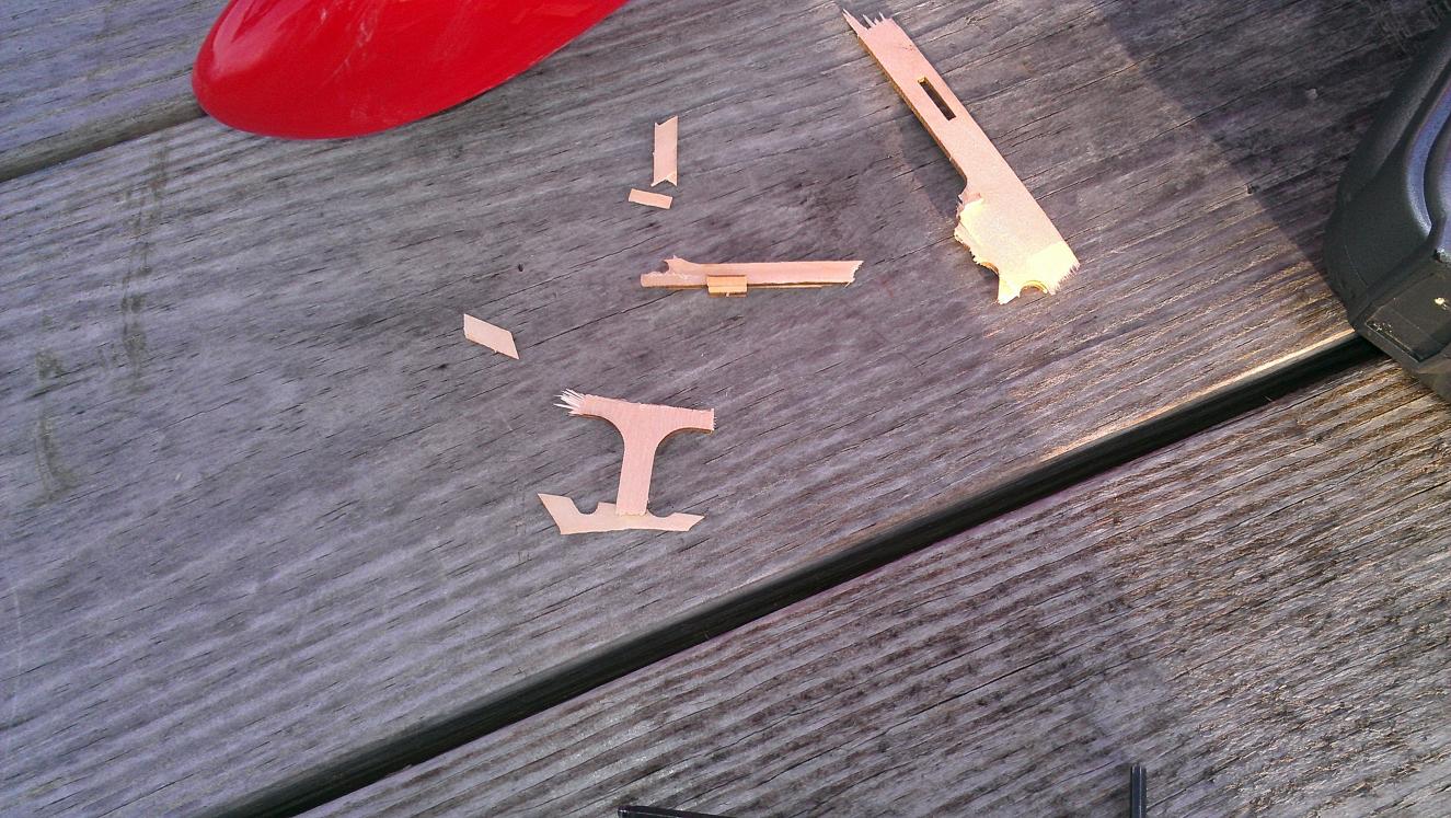

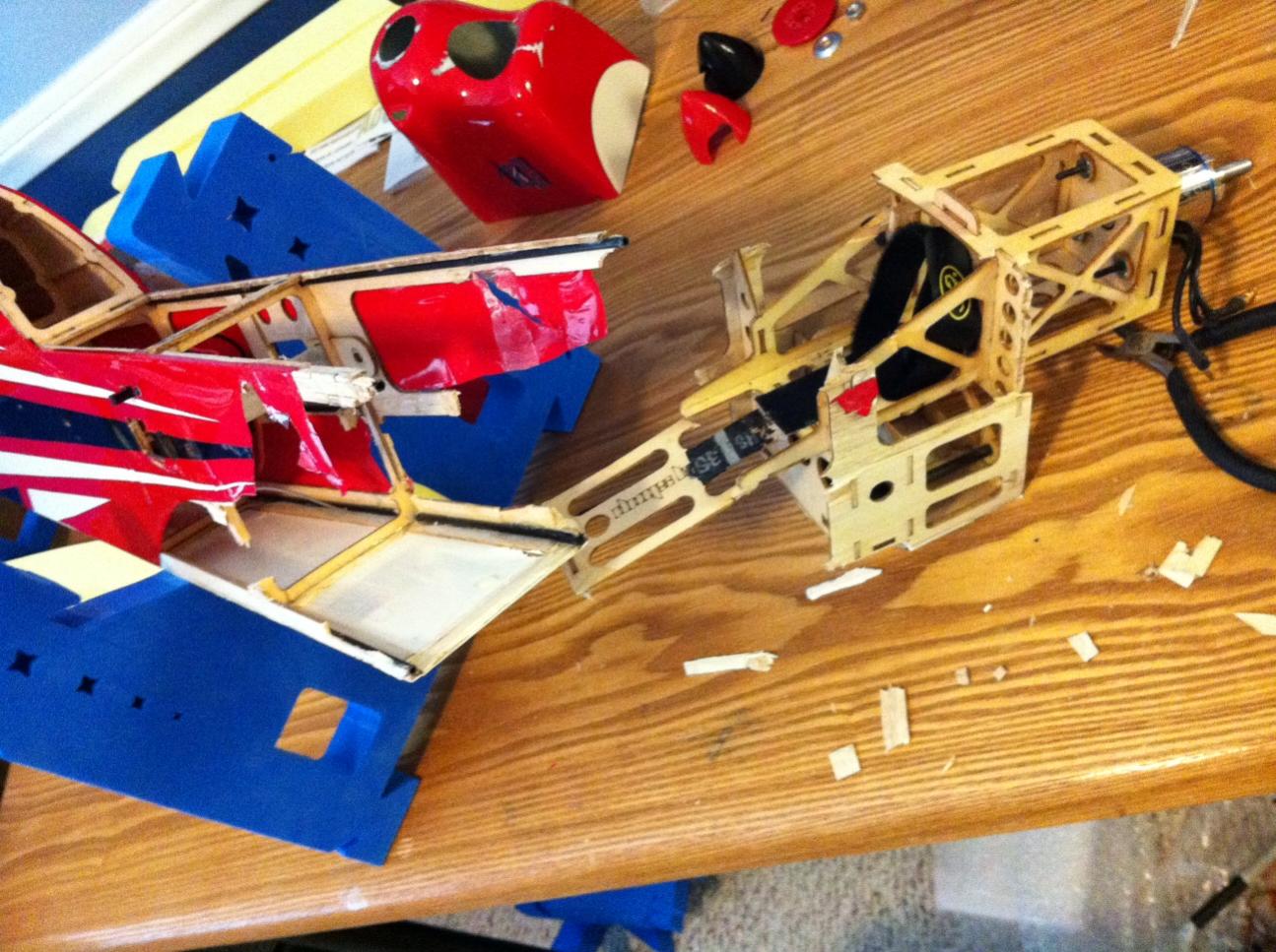

Boo-hoo! I crashed my Laser!!! And in the stupidest possible way! I was practicing slow rolls trying to keep them as crisp as possible. Of course I forgot to set the timer and the LVC kicked in when I was in the KE-portion of a slow roll. Tried to roll it back upright, but that bled off too much speed and put me in an unrecoverable (at least without power) spin. It smacked straight in from 20 ft and did a few cartwheels in the weeds at GCA. I though for sure there was going to be pieces all over the place. But the plane was actually in one piece. Unfortunately, there was a lot of internal structural damage:
* Cracked longerons
* Former at the back of the canopy cracked.

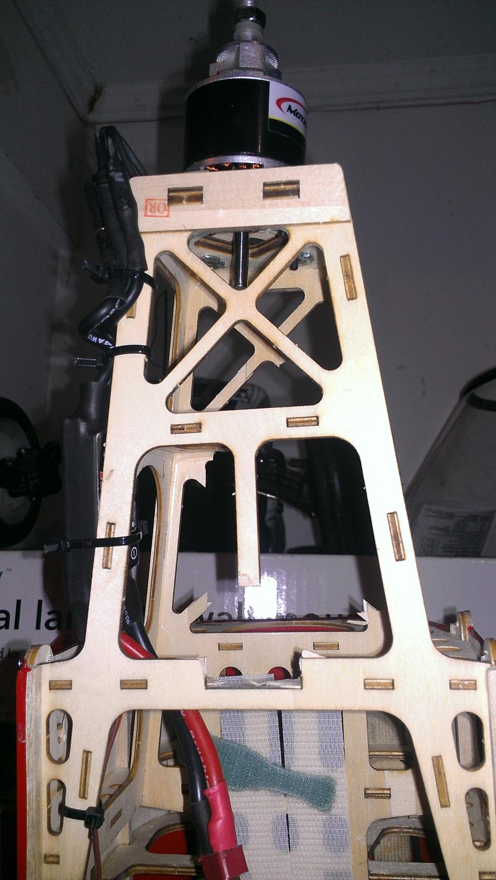

* "Cross-bars" (I'm sure there's a fancier word for it) on motor box cracked.
* Plywood reinforcements where the wings attach cracked.
* Cowl chipped and gel coat missing.
* Broken prop.
* Possibly bent prop adapter on the Motrolfly 2820.
I think I know how to fix it. Instead of trying to patch the motor box, I'm just going to remove the cross-thingies (what the heck are they called???) and stiffen it with CF rods. I may do the same with the former and glue it back along the side of the fuse and add a CF strip to replace the part going across the fuse. That should be as strong, if not stronger than original.
Any pointers?
True testament to EF durability. Your plane "did a few cartwheels" and this is all that's damaged? You could probably CA the pieces back on and you'll be flying again in no time.
njswede
Yup. Irrecoverable spin from 20-30 feet straight in, a few bounces and cartwheels. I thought for sure there would be just sticks left! It's a bit worse than it looks, since the sides and longerons are cracked in several places. But it's probably fixable.
And the SFGs didn't even break! They're all covered in dirt from having plowed the field...

Sorry to see your new laser has took a hit, frustrating way for it to happen too.
Looks like it will fix up just fine. if it were me I might be tempted to strip the covering to do the repairs. Being all red the fus on the laser would be a breeze to re-cover. If you have the bust pieces of ply from the motor box they might just drop right back in and some CA will make good.

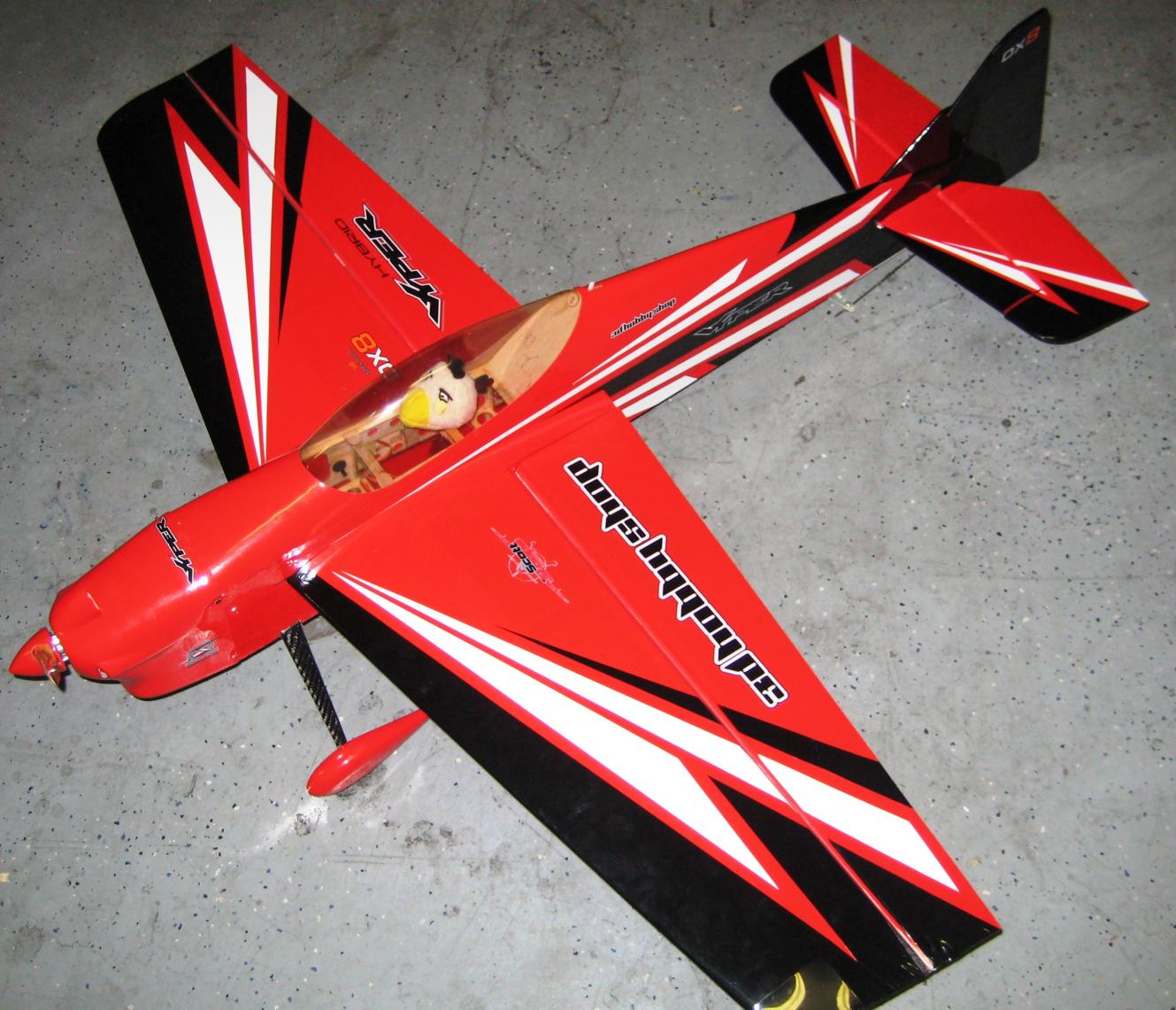

Pontus, as I mentioned on the phone, I'd post some motivational photos for you. This pic is from a 48" Super Vyper that had a mid-air with a similar sized high wing foam trainer. The ultracote held together long enough for me to make a landing on the runway.
When I got home, this is what I saw:vyper midair damage 1.JPG
When I peeled the covering back, this is what happened:vyper midair damage 2.jpg
If I can, you can!
