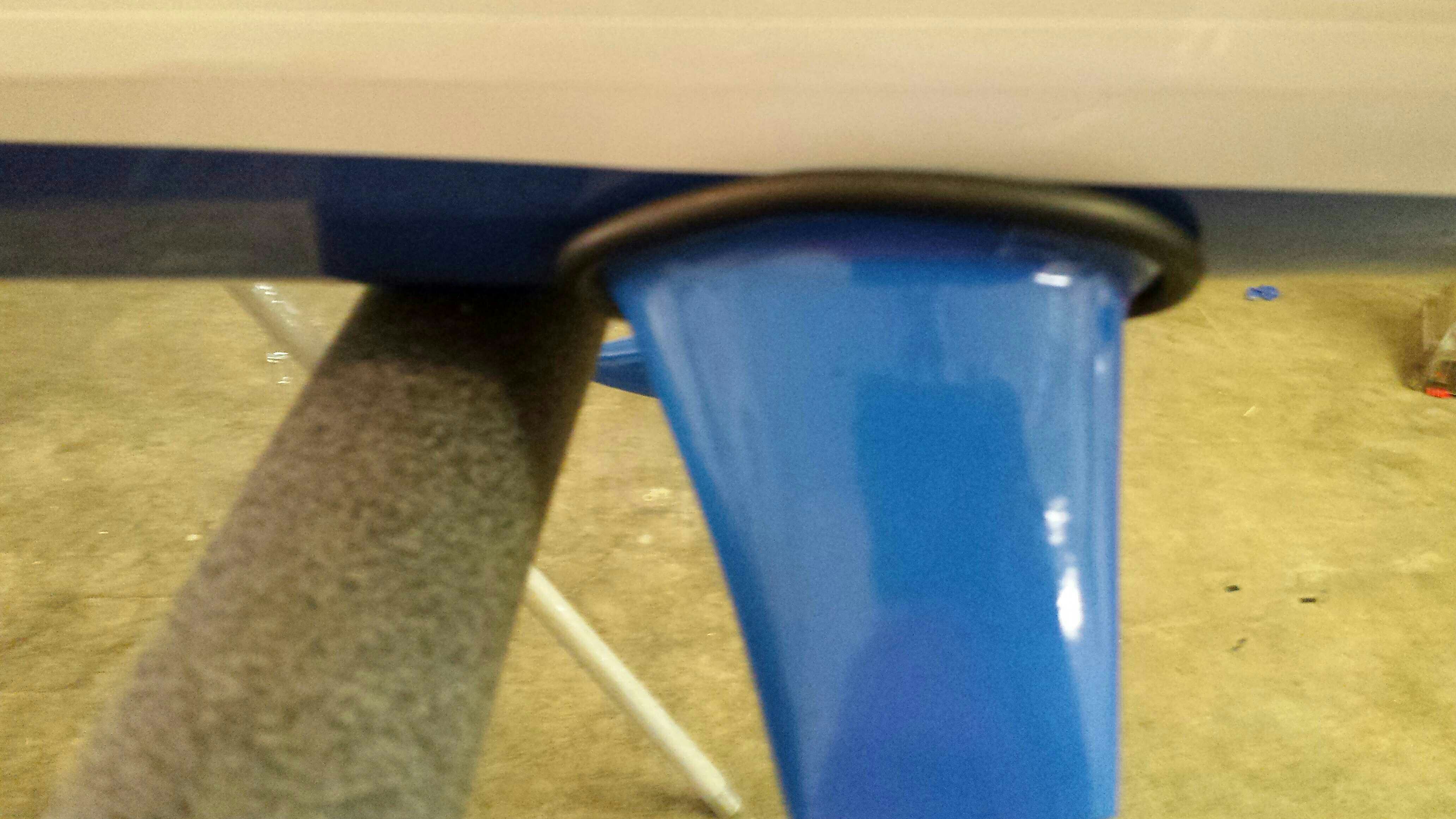

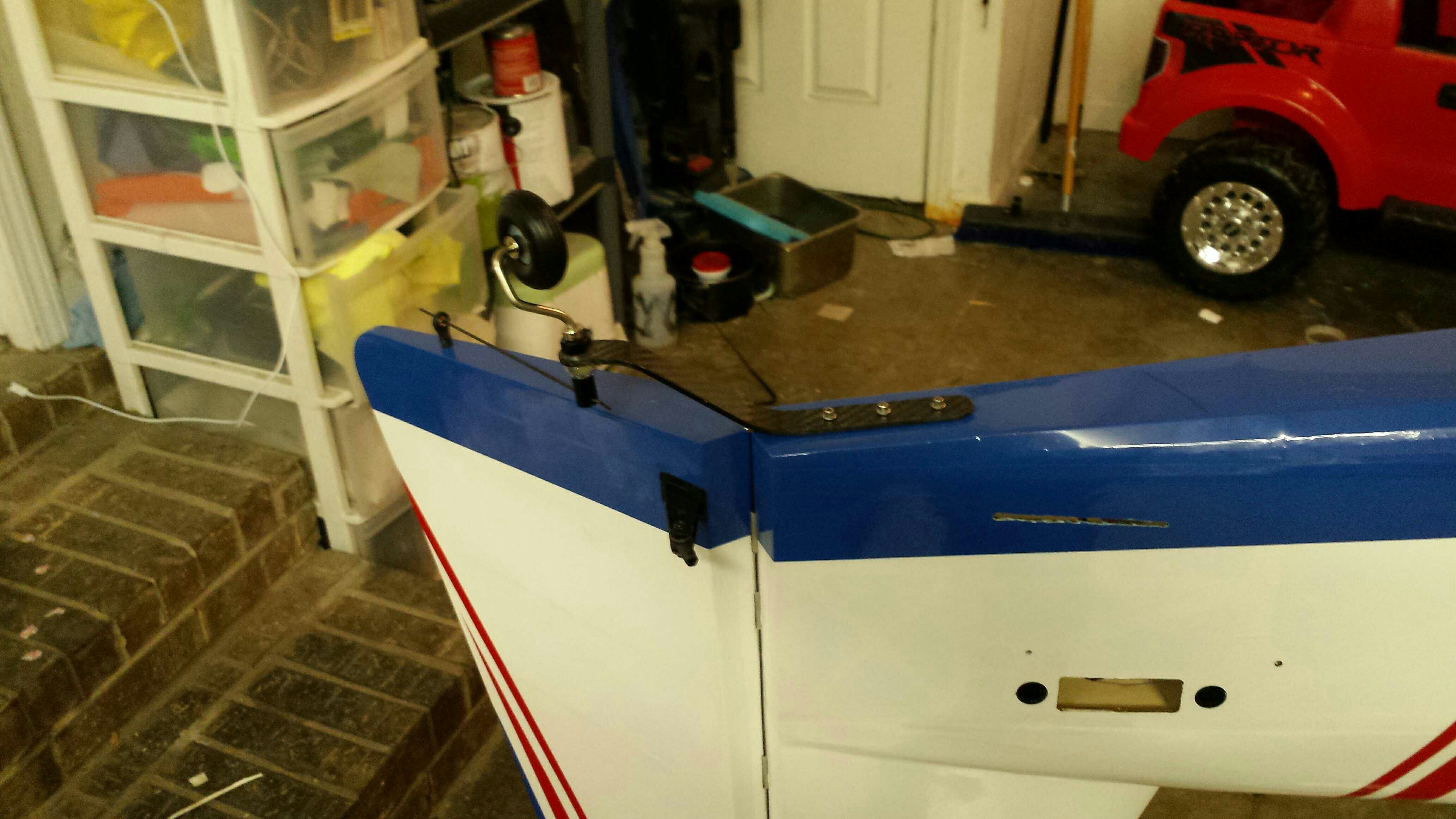

uploadfromtaptalk1396676646374.jpg tail wheel installed I will have a ton of Aztech being arrive next week so the tail wheel assembly will get some nice washers

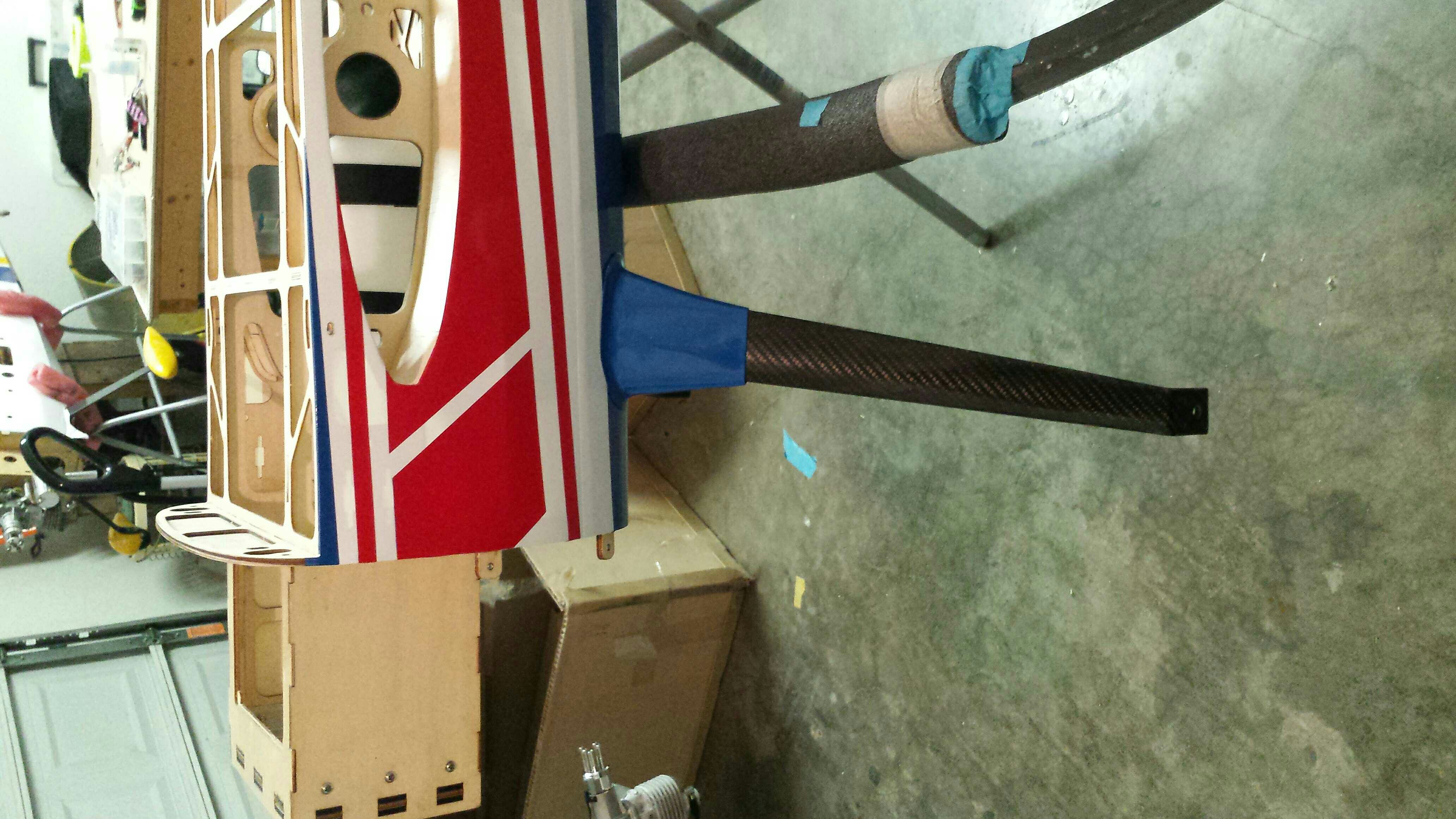

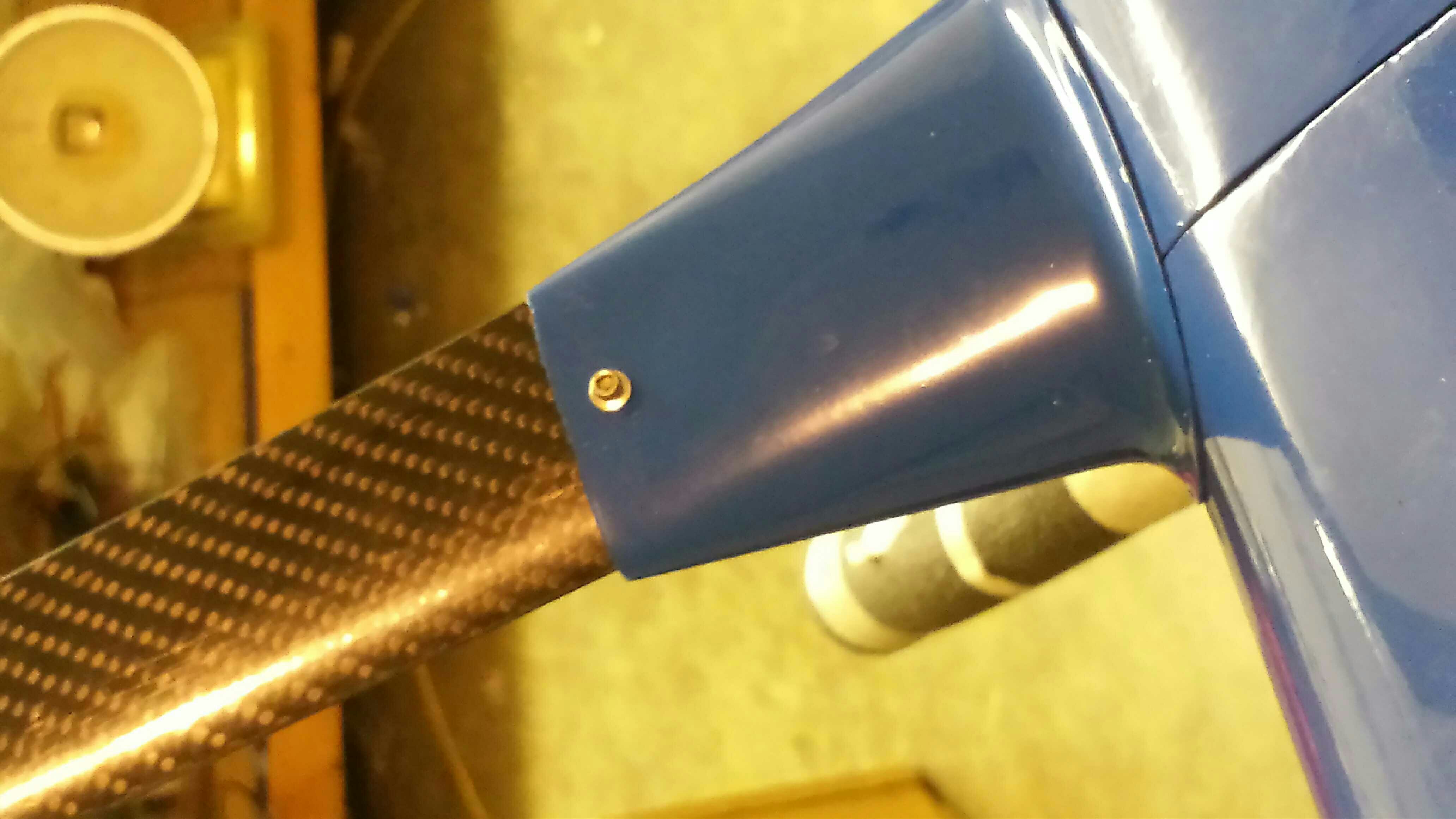

uploadfromtaptalk1396679599092.jpgso I did a little.modifacation on the landing gear cuffs The manual calls to out them on with gasket maker or goop, BUT I decided I would drill and tap the gear to hold them with a bolt, this will make for easy gear removal if needed
uploadfromtaptalk1396680011422.jpgI am going to call the local hobby shop tomorrow and have them order me some four most u trim it will make the gear cuffs look cleaner

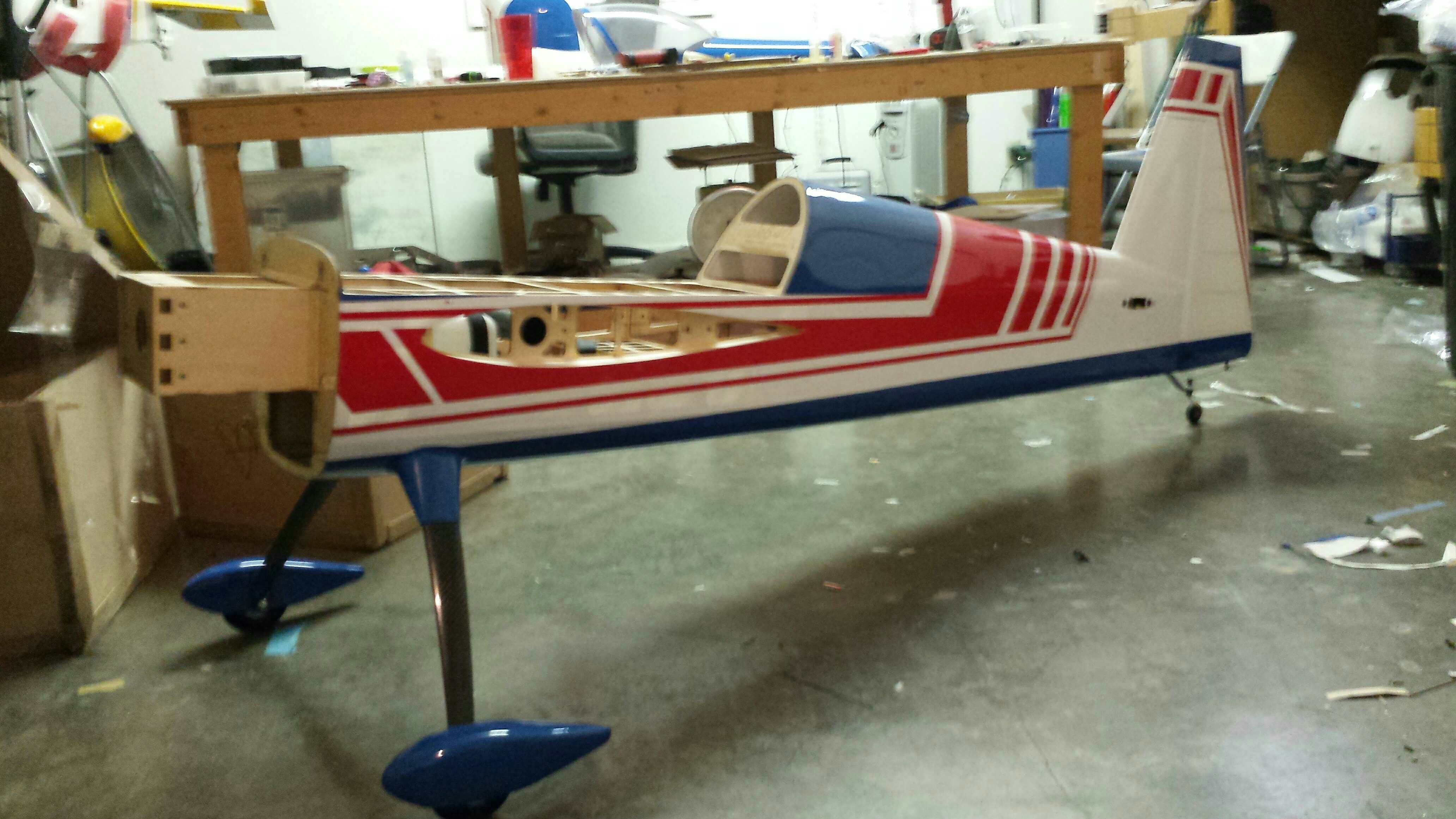

uploadfromtaptalk1396681967077.jpgOK well its on its feet I went a head and mounted the factory wheels. But I have a set of flywheelZ on the way from azhar. Bling bling. I also opted not the lower gear cuffs. I like the look better with out them

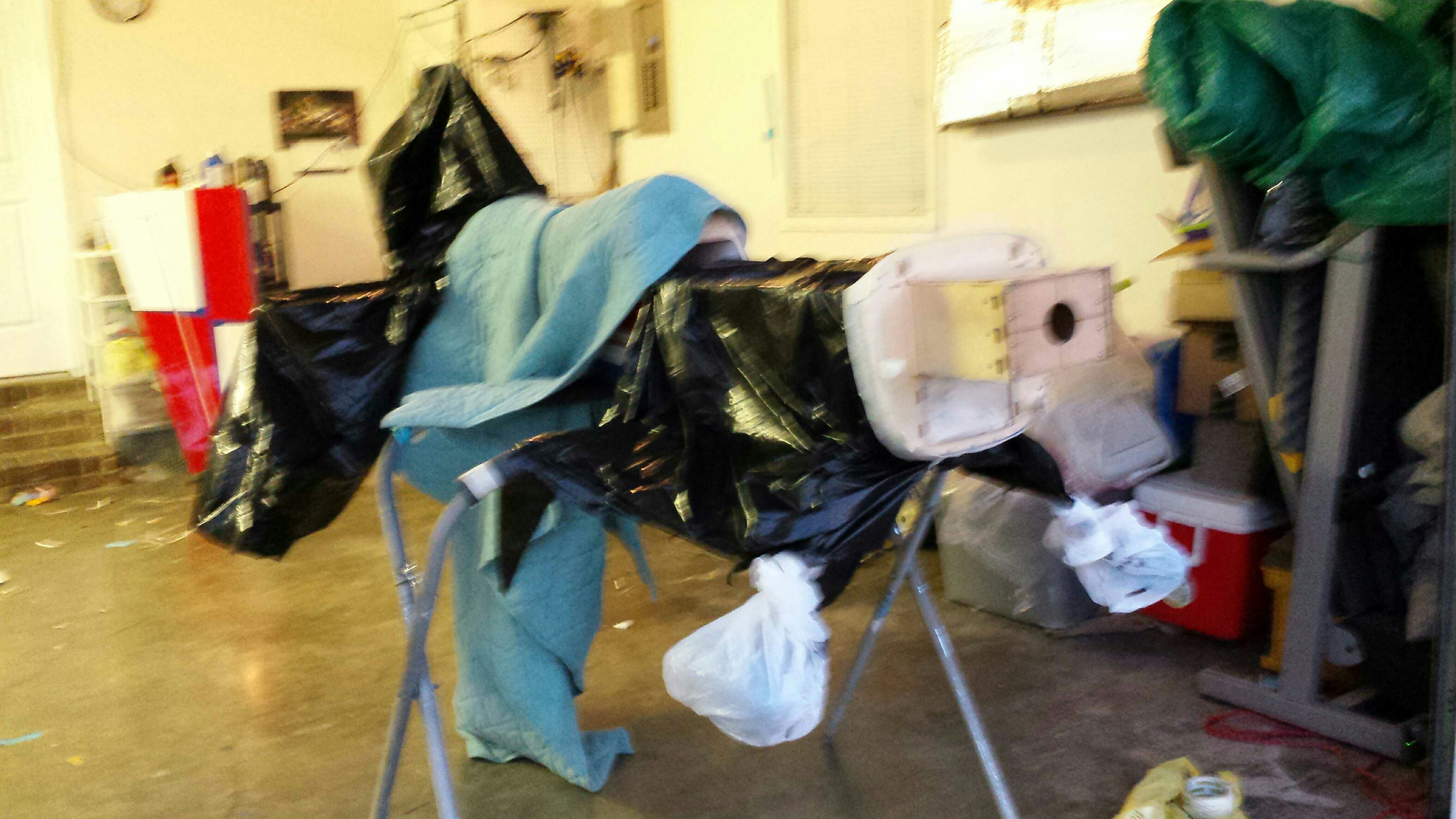

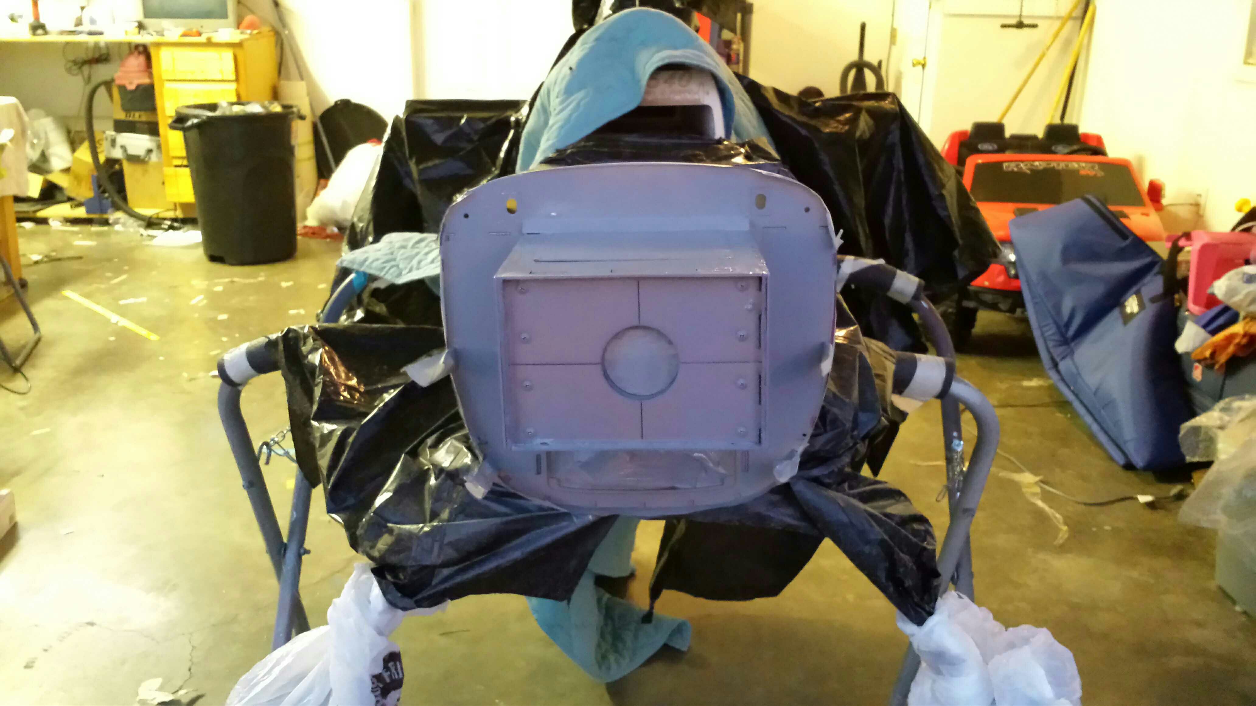

uploadfromtaptalk1396744989549.jpgone Coat of Valspar Grey primer, after it flashes off I will put one light coat of Valspar light Grey speck paint
