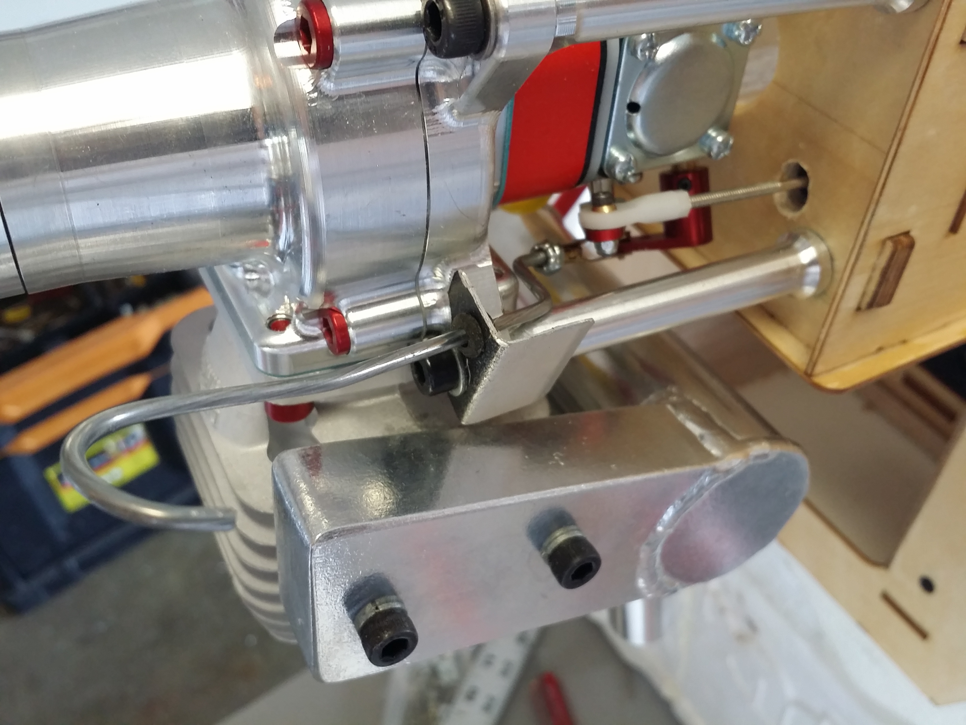

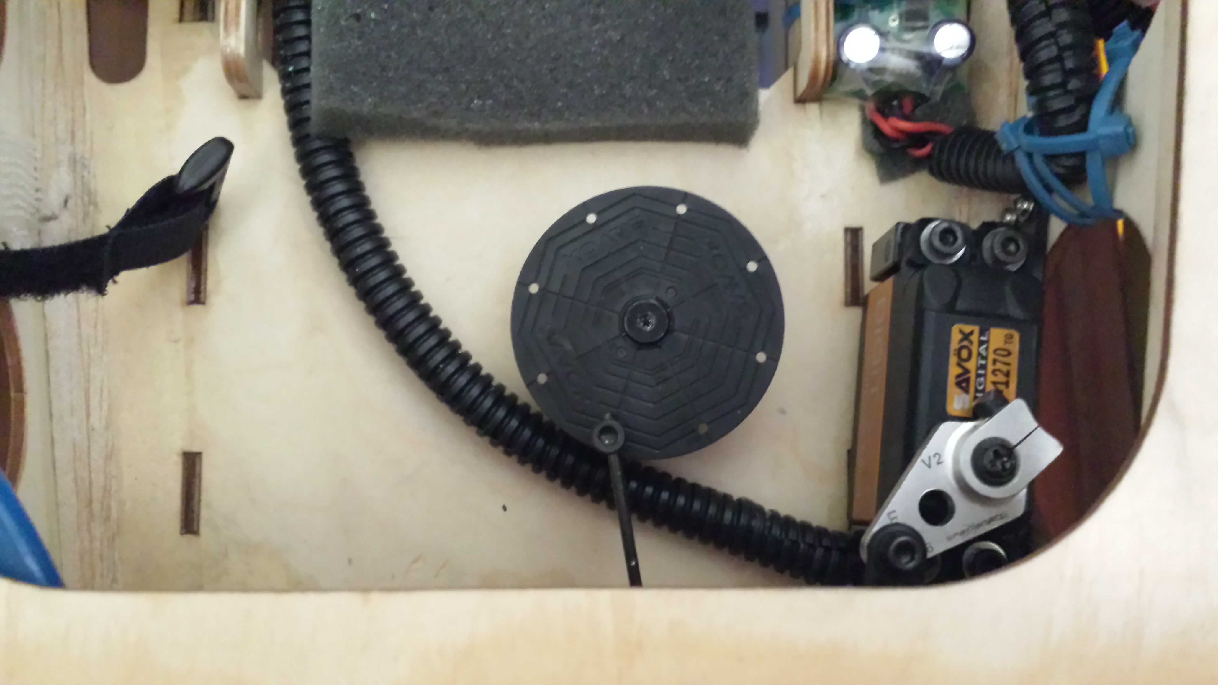

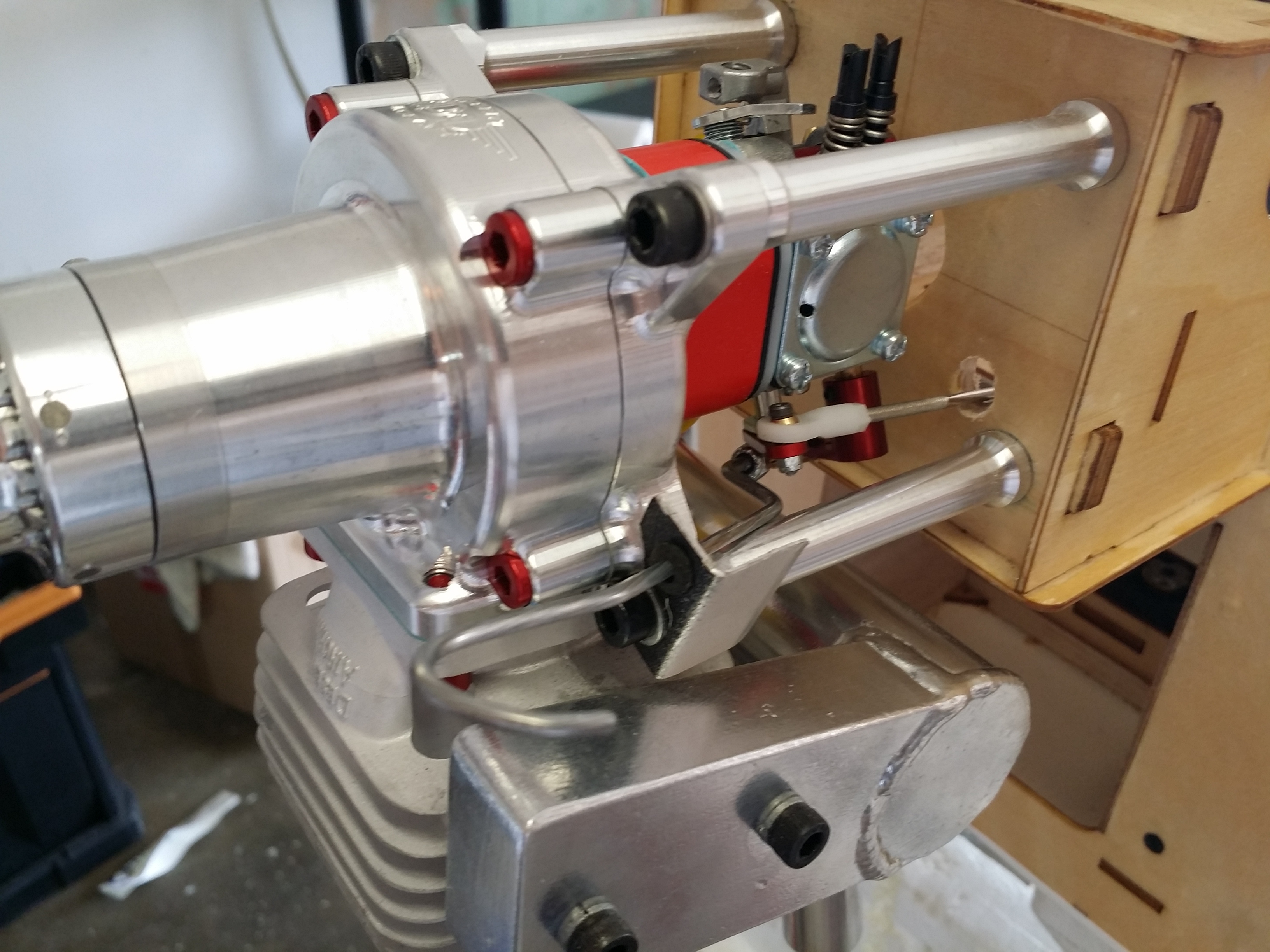

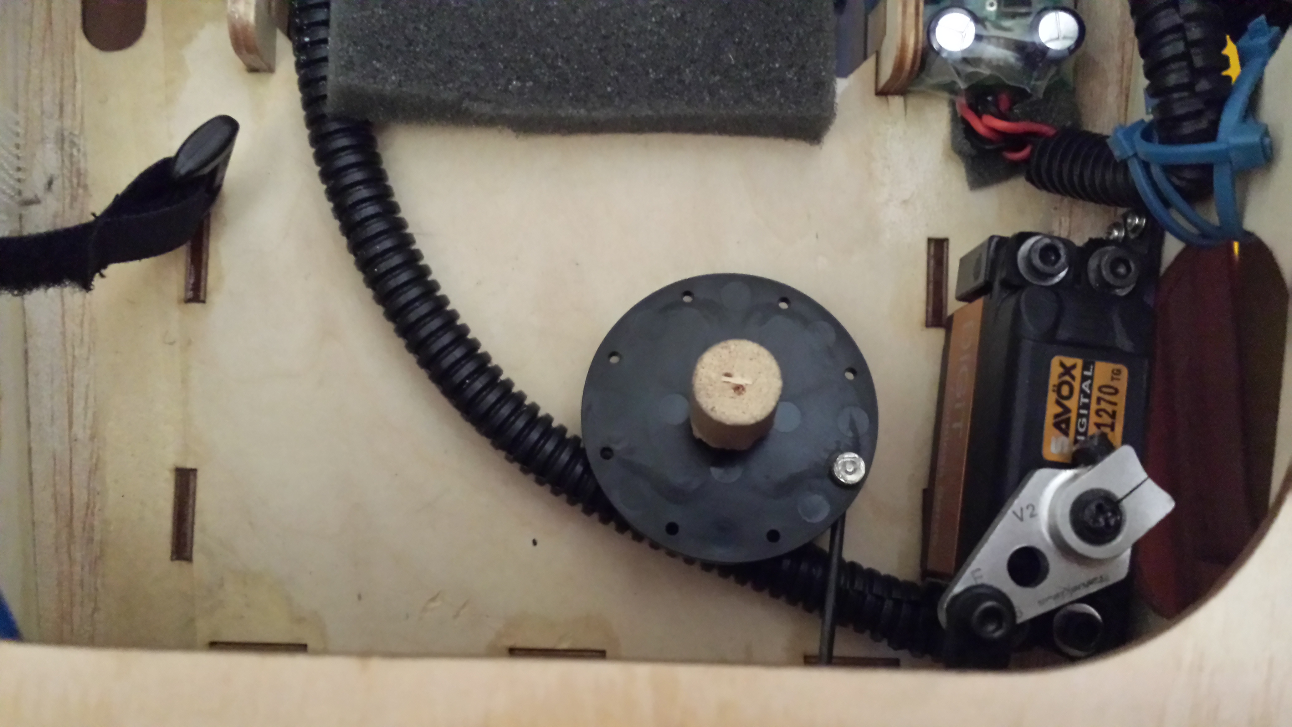

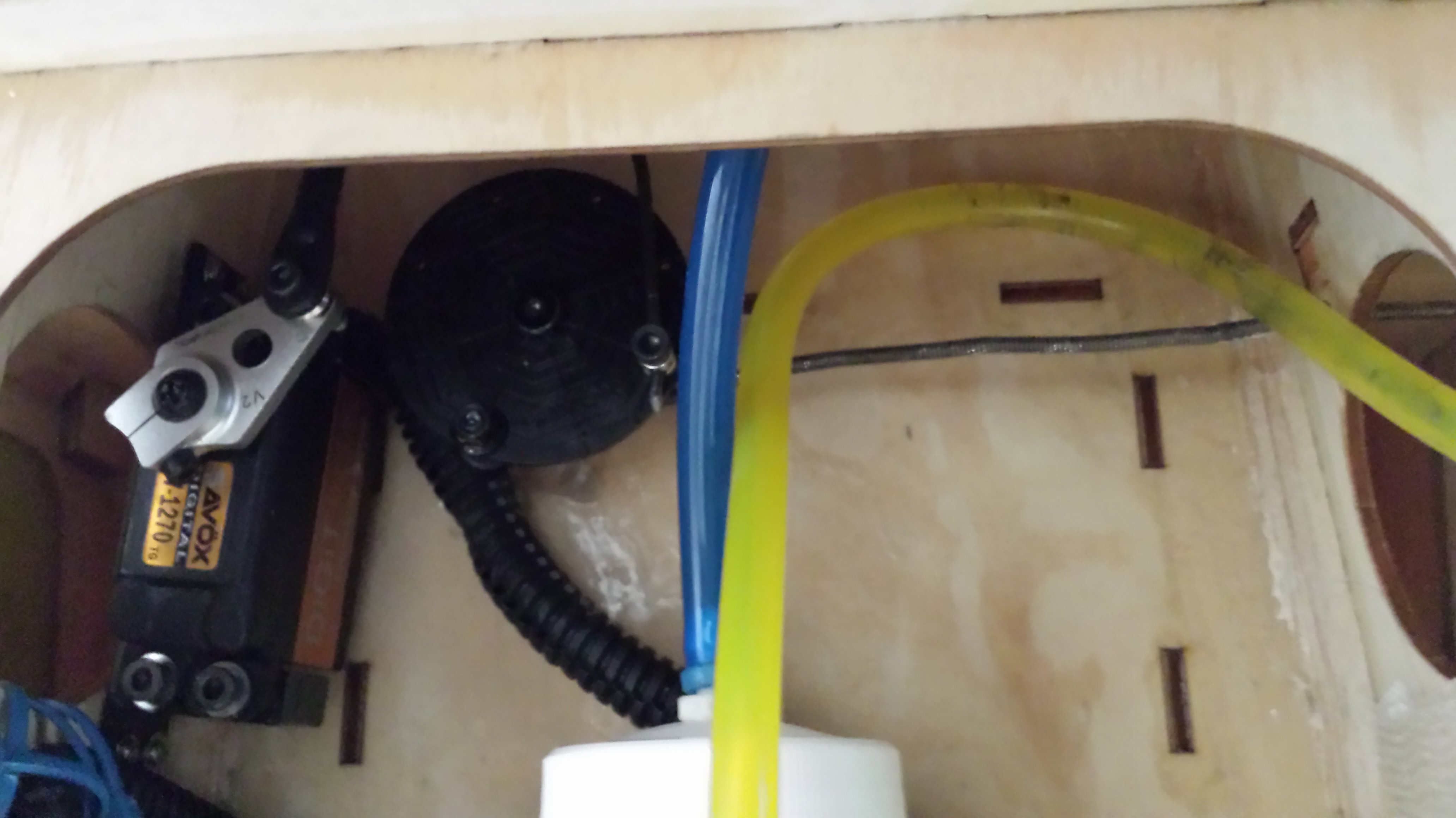

Got my bell crank done. I used the linkage that's provided for the throttle since I made my own linkage out of a cf rod, turnbuckles, and ball links for the use on the throttle. I used one of the round servo arms that came with my savox servos and screwed that to a dowel that I glued to the airframe. I used a threaded rod with a secraft ball link for the rod I grab. I like the secraft link cause it's blue like the airframe is in that area. I pull for choke on and push in for choke off.

I had something similar and my choke almost vibrated shut. I lost about 50% power a few minutes into my flight. Pretty much the only reason I switched to a bell crank. I also must admit that while that way is easier to set up, ease of use goes to the bell crank. No more reaching through the cowl. Just pull and push.
The way you did it is my usual method.
Yours does look very nice though.
Nice job on the servo bell-crank job.
attachment.php
What kind of spacers did you use to secure the Throttle servo. I noticed, its not mounted in the factory provided location.

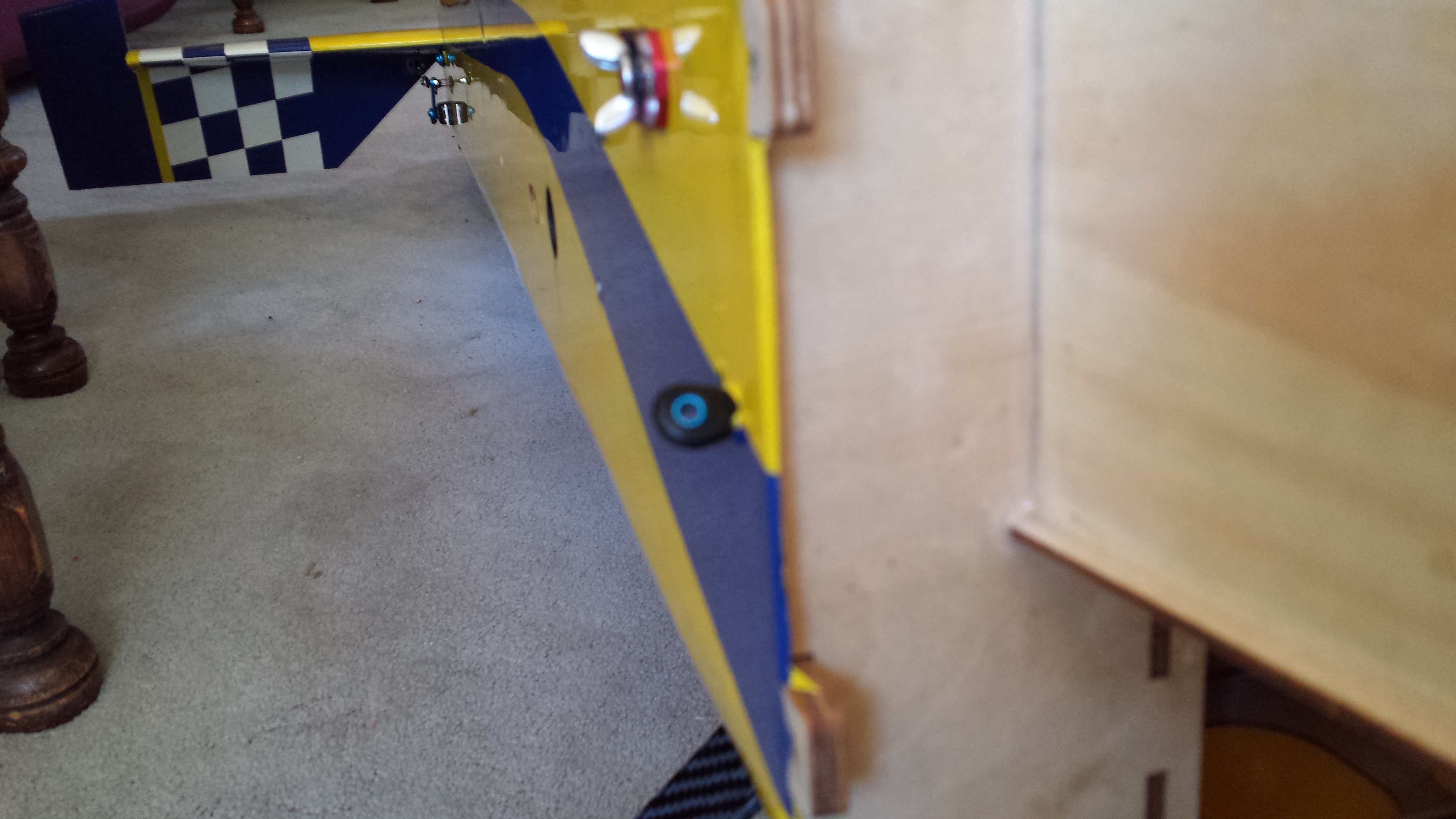

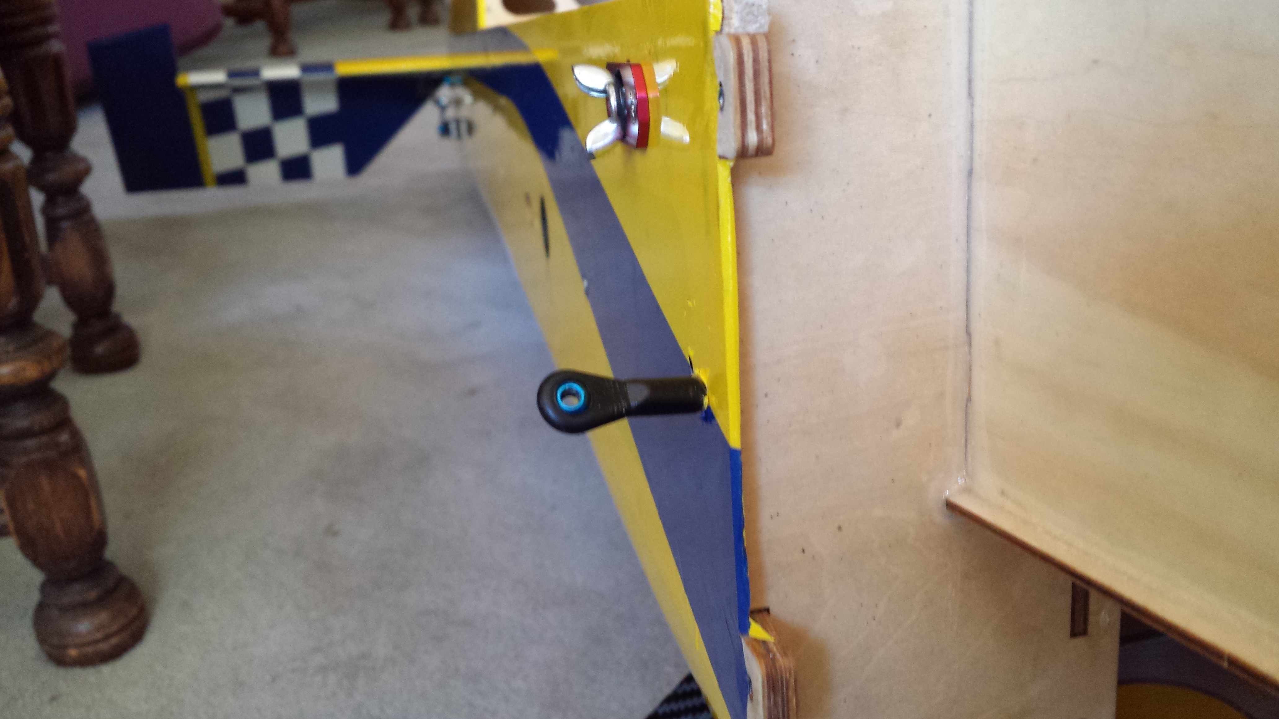

attachment.php
Also whats that wing nut onthe side of the plane.
