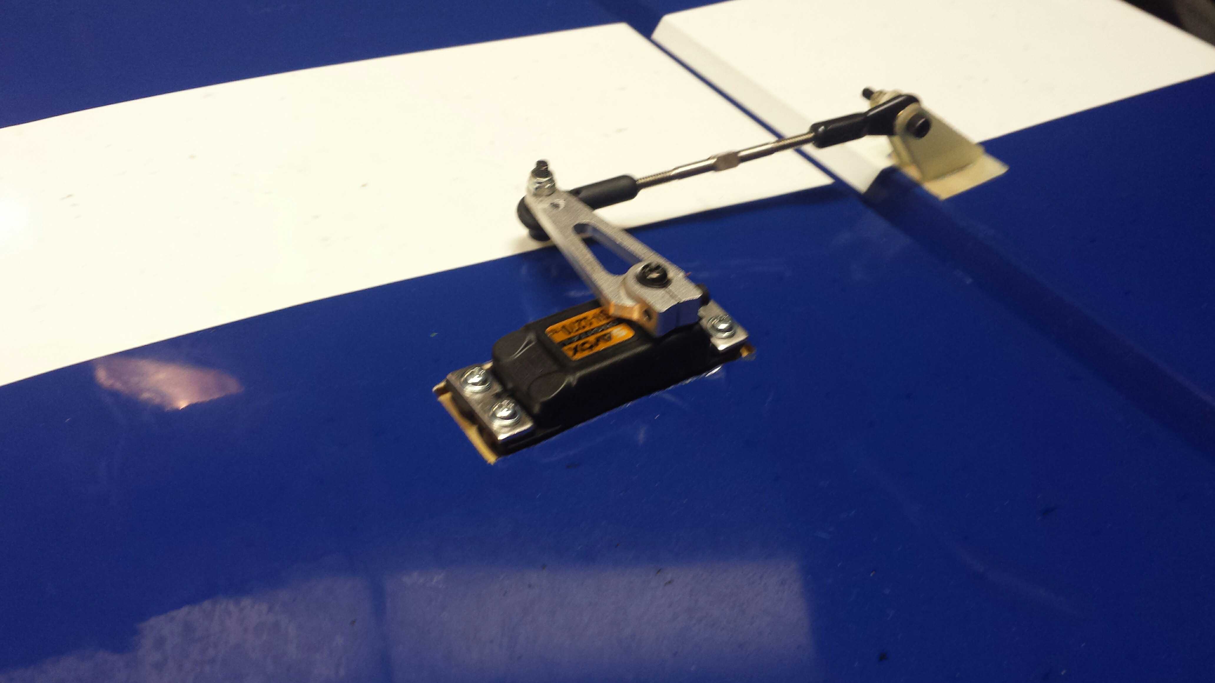

I used them on my MXS too but for their intended purpose of keeping the rubber grommets from getting deformed. Here is a pic of my aileron servo(also using them on my elevator servos). On my Slick I placed them under the grommets for spacing.

I never saw those before Joe, pretty cool. I know you guys are using a DA35 but I love the way my VVRC 40 fit in the MXS. Just reach in the lower air inlet and flip with your finger and the throttle servo is a straight shot from the motor box floor.

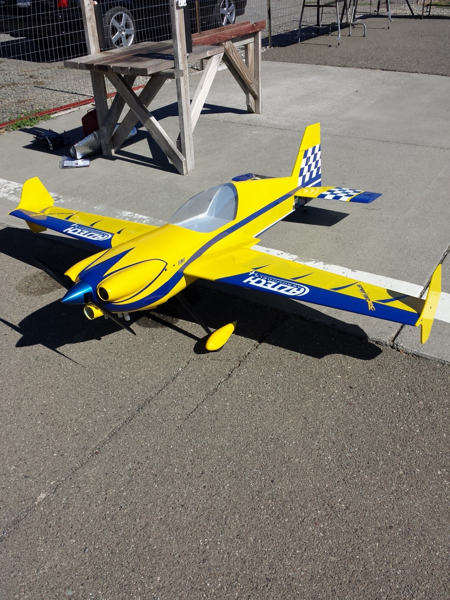

I just got 5 flights today on my MXS and it's flying great. Floats in 3d but does great XA too!
