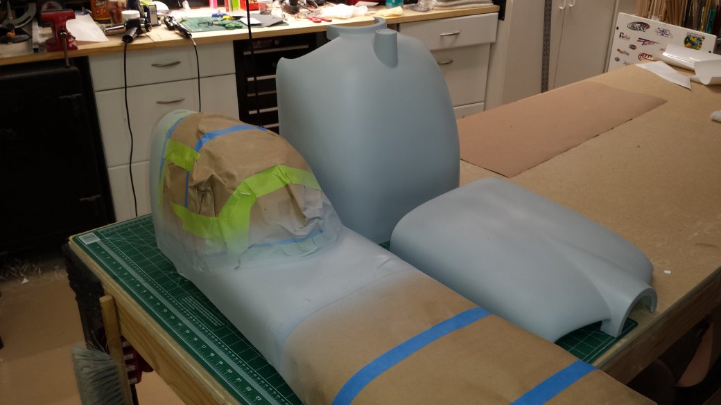

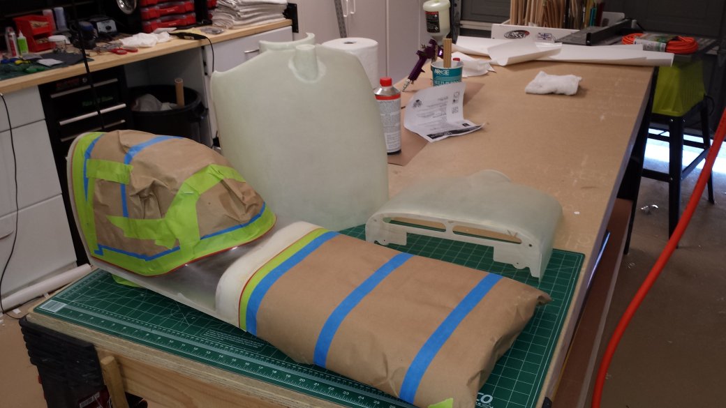

Prepped and primed the first coat on the cowl and canopy today. I started with 180 grit and then 220. I used a wax and grease remover before spraying. I will sand and spot fill tomorrow before spraying one last primer coat. I do not anticipate much need for to much spot putty as the glass work is very good on the cowl. The finish line is near I can feel it.
