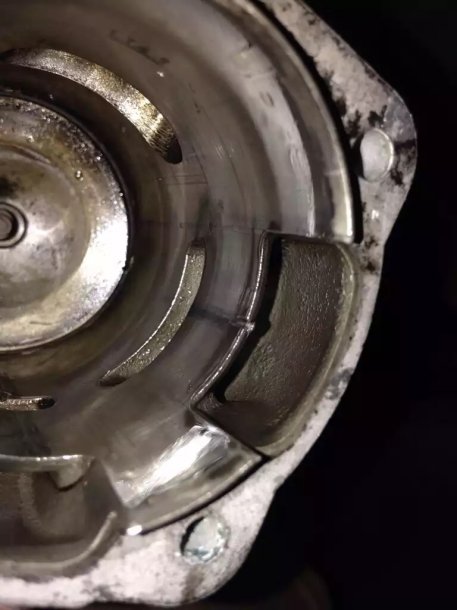

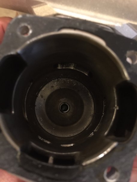

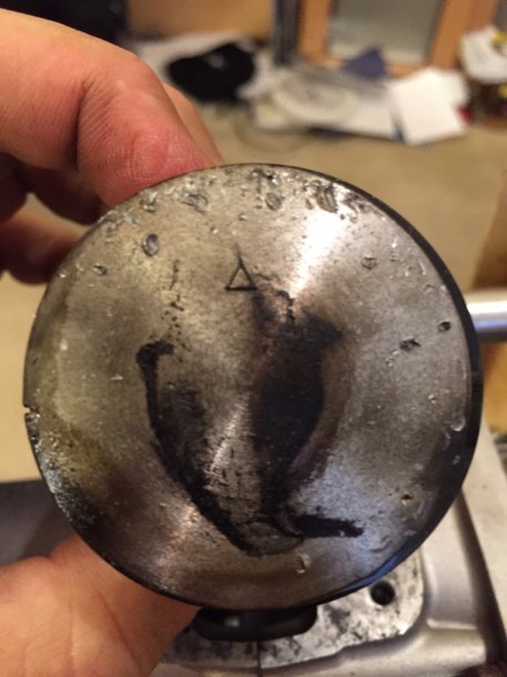

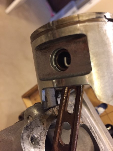

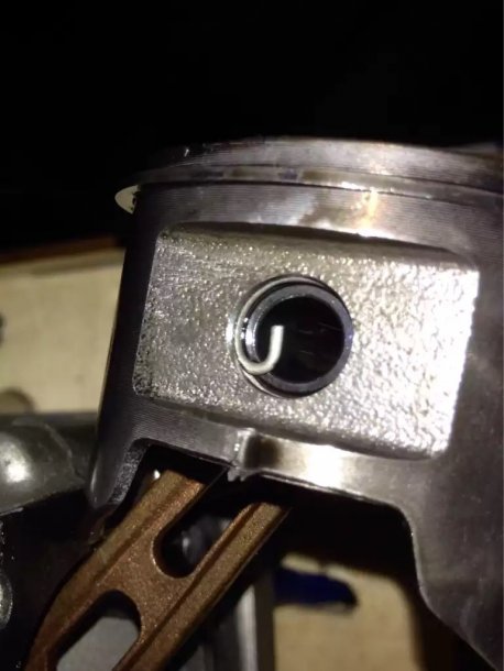

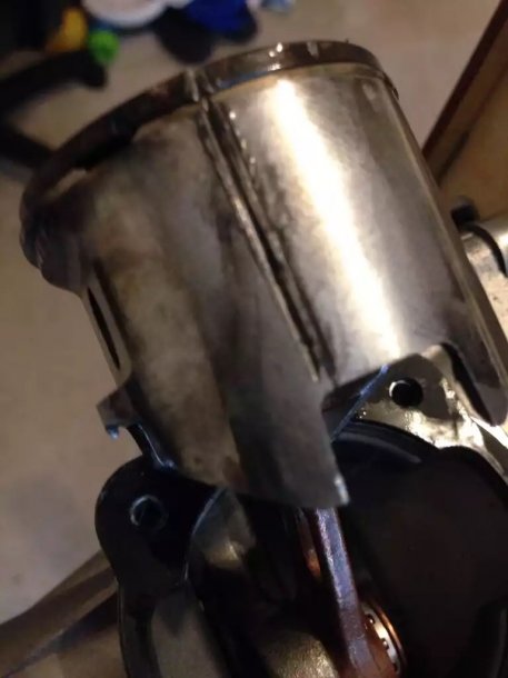

I'm not having good luck with the piston retainer clip on my two GP61's. Just had my SECOND engine crap itself in flight. Both times I had the exact same part failing in flight... Both times in the same way: fouling the cylinder, piston, and ring.
This time:
Last time:
Waiting to hear back from Kole as I bought it from him. He took care of it last time, as It's under warranty of course, and surely he'll warranty this engine too... but I'm still frustrated with my luck. :(
Just heard back from Kole @Limitless Aero.
He's sending me a replacement cylinder, piston, ring, gasket, and redesigned clips. It's all shipping tomorrow. Awesome service as usual... And with the redesign, it shouldn't happen again.
Thanks Kole :)
