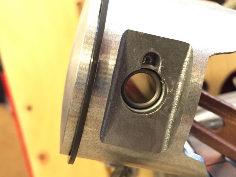

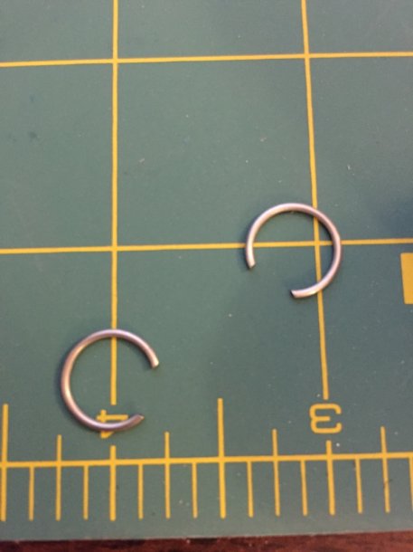

Wow! Did the e-clip break or actually come out of the groove it sits in?
Not that you should have to but I'm sure there is an internal retaining ring that is a drop-in replacement for the e-clips.
The e portion of the clip broke off, both times.
This engine is about 15 months old, and I determined it was the same GP61 that was repaired after this happened the first time. It was NOT my second GP61 purchased this past summer.
I'll post pics of the new style clip when it arrives with the new piston and cylinder
Forgot to post this last week:
New clips installed and running great.
