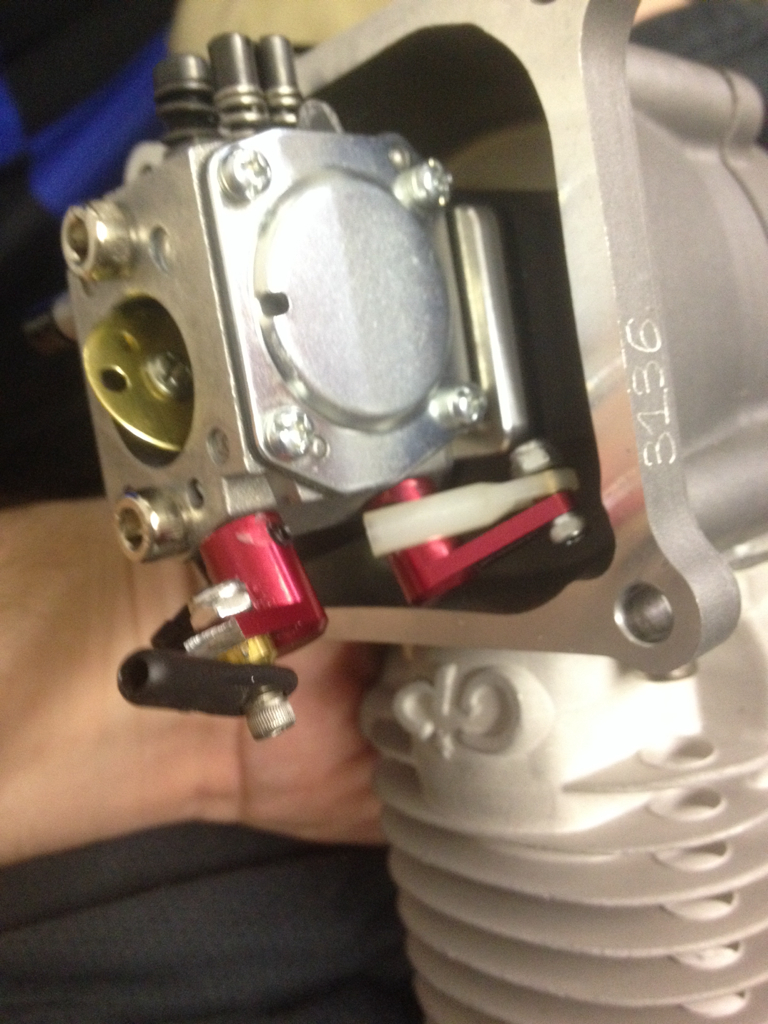

get the 40:1 full synthetic in there and lean her out a tiny bit
ImageUploadedByTapatalk1394592331.042201.jpggot it
