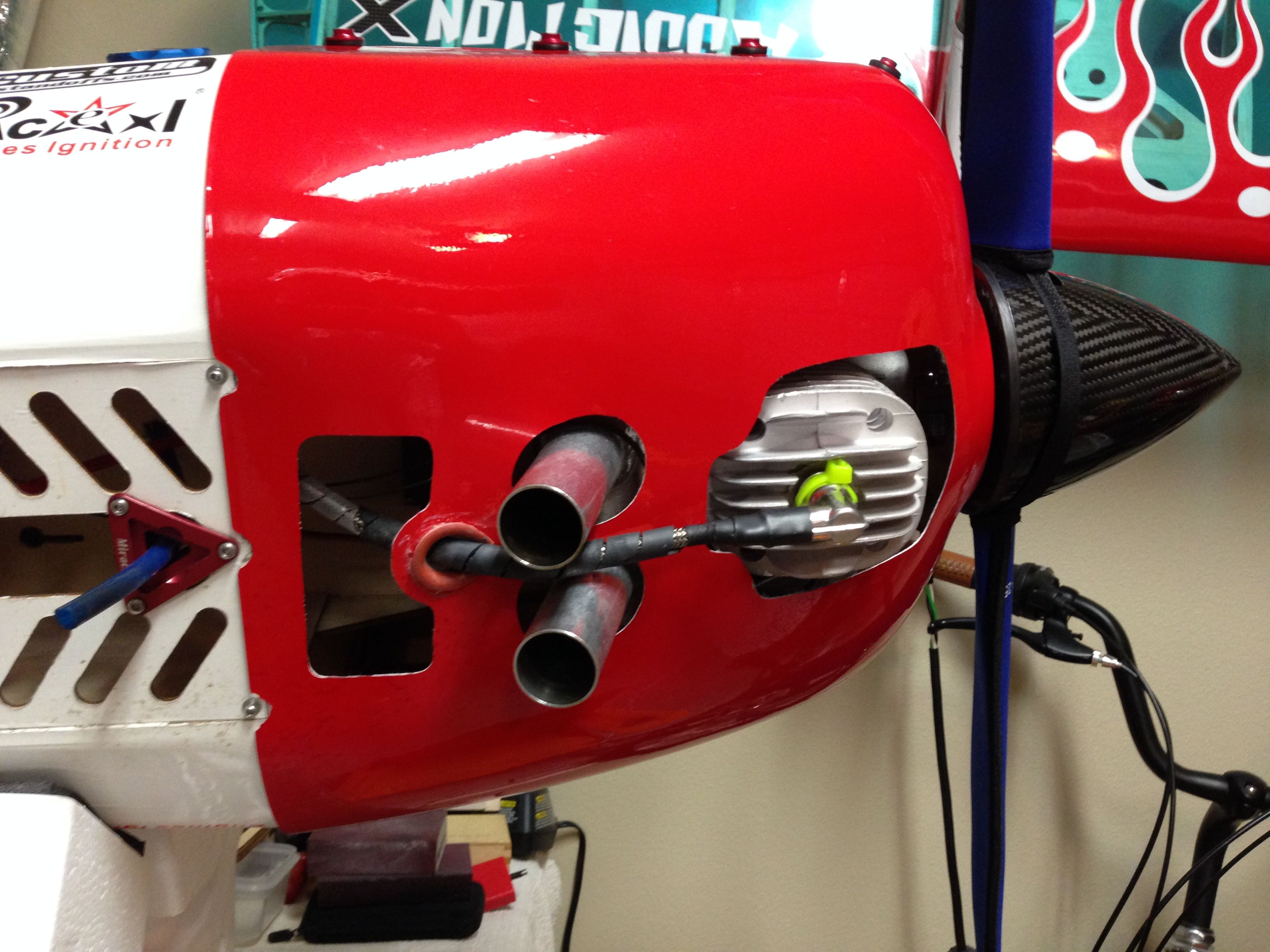

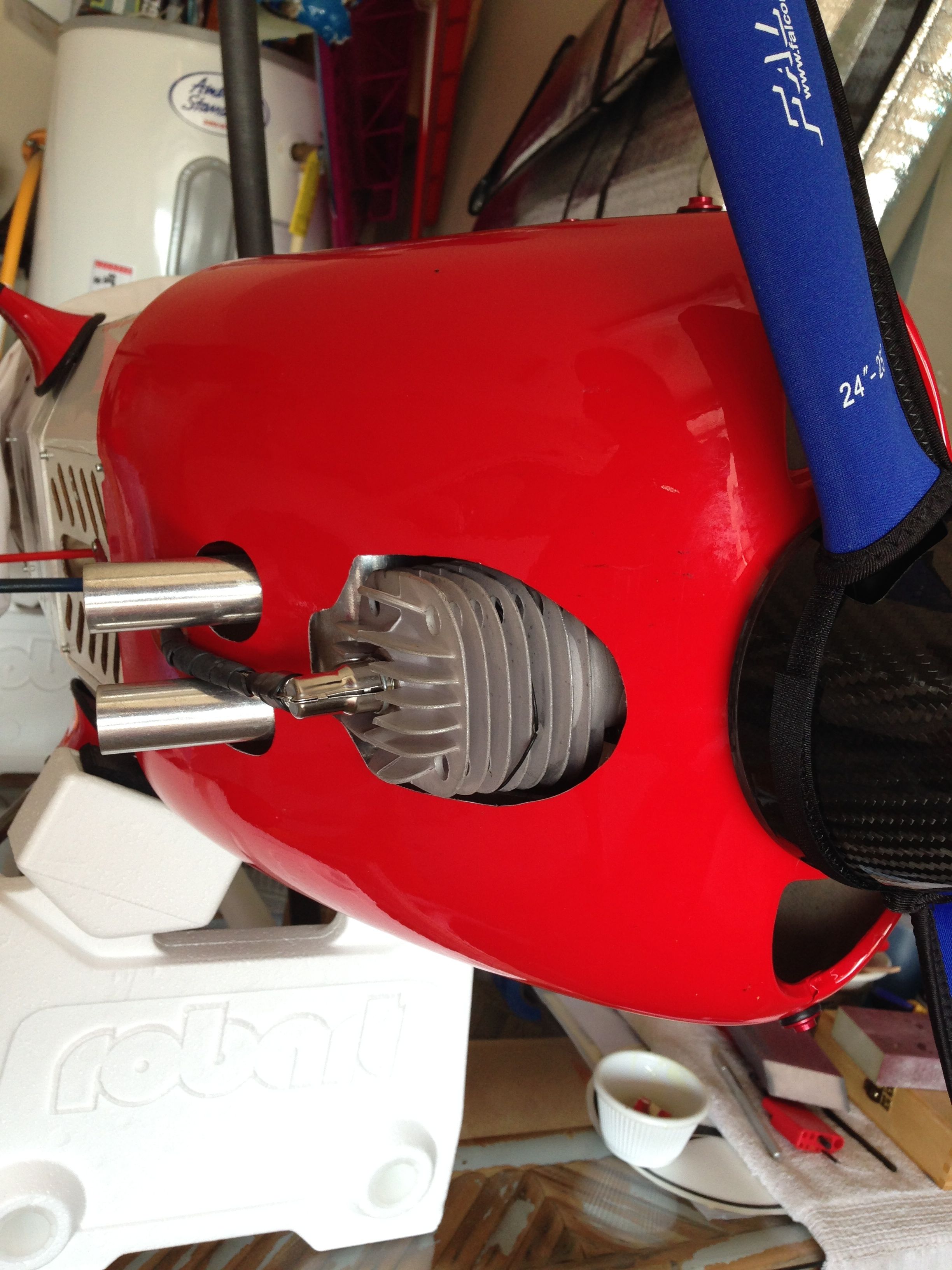

Also wonder if my cowl is too tight on engine as possible cause of temps. Pic attached.

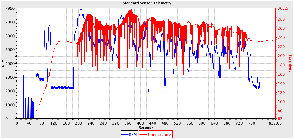

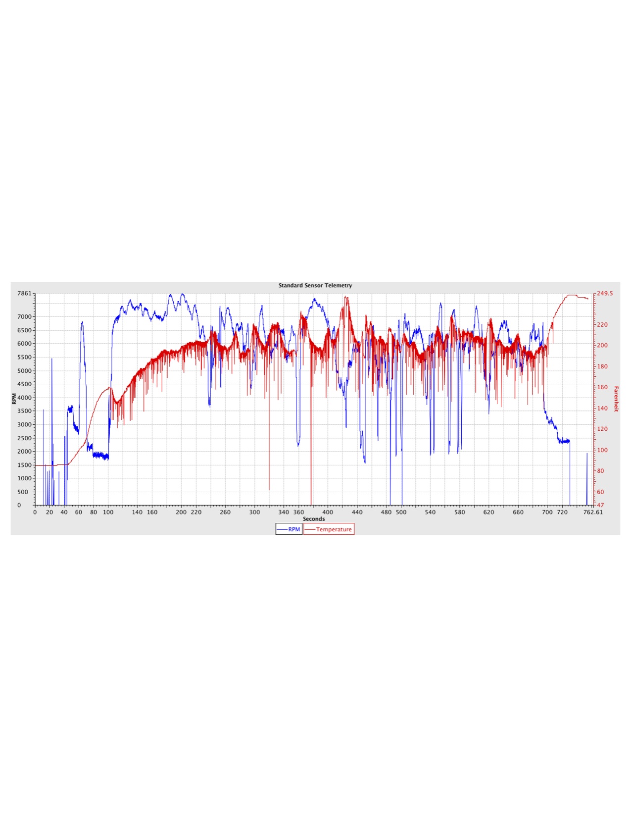

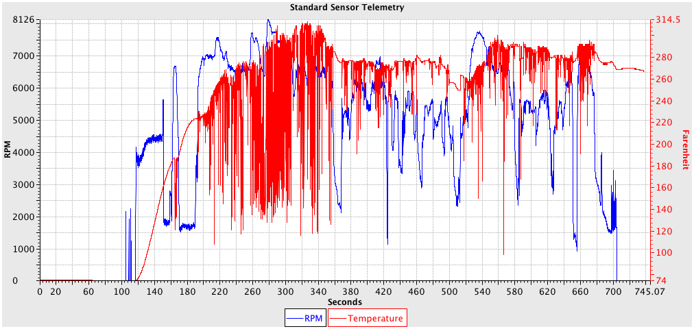

Attached is the telemetry from two of my 6 flights Sunday.
Both 24x9 Falcon, On 4th Gallon, 92 Octane, Redline 40:1, thermocouple at middle fin back of motor
Good Sound File
Max Temp 314F
Avg Temp 254F
Max RPM 8126
Bad Sound File
Max Temp 303F
Avg Temp 246F
Max RPM 7996

two things come to mind from the photos, just some suggestions: you could go up in size of the cutout around the head, is that gap too tight? The other thing is exit area, it looks like there isn't much flowing out the bottom of the cowling besides the tunnel vents - but I see all sorts of types of cutouts on pics of planes. Mine is like this, the third picture down http://www.3dhobbyshop.com/72-Extra-330SC--Red_p_15148.html
Some others look sealed up much more. I can't remember the ideal inlet/outlet ratio right now. 1:3 ? 1:2 ? Plus that is not exactly easy to measure, I'm interested to hear what everyone else does

Thanks for the inputs. 1. I am convinced I need to open up cowl for exiting hot air and will open around the head. It can't hurt.

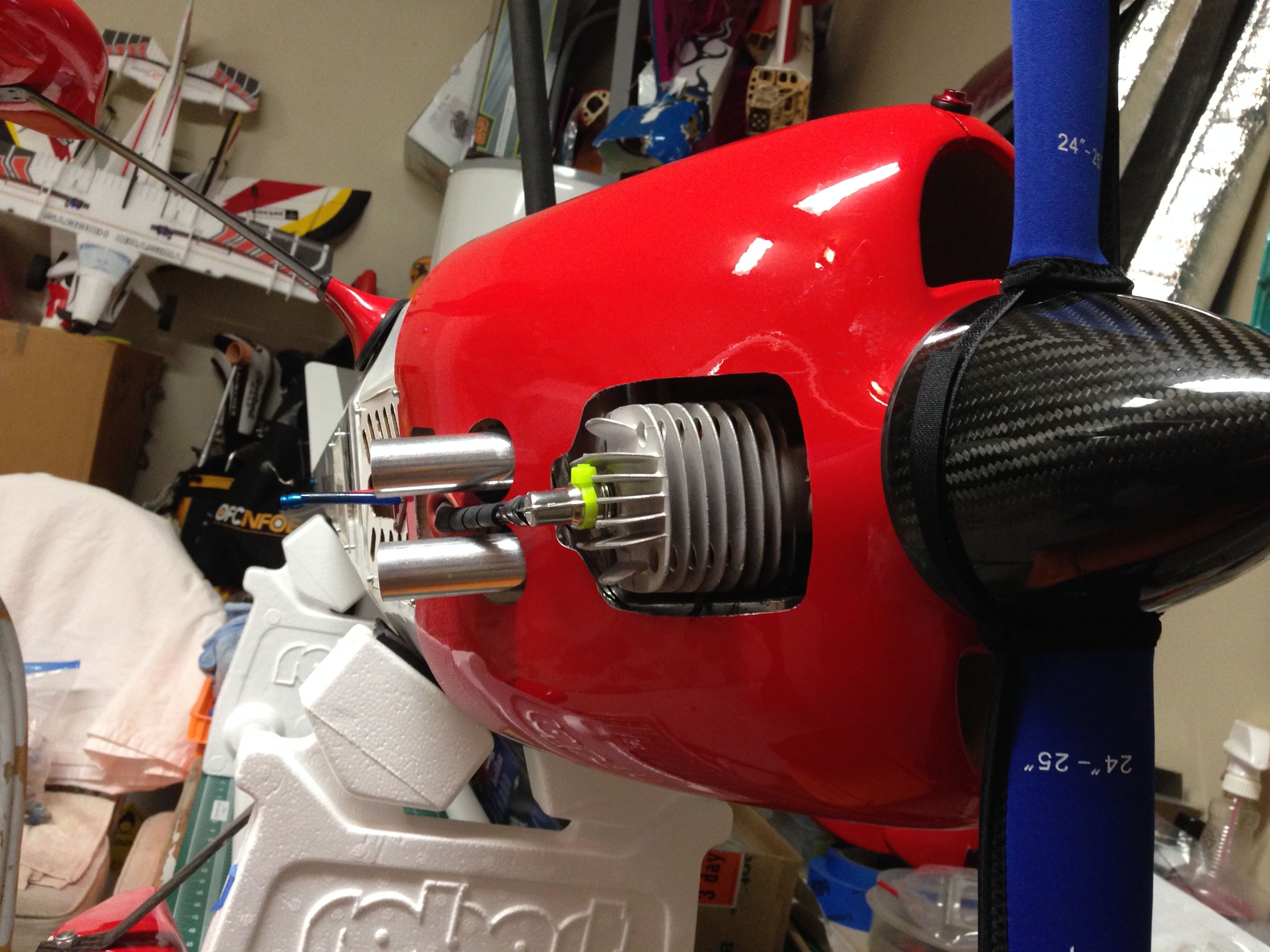

Cooling was confirmed to be my issue and I have the data to prove I did not cut my cowl enough for entry and exiting air. I opened up around the cylinder about a finger width and 3/4 in more on the top of the cylinder opening. I also opened up a new hole behind the two muffler pipes. Not sure which was the best cut, but results show almost 100F reduction in Temps!!! I leaned out the Low needle in the data set attached and had minimal popping a gurgling. When it did it was in the expected 10% throttle range. I am extremely happy with the sound of this power power plant now....
Lesson learned....Air cooled engines need AIR!!!! Gasser Newby mistake to opt for looks over cooling in the cowl cuts. Attached is the before and after. It is amazing how drastic the temps dropped with minimal cuts.
