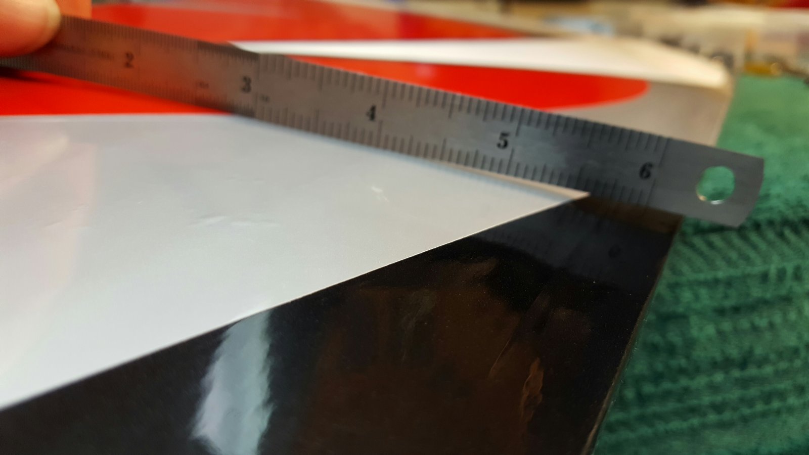

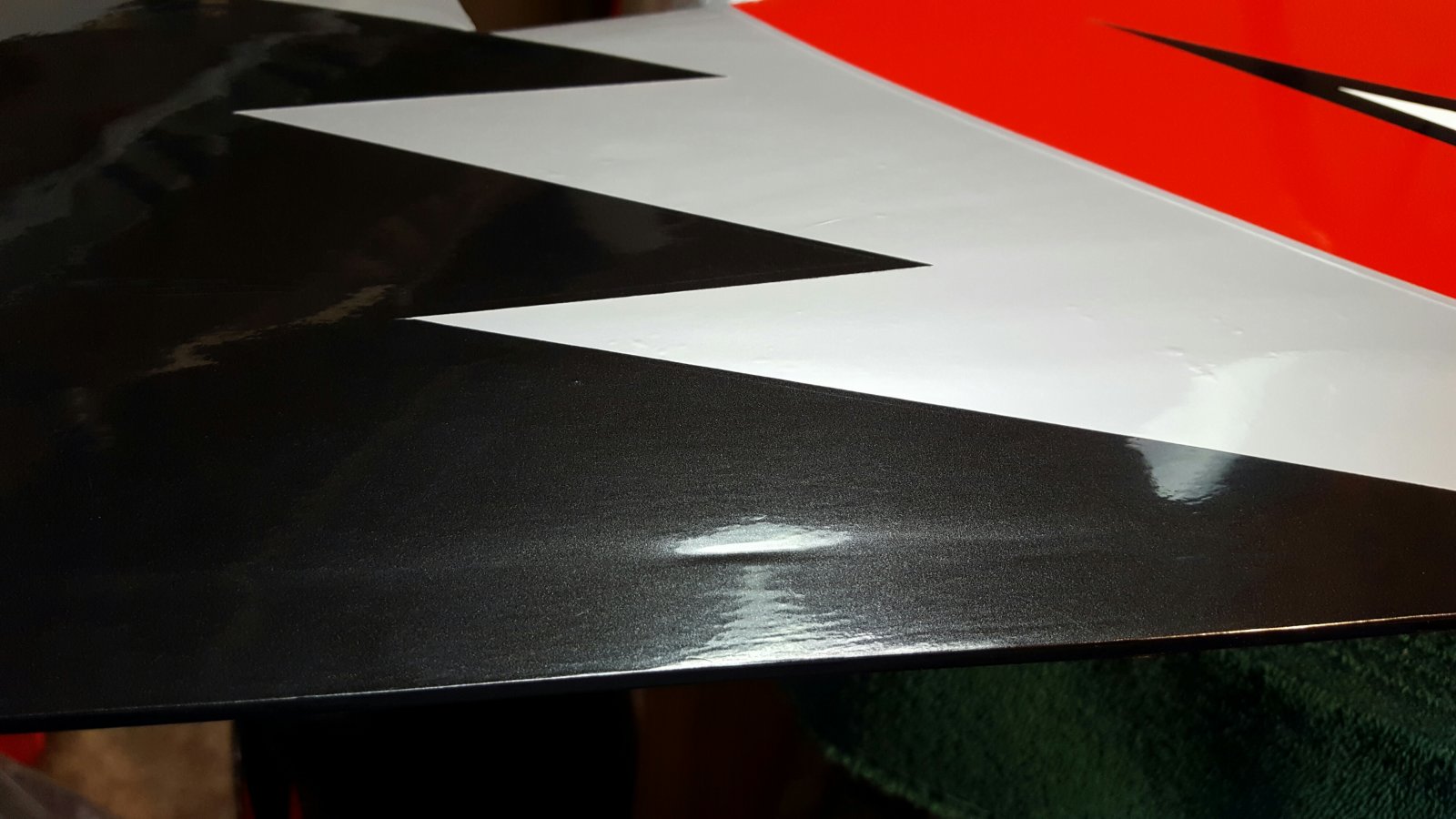

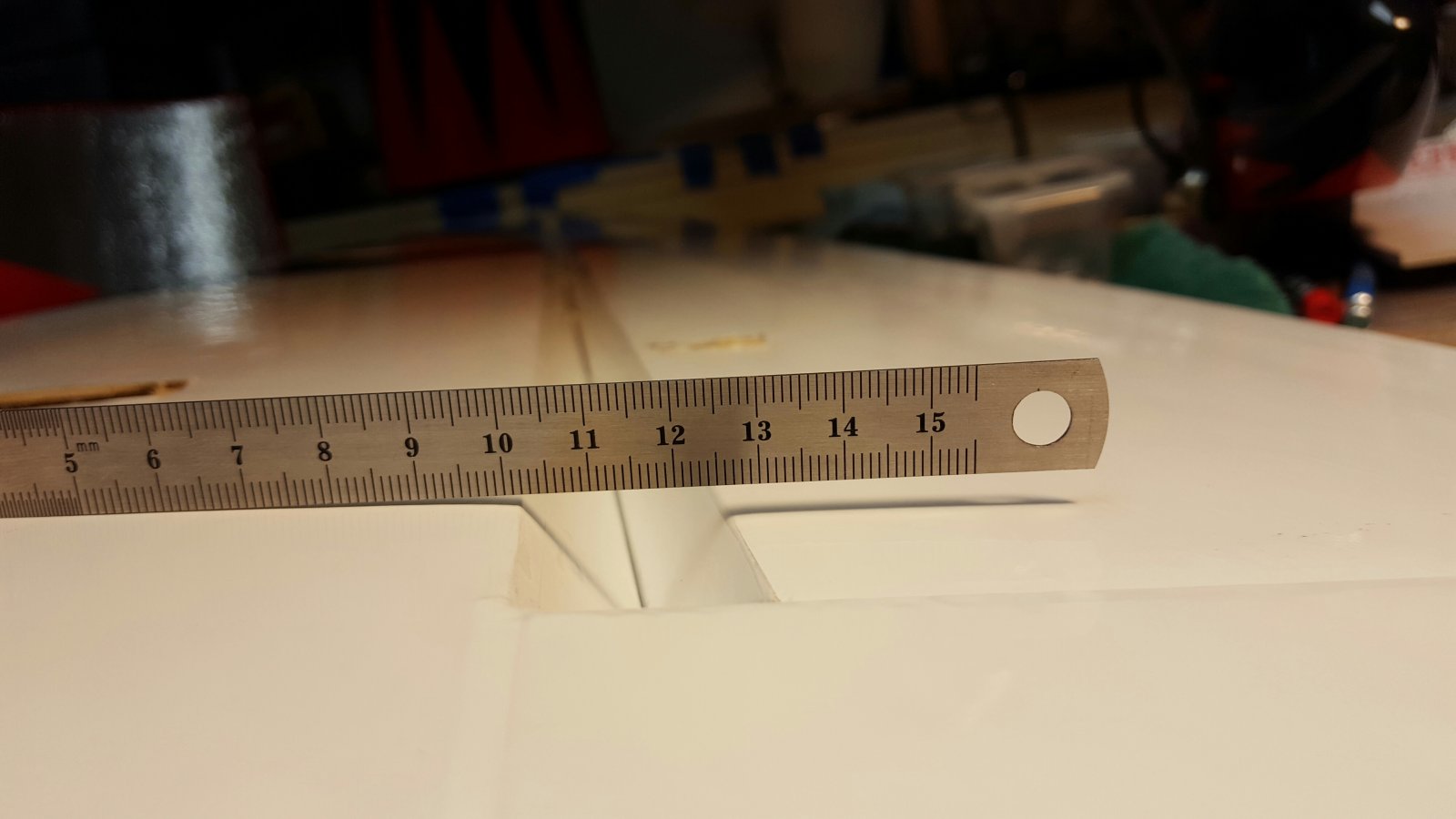

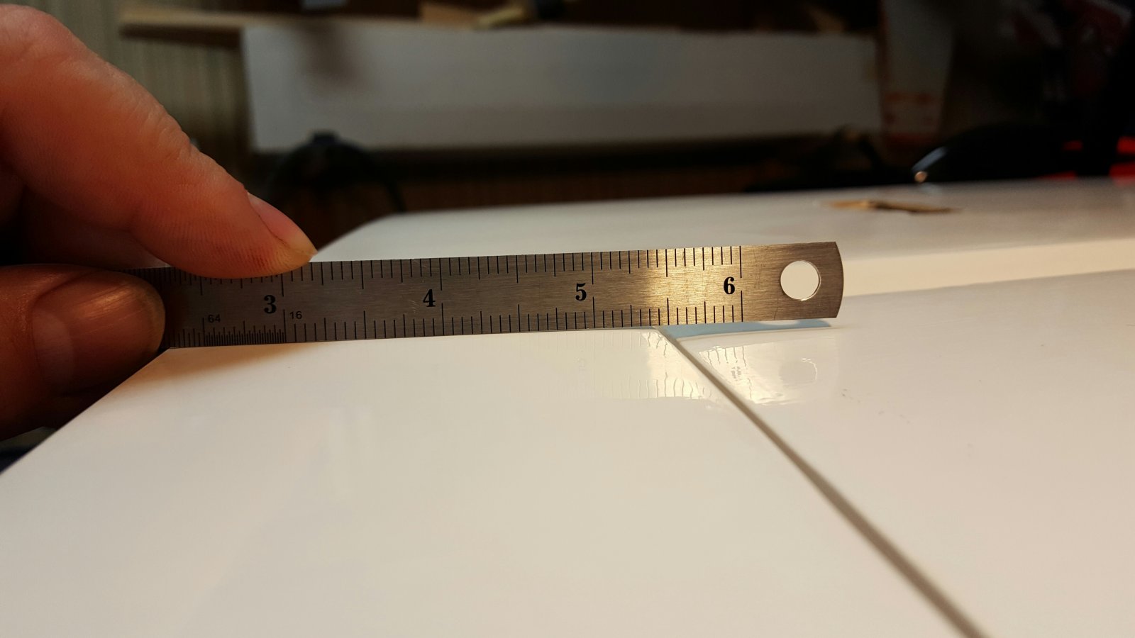

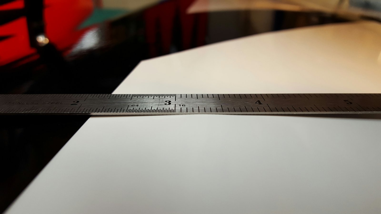

This is the hump in the bottom of the left wing below the wing tube. It doesn't show up very well in photos, but it's very obvious in person. I've had a couple other guys I trust look at it and they all agree with me that it's pretty bad.

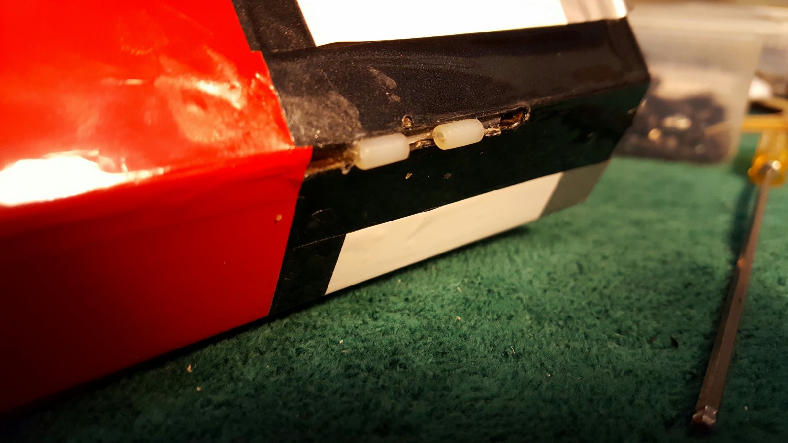

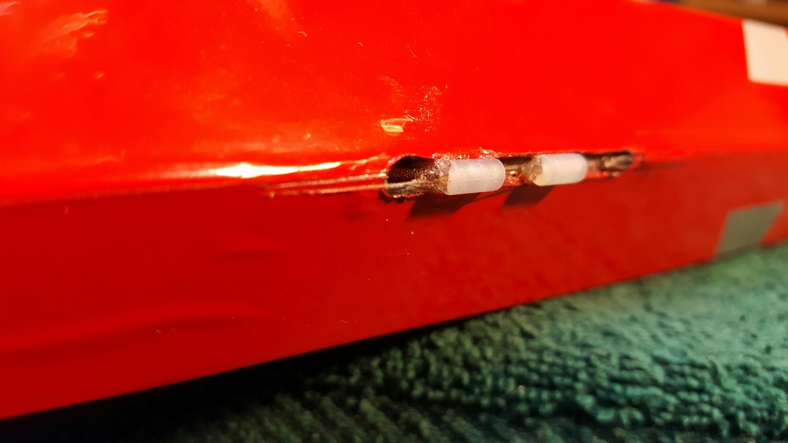

This is the way the aileron fits at the root.

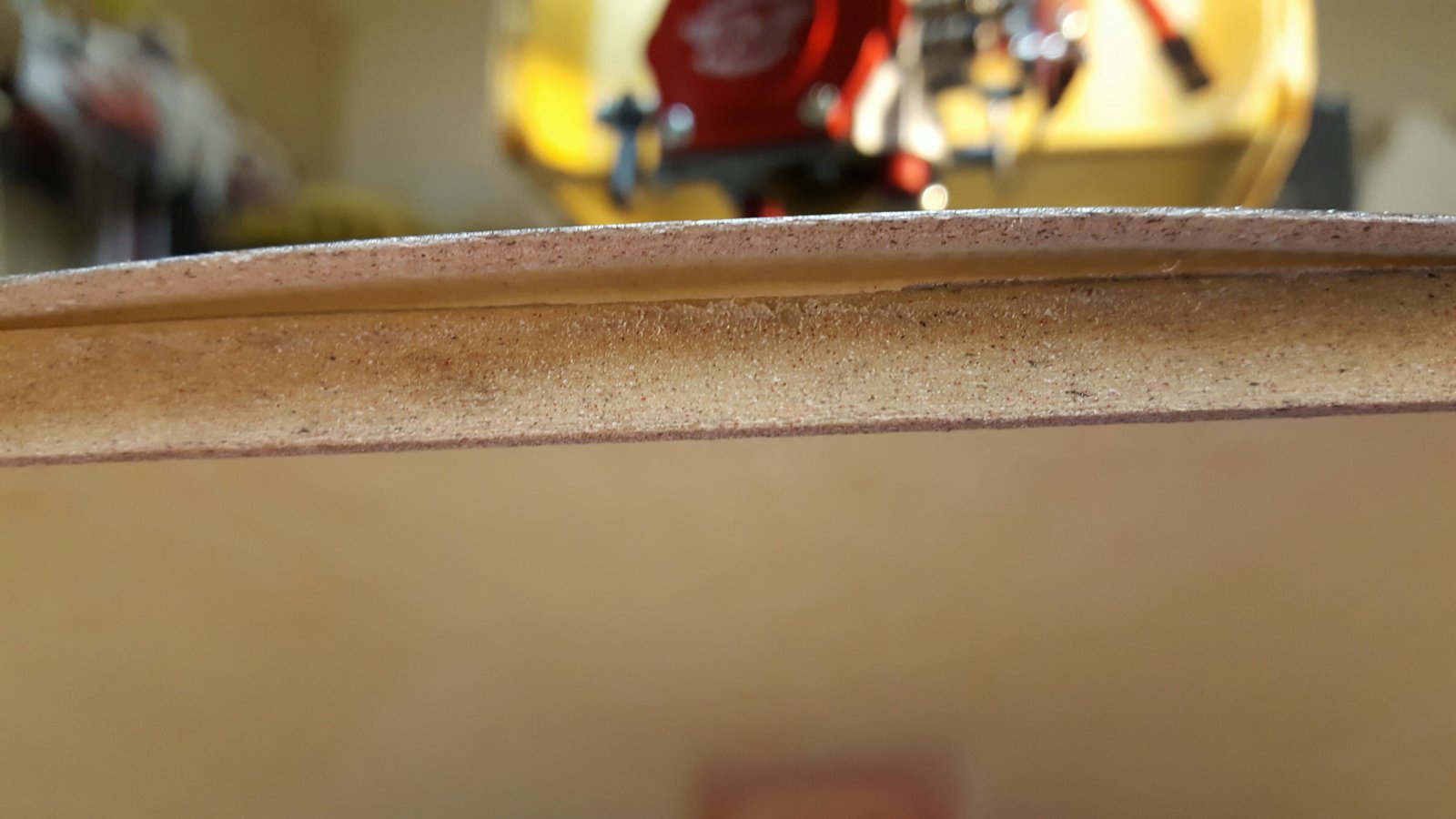

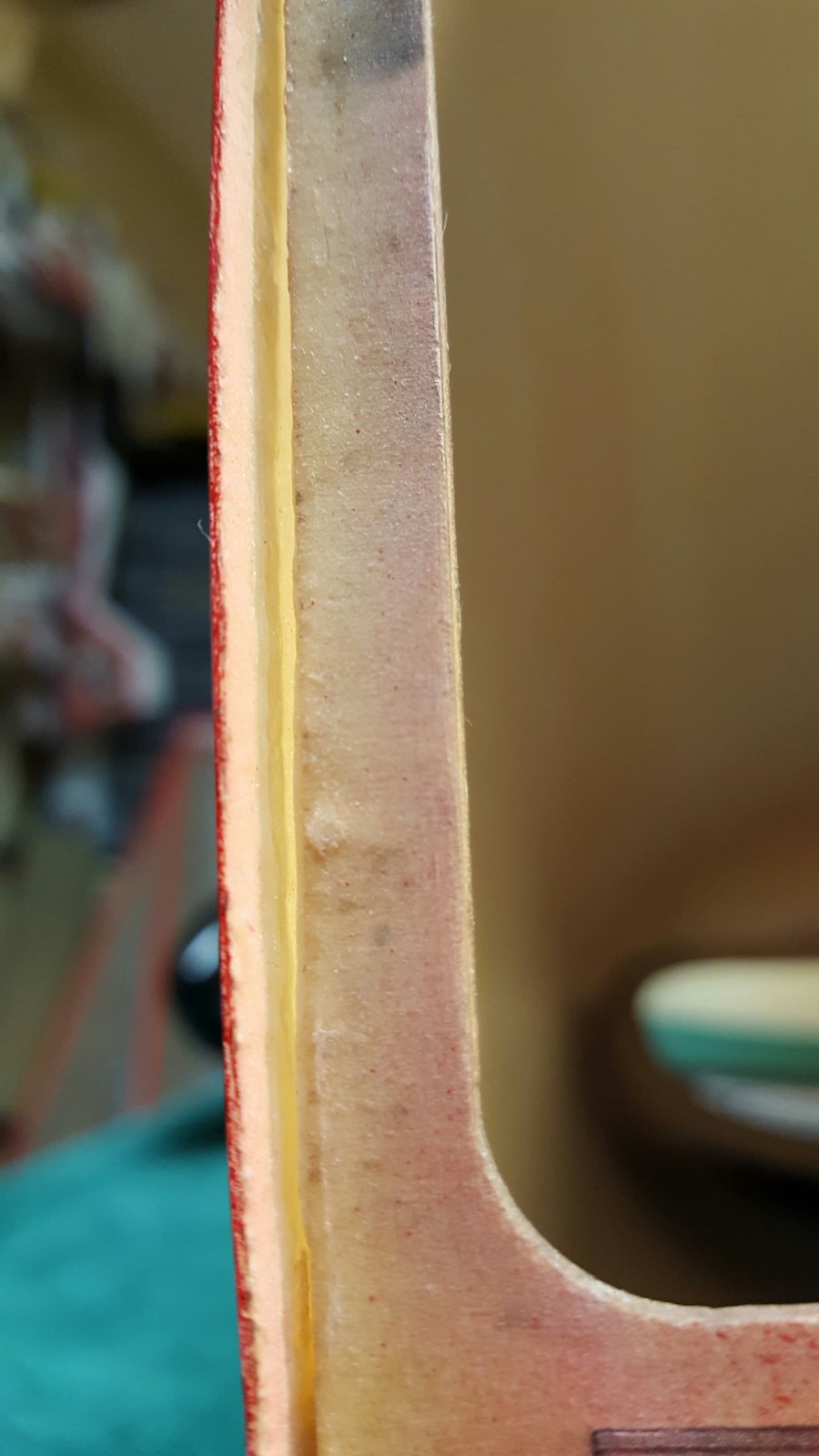

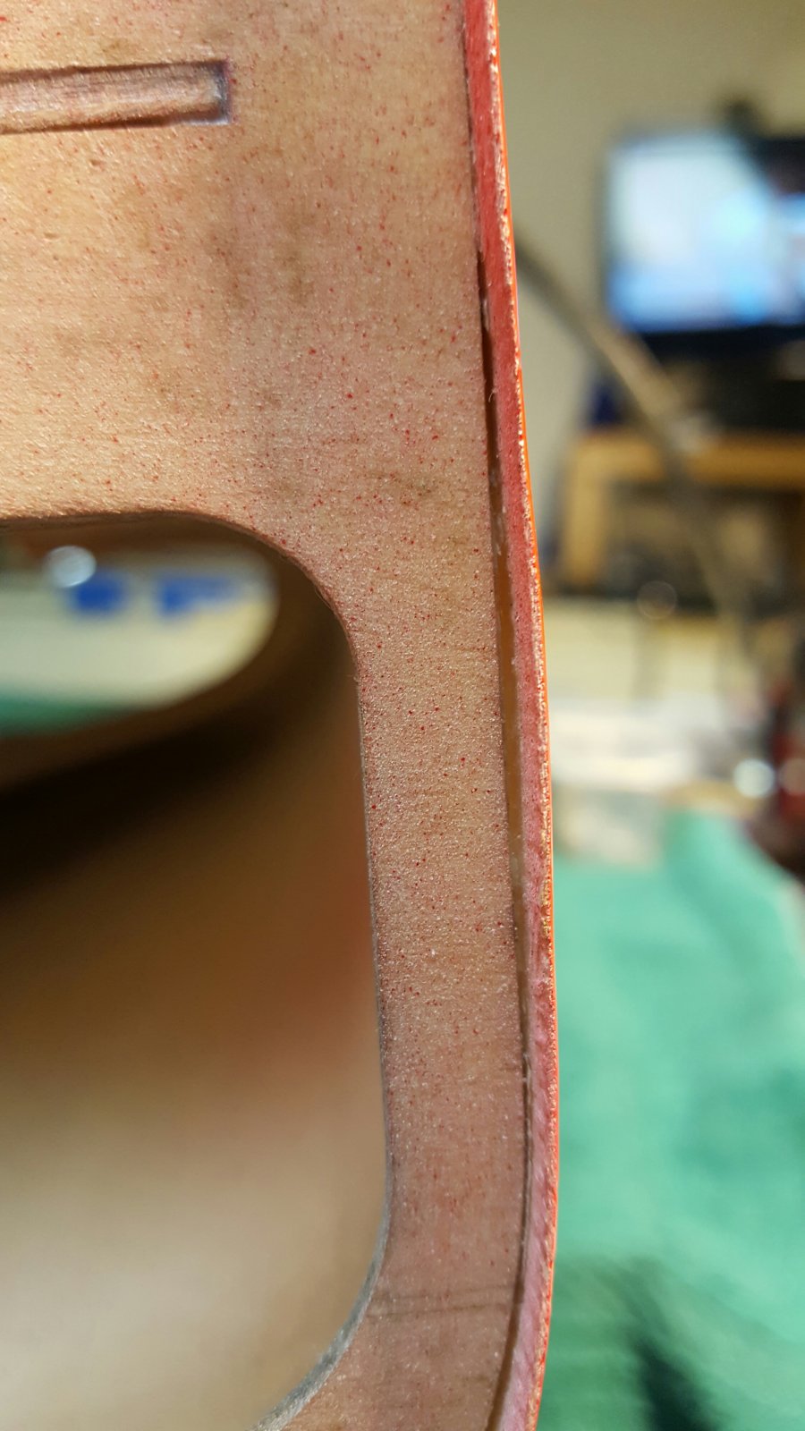

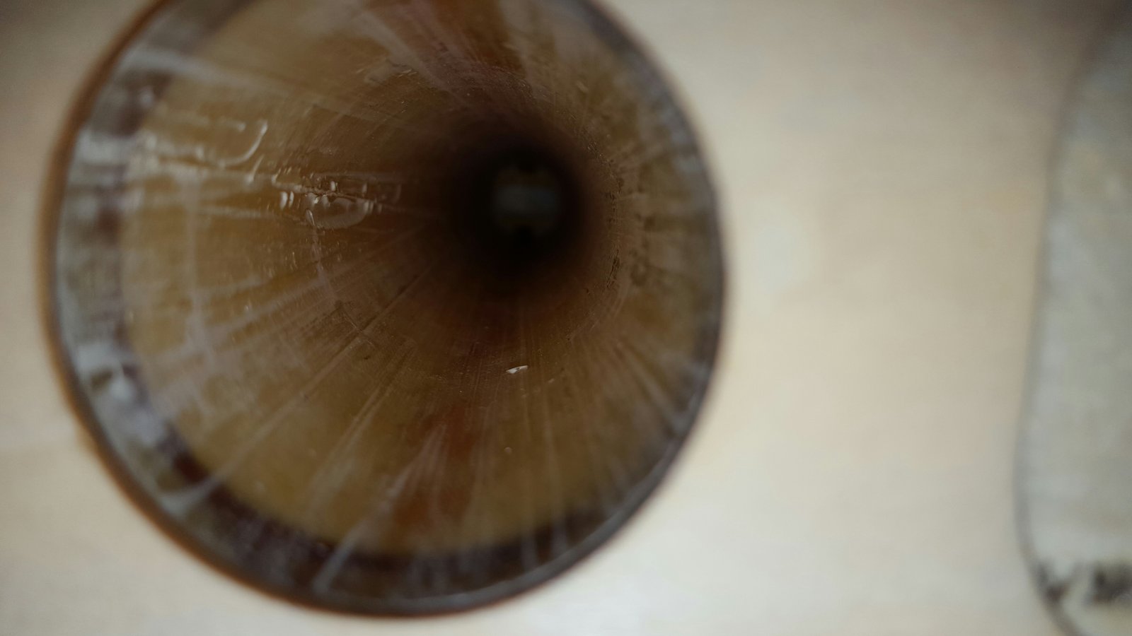

The wing tube socket that has a split in it with glue oozing through.
A better angle of how the aileron fits.

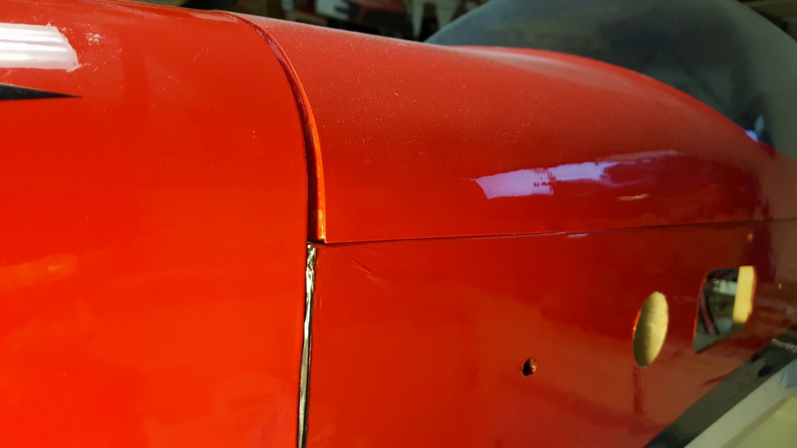

The next few are the cowl ring that isn't glued in most of the way around. An easy fix, but it should be better that this.

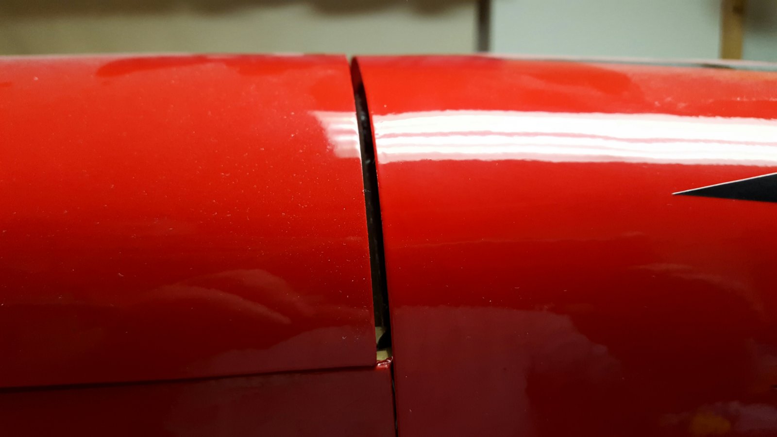

The next two are way the hatch fits the cowl.

Who was the designer of this extra? Just seems crazy that he would say that was within tolerance. With the straight edge on the hump it's pretty obvious to me and the aileron being that far off should have never passed QC.
That gap between the cowl and hatch would drive me nuts. Is it possible to slide the cowl back further to make up the gap???
