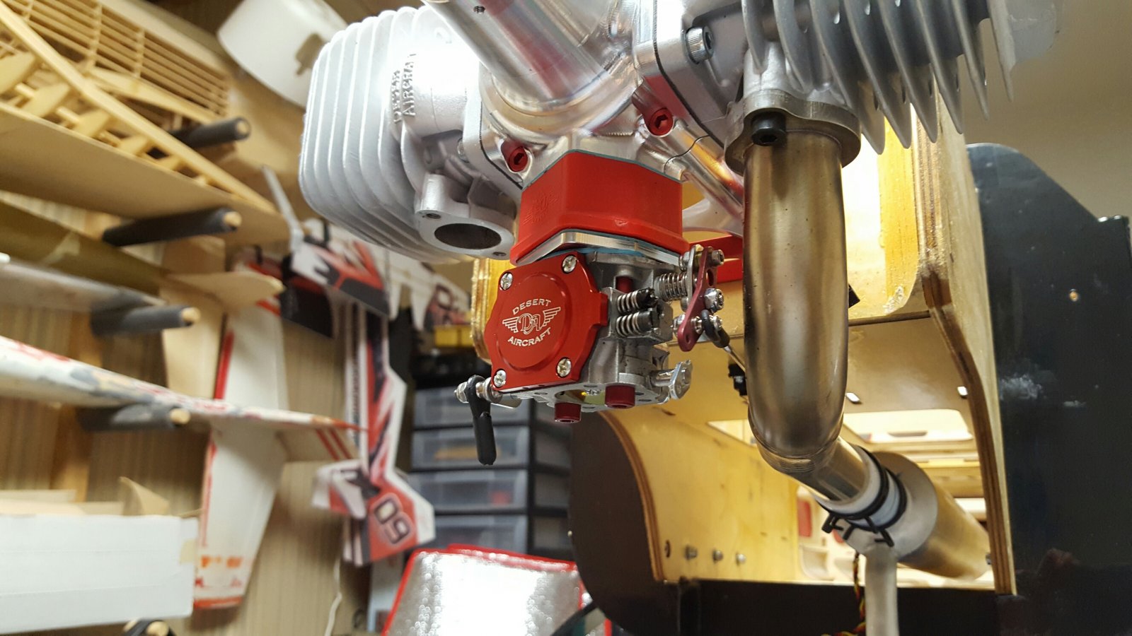

The Extra actually made it into the shop today. I worked on the throttle arm, servo, and linkage. I flipped the stock DA arm over so it pointed down. I stole @Terryscustom s fix for that using a ball link spacer. I also did something similar so I could put the choke rod on the opposite side for clearance.

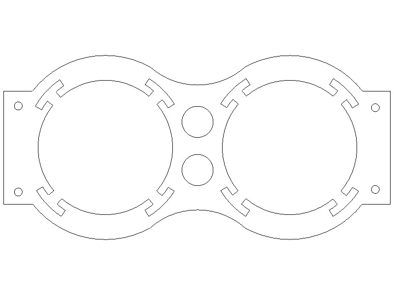

Tonight I spent some time designing a canister mount. The ones that came with it won't really work, so I'm going to make my own. I've got some .078 aluminum that I used to make the canister mount in my Pilot Edge and it's worked for over 3 years, so I might as well.
