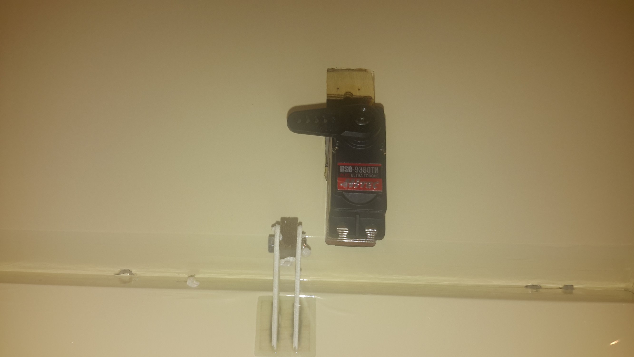

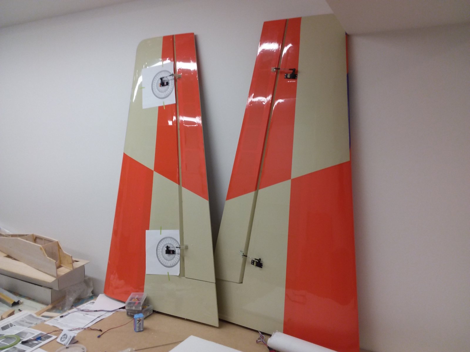

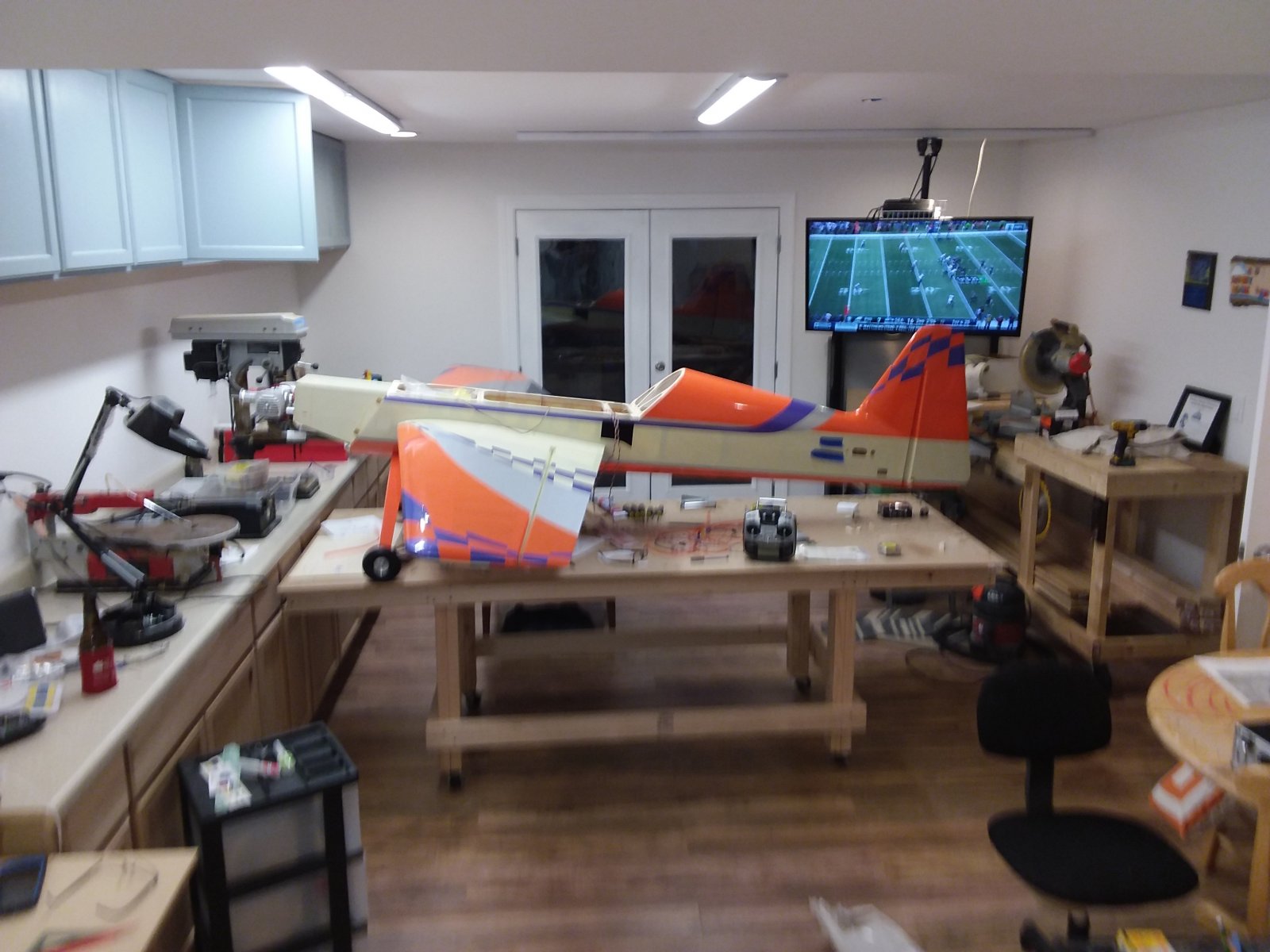

Wings are on and I did a little testing of the ailerons. I like the Hitec 9380's, probably stronger than I am and dead quiet. Not 1 single squeal, unlike the MKS 777's I have in my Yak.
