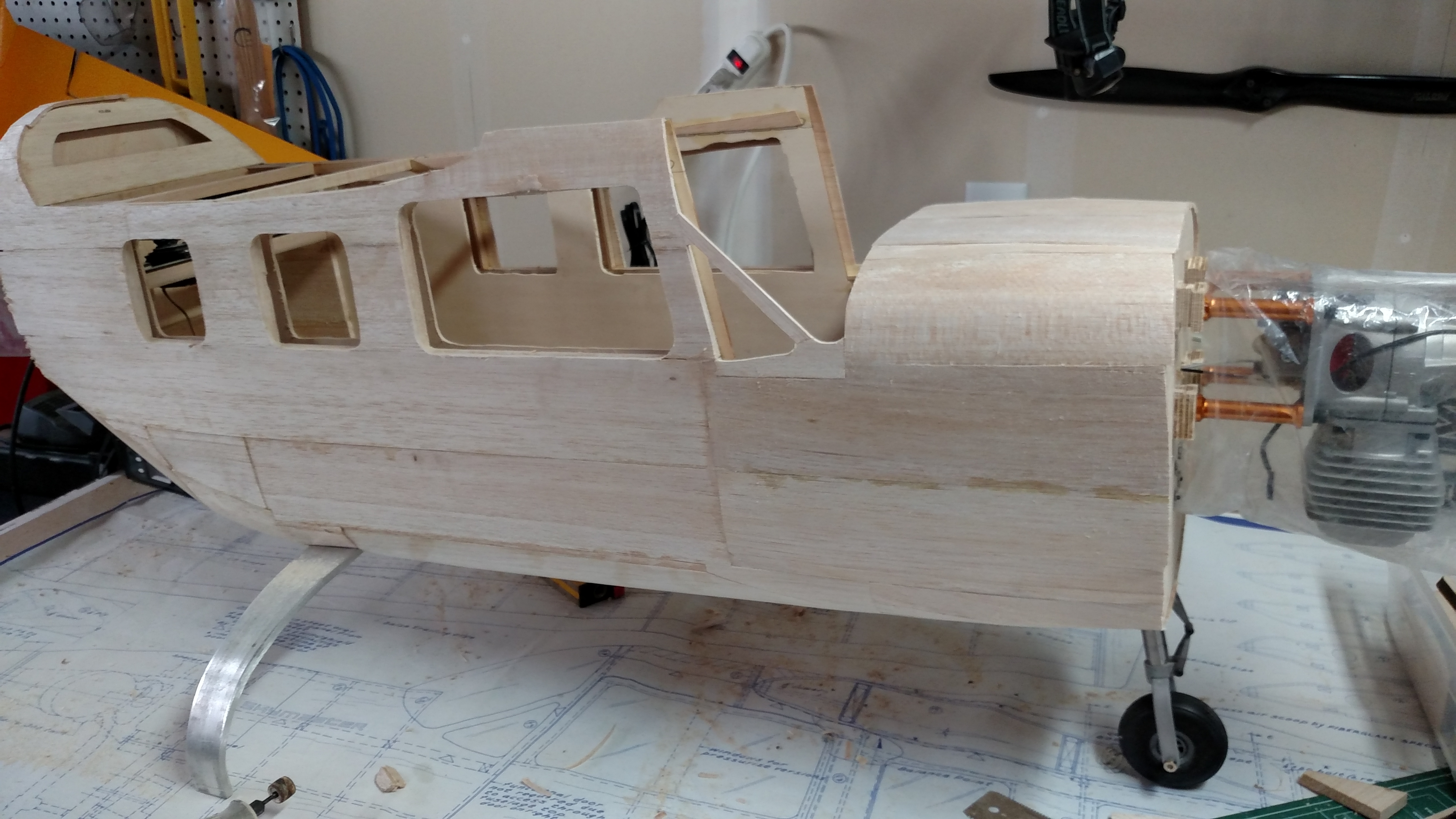

This weekend I found a little time, so I installed the front throttle and choke servos in addition to the new engine standoffs.
I then went to work with the sanding drum and shaped out the windows a bit. Why I was putting that off, I don't know, but having them shaped really improves what I have to look at as this project progresses. I cut out the windshield side pieces and glued them into place. Another thing I was wondering how I would do, but it was easy. Being a first-time plan builder, everything seems like such a challenge until I try it out and it gets done.

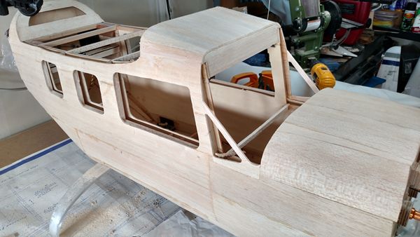

I also finished with the rest of the sheeting on the fuselage. I had left a portion of the nose unfinished so that I could see better what was happening with the linkages for the front engine. With all of that working and the nosewheel control installed, I figured I may as well close it up.
I'm pondering cutting out a door. It seems like it would allow me better access to the inside after I finish the top of the fuse. It also seems like it would be a HUGE amount of work, but really all it would entail would be making a template from the plans, transferring it to the plane, cutting it out, and then eventually installing some hinges and a latch... I'll probably end up doing it at some point in the near future.
For now, here is where I'm at. Both of the engines are installed and linkages hooked up. Programming in the new 18sz is different than I'm used to, but I'm learning new things all the time. Lots of sanding and smoothing to be done to make it ready for glassing, but it's coming along.
