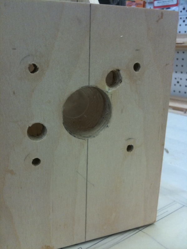

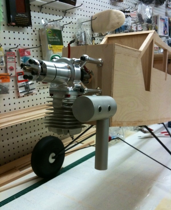

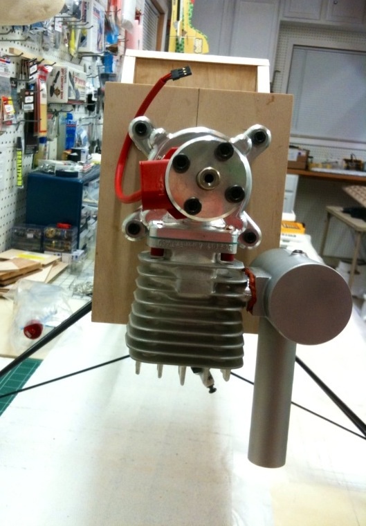

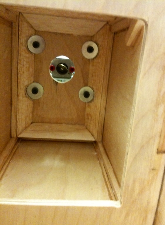

Good to see you making progress. Once they hit their feet, it seems like it is all down hill from there. I have a simple suggestion regarding your carb and the center hole in your firewall. I am wondering...do you need the hole there for clearance for the choke butterfly? If not, (which I usually plugged or did not cut open) a 1/2" or more gap between the back of the carb and the firewall is usually more than sufficient "open air space" for the carb to feed good. I can't see the back of the carb in relation to the firewall so I am just making a guess. If you have the clearance for the choke butterfly with enough air space around the back of the carb., I think I would just plug or block off that center hole.
Yup. I needed the clearance. I'll have to come up with something to keep fuel out of the fuse.Good to see you making progress. Once they hit their feet, it seems like it is all down hill from there. I have a simple suggestion regarding your carb and the center hole in your firewall. I am wondering...do you need the hole there for clearance for the choke butterfly? If not, (which I usually plugged or did not cut open) a 1/2" or more gap between the back of the carb and the firewall is usually more than sufficient "open air space" for the carb to feed good. I can't see the back of the carb in relation to the firewall so I am just making a guess. If you have the clearance for the choke butterfly with enough air space around the back of the carb., I think I would just plug or block off that center hole.

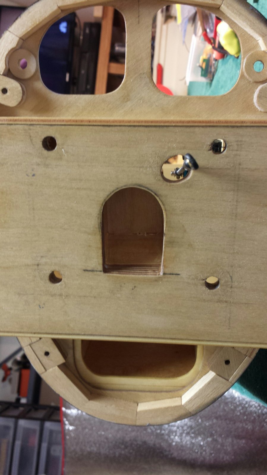

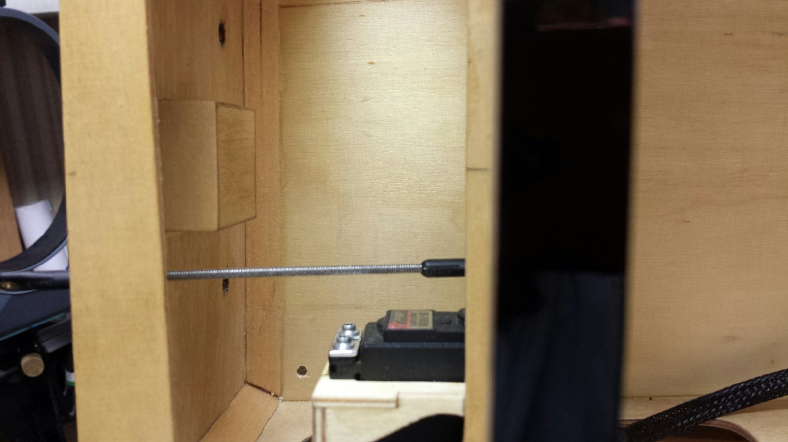

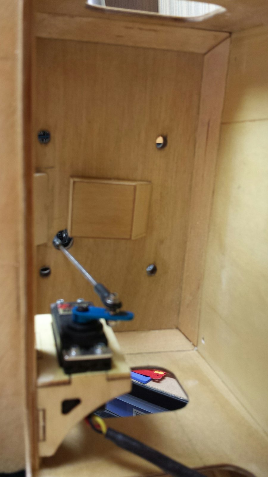

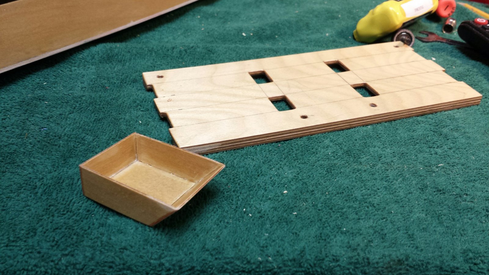

Thanks bro. That gives me something to work with.Here's what I did Mike.
And if you go to this page of my thread you'll see a cool Idea for it from @Pistolera https://giantscalenews.com/threads/50cc-scratch-build-from-my-own-design-revisited.1089/page-64

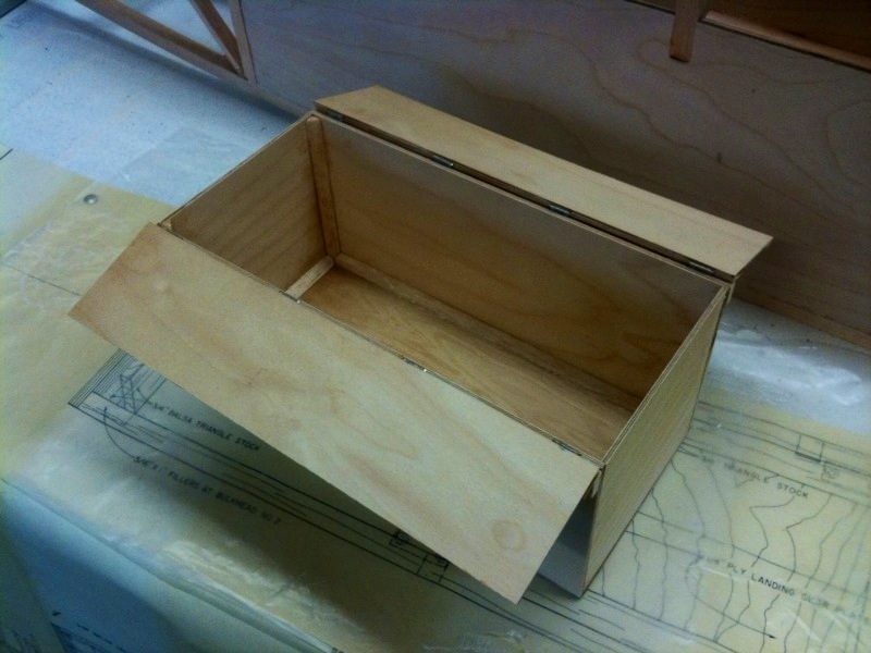

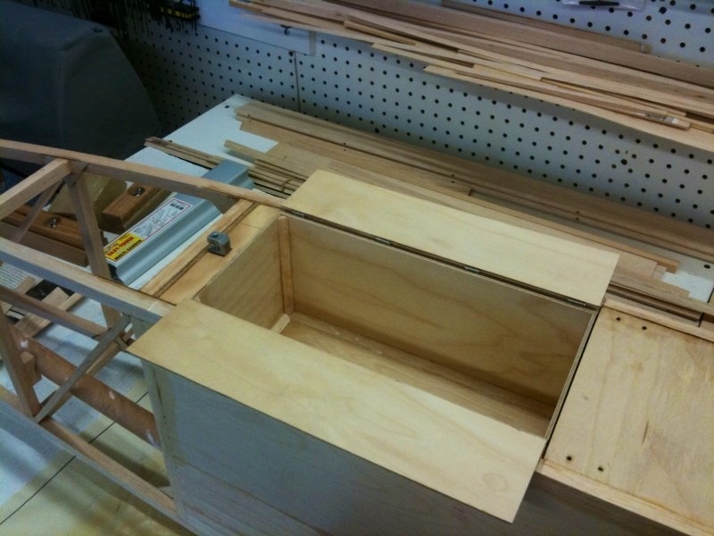

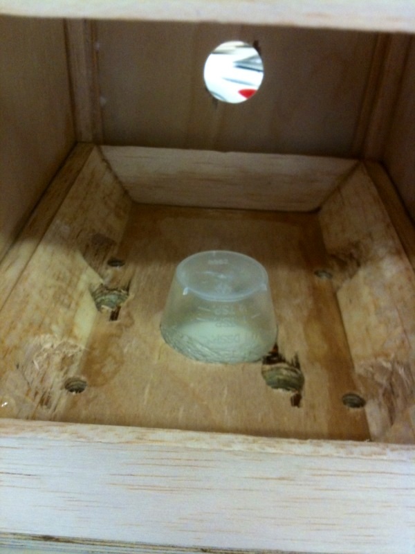

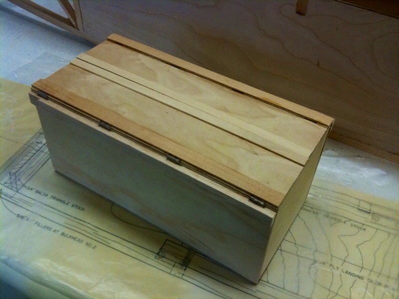

View attachment 96611 View attachment 96612 View attachment 96613 View attachment 96614
You will need to do something to stop the fuel spitting into fuselage. Jetpainter gave a few good ideas how to do this.
