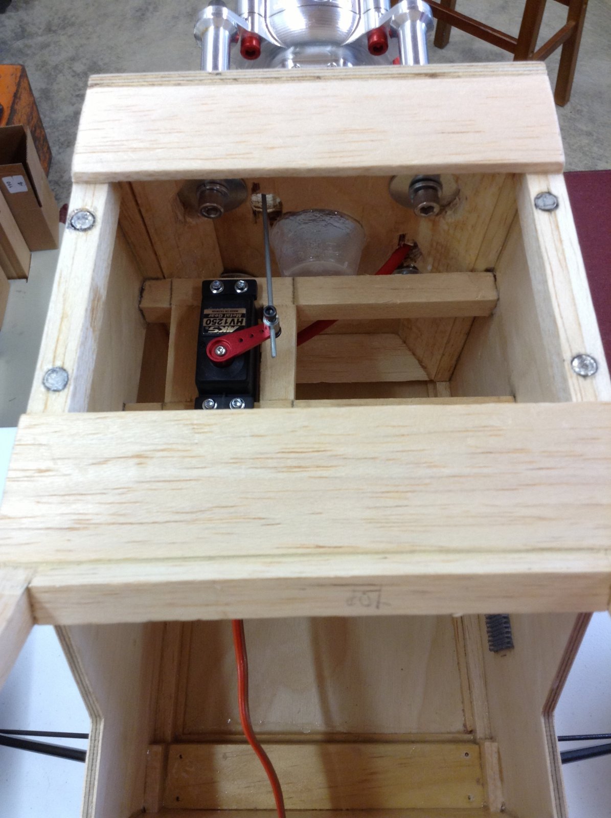

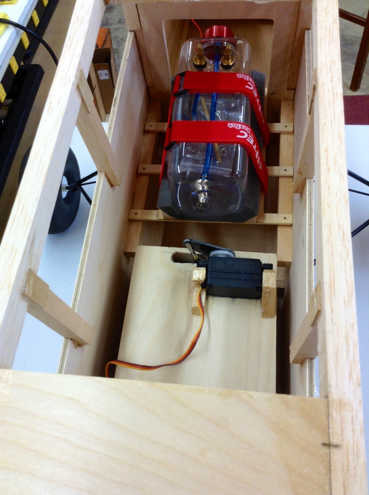

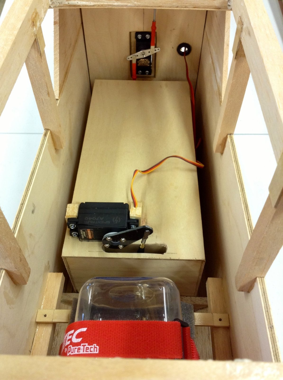

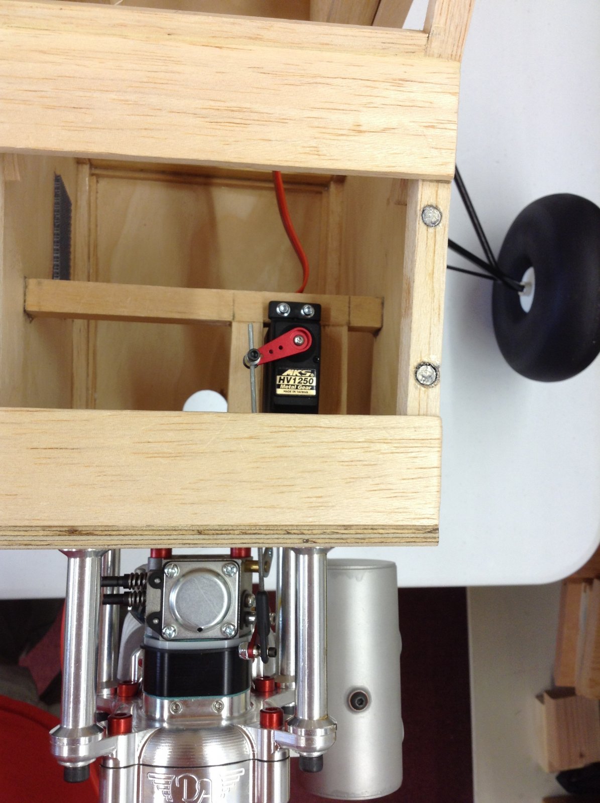

Finally finished up the cargo box. After pondering the linkage for a while, I decided to go with a cable setup instead of hard linkage.
View attachment 97098 View attachment 97099
Neat setup. For what it's worth Mike, your cable drawn closure system is probably the easiest way to go. I used a Hitec HS 55 at each end of my box. One for each door. It worked pretty darn well, but oh my aching head. The geometry from solid links just about drove me coo coo.... It would either close all the way and not open all the way. Oooor.....it would open all the way and bind when closing. Grrrr...... Of course this was well before I understood completely how to use the programming in my radio. Once I got that nailed down, huh...what a piece of work. LMAO.
