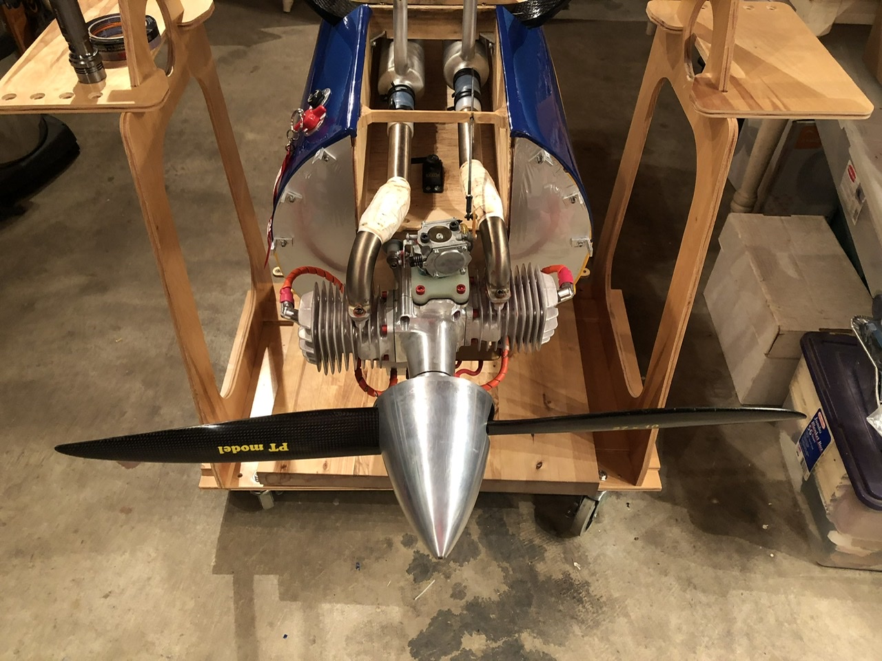

Need some insight from the great people here at GSN.
Yesterday, I decided to take the Python to the field and leave Draco at home.
Was a beautiful afternoon, clear blue sky, no wind and 80F. First flight was awesome, stayed up for ~15 min.
Landed, refueled and pulled it back to the starting station. Here I encountered the phenomenon I’ve been fighting for a while now - the throttle servo would not respond.
Actually, I’m not sure how I finally managed to make it respond, because I tried a few things.
2nd flight after this was uneventful. Flew for another 15 min or so.
Landed, refueled, and again - no response from the throttle servo.
Tried a few of the same tricks again, but nothing.
Was getting dark, so I pulled it back to the truck and disassembled it.
Before loaded the fuselage, I tried one more time.
Of course it worked!
So any ideas would be greatly appreciated.
Latest equipment - JR8411 throttle servo, Spektrum DX9 Transmitter, Spektrum satellites on a Powerbox Competition SRS, 2 x 2S LiPo 5000 mah batteries.
I’ve experienced this previously when running a different throttle servo, Spektrum AR12120 Powersafe receiver, different batteries, and different extensions.

Does this happen only after a first flight? Where is the servo mounted? Is it getting too hot (eg; exhaust muffler)? Can you hear the servo - like if you were to try and move it by hand is it locked? If it was an electrical issue I wouldn't think it would reveal itself like you are talking. Given that it seems to reveal itself after a flight and after it sits for a bit it comes back, my initial thought is that it's getting heat soaked.

Does the plane have the spectrum gyro built in . If it does seem this happen switch it off and you should be ok.

When it does this can you see the receiver if you can is the led on solid or not.
Thanks for the responses gentlemen.
Yes, the issue occurs after the first flight, never between the time I check the control movements just after assembly at the field, and the first flight. When this trouble happens, no noise can be heard from the servo, and I can move it freely by hand.
Best way to describe the throttle servo location is inverted at the top of the pipe tunnel. You can see it hiding between the two pipes in the photo below.
I did put new baffles in this thing not too terribly long ago, so it’s very possible that heat is the problem. Oddly enough, quite a few minutes had passed by the time the servo worked again after the 1st and before the 2nd flight. Similar delay between after the 2nd flight and when the servo worked again just before loading the model into the truck.
Looking at the receivers when this happens, all four of the satellites have solid LEDs. With the PowerBox, I can assign any signal to any of the servos, so I did this by assigning a different servo to the throttle input signal and it worked fine. However, I could not get the throttle servo to move, regardless of assigning it to any of the inputs.
