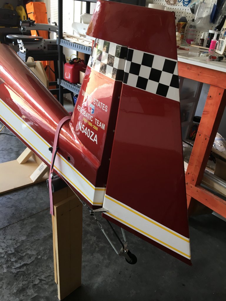

Got the fuse and rudder covered. Just need to put the receiver, satellites, and batteries back in and it will be ready to hang up and check the CG again. Not sure if I'll get to it today or not.
JAG

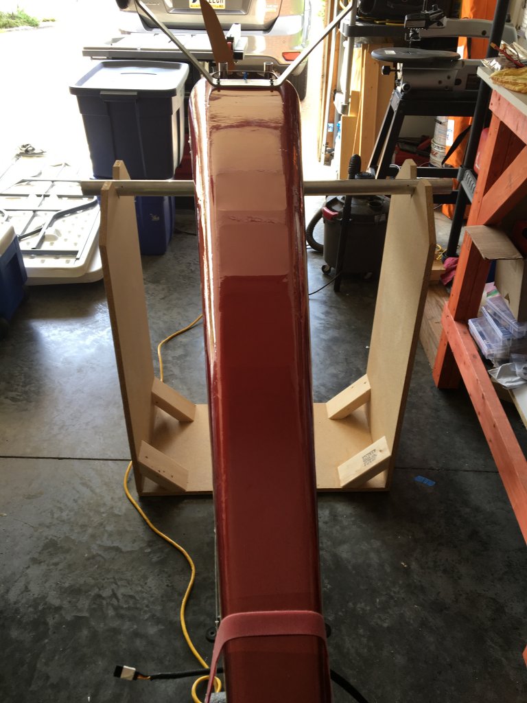

Well I hung the plane back on the Vanessa rig today. Removing the 10oz of weight from the tail moved the CG 1". So I was at 7.25" when I started today. From their I tried many things to try and get to the recommended CG of 5.5" - 6.25". I moved all three batteries on top of the motor box. This brought it to 6.875". I currently do not have a good set of wheel pants, but put all the pieces on top of the wheels to simulate adding them back on. That brought the CG to 6.75". I also tried spacing the motor out another 1/4" but that didn't help much at all and looked stupid with that much gap behind the spinner, so I moved it back. So that is where I'm at right now.
Just as a last ditch effort to see where it would come out, I added the 24oz of lead that came on the plane back on. I put it on the outside of the motor box. This brought it down to 6.25".
So I think what I'm going to do is take the lead back off, add a new set of wheel pants, and fly it at 6.75". It should be manageable. Heck it flew at 8.25" except for the dead stick landing.
I want to see how it flies then put a plan together for the winter. I'll probabaly do some more lightening in the tail on the fuse sides and maybe some work on the Aielerons. I also will probably move the receiver and wiring all up in from of the wing tube. I could also get rid of the SWB rudder tray and build a single servo mount, moving the rudder servo closer to the CG in the process.
