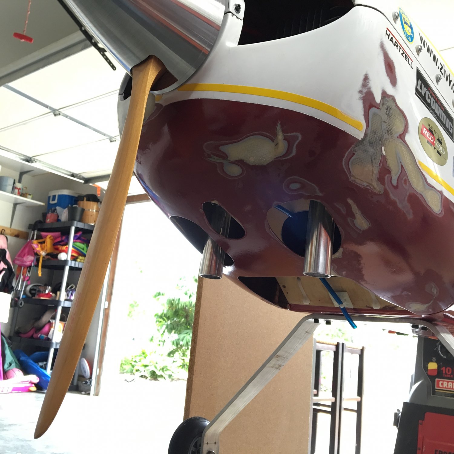

Nice job on the repairs.
When you strip it down look for places to lighten it up (knowing its slightly tail heavy.
-Motorbox holes
-holes in foam on the bottom of the fuse
-lighten out the rudder and the stabs. I'm guessing both are sheeted foam.
See if someone near you has one of these you can borrow and make some holes!

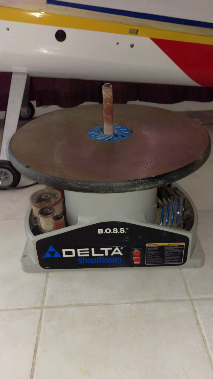

I've never used a spindle sander. But I do have some planes to lighten it up when I strip it down some day.

That sander is great. I used one on my Bipe elevators and rudder. Just draw out the circles you want on the wood sheeting. Cut a hole in the surface large enough to get the spindle in and sand away to the circle drawing. If you had the styro chucks you could put the surfaces in them to ensure a more "level" hole.

Oh thats pretty cool. Always wondered how people were getting suck perfectly round circles in cutouts. Good thing I know someone with one. :)

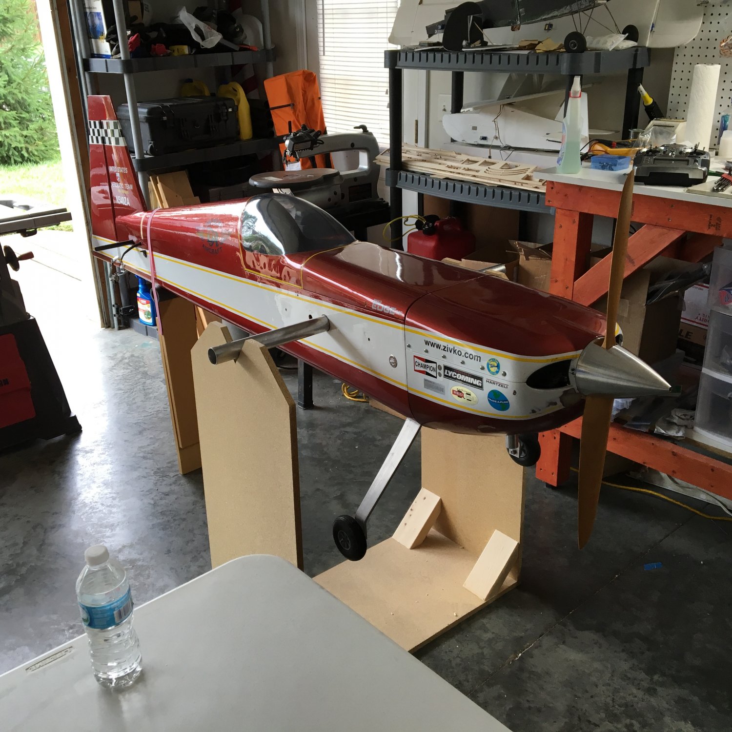

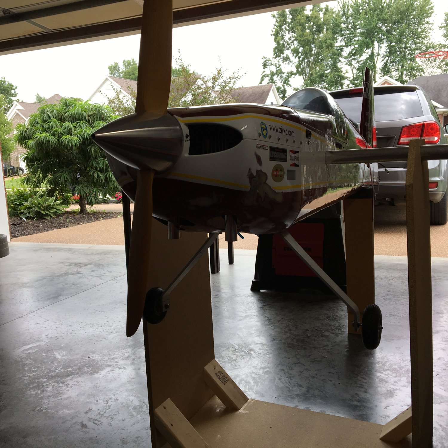

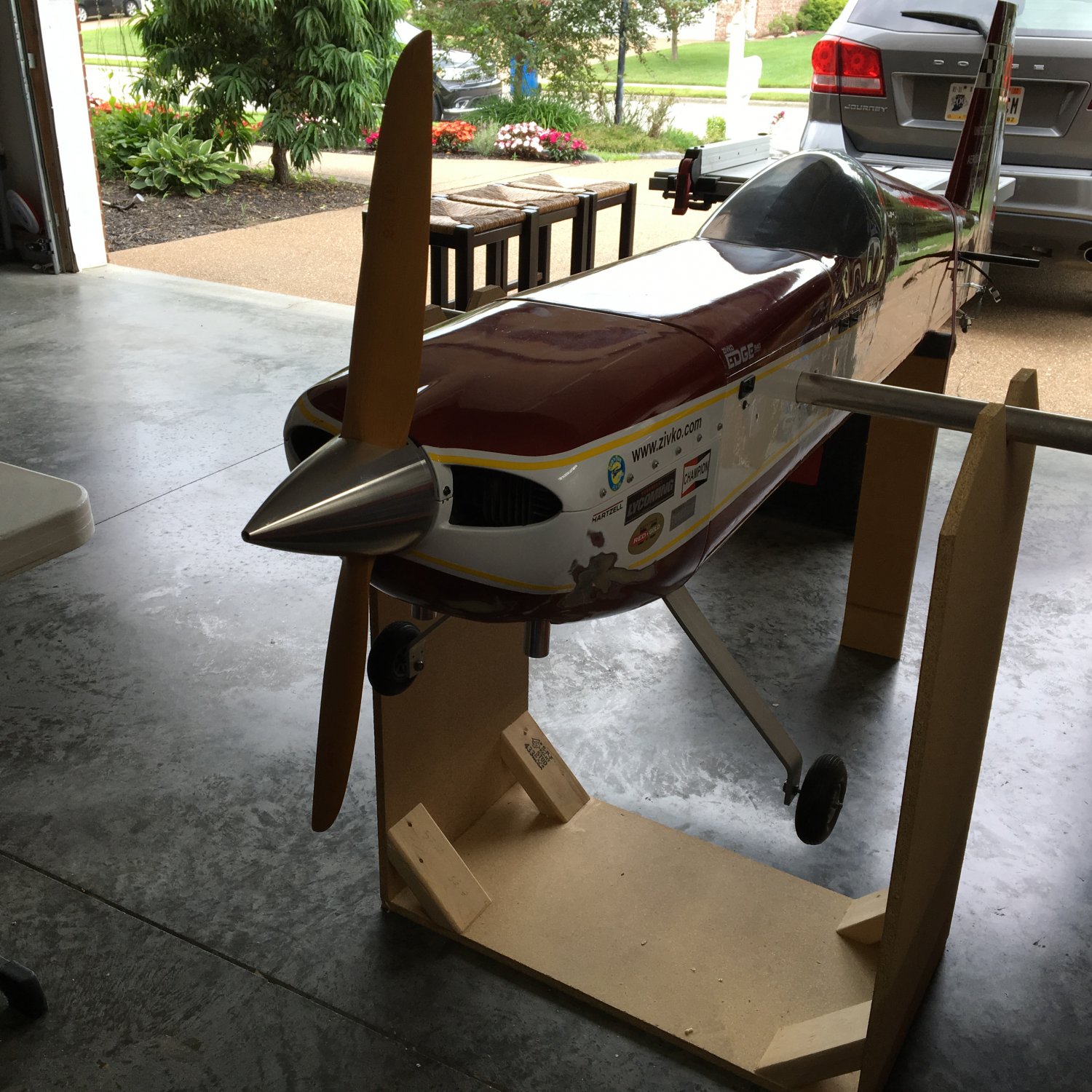

Picked up some hardware at lunch and got the landing gear installed. I also sanded the cowl down yesterday and got everything reassembled. Not going to worry about painting the cowl for now.
Hopefully I'll get it strung up this evening and get the CG checked and see what I need to move around to correct it. Or if I need to add any weight.
