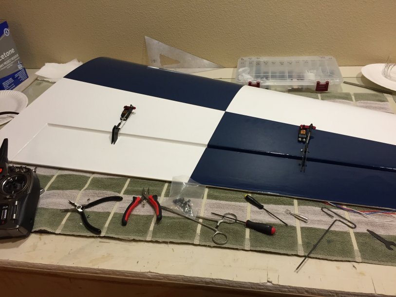

All surfaces (except rudder) are hinged with control horns installed.
Super stoked. All the time spent to get the control horns to have the same height from center of hinge line paid off (no programming in radio necessary to keep from binding). Also pretty impressed with the Savox 1270 servos. Angle of throws were same to each side of center. After install on the left wing and a couple of fine adjustments on the turnbuckles, the servos were happy throughout the full motion of travel.
