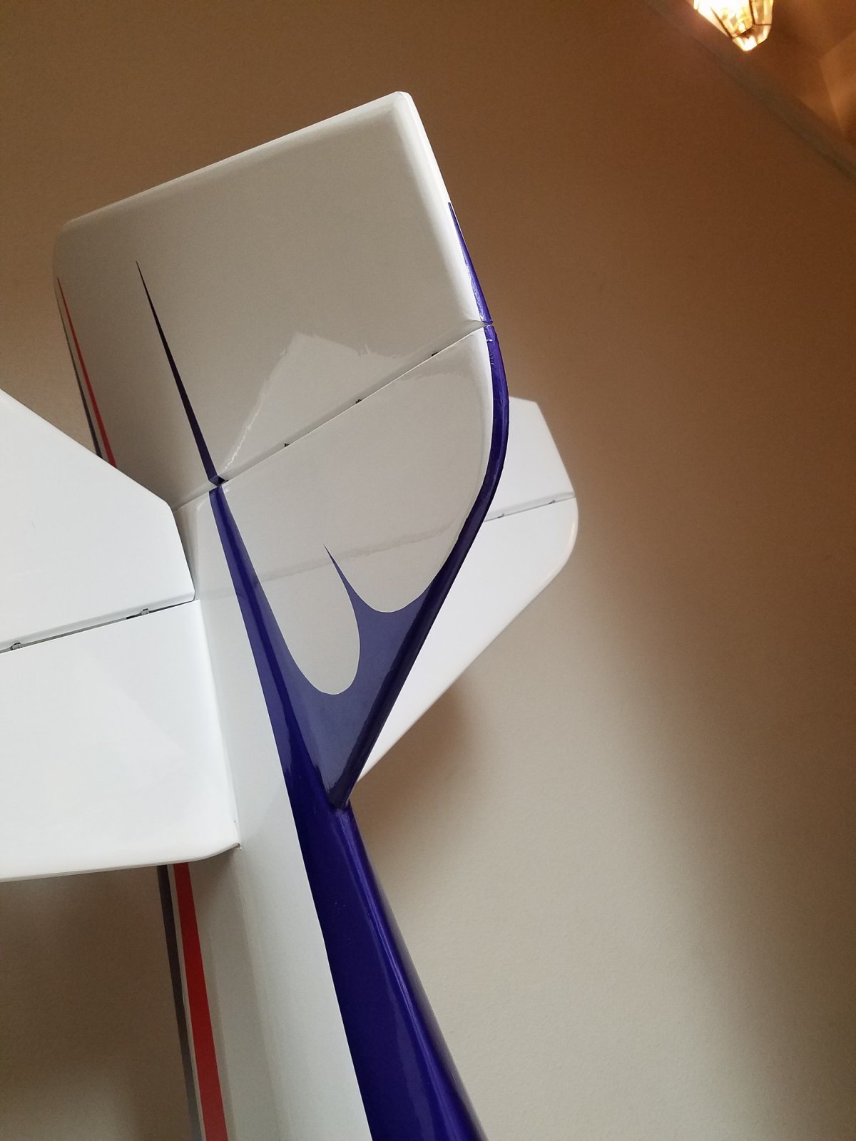

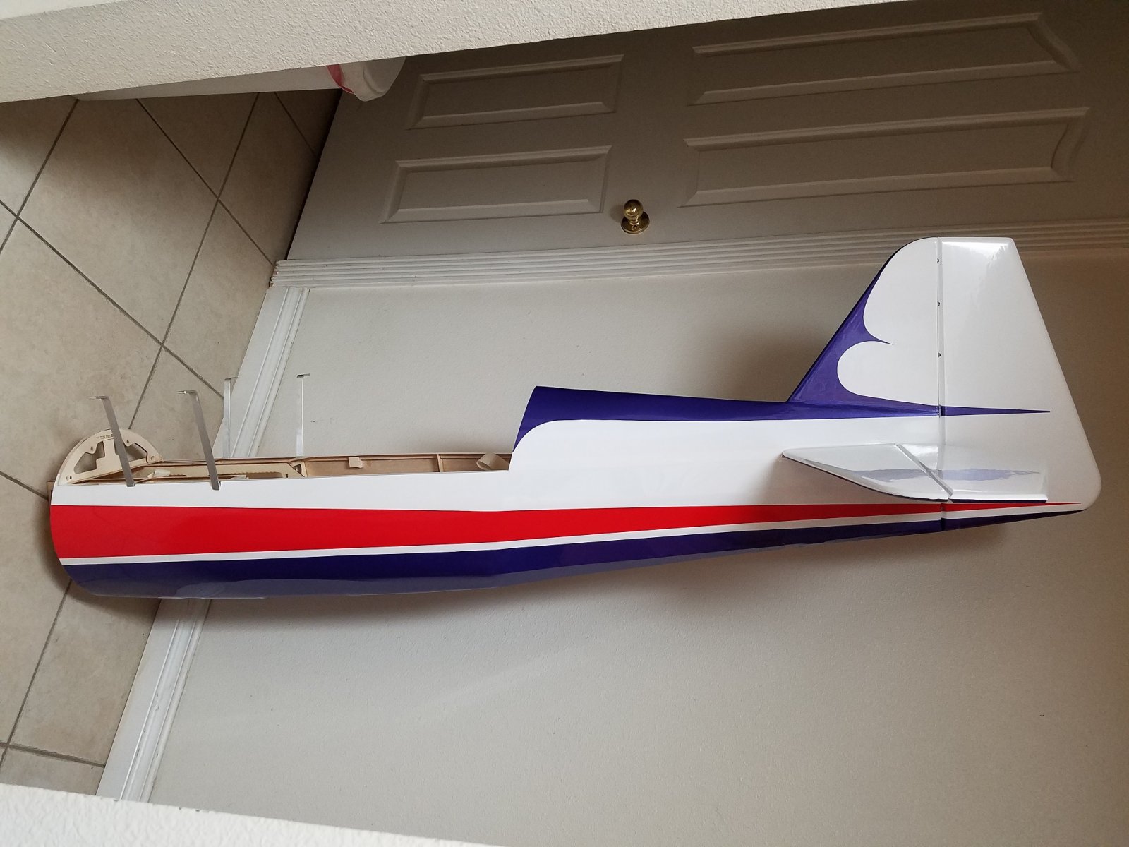

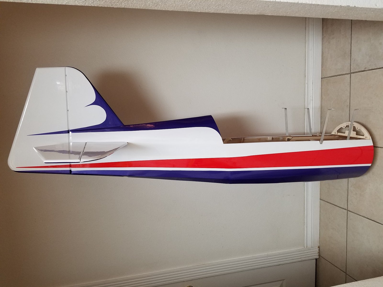

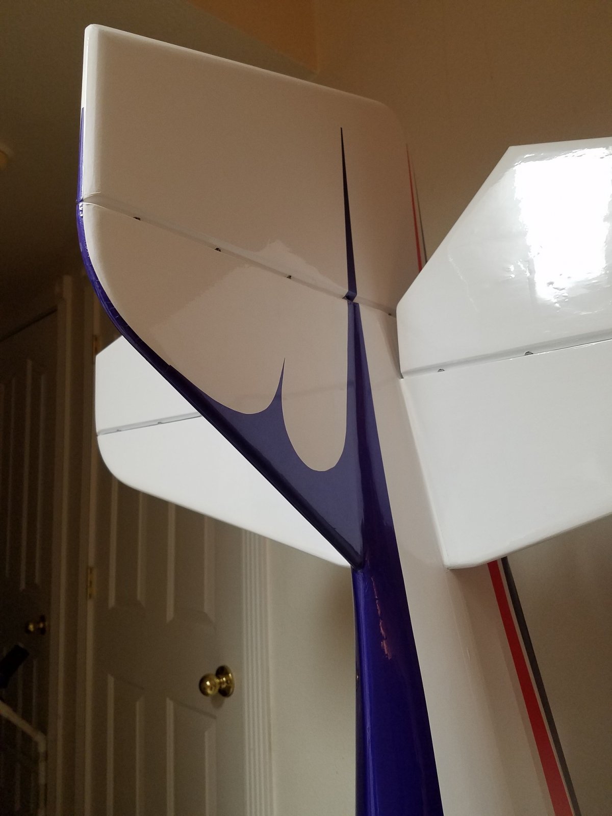

Call it devoted, call it obsessed... call it "just want the dang thing done". I just had to see what it would look like with a little more detail added to the covering. Hence, 4 more photos. Hey, this is really getting exciting. I just gotta see this thing totally done. LOL
I added my own little addition to the rudder that is not on the full scale scheme. I think it looks pretty cool. I still have a lot of touch up with the edges, but just too tired to dig out my sealing iron with the little "shoe" on it. Will get to it tomorrow. I also plan to get the trim on the stabs and after a massive organizing and clean up project, (my living room looks like a hurricane hit it) I will probably attack the canopy/hatch and the wings.
What covering I have done is far from perfect. But for free hand, I guess I can live with it.
