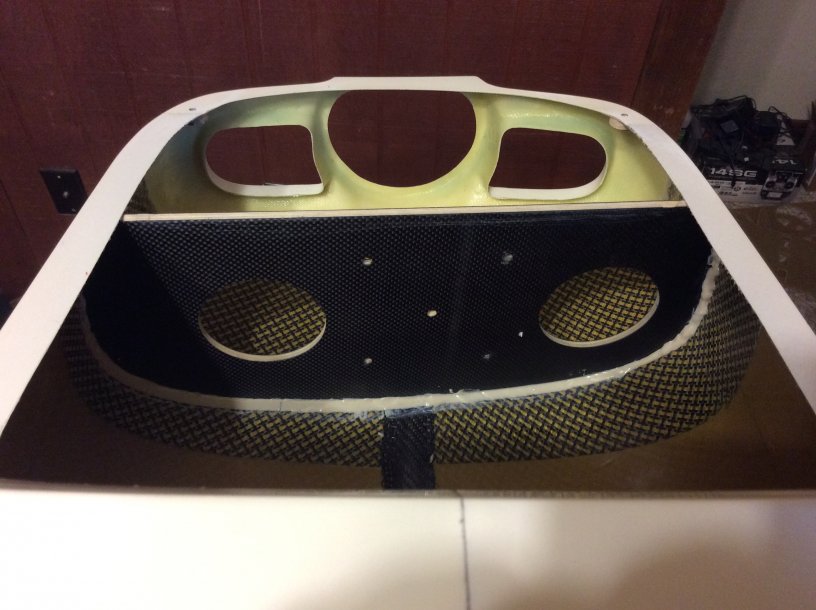

Canisters time.
Made them my self.
At first they've weighted about 2.8oz but then I've found out that I'll need to add some more height to the mounts about 3/4".
After the height addition the mounts are now weigh 4.4oz.
With the Dremel tool everything is easy so it took a little bit of hand drawing the holes for the cans and then some modification to fit it right and make it efficient for air to travel around the cans for cooling.
The rubbers that hold the cans are regular gas hose it will fit it self when I'll do the break in.
The holes in the fuse are a little bit bigger with a tiny hole in the bottom to fit the cans on the headers without taking the headers off.
The cans exhaust are very long so there is no need to add something to make the gasses go out after the fuse bottom line.
